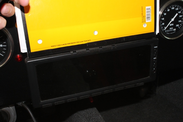

Once one or more cameras are setup, they need to feed a monitor.
I am using a monitor that is shaped sort of like a conventional rear-view mirror, and has input for 3 simultaneous inputs. This permits a view of the rear, and both sides, all at the same time, and in the same panel. See the details at Savv LBM-5400 10.2" Wide Screen Rear View Mirror Multi Monitor
I plan to install the factory side mirrors for compliance. They look pretty good as a backup, but I plan to rely on the cameras for actually driving.
