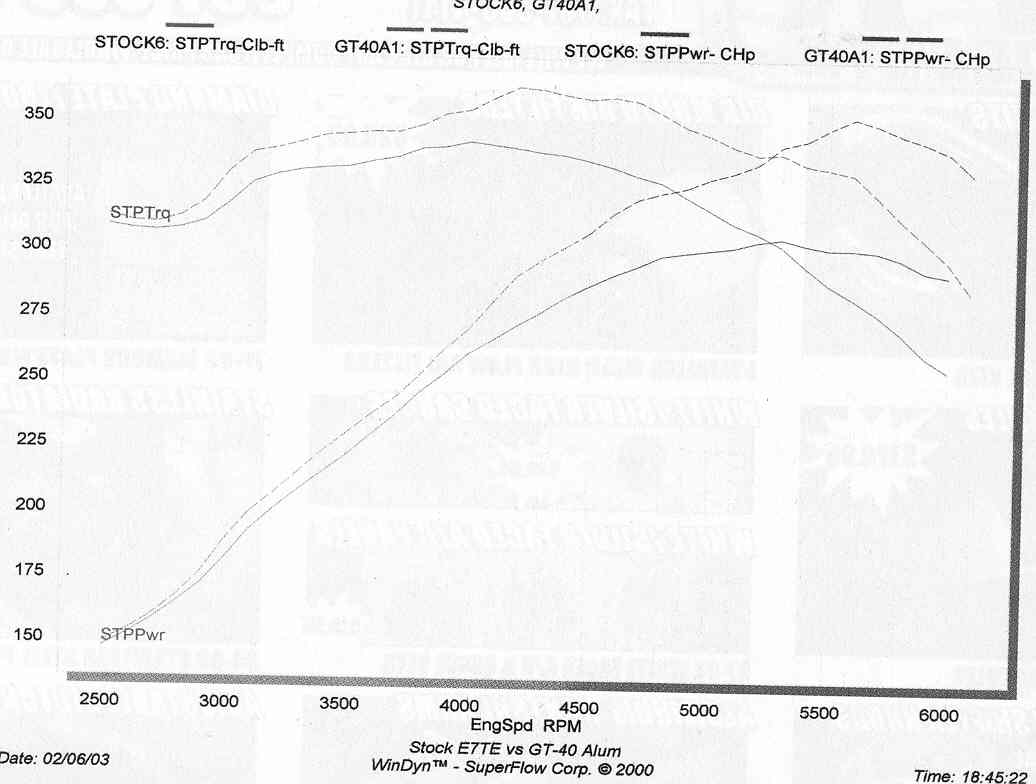

Just to beat a dead horse, I've attached dyno results published in MM&FF September 2003. The engine was a 302 CI, 9:1 compression motor. The heads were the GT40Y's, which flow quite a bit worse than the X's, and the cam was a Comp XE264R which is more tame than the B303 (212/218 @ .050, .512" lift, and 114 LSA). The intake was the carbed performer RPM.
Peak HP 353, peak torque 363.
Also notice that in the same graph are the results for the same engine with good old E7TE heads (stock 5.0L), and it still made more power than yours must be making at the flywheel.
I don't see how the heads are to blame.

Have to completely agree with Adam's analysis despite feeling the 5.0L FMS motors are not as good as they claim. I remember the MM&FF data and although the motors made more power with aftermarket heads, the stock 5.0 heads did reasonably well.
