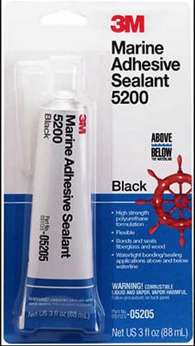

Here's one Ron: 3M 5200. It's used in a lot of marine applications. Once it's bonded, the only way it's coming off is by taking the surface of what it's bonded to with it. It'll take 24 hours to bond to the glass, and 7 days before it's fully bonded, but it ain't coming off there except with a hammer.

Cliff, that stuff sounds scary... I don't think I could hold the mirror still for 24 hours...my arm would either get too tired or I'd have to go pee. Either way....
