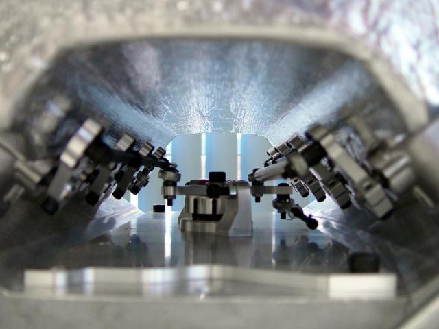

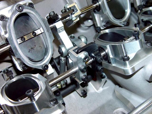

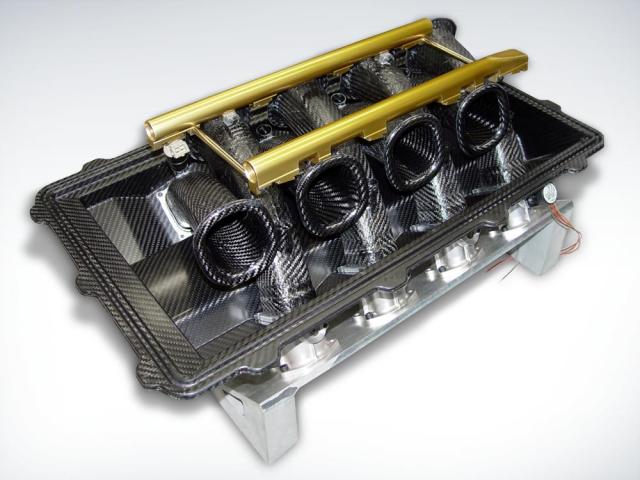

Harrop SVO manifold

That manifold is a very nice piece of work. This may help you, I puchased the race motor for $12,000, supposedly half of it's original cost, about 4 years ago. Even though I've lost the short motor the heads, camshaft, dry sump and pump, and 4 barrel Motec manifold leave me with quite a bit of value.
