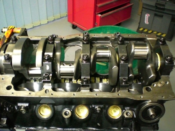

Maurice if you look closely at the pic of the crank you'll see it has heavy metal in the counter weights. I had the machine shop (Saliba engine reconditioning) balance the crank so it is internally balanced. They supplied the pistons,crank and rods after machining the block so I assume (no not that word again) they have weight matched the pistons and rods and also used those weights to balance the crank as a unit. I will check with them as my orders are not to assume anything.:uneasy:. I was going to remove the camshaft to check the bearing oil holes are lined up ok. They were fitted by Saliba. So if I have it out should I crack test it too? I've never heard of camshafts being balanced but what do my bosses think?

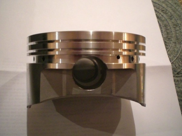

OK I have a pic of a piston going into my new engine. This pic clearly shows the oil ring groove and pin interference and forms part of the objection to the 347 stroker engine (I am building) by forum members in earlier posts. The new crankshaft has longer throw journals which increase stroke from 3" (standard 302ci) to 3.4" (347ci). Rod length is increased from 5.09" (302) to 5.4" (347), this increase in rod length attracts some critisizm as it makes for a poorer 'Rod Ratio'. Because of the longer throws on the crank clearance issues arise and knotches have to be cut in the lower bores. This has been done to my block and Jac Mac highlighted they were larger than they needed to be.
So in summary objections to stroking a 302 to 347 are based on
1/ Piston pin/oil ring interference
2/ Poor Rod ratio
3/ piston support at BDC

FWIW.
1. Piston Pin oil ring interference.......I dont have a problem with this, in fact at 3.4" stroke I would run a 0.900" pin height piston.
2. Poor rod ratio.........This is the 'real' issue & use of a 0.900" piston allows a rod that brings this into an acceptable 'area'.
3. Piston support @BDC......With the above suggested longer rod this situation is considerably improved along a more 'conservative' approach to the clearancing notches.
Obviously these suggestions are going to be ruled out as TOO expensive due to the pistons & rods being custom order pieces & I can understand that. However thats my take on the combination & I have similar views on the 427ci(4"stroke) versions of the 351w. These combos were introduced simply to satisfy the need for cubes factor and while they do satisfy that need in some respects they come up short on reliability when pushed at higher RPM.
I have to agree with Jac.
For my next engine I'll be using a 5.4" rod with a 4.125 bore Mahle piston that has a wrist pin located @ 1.090" and a 3.4" stroke, 4340 lightweight crank.
These are shelf parts, not special or custom order.
Prices for this setup with rings and bearings will come in around $2500.
Dont you mean disagree Scott.:) your combo is same as Ross. I suggested a 0.900" pin height, 5.600" rod, with the 3.4 stroke.
Yours & Ross combination works out at 1.588/1 rod ratio.
My suggestion comes out at 1.647/1 rod ratio.
