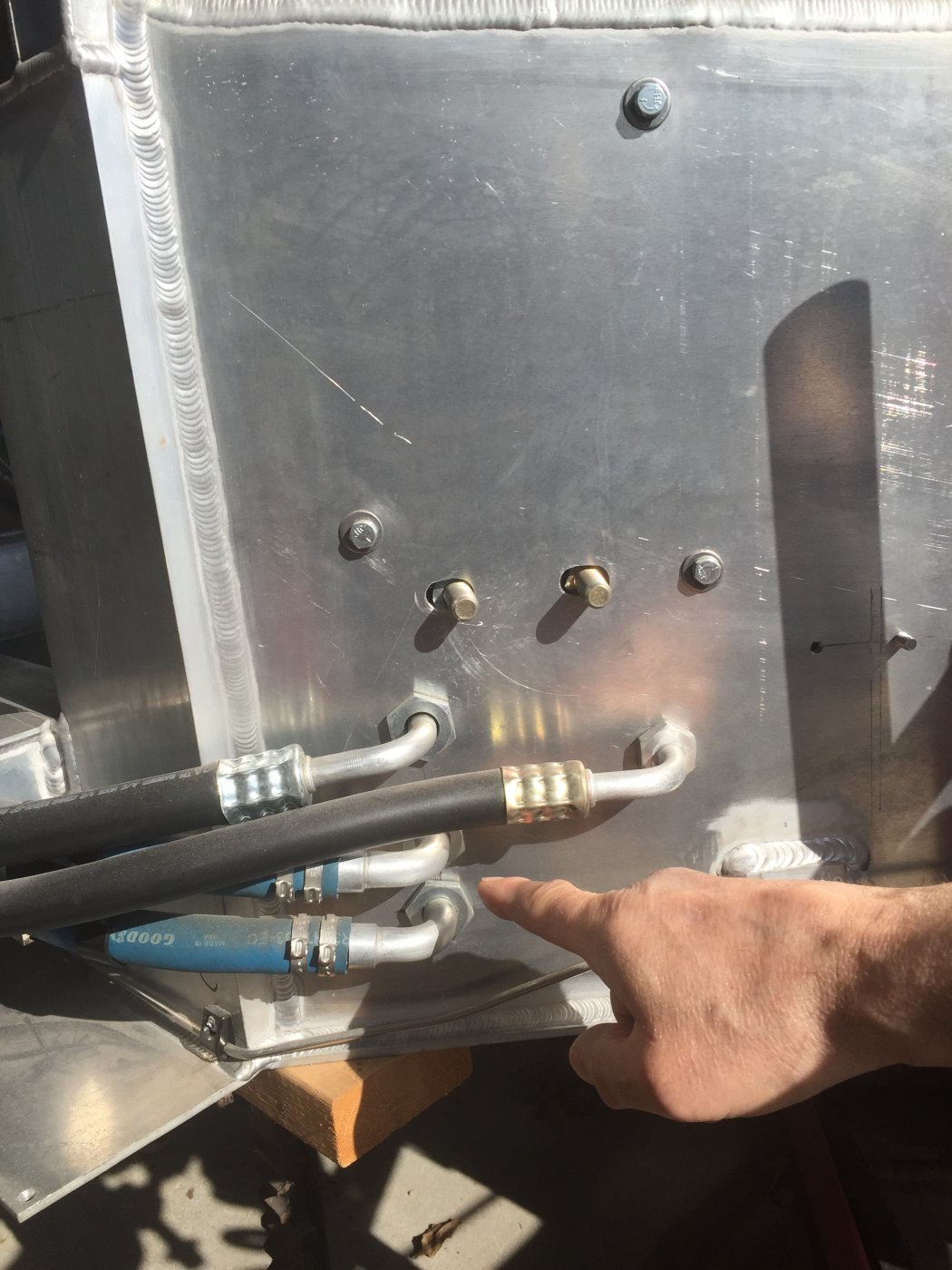

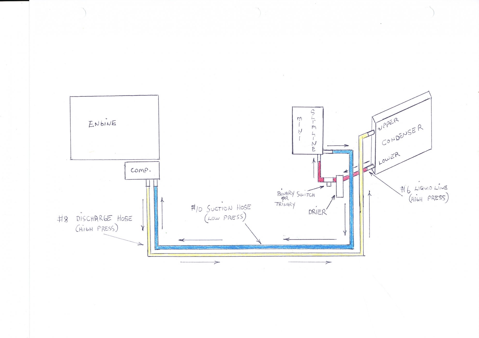

Most use 5/8" heater hose both ways to the heater core along the passenger side of the chassis. If you look at Allan's build videos you can see that he routes the hoses up and to the top of the tub. Others like myself use Vintage Air adapters to go through the tub as shown in the first picture. The second picture is a drawing I made up of the A/C hose configuration.

Pardon my ignorance , I am trying to order the bulkhead fittings for a/c lines and heater hoses, I can see the fittings coming out of the footbox, but what do the fittings look like on the other end (inside the foot box) is it an AN type fitting? Thanks
Heater hoses are usually a #10AN fitting with a 5/8 barb for the hose. The AC will be a #10 O-Ring AN and a #6 O-Ring AN.
