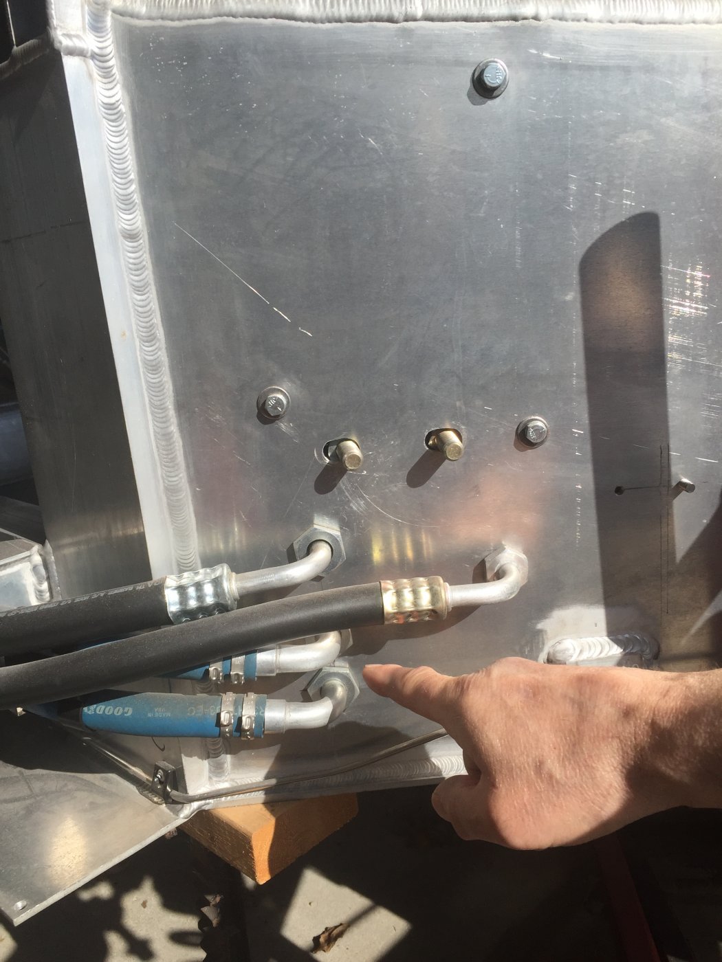

Here are the part numbers for the following fittings in the attached picture. Some builders choose to run the #8 a/c hose on the outside of the foot box all the way to the front. I bring mine inside the footbox then out the front bulkhead for a cleaner look. The down side is the fact there are two additional connection points.

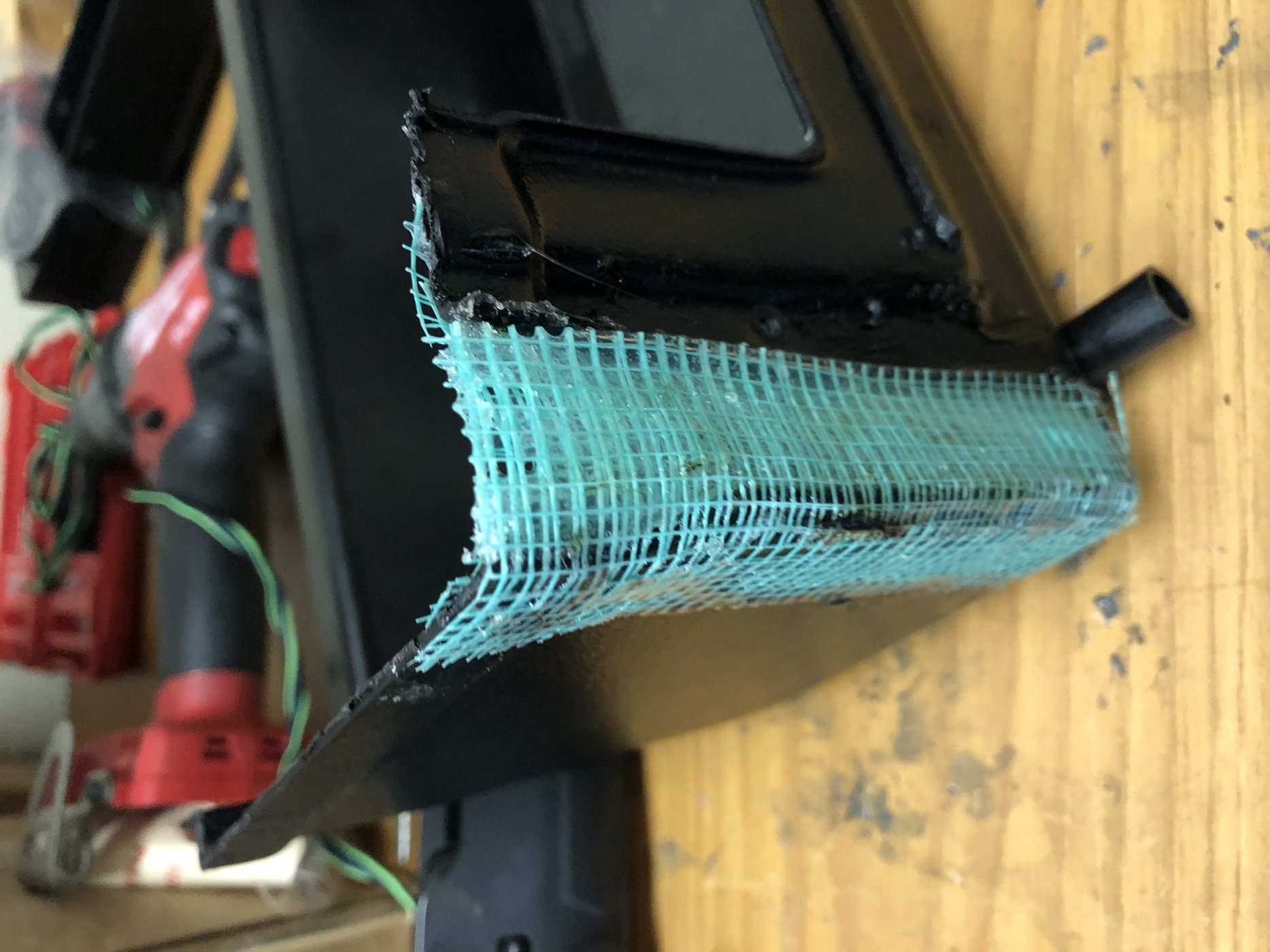

Thanks Joel, I did think about doing it that way, and thanks for the shoe goo tip, I got the clear instead of black, so it looks funny but works.
I will try both ways and see which makes more sense .
Joel K
Hector,

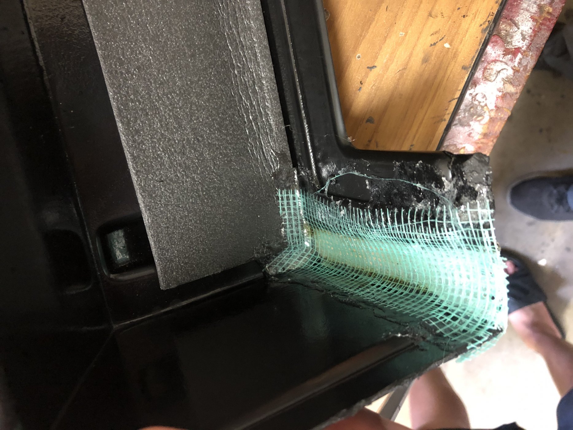

Shoe goo is good stuff. The black is nice since it hides the fiberglass sheet rock tape and is virtually the same color as the ABS. But at the end of the day, no one will see it.

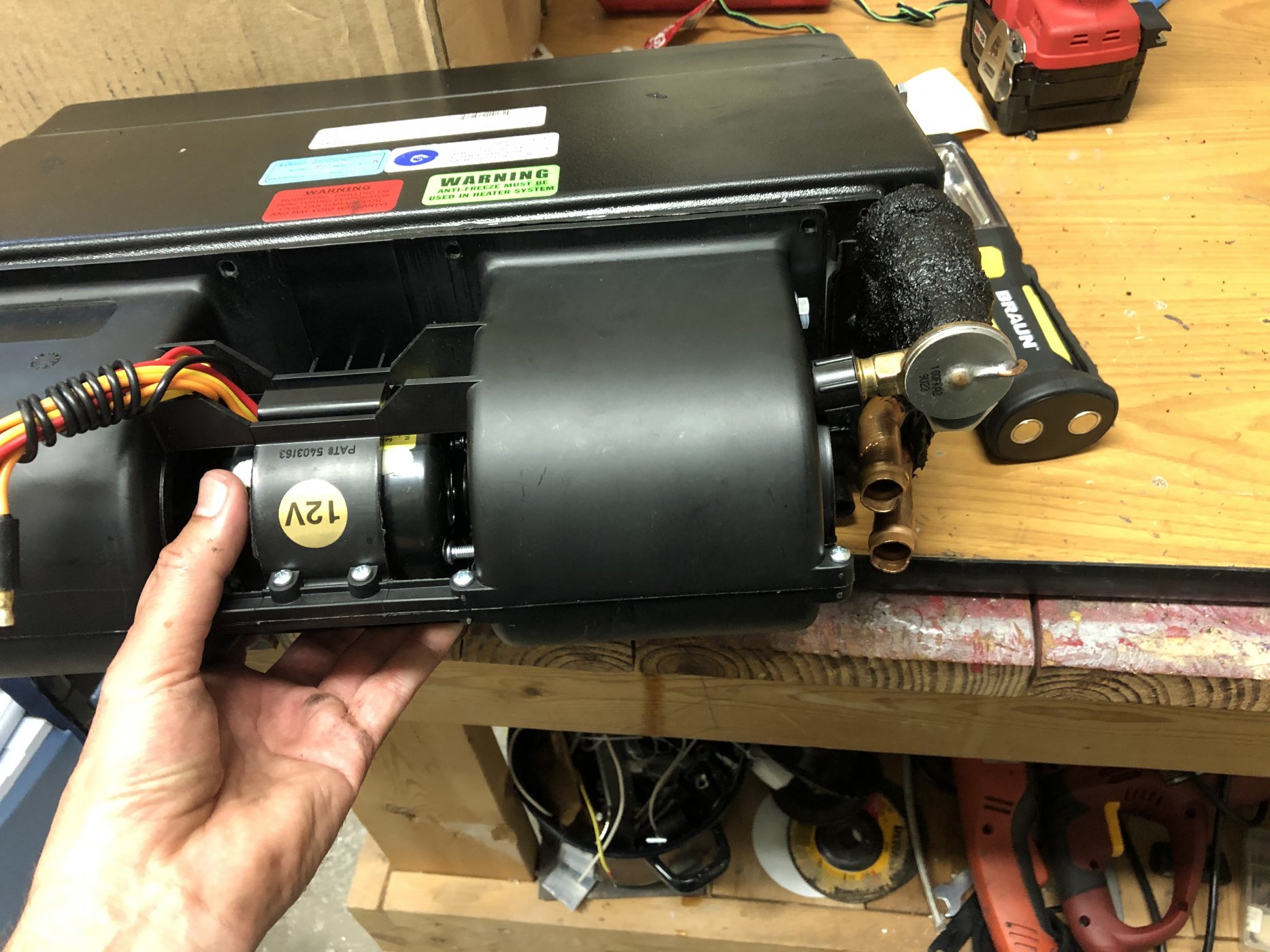

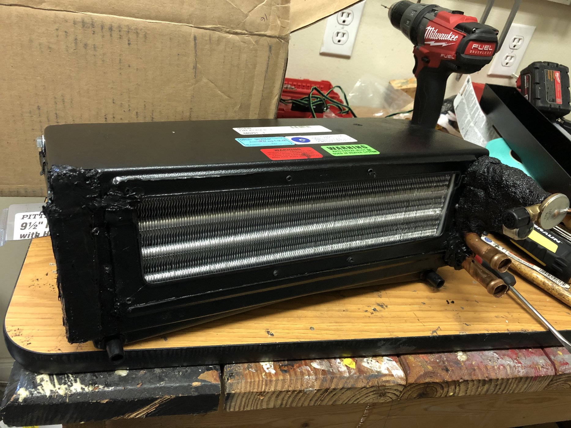

So I repaired the condenser frame, flipped the heater core, replace all the sticky monkey sh!t, flip the a/c intake everything looking great .
Hector

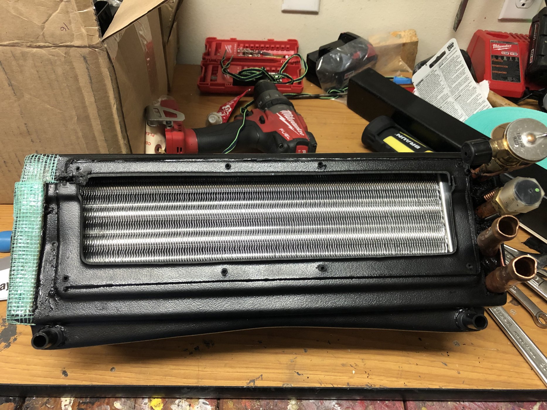

I am so ticked off!! remove monkey crap again rotate a/c intake and probably have to bend the heater tubes again, now to the outside . What a royal PITA.
Joel K
Patience, patience, patience. What I am learning by doing this project is everything takes much longer when you are doing something for the first time. Lot’s of think time and going slow in small steps helps me.
I think you are close, a couple ideas.
1)The #6 fitting needs to be rotated a bit upward which you already know.
2)Looks like you squeezed the tops of the copper heater tubes when you straightened them. Stephan, cut the tops off and re-flared the stub, this may work for you and cleans things up, but you will need the right tool to flare the copper tube.

Joel:
As I look at this core flipping mode I realized that the air intake for the unit is blocked severely by the heater tubes. I am going to try to bend those away form the air inlet . I don't know if anyone thought that may be a problem with air flow into the unit.
Joel K

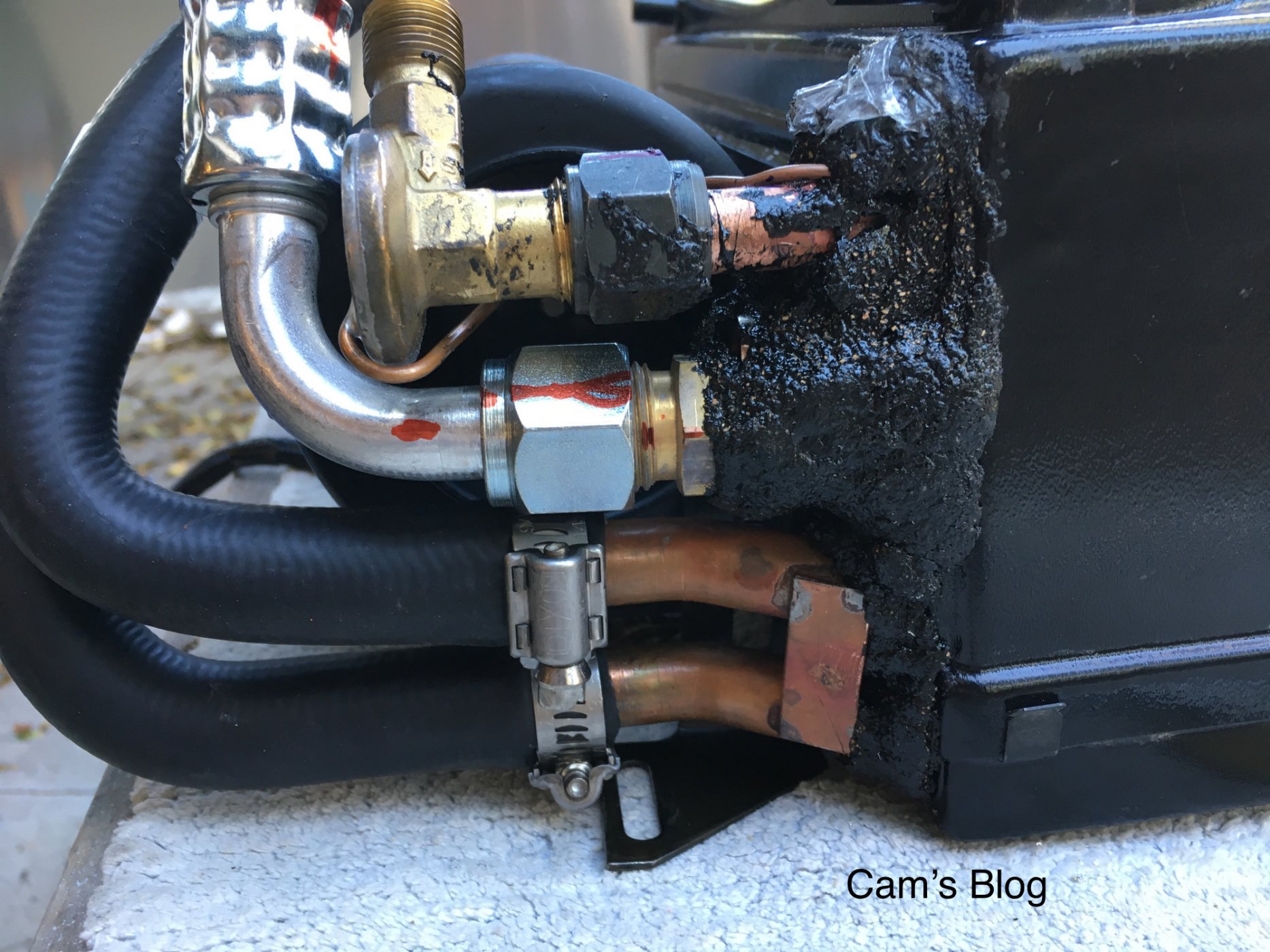

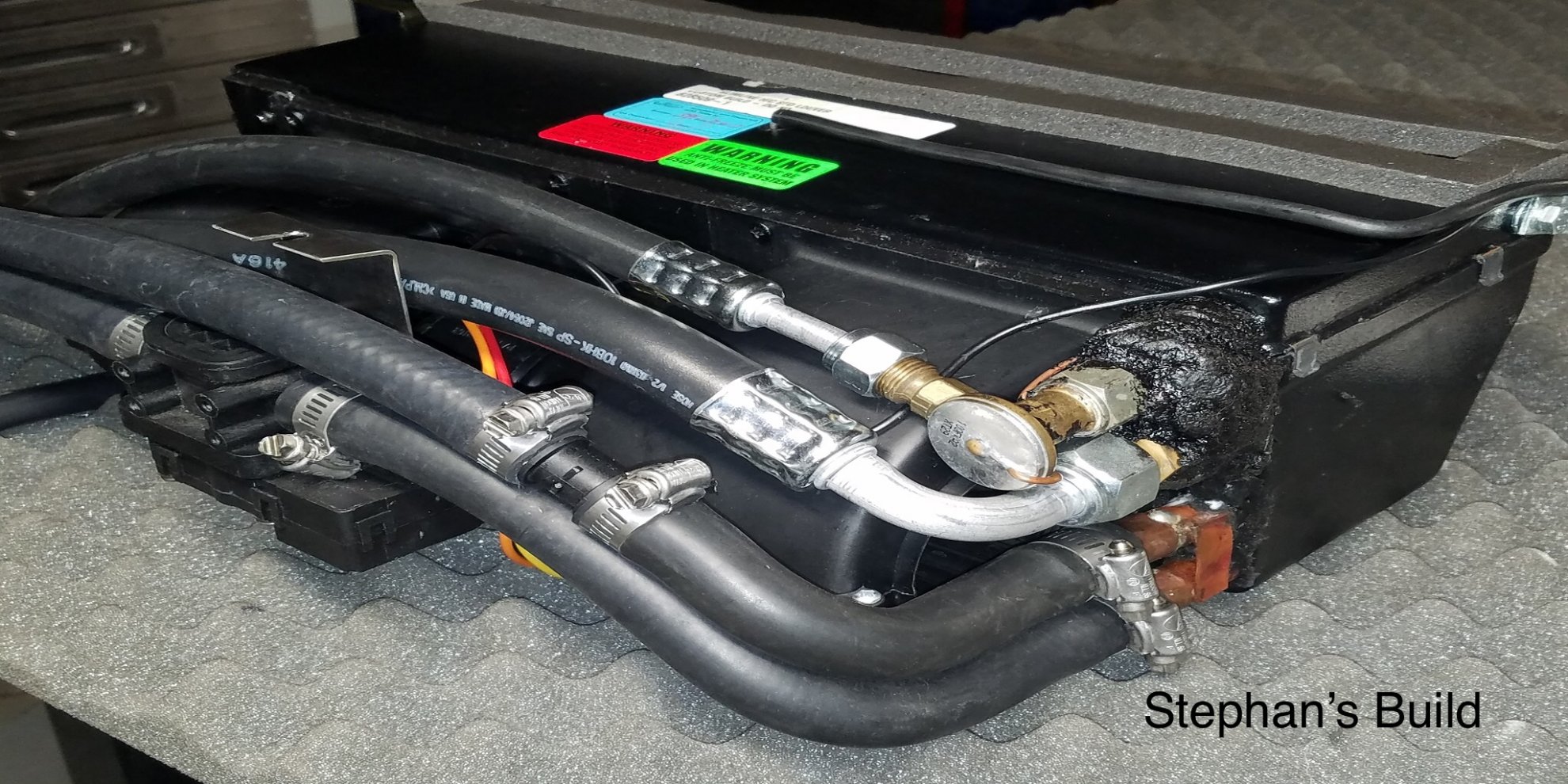

Hi Hector,
You have a point and I did not think of that, however I don’t know how much better it is leaving it in the original orientation. I still like the swapped approach.
Here is a pic from Cam’s Blog with all the hoses on...
Here is a pic from Stephan’s Build thread with the heater core swapped. Not much difference to me.....
Hector
I think that is a problem, you are not getting any air into that side. I don't know if I can make it better but I am going to try , it will depend on where I can route the tubes inside the footbox. Will see. I guess there is never a free lunch, always a compromise . Getting used to it.
Hector
If if bend the lower tube 90 degrees straight down and the upper one 90 degrees towards the driver side it is tight but it will fit and will free up the air inlet. Easier said than done, I will see what I can do . I may need to learn to solder copper tubing. I should have gotten the copper tube bending spring to begin with. May be too late now, I messed up those tubes really good, this will be the third of fourth bend I attempt.
I wouldn’t sweat that blockage, it’s very rare that I move my blower past the low setting. It’s getting plenty of airflow and isn’t stalling out the fan. Texas heat may be a little different but this was true even when ambient temps were in the 90s. Seal your cabin really well and get as much heat blocker in there as you can and I think you’ll be good.
