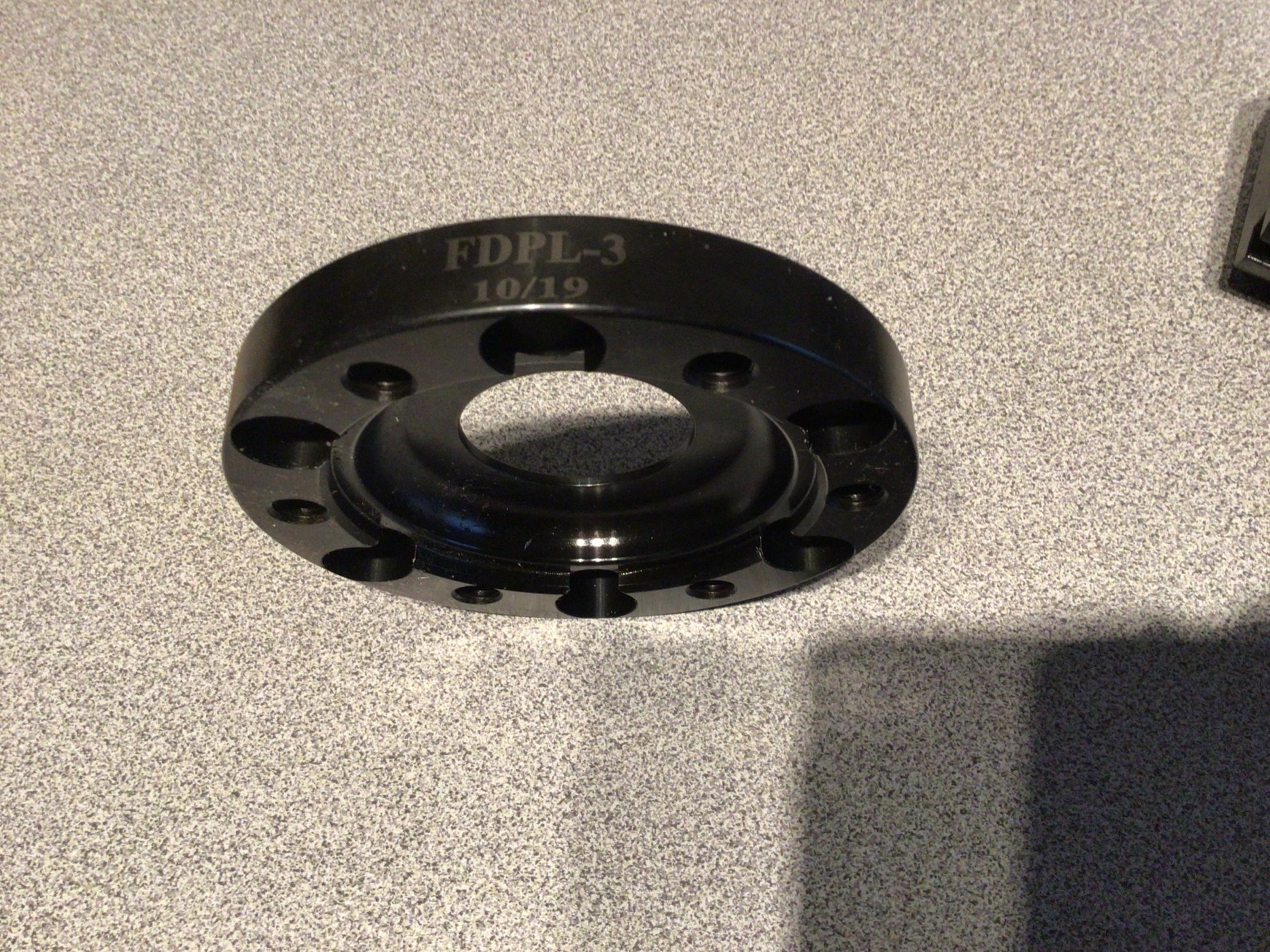

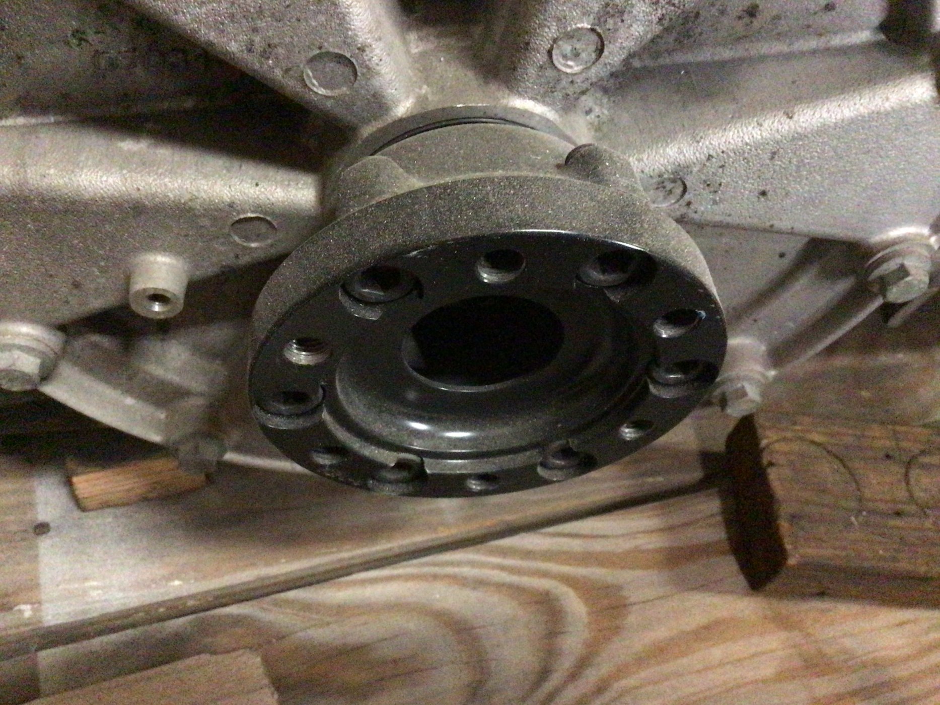

Hello John,
I am looking into drive axle options. I can't seem to find the C/V joint that fits the Ricardo flange. The Porsche 930 is close but a tad too small. Any help with this would be greatly appreciated.
Thanks.
Ken Roberts
“The Driveshaft Shop” sells the adapter flanges to mount the 930 cv joint to the Ricardo. Part number FDPL-3.
It is also the same adapter to use with the V10 Graziano. I think I paid about $450 for a pair. I have these adapters on both my Ricardo and V10 Graziano transaxles.
