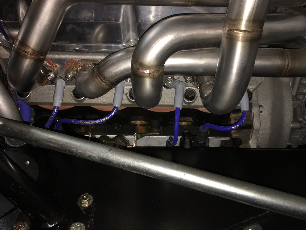

Lee, The cables on most RCR right hand drive GT40's run along the right sponsoon between the drivers seat then a hole is drilled in the rear bulkhead to route the cables. I chose to keep the extra 2" of room on the drivers side (3" where the shifter box is located if placed on the inside of the sill) and mount the shifter inside of the sponsoon next to the gas tank. I had to make a relief in the gas tank to house the shifter box. I cut a hole into the interior side of the sponsoon close to the bulkhead and routed the cables through this hole and the hole in the bulkhead to the transaxle. I had a plate made to mount the shifter box to and then mounted the plate to the sill. I probably lost 1 gallon of fuel but my comfort is worth much more. :)

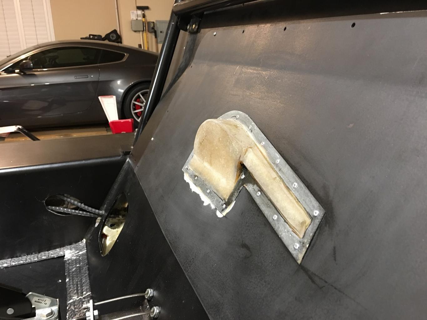

I did not like how the water pump "bump" was done on the rear bulkhead so I ground it off and made my own. Not only does my design protrude into the interior by a 1/2" less it also allows for a/c belt clearance. Once repainted the bulkhead will look good.

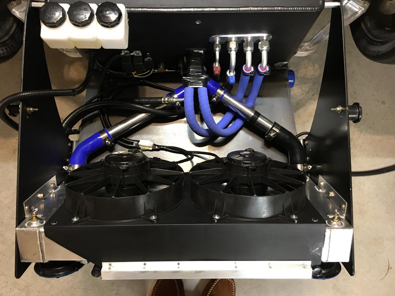

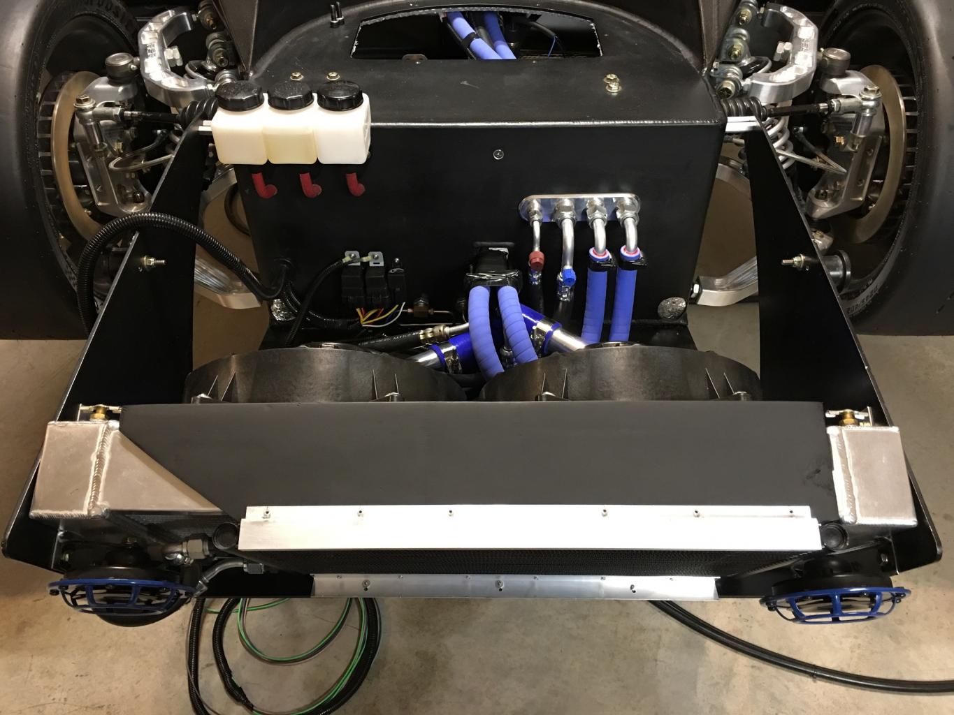

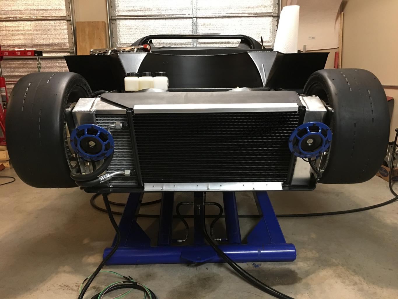

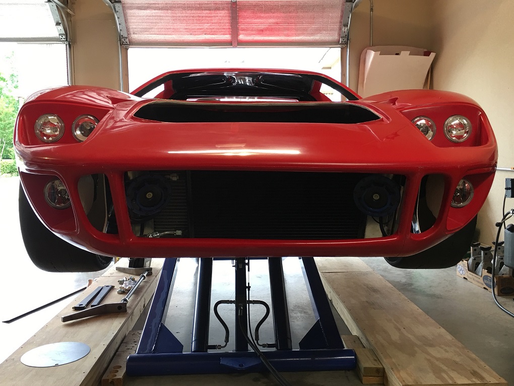

I designed and made a shroud for the radiator that would house 2 Spal fans and hold the top of the a/c condenser in place. The shroud is completely sealed around all 4 edges to the radiator and even though it is only 4 layers thick and secured by 4 sheet metal screws it is very solid. I am especially pleased that I actually completed it in 1 long day (including paint)!

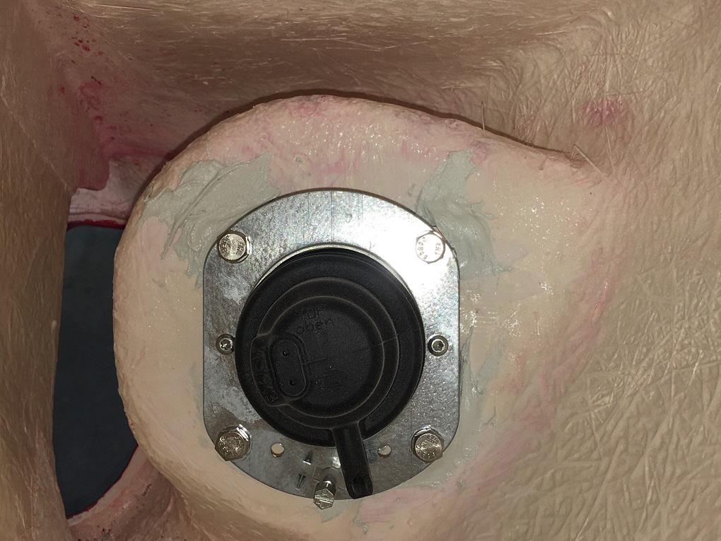

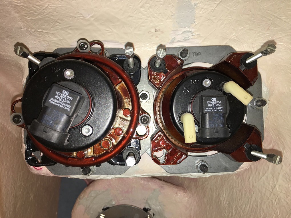

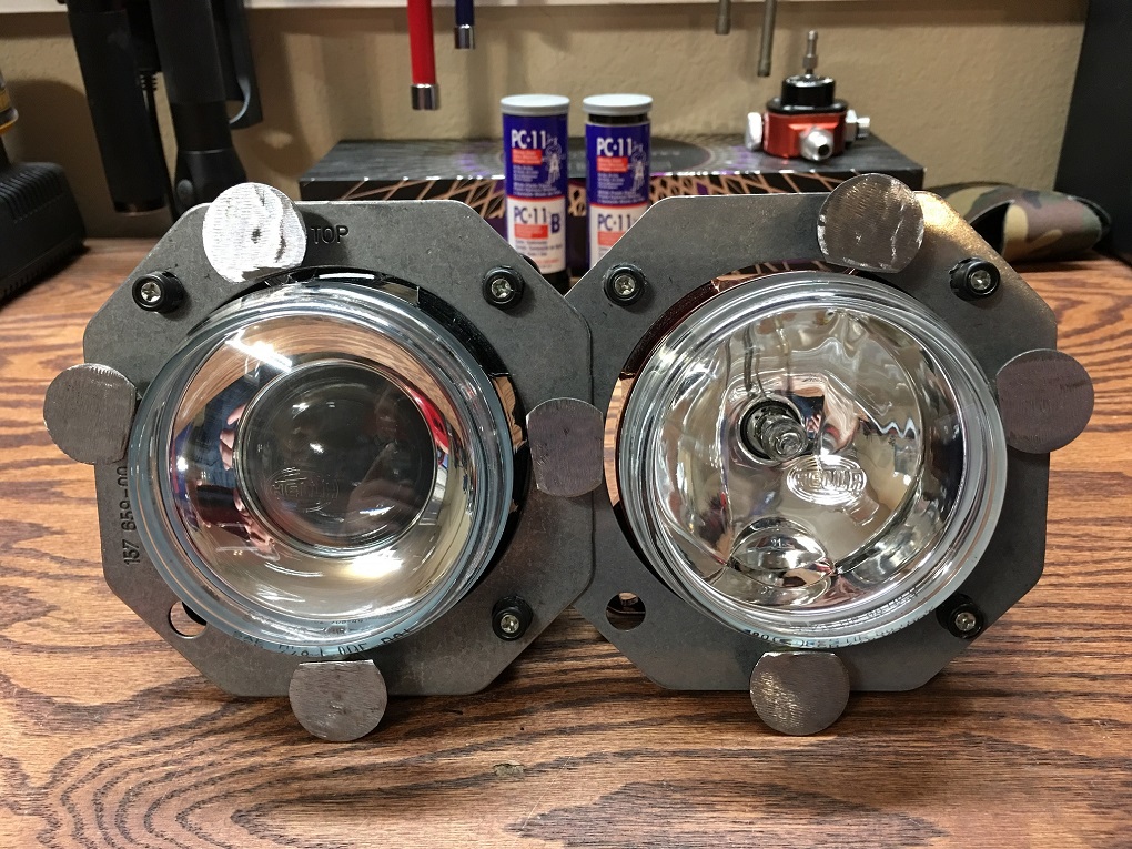

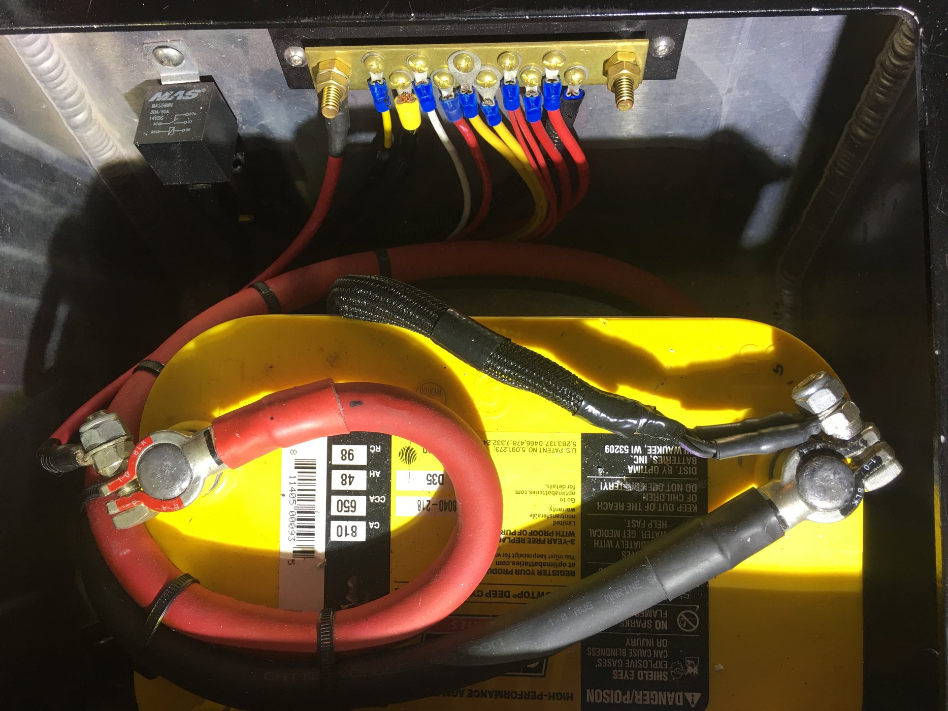

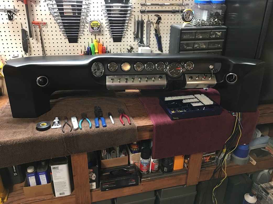

Dash was completed so I installed it and started wiring the rest of the car. I installed all of the lights except the front turn signal lights since I am still looking for something that I like. I broke from tradition and went with 90mm high beam, low beam and fog lights since I prefer to have very good lights when I drive at night. If I ever sell it (maybe in 20 years when I will be 82 and no longer driving at high rates of speed) it will be quite easy to convert it back over to the original style lights if the new owner so chooses. The wiring kit supplied by RCR serves its purpose and works well. I had to purchase 1/4", 3/8", 1/2" and 3/4" convoluted tubing to protect the wires and I installed a terminal strip so that 12v could be supplied directly to fuel pump, fan, horn and head light relays as well as the key switch, alternator and 20 circuit fuse block.

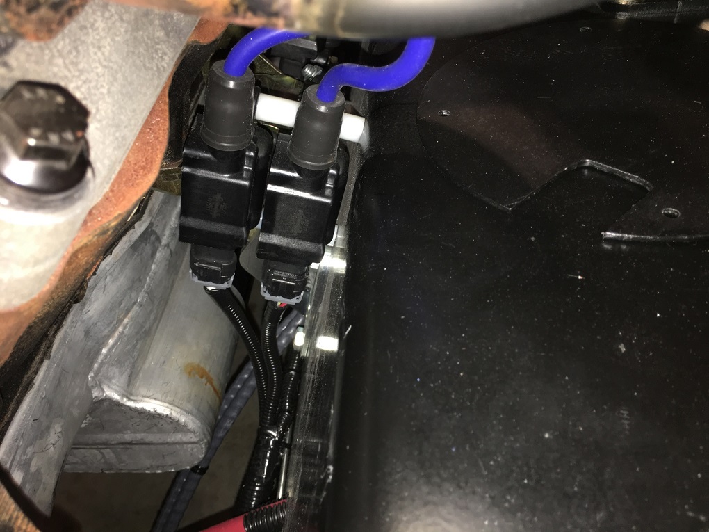

I wired the Fast XIM and Sportsman XFI ecu's that will control the fuel and spark for the engine. This was somewhat a pain in the rear since the harnesses are designed for a front engine car and they had to be cut and reconfigured so that I could have a cleaner mid engine install. I takes extra time but in the end it is worth it since the wires are hidden fairly well. I placed the coils (coil on plug like modern engines) down by the oil pan so that they are out of sight as well. I like a clean engine compartment where the main focal point is the engine (and in the GT40's case) the suspension and trans-axle.

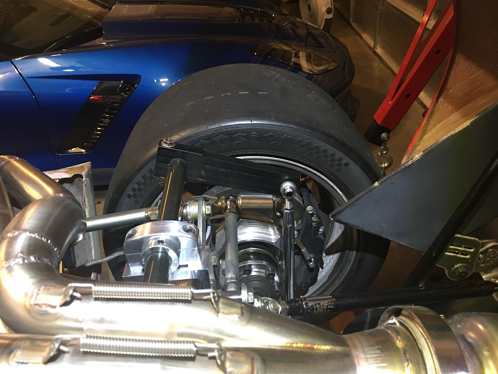

Installed the rear sway bar, I am still missing the front sway bar since October 2015, I have the other pieces for the front sway bar but not the bar. I do not think that it should take 2 years to get a sway bar but I guess that I am wrong (it must be made out of unobtainium). I had to rotate the oil cooler by 90° so that it would clear the rear deck and I added a brace but I still have to add another brace to it. I also rotated the fuel pumps so that they were horizontal which lowered all fuel componets so that a flat cover will cover them, I still have to make the cover. I replaced the RCR supplied shifter with a CNC Performance Parts shifter and transaxle adapter. I can select all gears with little effort and the shift is very smooth. I was having trouble selecting gears with the RCR supplied shifter but this may have been my fault more than the shifter's fault, I just couldn't get it adjusted perfectly. I had to make a larger plate since the shifter is wider than the RCR supplied shifter and I did not want to rework my fuel tank for a second time. At some time in the future I am going to shorten the shift lever by one inch.

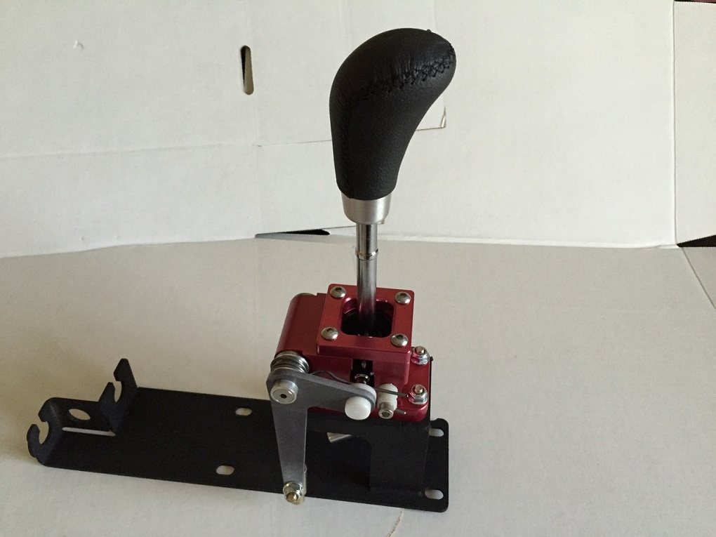

Nice. Good progress.
Did you take any photos of the shifter before you installed it?
I would like to see it as I'm considering other shifter options also.

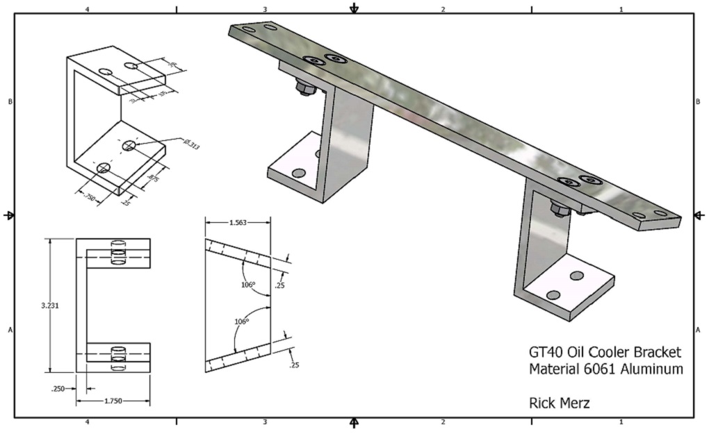

This post is in response to Mitch's questions.

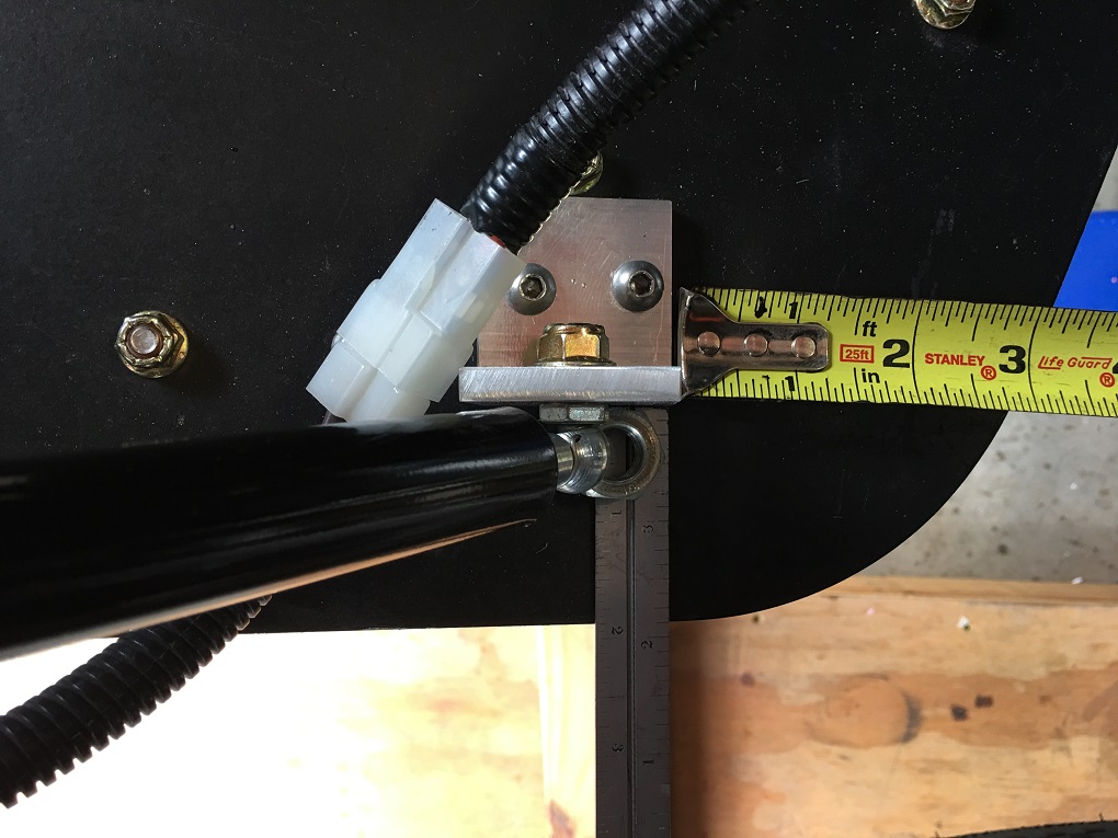

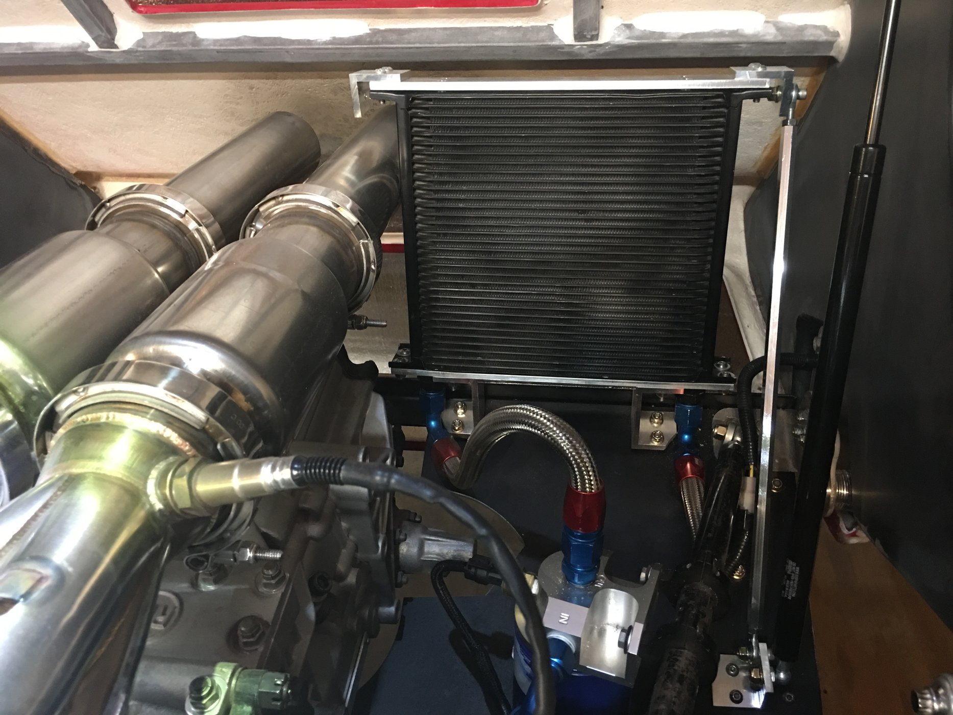

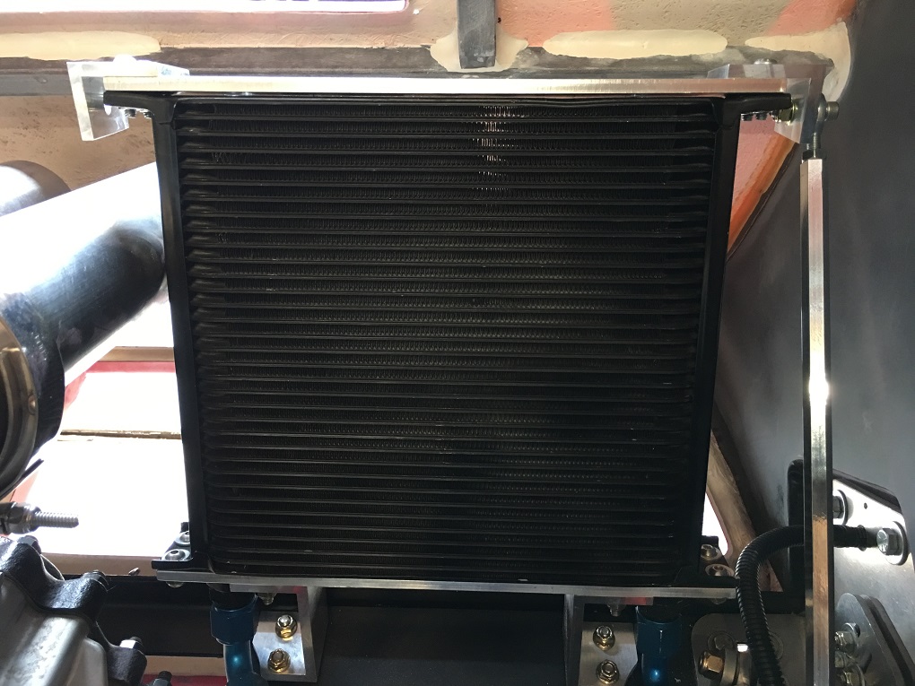

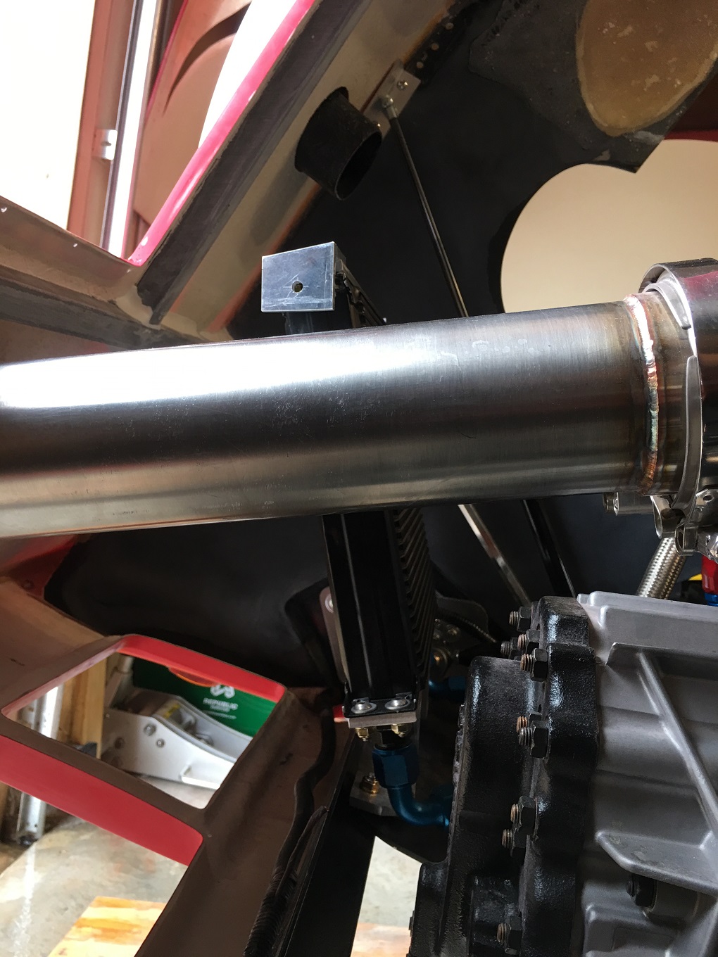

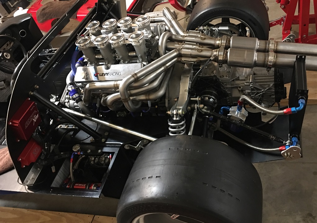

I angled the oil cooler to put the cooler parallel to the rear end fiberglass (slightly past vertical). I attached a pic of the bracket as well as a pic of the drawing for it.

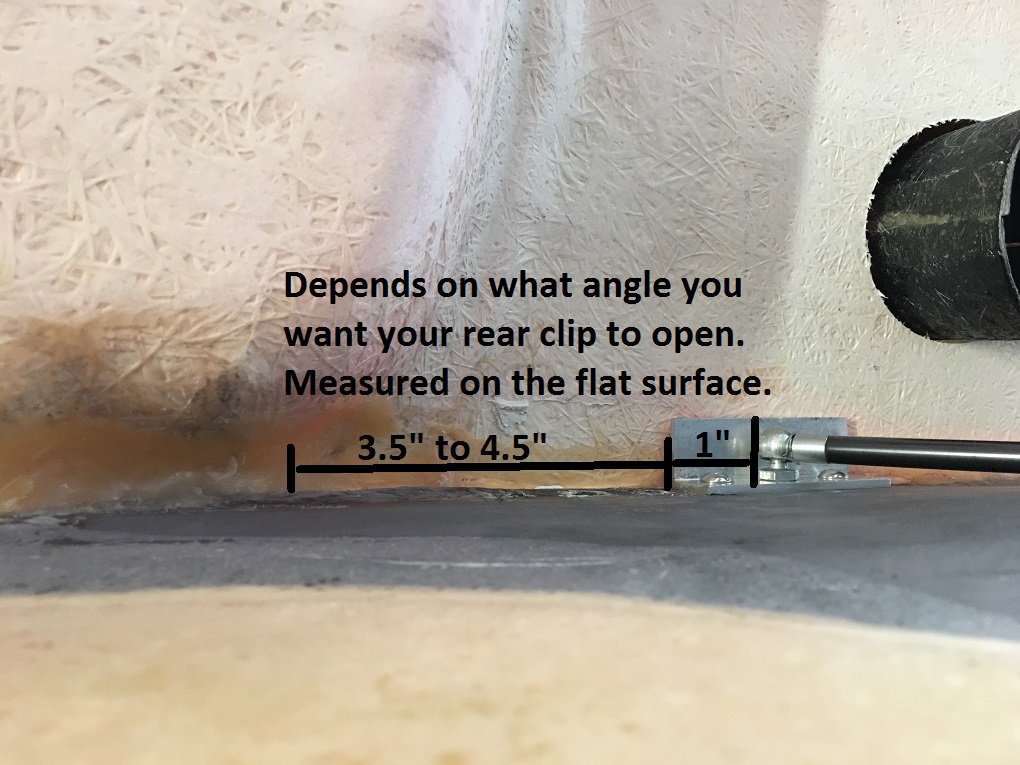

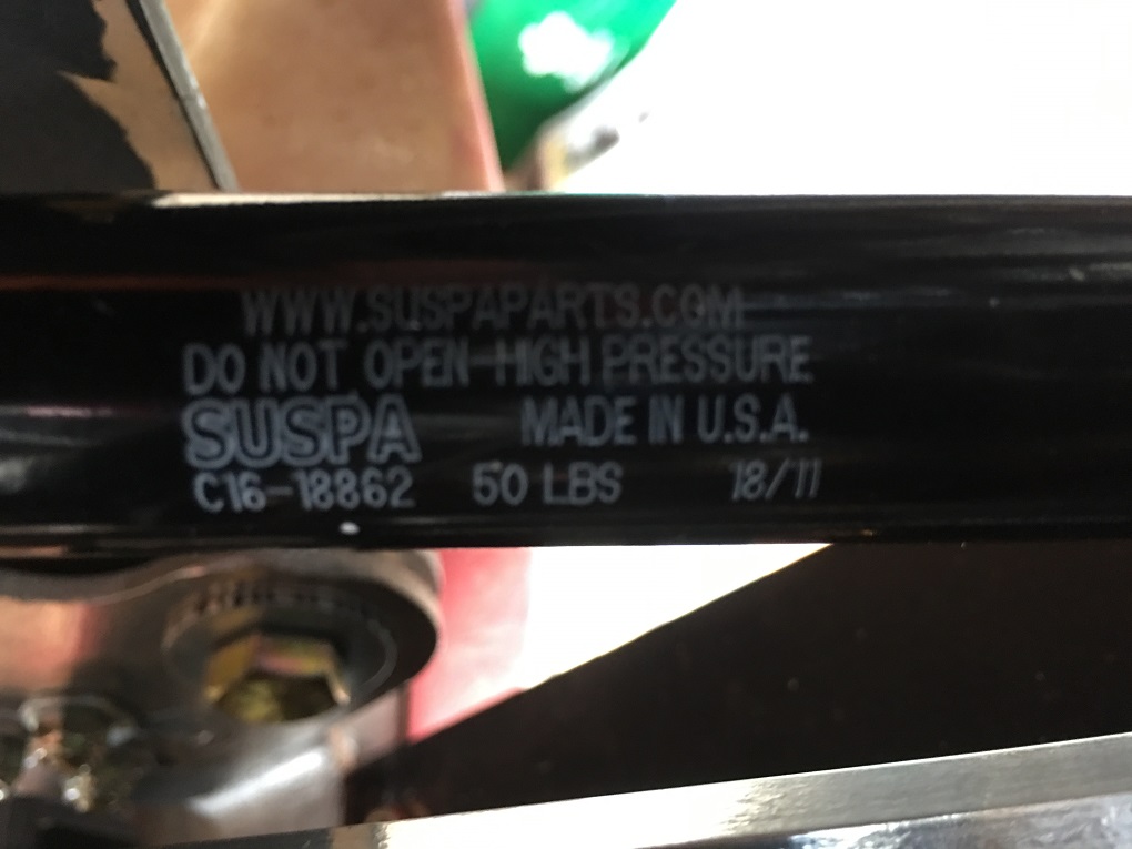

I purchased the nitrogen strut, end socket caps and ball posts from McMaster Carr, order strut 9416K21 @ $22.49ea. (select 50 pound), ball socket end (for strut) 9416K79 @ $3.58ea. and ball end stud 9512K63 @ $1.79ea. I attached them to the clip with a 1"x1" aluminum angle that was bolted to the inner wheel well where it meets the rear deck and it was epoxied to the top of rear deck as well. Worth noting is that you need to stiffen the under tray since it will flex when the clip is opened. I accomplished this by bolting two 1" x 1" aluminum tubes to the underside of the under tray, the holes in the tube are counter sunk so that the under side is clean looking.

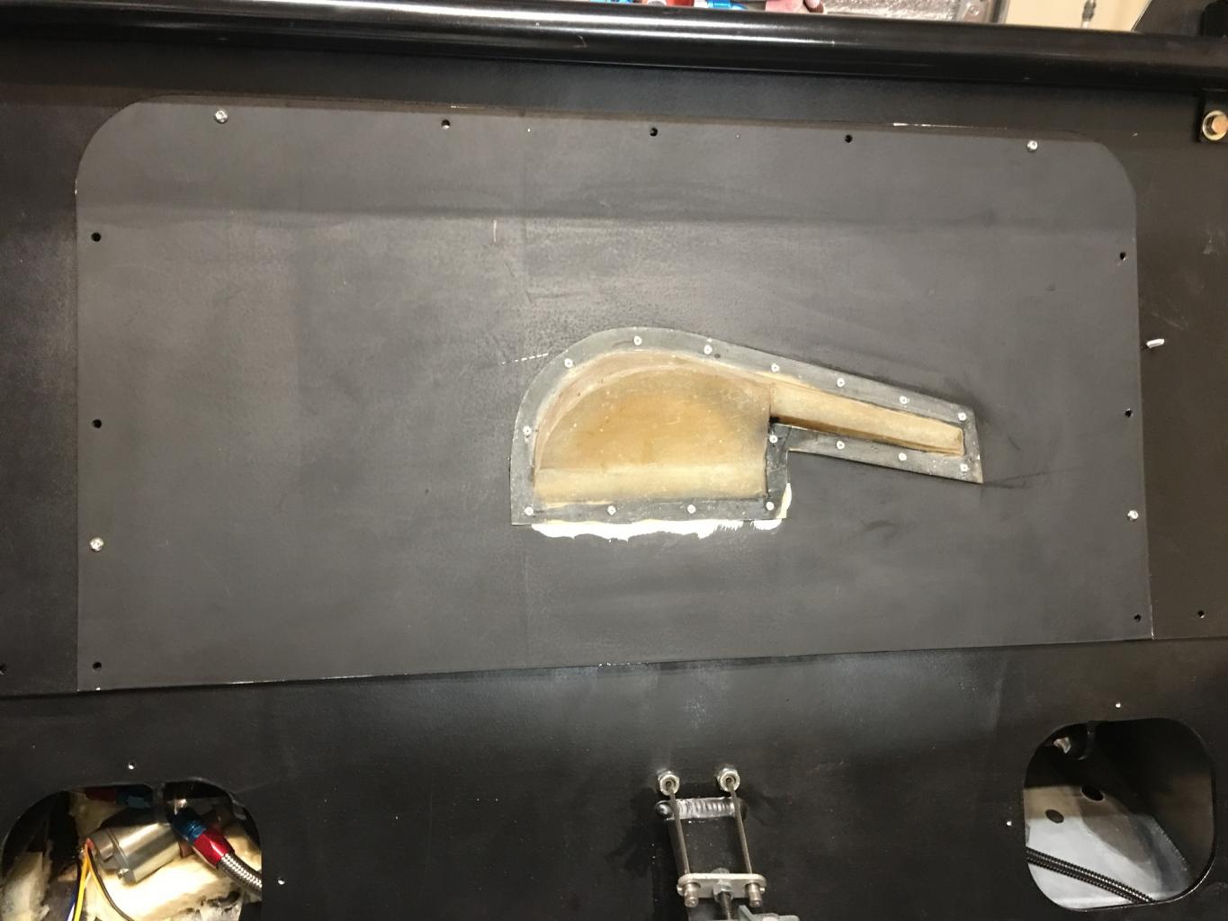

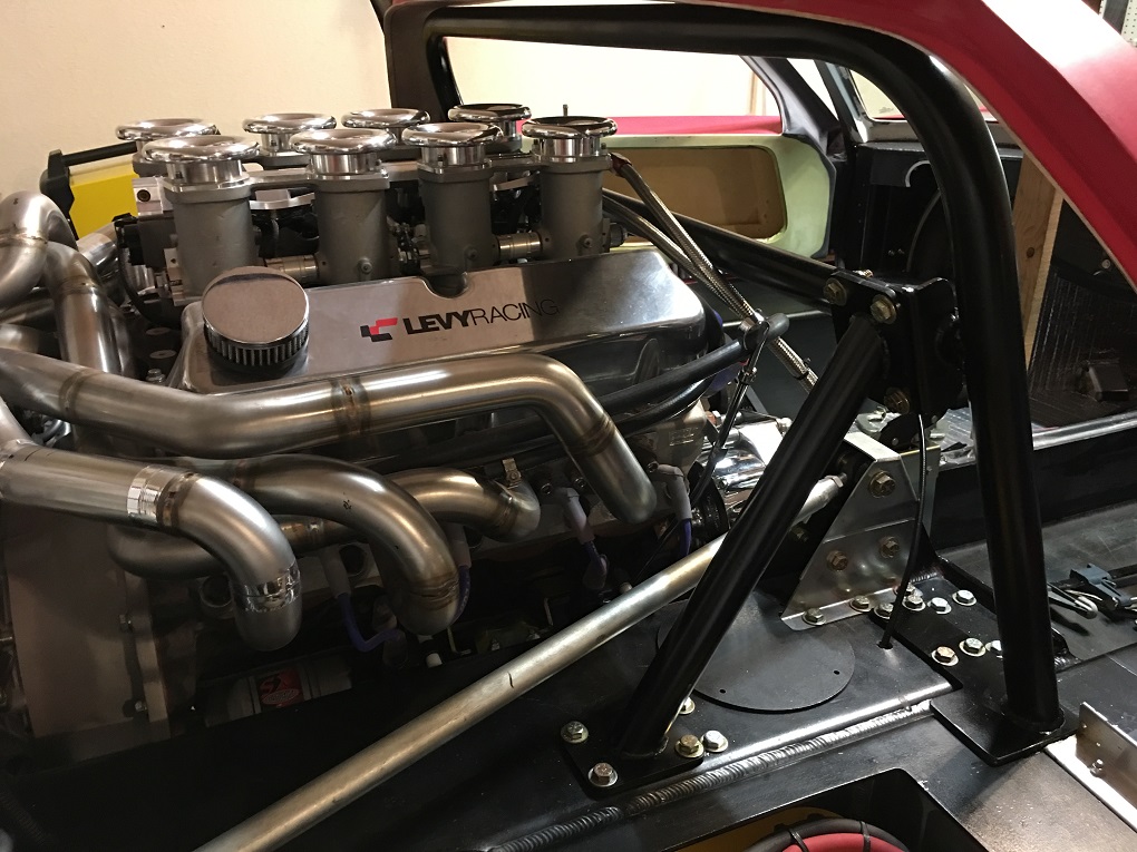

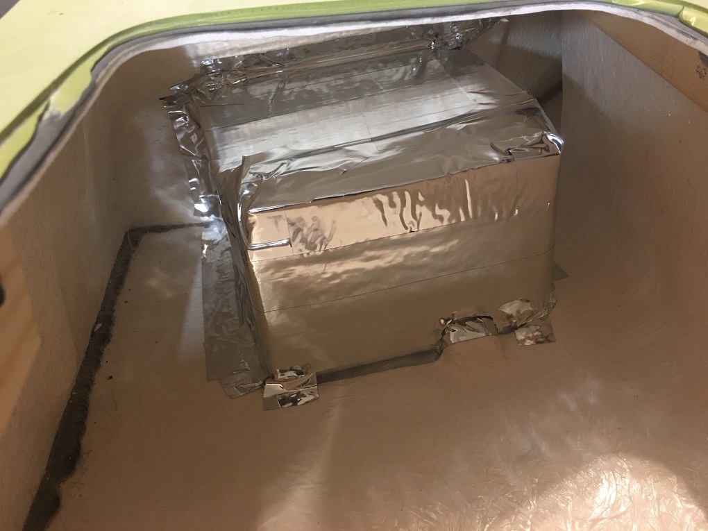

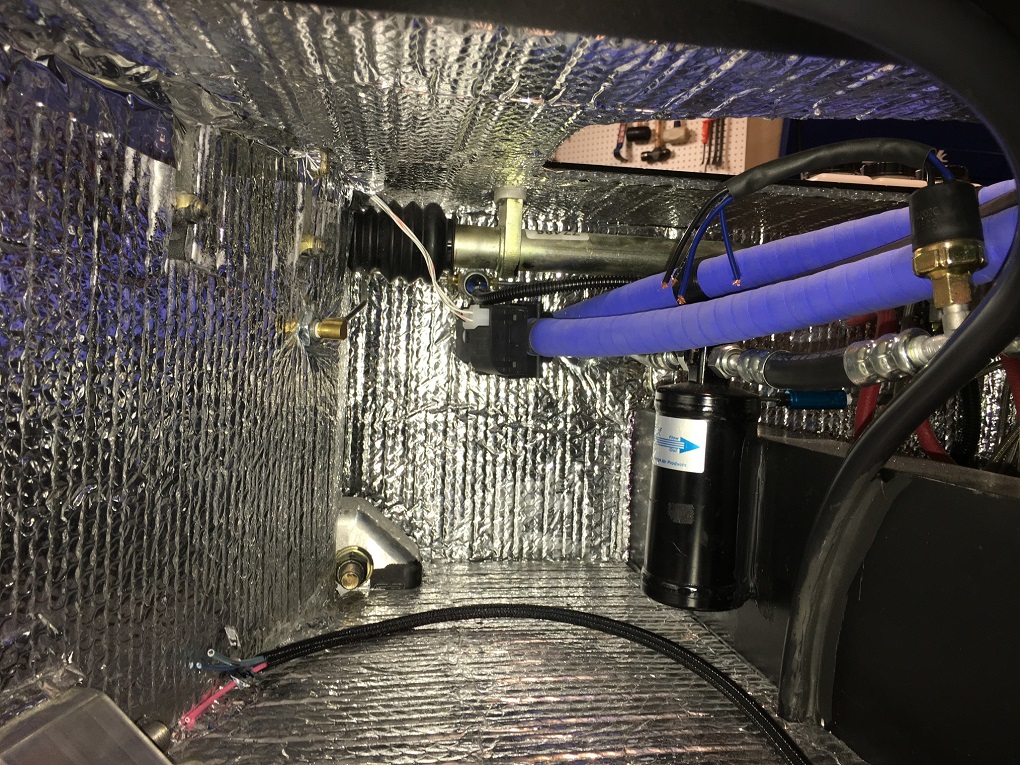

I decided that I did not want the roll bar inside the cockpit where it is right behind my head. To move the roll bar behind the bulkhead required grinding the weld on the horizontal brace so that I could lower it about 2", care must be taken to only cut the weld and not gouge the roll bar. I wanted to lower the brace because I wanted to position the rear window a little lower. I had to cut off the mounting pads and shorten the braces as well. With the bulkhead in place I clamped the roll bar in place with the mounting pads under the roll bar. I clamped the horizontal bar in place and checked everything for plump and level, then everything was tacked together except for the rear braces. I removed the roll bar and had it welded then I painted it, reinstalled the roll bar and fit the rear braces which had to be shortened. I determined the length by cutting the braces in half then holding the two halves next to each other while the ends were touching the roll bar mounting pads and the monocoque I marked the overlap and cut on the marks, tacked them together and had them welded, I painted them and then bolted them to the bar and car.
Fran was kind enough to supply a new bulkhead with the rear window cutout and mounting screws deleted so that I could customize it to my taste.

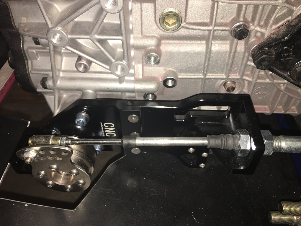

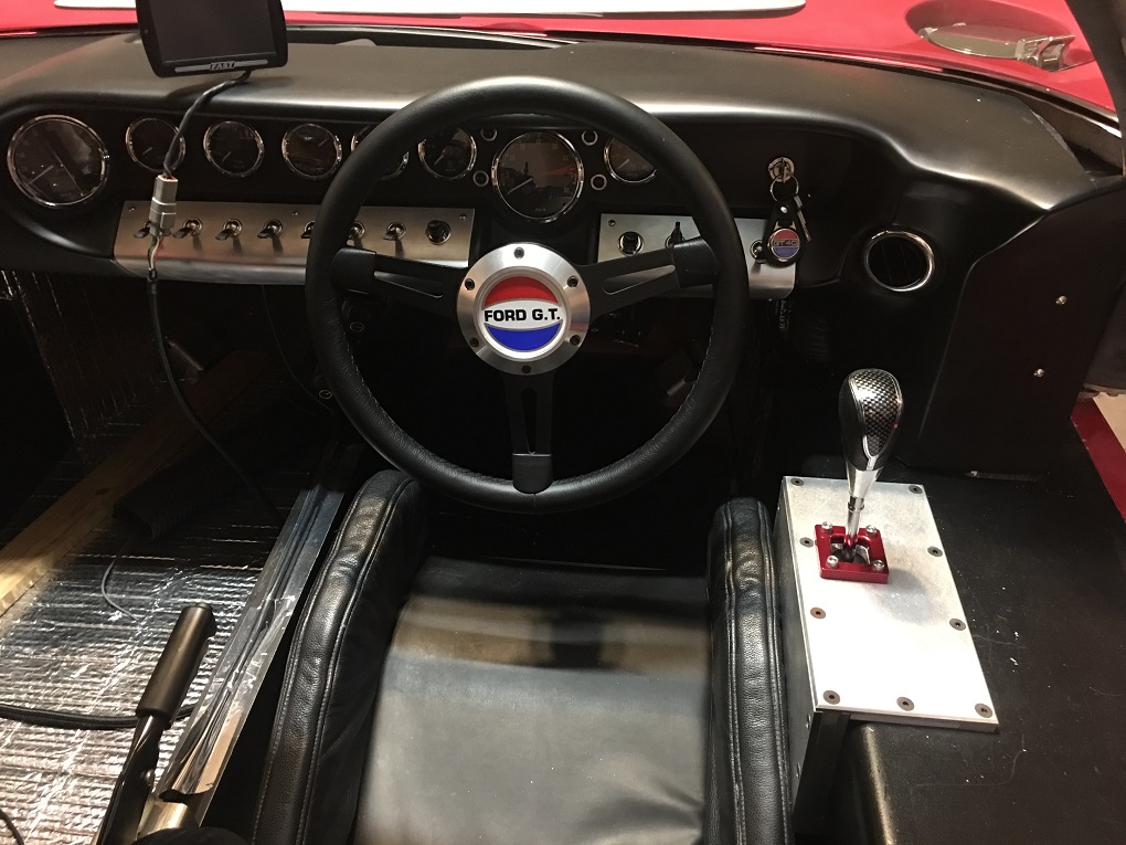

Bill Kearley
Same shifter set up I have, nice stuff, hope it works as good as it looks. My cables are in and complete and things feel a bit stiff, hope things loosen up with some use.
Rick Merz
I have only made a short drive, about 4 blocks, and it shifted perfectly. I can shift it without the car running into every gear without any problem, I could not do that with the previous shifter. I does look good but I am going to change the shift knob, just not sure to what yet.

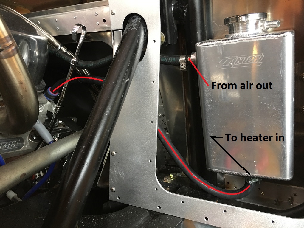

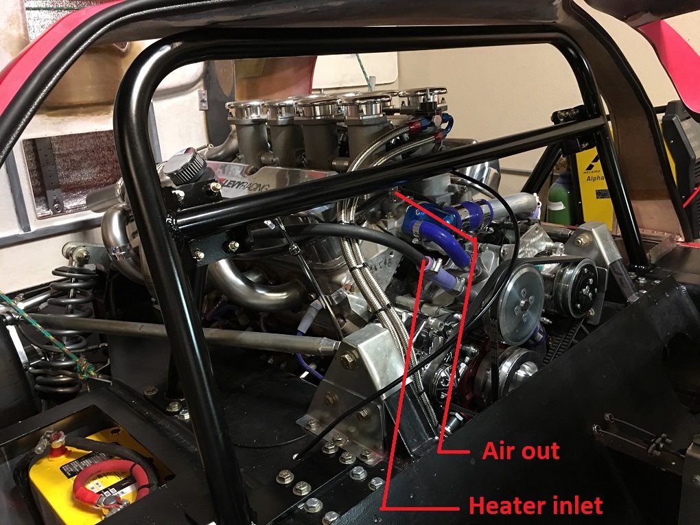

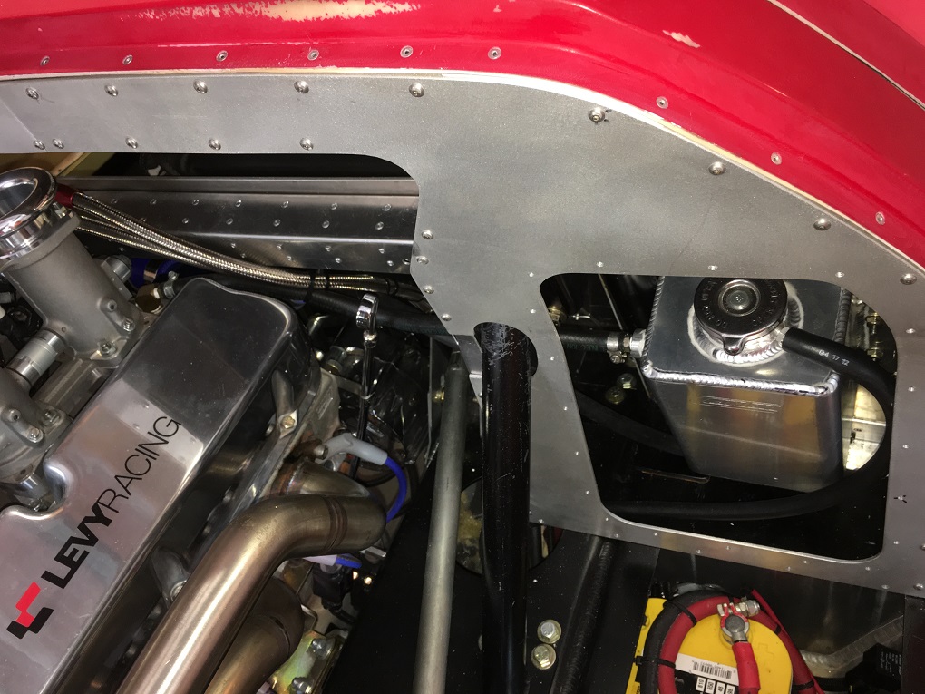

The lines to the heater inlet and the air out from the top of the manifold go to the expansion tank. The heater inlet hose goes to the bottom of the expansion tank outlet hose barb and the air out from the manifold goes to the top inlet hose barb on the expansion tank. This will allow the air/water to be pulled from the top of the manifold and fed to the suction side of the water pump (return from the heater if connected to the heater core). This allows air to be continuously purged from the cooling system. A tee could be added to the air out from manifold hose so that a hose could be run from the radiator bleed to the top hose barb and continuously purge air from the radiator as well. I do not use this connection since once the radiator is manually bled it usually stays free of air. In the first attached picture the hoses appear to be running to the rear of the engine, I placed them that way just to keep them out of the way when I was designing the rear bulkhead, there is a front and rear bulkhead on my GT40, more about that in my next post. :)

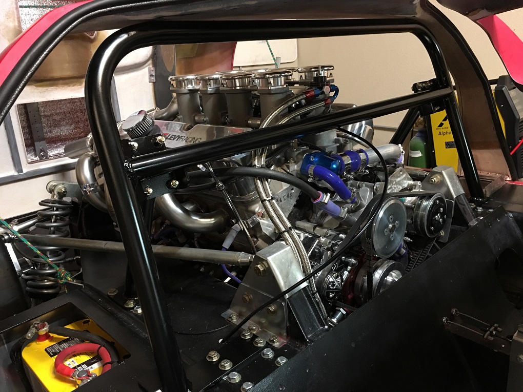

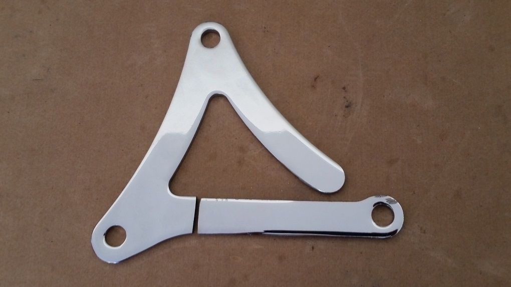

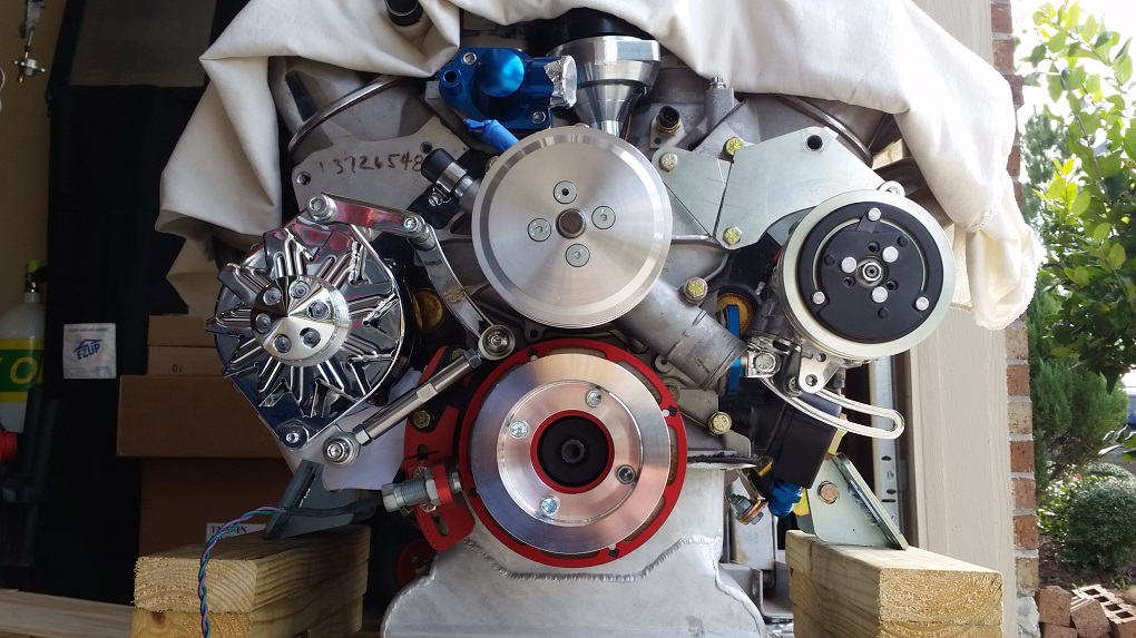

I made my own alternator bracket, I purchased a Dodge Charger bracket and cut it apart, I also purchased an adjuster for the alternator, both from ebay. Picture was taken when I was mocking up my alternator bracket (modified RCR supplied bracket).
I routed the top heater hose to go to the left side and wrap around the air conditioner compressor and down to the bottom center of the engine then a 90° bend turns it to be inline with the center tunnel. The other radiator hose is on the lower left side and curves down with a 90° turn to line up with the center tunnel, both hoses going to the tunnel are directly on top of each other as are the tubes in the center tunnel.

I routed them through the tunnel and connected them to a bulkhead pass through. When I installed my engine I thought that it was too busy at the front of the engine so I removed the heater hose pipes that I had wrapped and I will tee off of the front radiator hoses in the future. Attached picture shows when the heater hoses were run through the tunnel, also attached a picture of the hose routing under the dash.

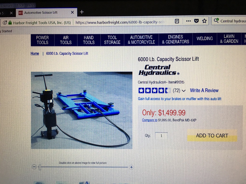

I have a Central Hydraulics 91315 56" lift (6,000 lbs) from Harbor Freight, VERY helpful and only $1,500. I removed the arms and built 2 x 4 and plywood ramps to get over the lift with the GT40, with the ramps you could leave the arms on but since the GT40 is flat on the bottom you don't need the arms.

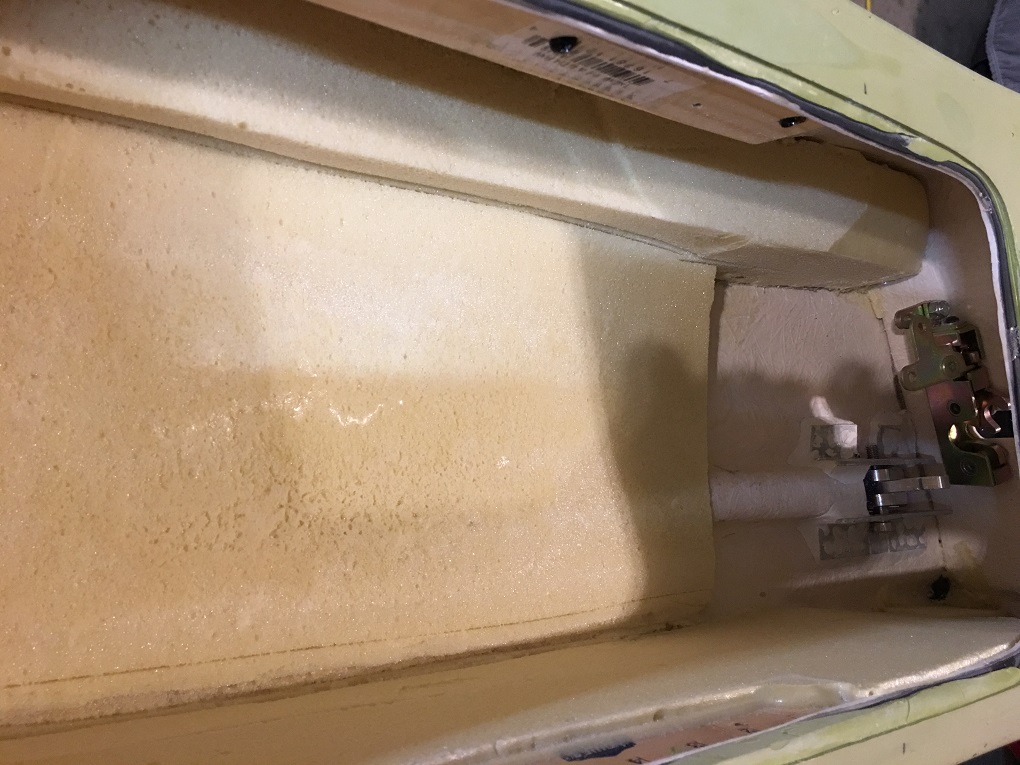

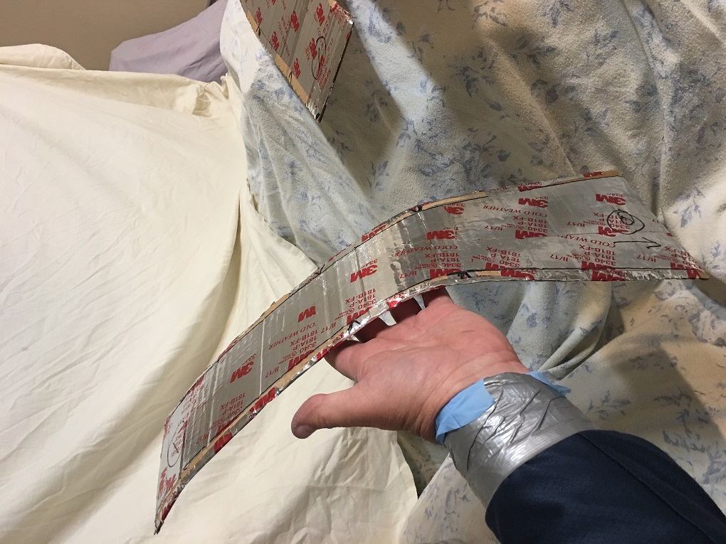

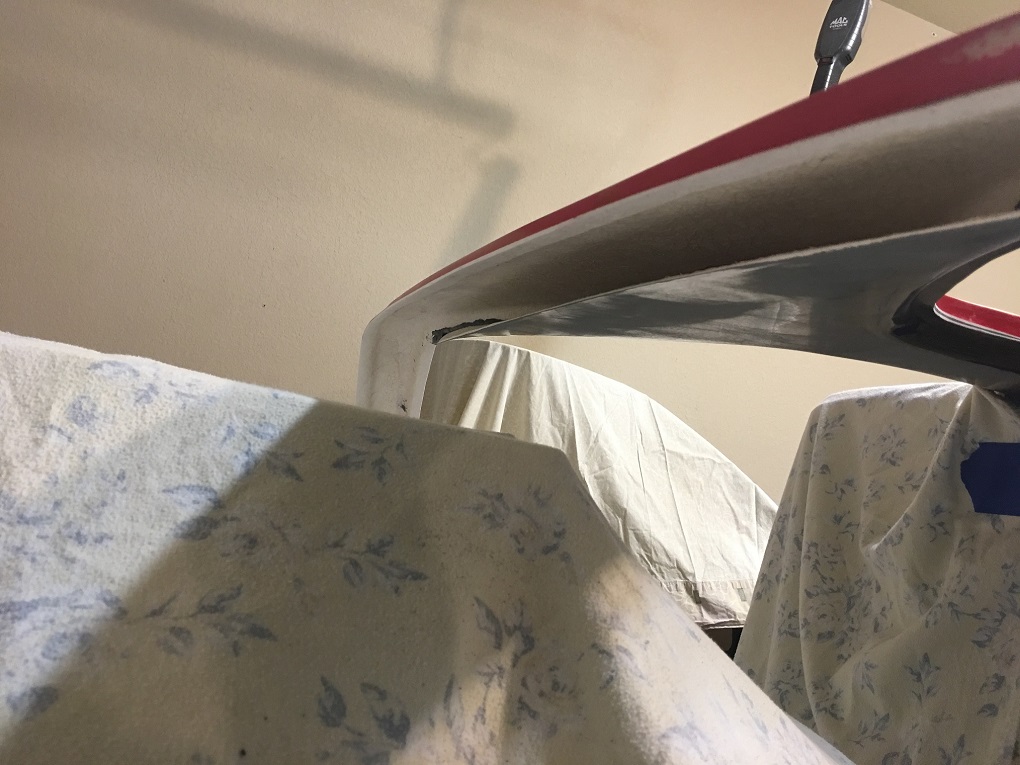

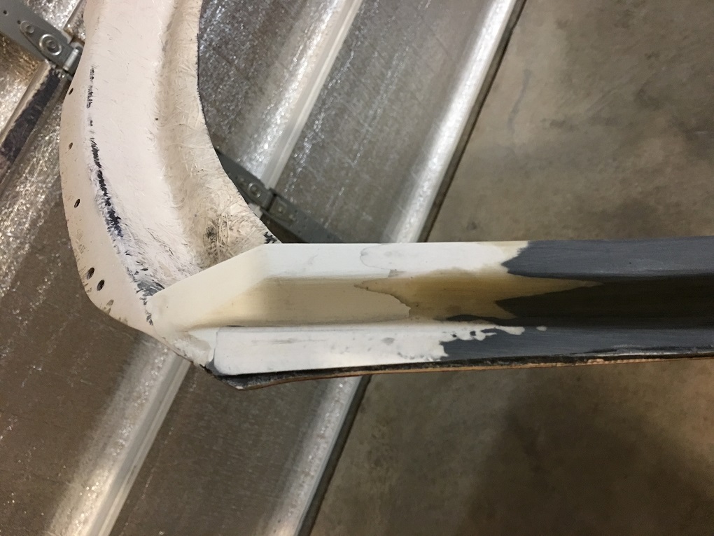

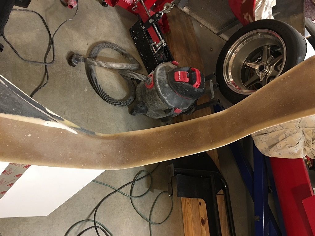

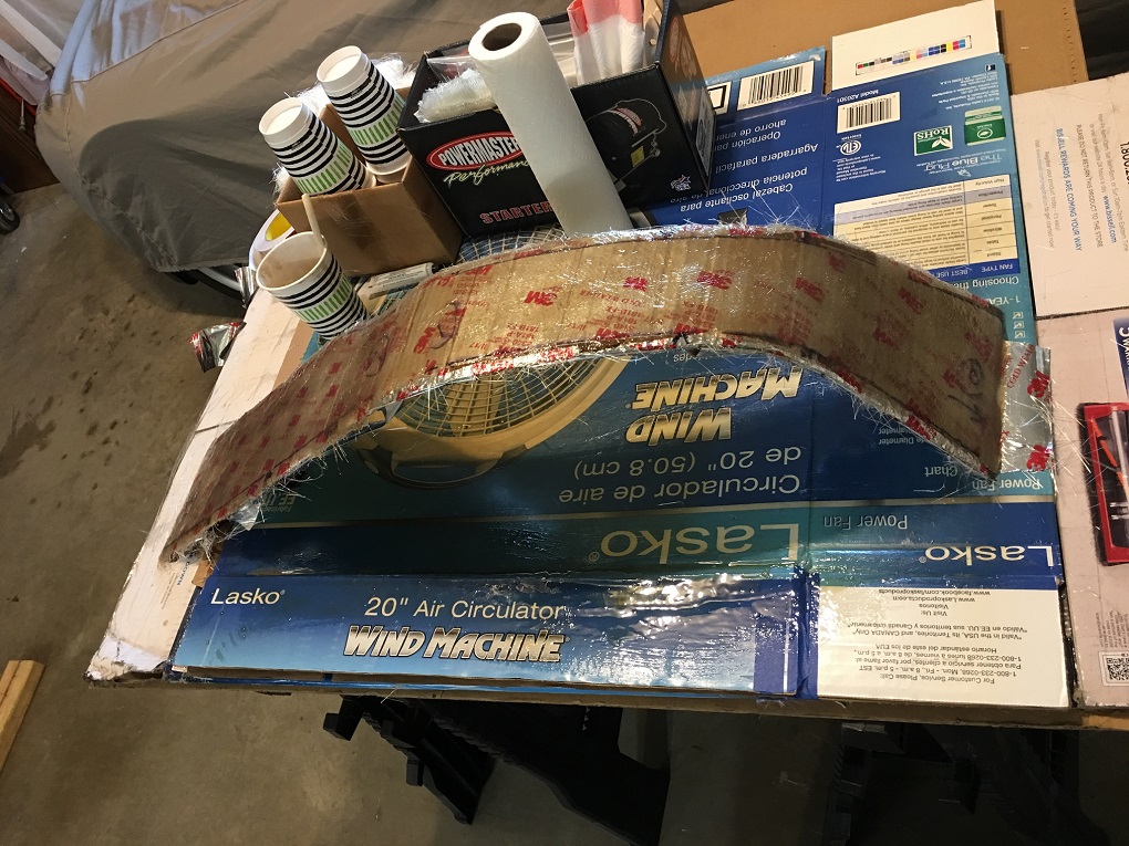

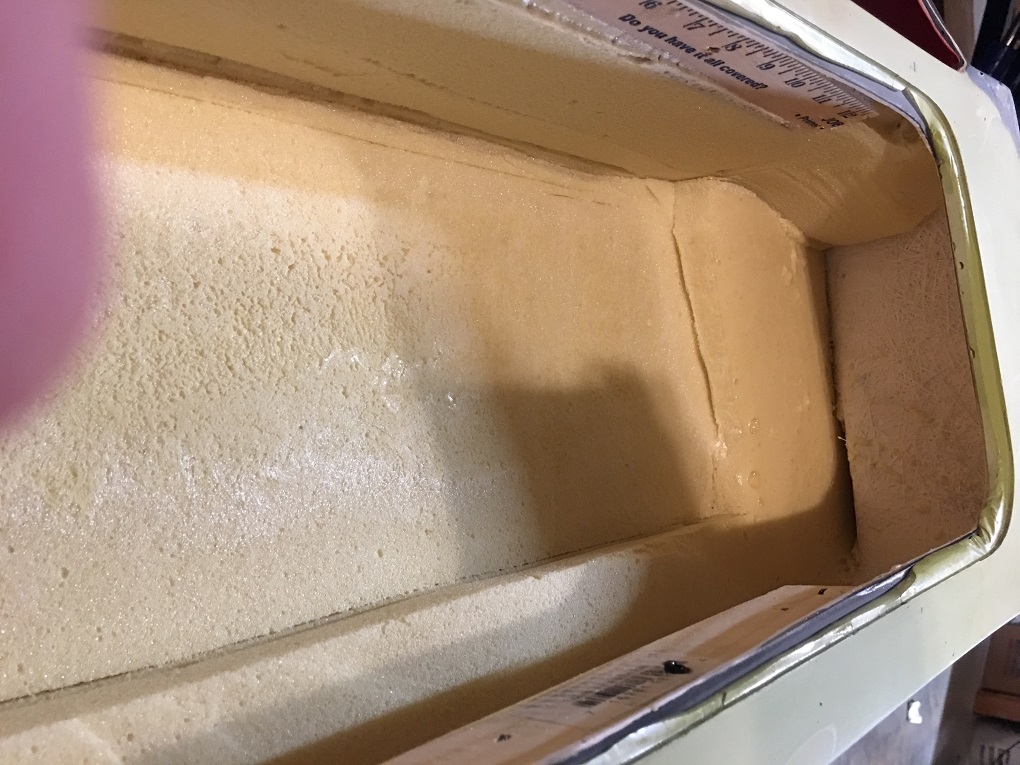

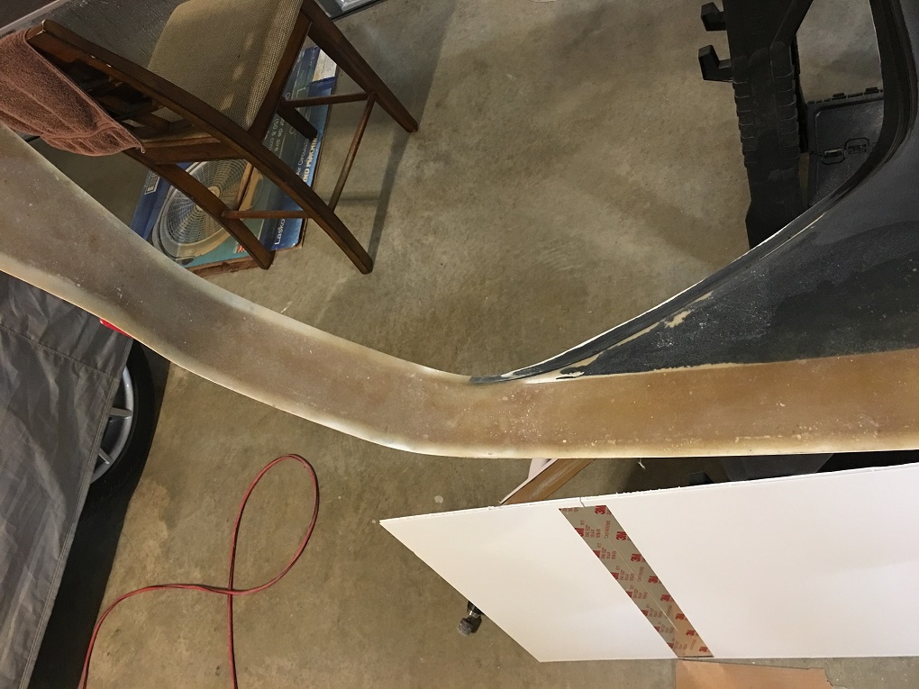

I decided that I wanted to stiffen the spider by closing the "A" pillars with fiberglass and filling the space between the roof and inner panel with expanding foam similar to how Tom did his roof. I used 3 layers of cardboard to make the molds, the 1st layer is bent to shape then I added a 2nd layer (bent to shape) with aluminum duct tape and then I added 3rd layer (bent to shape) with aluminum tape. To finish the mold a layer of aluminun duct tape was applied to the side that will receive the fiberglass and expoxy since the cured fiberglass will not bond the the aluminum tape. This method will make a cardboard mold that will retain its 3D shape. I laid up 4 layers of fiberglass mat onto the molds, and clamped (light load as to not squeeze the resin out of the fiberglass just enough pressure to hold the molds in place) the molds to the "A" pillars. I did this work with the spider in place to ensure that it would stay in the correct shape and I was too lazy to remove the engine since I felt confident that I wouldn't make a mess :). After curing I removed the molds and removed the spider and sanded the fiberglass smooth. I added an additional 2 layers of fiberglass mat and sanded it smooth again. I bolted the spider onto the car and was able to stand on the rear area of the roof without any movement (I weigh 245 lbs). I filled the roof cavity with foam as Tom did since the foam will add structrual ridigity and it will make the interior cooler and quieter (the door tops, door window frame and outside skin have been filled as well). The doors shut with a firm solid sound now and total weight added was about 12 lbs (roof and doors).
