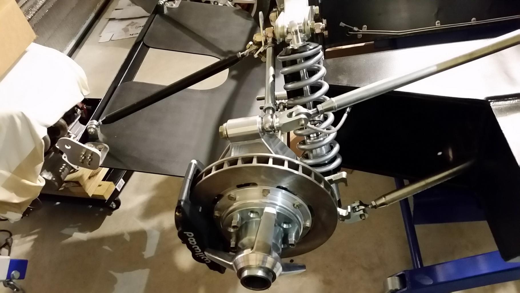

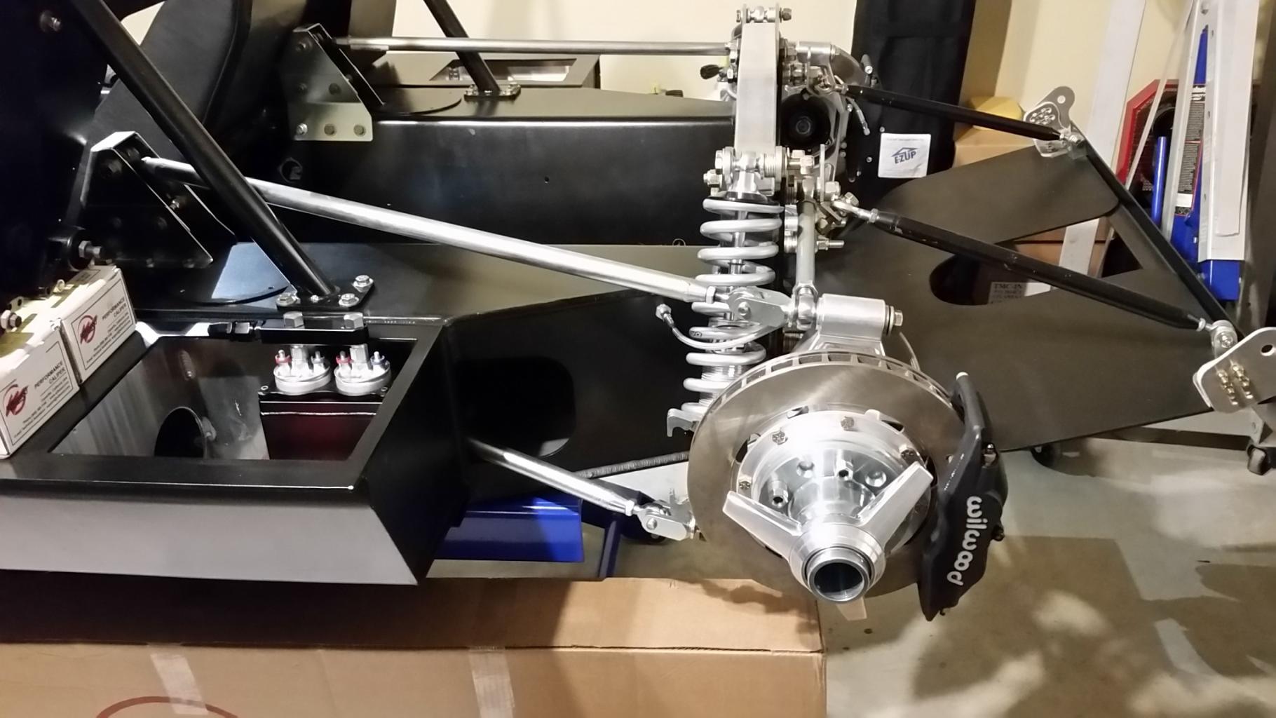

Installed the suspension and brakes with the exception of a couple of bolts and spacers that are needed for the transaxle mount and emergency brakes. I will corner weigh and make final adjustments to the suspension when the car is completed.

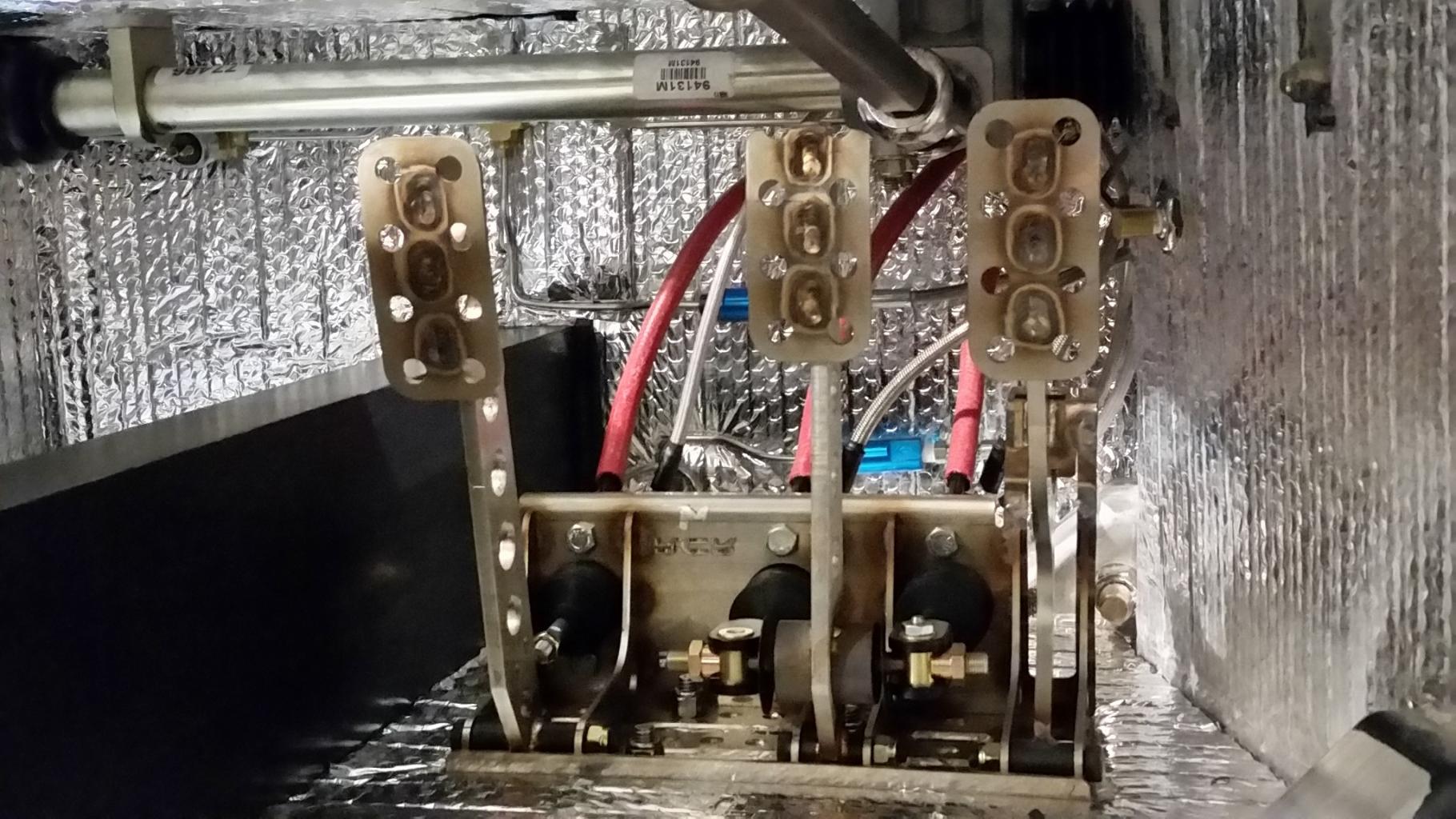

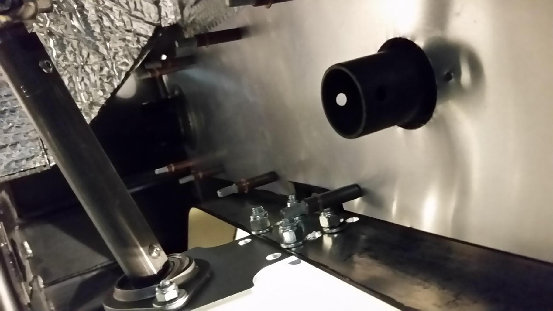

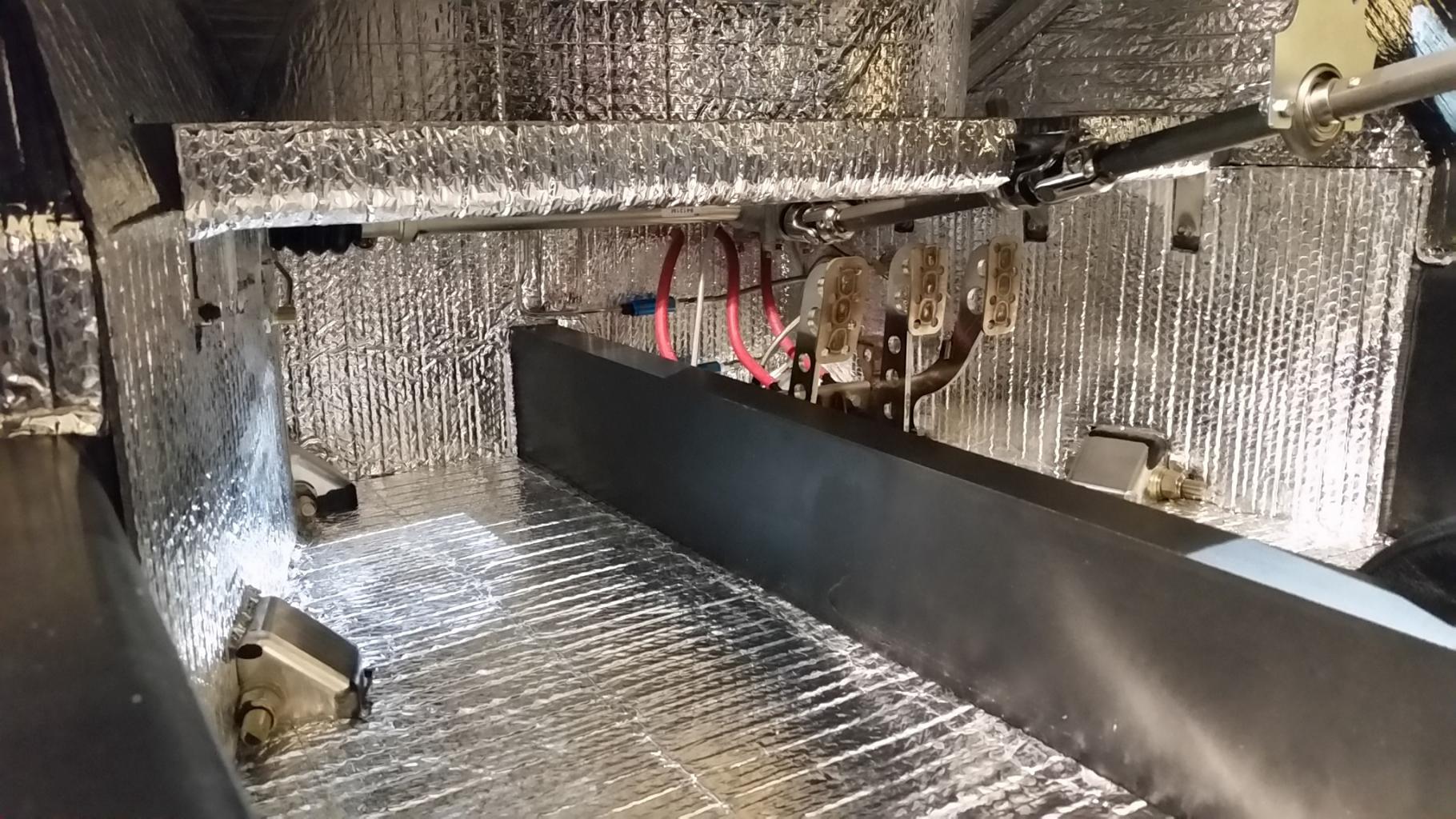

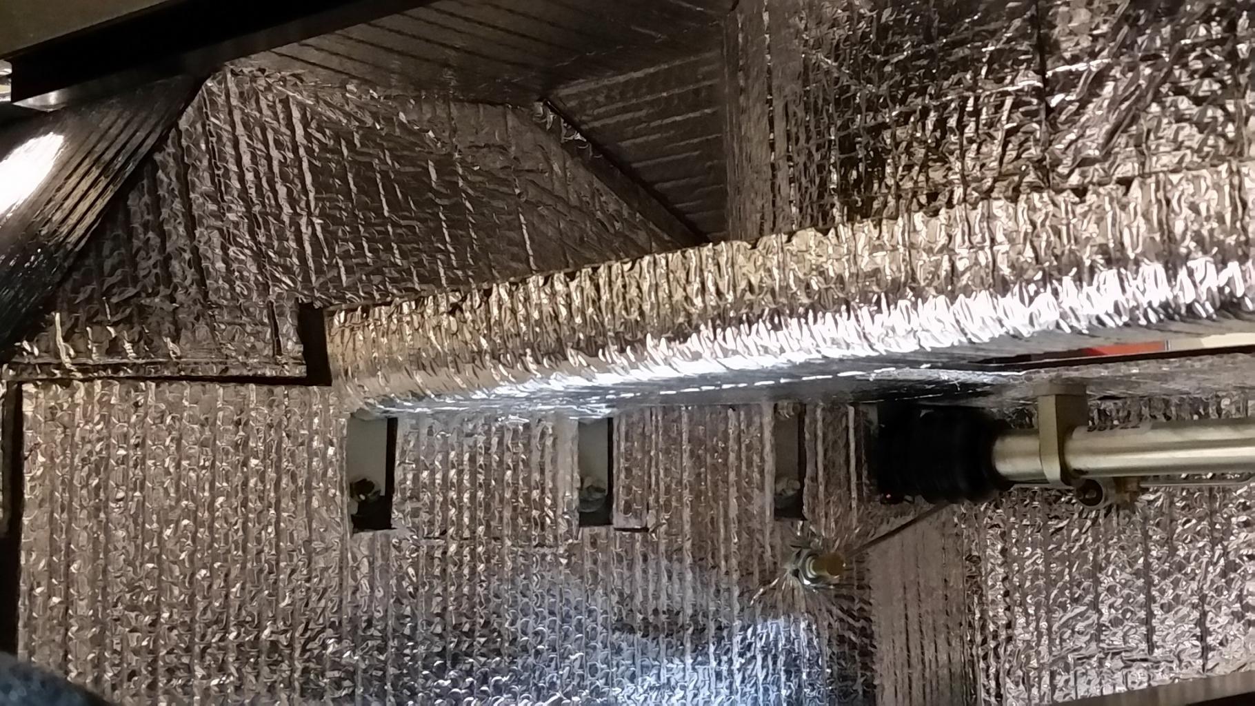

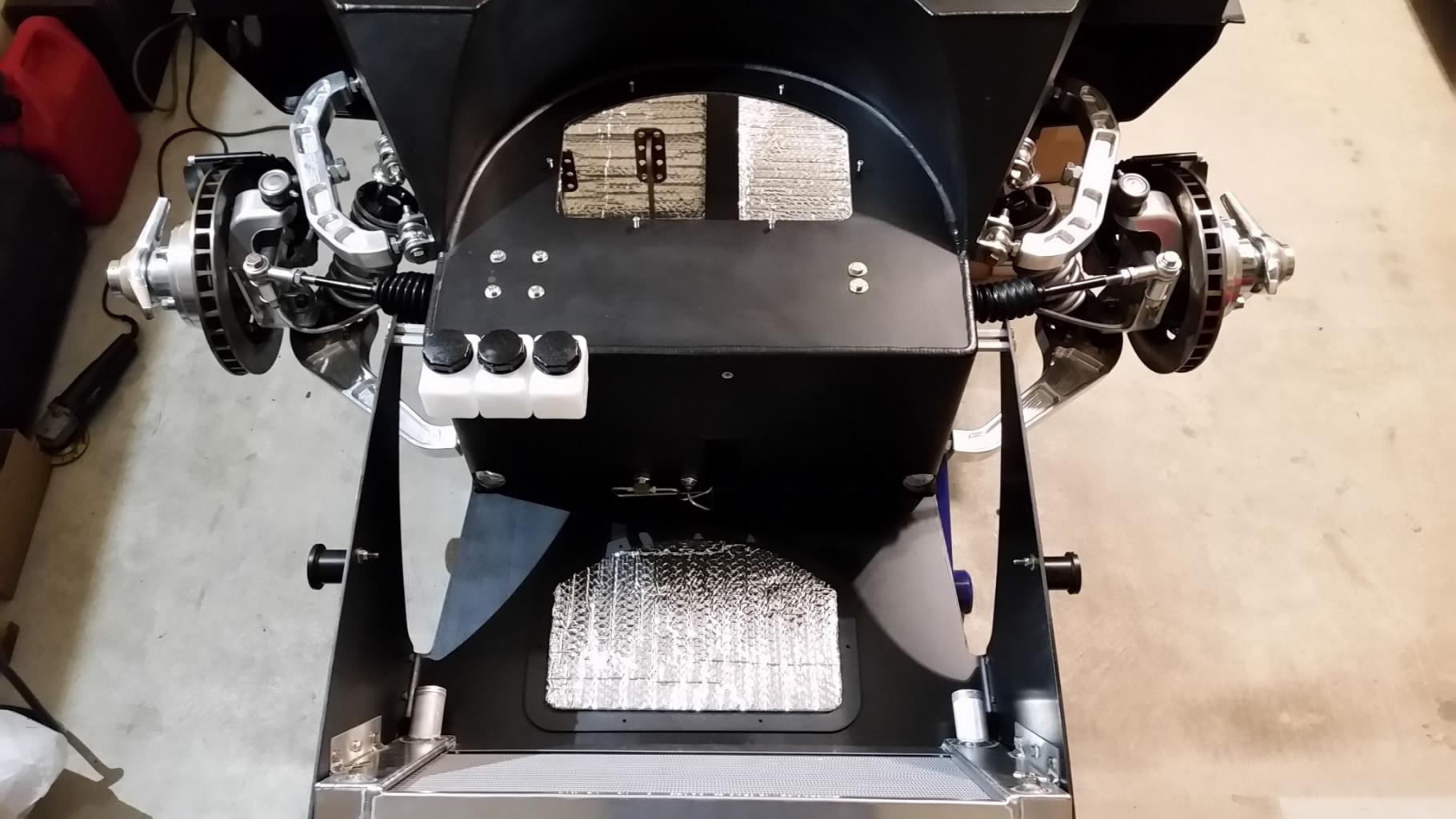

Insulated the front half of the tub and installed the pedal box and steering shaft. I insulated the complete front end to ensure that the air conditioner does not have to work any harder than necessary. A cool car is important to me.
I ran my GTD 40 on the track with the AC on since I would rather change the AC compressor than sweat. I was at Gateway in July for Run and Gun 16 many years ago when after a 25 minute heat I got out of my GTD 40 and complained that my car was too cold in front of another gentleman who was sweating profusely as he replied "you race with the AC on? It uses too much horse power and it's hard on the compressor.", to which I replied "of course, I don't want to get hot and I have plenty of horsepower. If the compressor fails it will only cost about $150 to fix it." BTW the AC compressor never failed even after many track day events and about 20,000 miles of use.

Rick Merz
Tru, It is TempShield® Brand Double Bubble Foil. It has two layers of 1/8" barrier bubble film laminated between two layers of metalized film. TempShield® Double Bubble Foil is designed to be used for water heater, metal and commercial buildings, stud walls, roofing systems, basements, and crawl spaces when reflectivity and higher R factors are required. I use it on my garage door and it works very well to stop the Texas sun from turning my garage into a sauna (my garage door faces West).

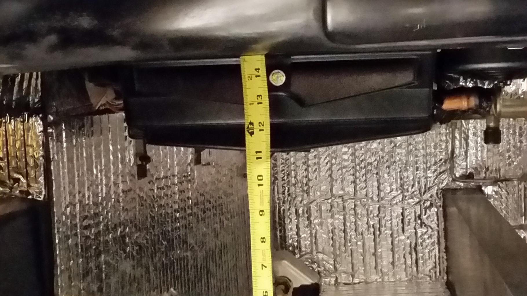

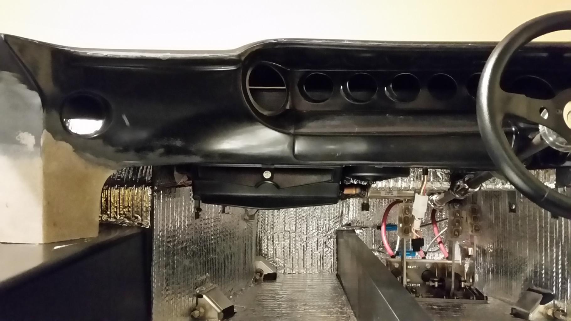

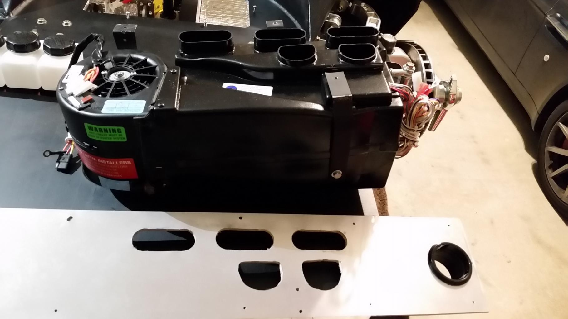

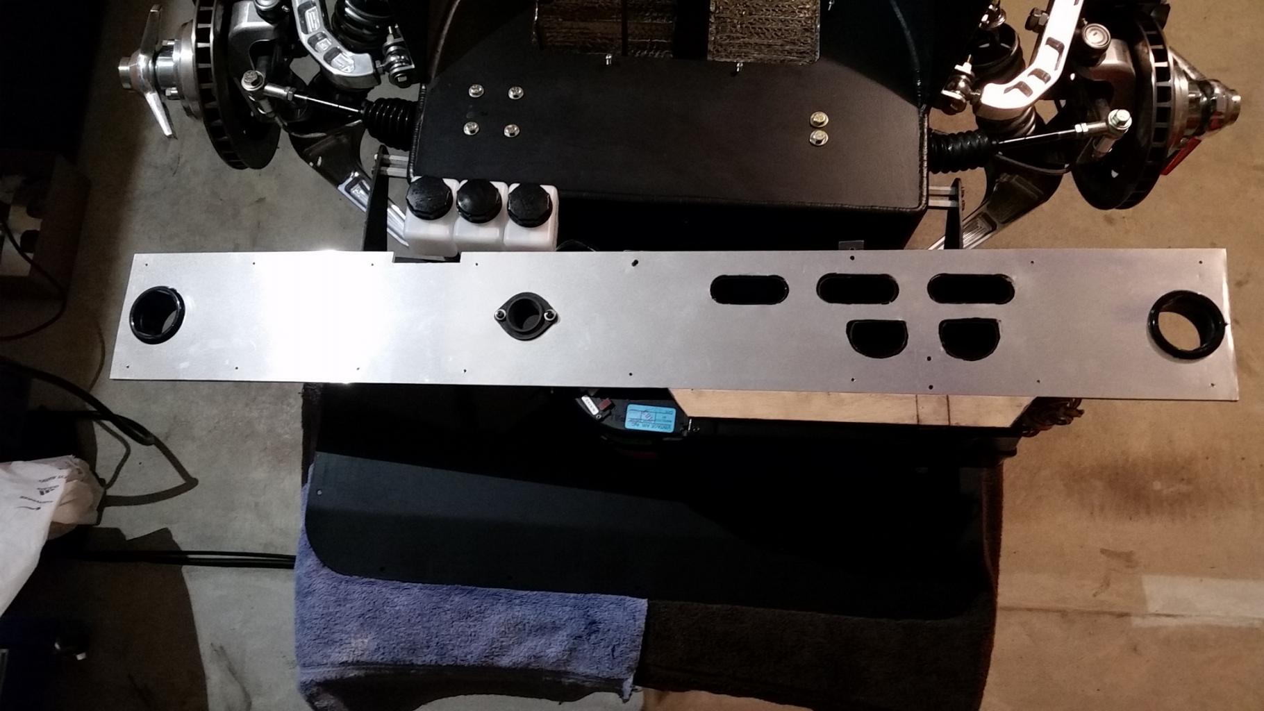

Installed the a/c unit: I used a piece of 1/4" plywood and glued a sheet of .0625 aluminum to both sides to make a bottom for the (2) 1" square tubes used to strengthen the dash area so that I could make a plenum for the a/c unit. I did not want to cut the 1" tubes and weaken the structure. The new plenum will supply air to the dash demister, (2) ball vents and a third vent that will point down in the center of the car. The ends of the plenum were closed off after the bottom was put in place. There is about 11.25" of clearance under the a/c unit which is about 1" less than if I would have cut and removed a section of the 1" square braces and bolted it to the dash and used the RCR supplied plenum. I tested clearance by sitting in the passenger seat and there was plenty of clearance. I hope I never have to sit on that side again, it felt so strange. :)

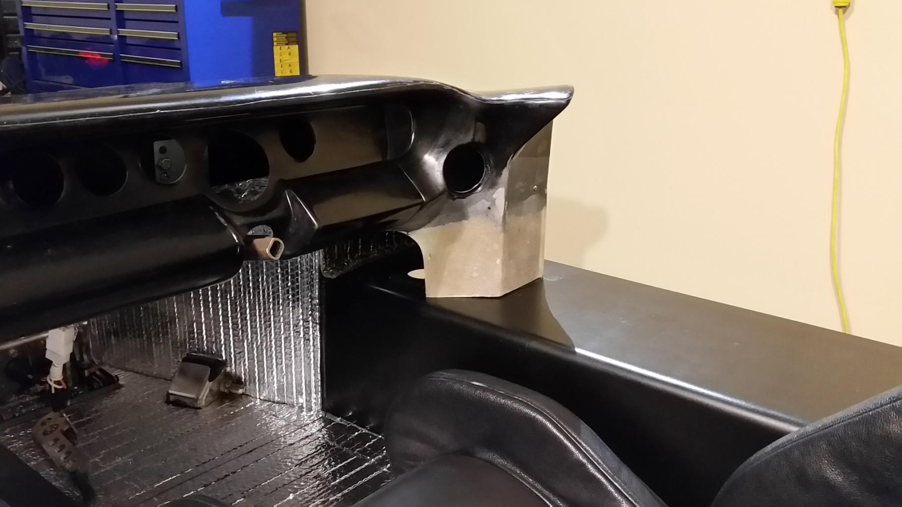

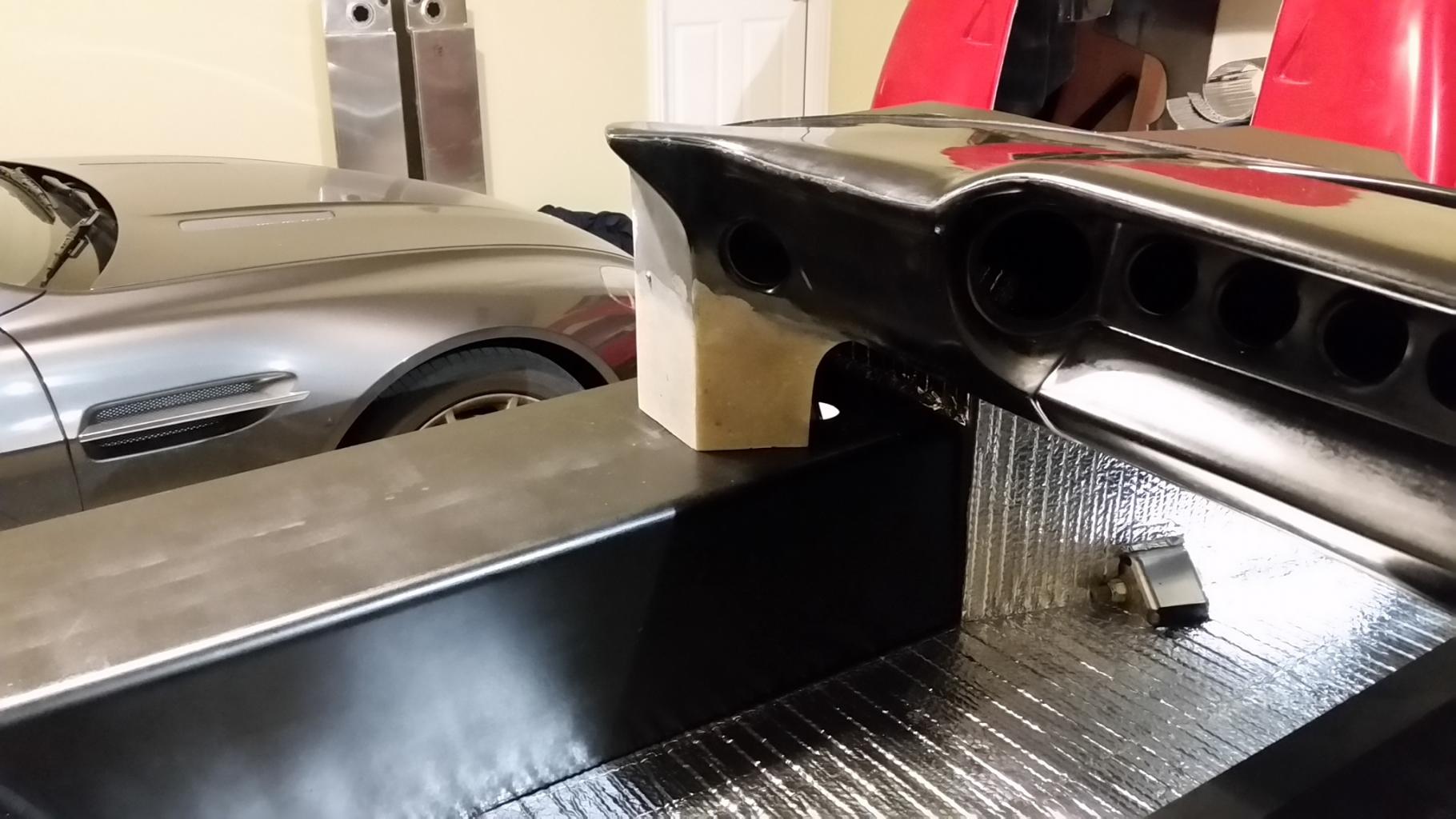

The RCR supplied dash for the right hand drive cars do not go down to the sill, they are about 4" short. I fixed this since I think that the dash looks better if it goes down to the sill and it helps to hide the fuel fill lines. I made a mold using cardboard covered with aluminum foil tape (HVAC tape) I also covered the sill with aluminum tape since the cured fiberglass will release from the tape. After removing the dash with the first couple layers of fiberglass I laid 3 more layers of fiberglass mat to the back side then rough sanded both sides and finished the front side with 2 layers of mat and finish sanded to shape. I am not a professional by any means but the end result will look good. I may do more work on the dash since I want it to look better when the spider is in place, that project will be done a few weeks from now.

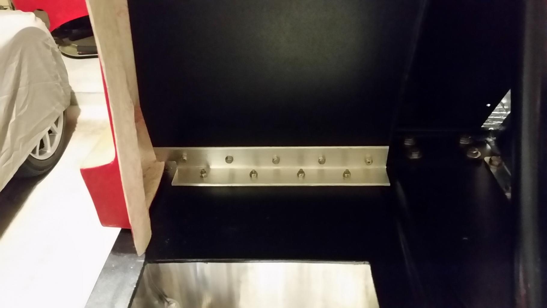

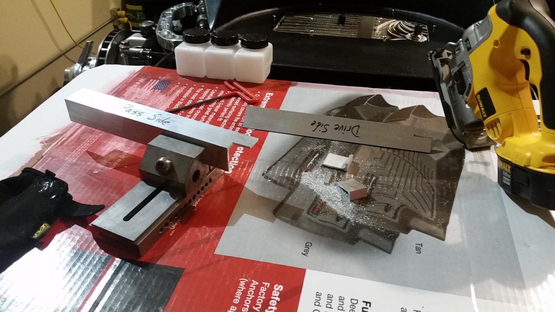

Attached the rear bulkhead to the side sponsons. Pretty straight forward just measure and cut the aluminum angle and drill and tap holes to bolt the angle to the bulkhead and the sponsons.

Tru, The bottom of the plenum is 1/4" plywood laminated with 1/16" aluminum on both sides. I will insulate the bottom of the plenum and the top of the dash as well.
