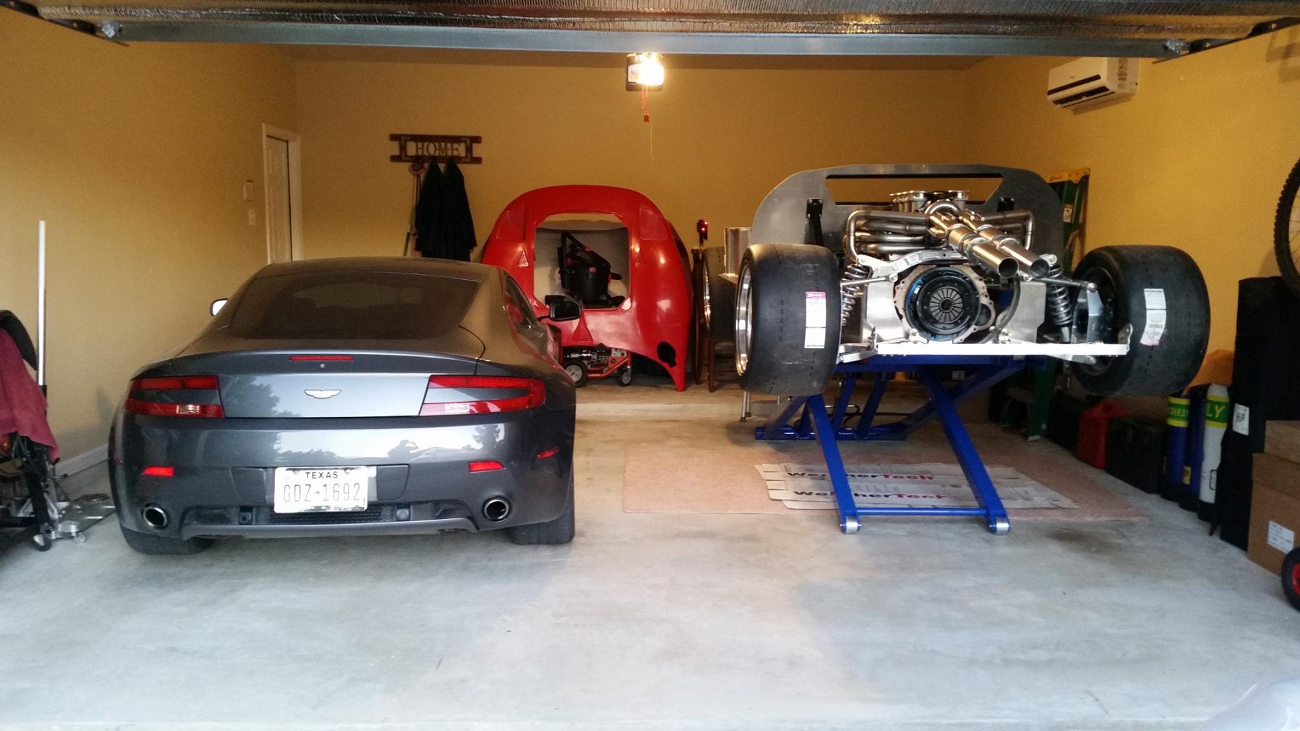

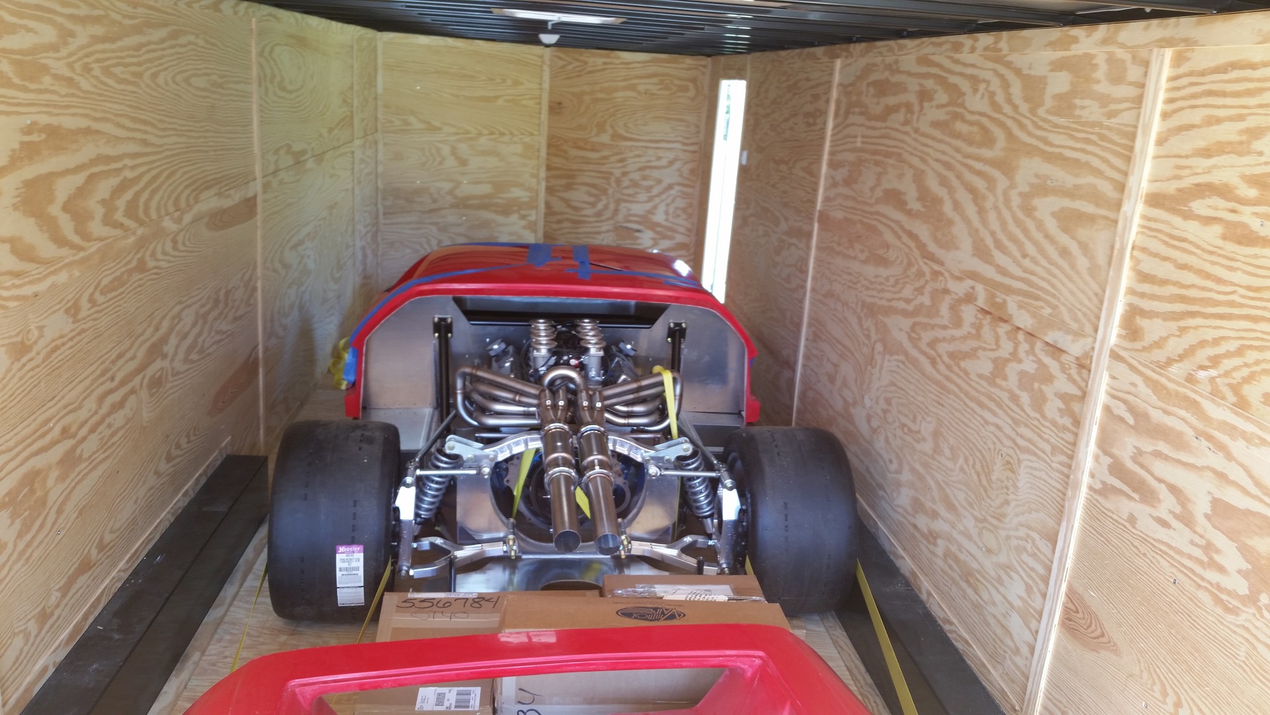

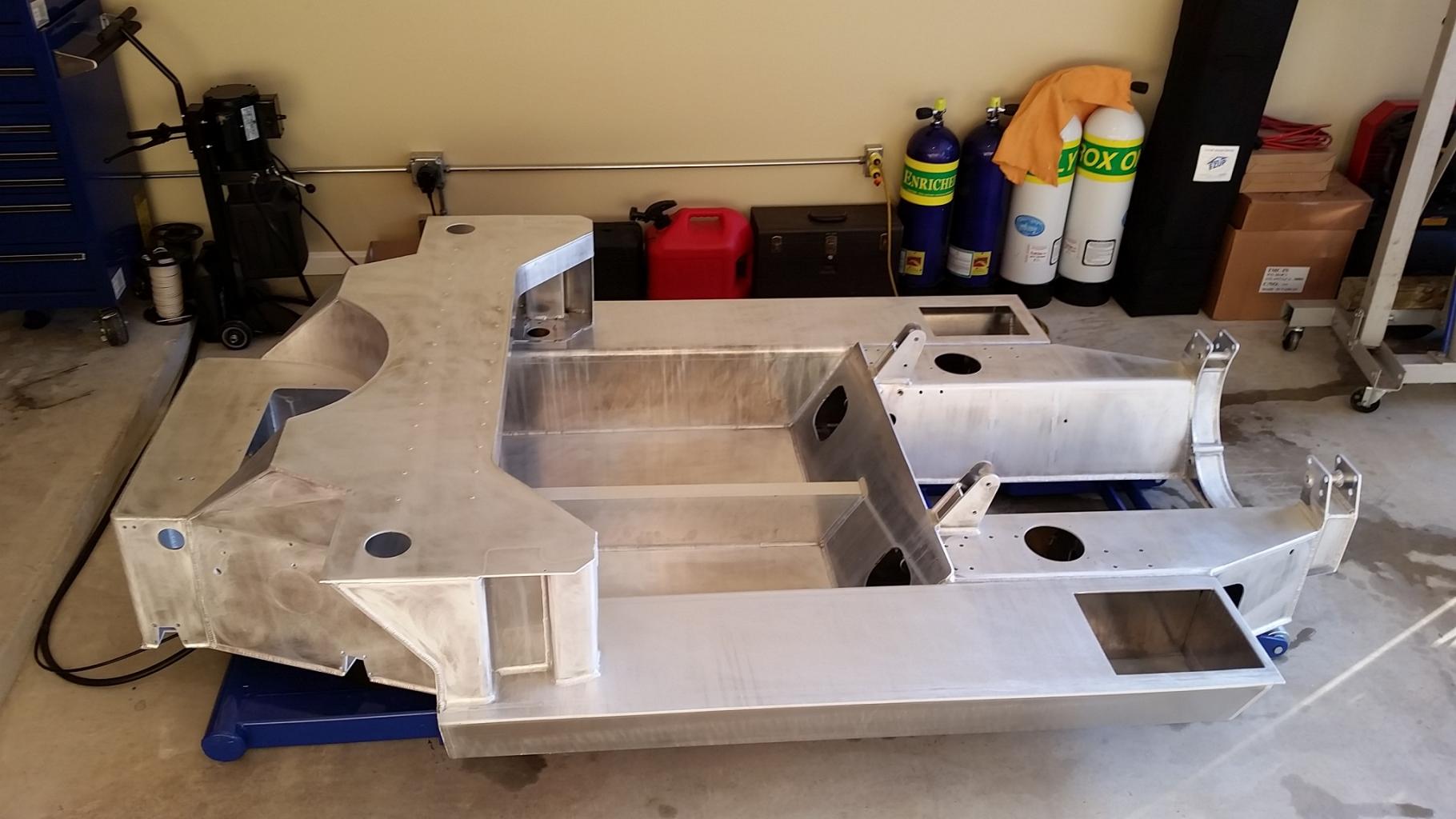

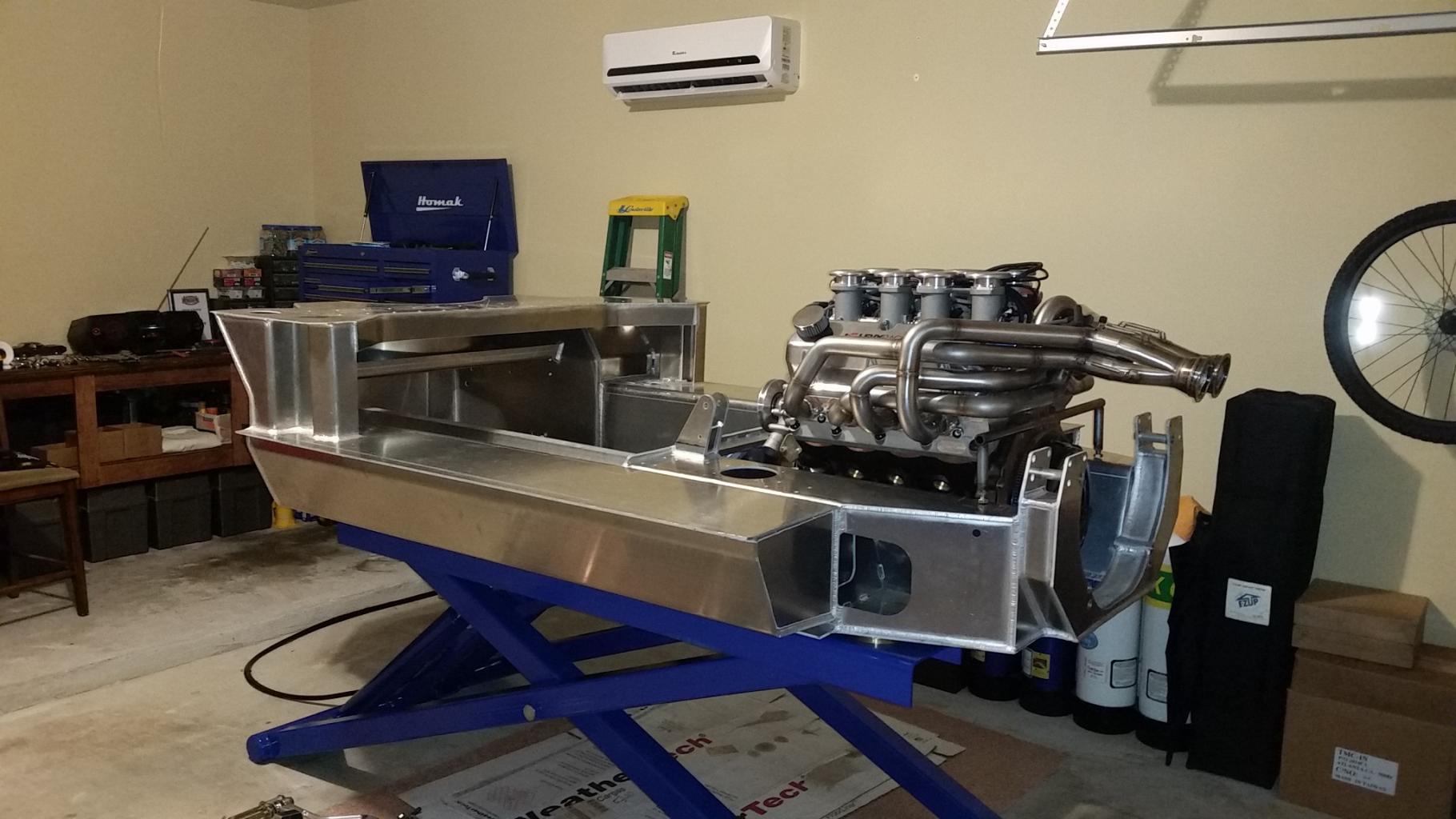

Oct 14, Arrived home in a U-Haul with the GT40 safe and secure. On Oct 12 I totaled my wife's 4 week old Tahoe when a Highway repair truck was stopped in the fast lane (until I was about to go by in the slow lane) then backed into my lane ripping the Tahoe open like a tin can! I was lucky to walk away with a dislocated finger and a badly bruised left knee. No highway work was going on... The driver was going to back up to turn around on a 55mph dived highway and go the opposite direction since he passed his work site by 6 miles. Thank God I was not pulling the trailer (since I was going to purchase a lot on beautiful Lake Keowee in South Carolina) Or the collision would have been much worse. I bought the lot the next day and then drove back to Houston.at it.
Un-packed the GT40, put her in the garage and stripped her down. I then took a couple of weeks off to heal. During my healing time I was planning and ordering supplies so that when I feel better I can get on with my build.

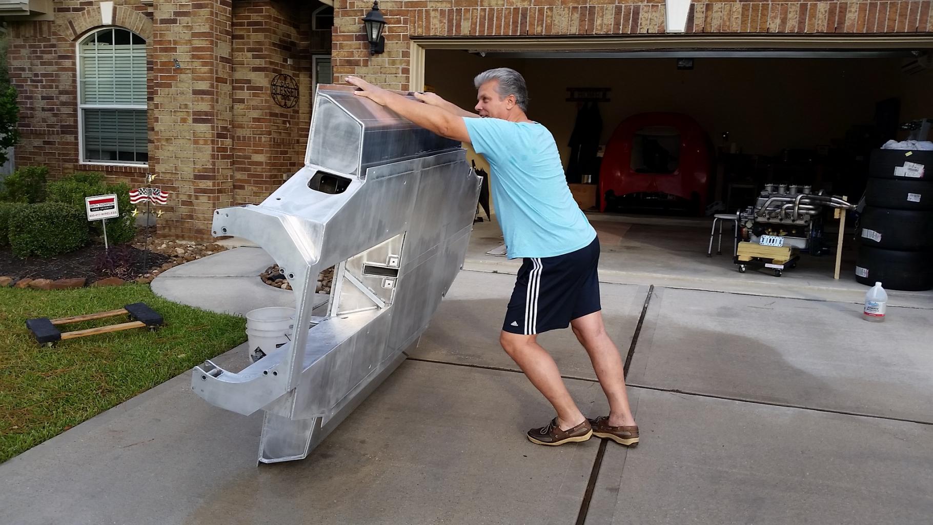

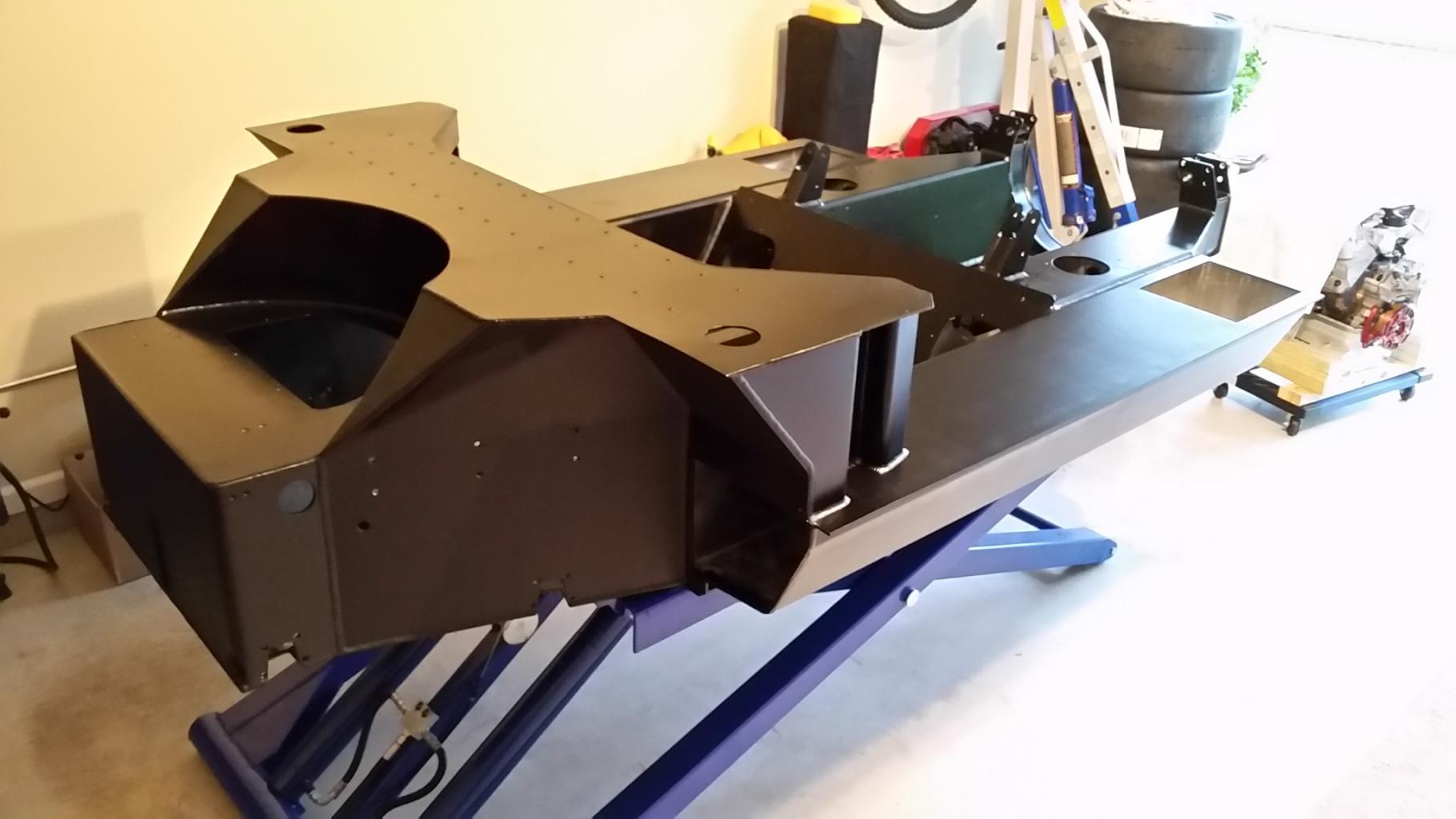

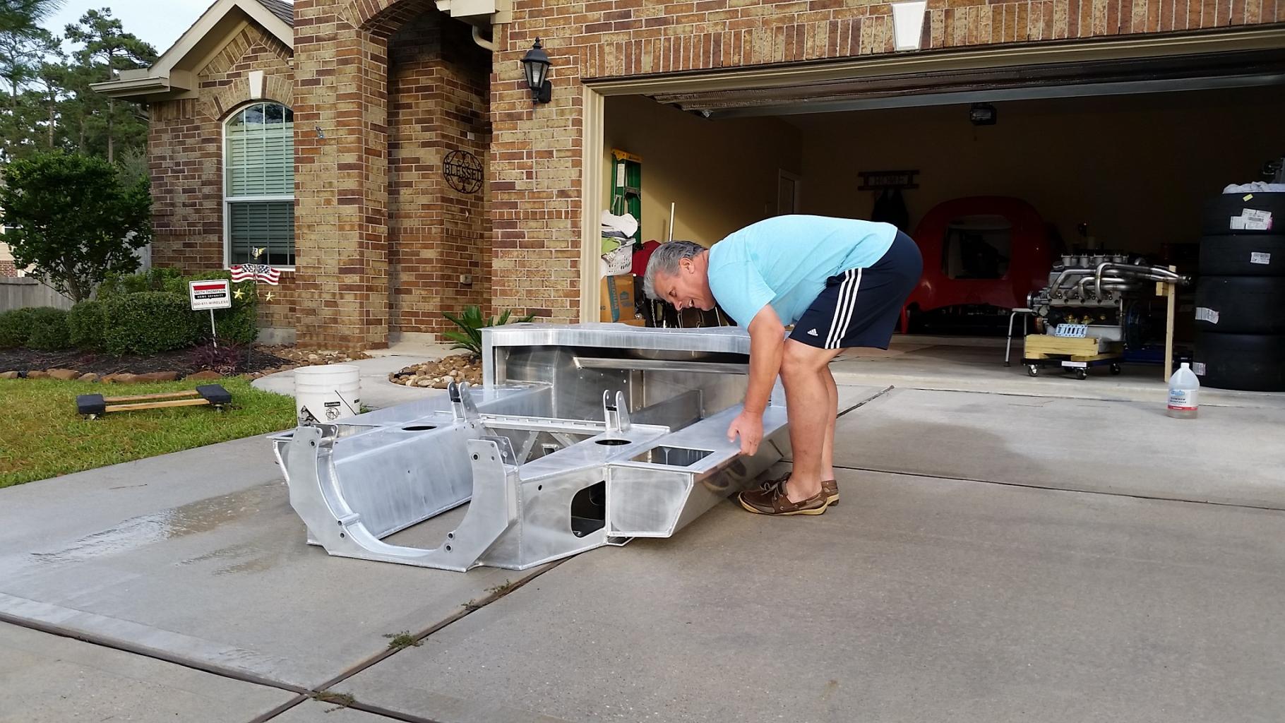

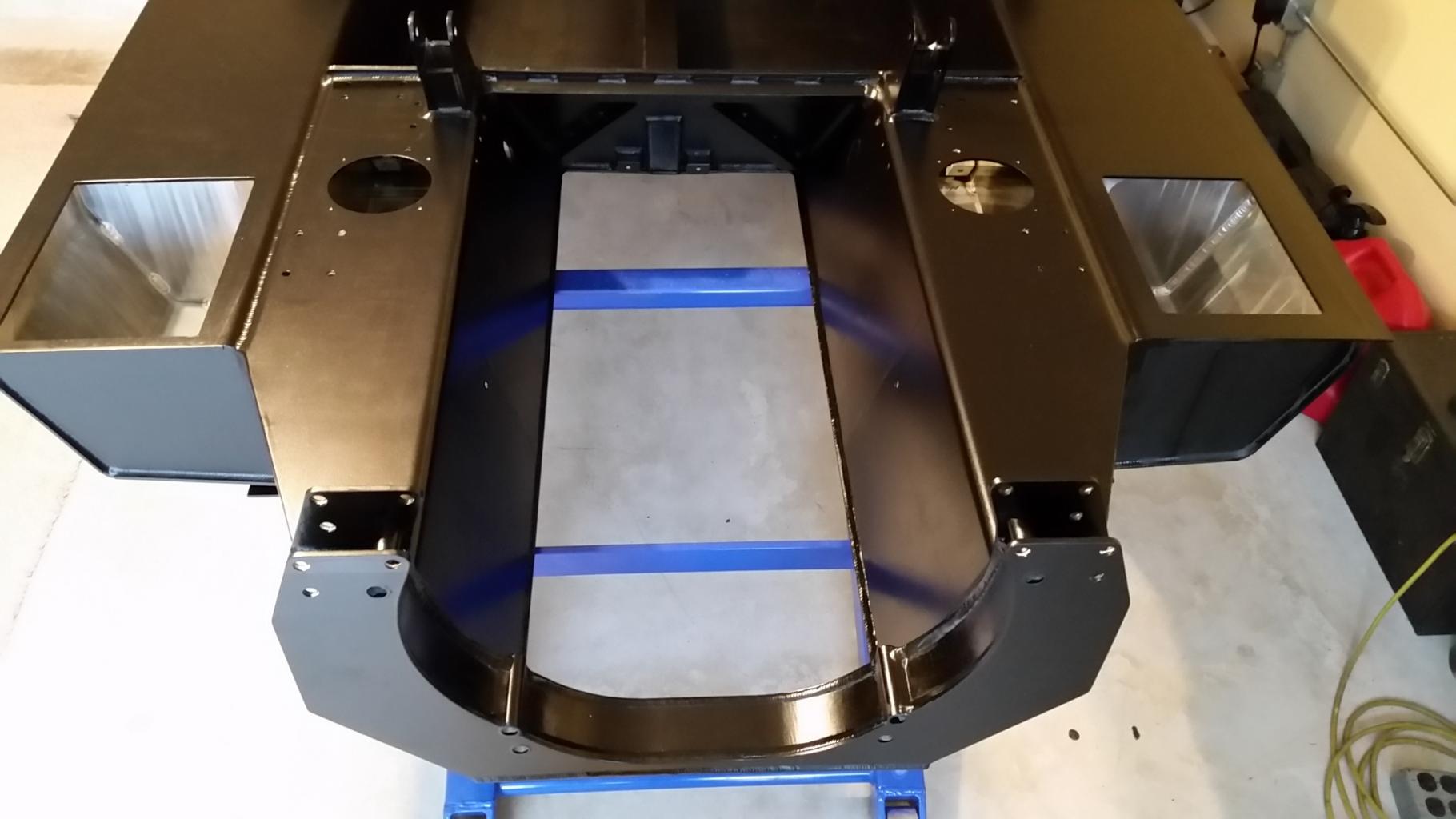

After resting for a couple of weeks I sanded the entire monocoque and prepped it with a acid wash. It is so light that I could handle it by myself (I put a furniture dolly under the front end and pulled it out of the garage and flipped it over a couple of times while prepping the metal). After letting it dry for a day I painted it with POR15 since I like the plastic like coating it creates on the metal. You must rough up the metal surface so that the POR15 will adhere well. I painted the areas where sand and rocks may hit with 6 coats so that the small rocks will just bounce off instead of chipping the paint. This worked well for me when I restored a '68 XKE roadster, I drove it for 12 years and the underside looked like it was just painted.
I cut a hole in the left sponsoon to house my fuel system since when completed I do not want to see a lot of fuel plumbing.

Rick the paint job looks nice and even. Are you using a roller or ??
I had prepaid a powder coater to do mine and he has skipped town and sold the business - so it will be paint for mine.
I've used POR15 before but am looking for a nice even finish.

Randy, I used a 6" smooth foam roller about 1.5" in diameter. It worked very well. If using POR15 the first coat should be a light coat. Let it dry for about 4 hours then apply a heavier coat (second coat must be applied within 6 hours or you will have to sand it again). I applied 2 coats on most surfaces and about 6 coats where road rash may occur. in all I used 1 gallon at a cost of $118. The finish turned out very good but if you want it to be better apply 2 coats then sand it a couple of days later with 220 to 320 and apply a final coat. This would only be needed for the visible areas. I did not do this as the finish turned out pretty good. If using POR 15 DO NOT leave the can open any longer than necessary since it will try to pull moisture from the air which will affect how it looks when you use it the next time.
