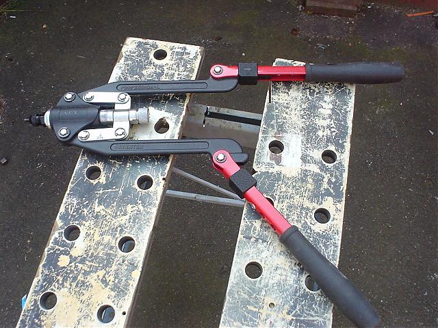

Hi Malc,
Here's a picture of my manual Rivnut tool that I have had for a few years. The handles fold down to allow you to get into smaller spaces. The only issue I have had with it is not knowing my own stength... when using the M4 mandrel, I have at times pulled the handles together a little too quickly and snapped the mandrel... but altogether I've found it good, and it saves the forearm ;)
Brett
