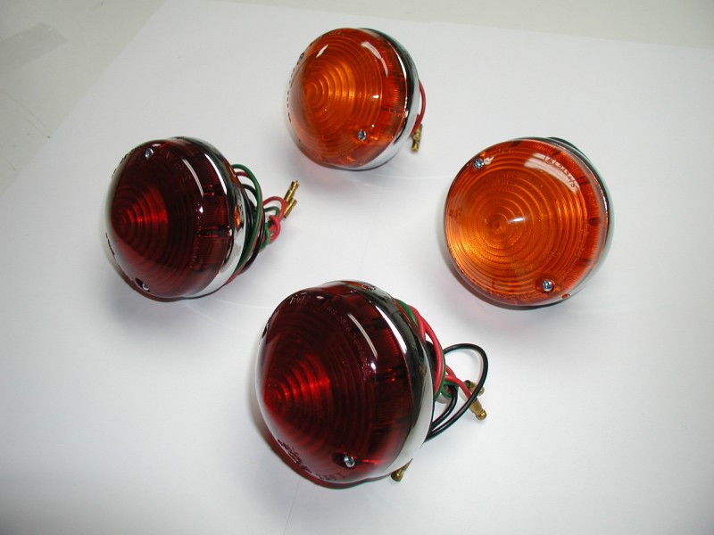

I am in the middle of converting to the earlier version, the lights are Lucas L691 indicator lamp L691 stop/tail lamps from AES UK Ltd. should you need a part number.
Chris

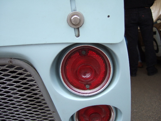

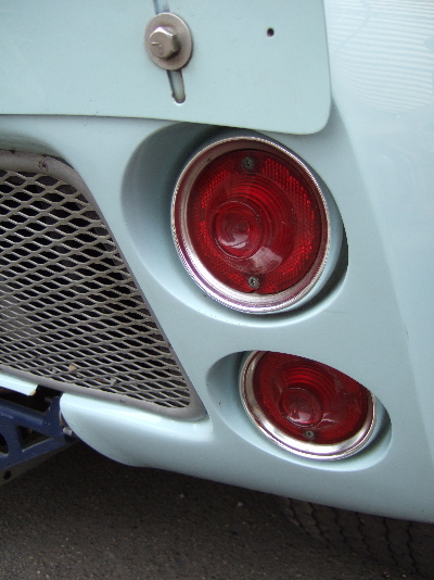

I took some close up pics of a MK2 at Le Mans Classic 2006 re the rear lights - they do not look like the ones above
Hi Ian,
the Mk.IIs are a bit odd in the whole GT40 pantheon. They were built up in the USA rather than at Slough in the UK so tend to be fitted with American sourced parts.
The rear lights on the Mk.II (and the Mk.IV as far as I know) are from a 1960/61 Chevy Corvair (no idea why they used GM parts http://www.gt40s.com/forum/images/smilies/confused.gif
:confused: )
The gauges on the Mk.II are Stewart Warner/Jones as well rather than the UK Smiths sourced ones.
