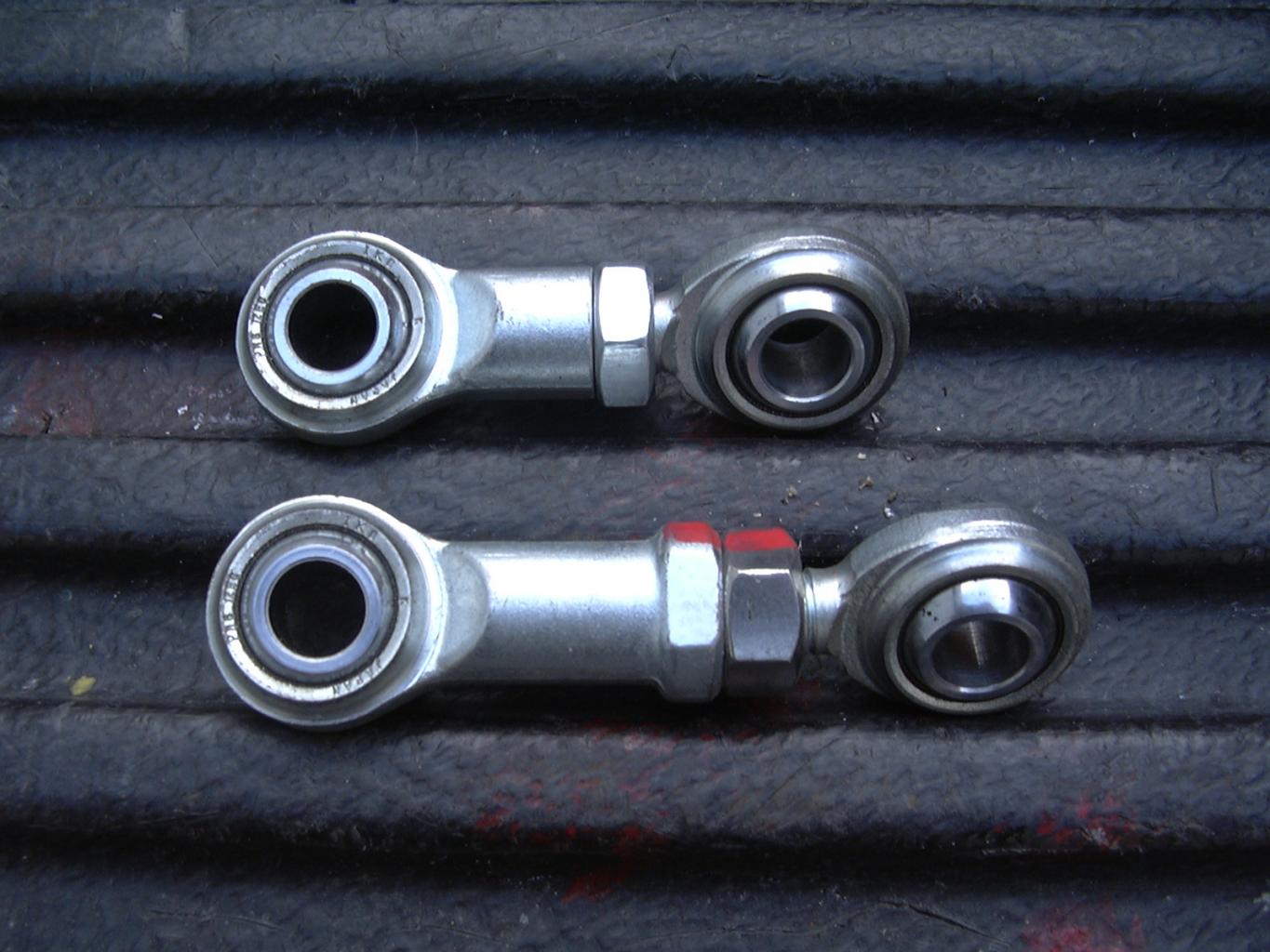

I've shortened my end-links to the extent that they are now higher than the lowest part of the 15" rim. The idea was that if I ever experienced a front flat the link wouldn't have the ability to act as an asphalt rudder making steering interesting at best.......
Jack Houpe
Rich, if you get a chance snap a picture of that for me. Did you have to order different hiem (spelling?) joints?
Jack, Here are the pics of what you need to do. The shallow nuts are known as jam nuts. I've got the engieering drawings for the rear lower suspension collar that I showed you at Monterey. PM me you email adress and I will send them. Regards, Rick

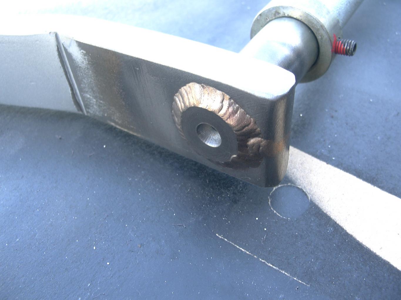

Rick your idea's and mods are out of the box and excellent. Really enjoyed Baha Cantina time. Not sure what happen to my last post?? I drilled and put a cold roll pin in my shafts right after I got the car.

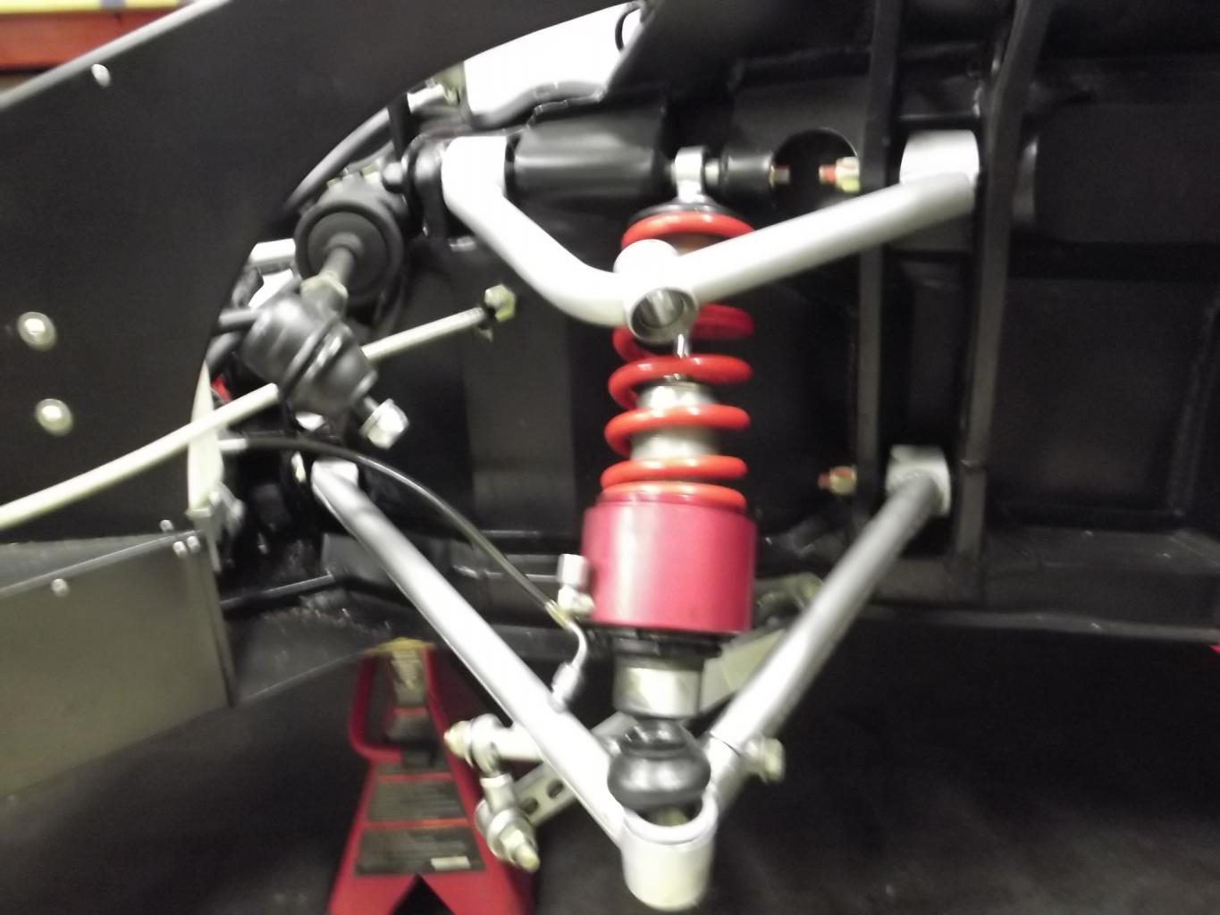

I can answer for photo 3, its a hydraulic lifting system for going over speed bumps and up driveways. The first time I seen Ricks car was last year and it looked as if the settings where way out as the front was much higher than the rear. After we met I asked what was wrong, he opened the door and flipped a switch and the front dropped down to normal specs.

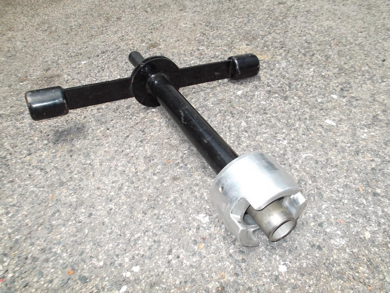

Photo 4 looks like a spinner knock-off tool. Handy if you want to keep the spinners. I replaced mine with 3inch nuts and use a 1inch air impact/gun. Much easier, and I will never do the spinners again! Scott
