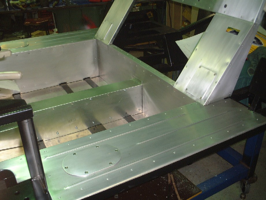

Im doing my own sheet work ,I had a few ideas of my own that i wanted to do im happy with the outcome so far.

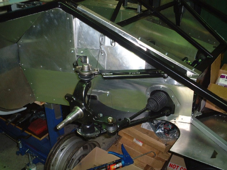

I really like some of your ideas with the front suspension and paneling, good job there. Keep on keeping on!

Thanks Ron.I had a few ideas for around the suspension that was the better of the options.
I think it should help with water ect & noise.

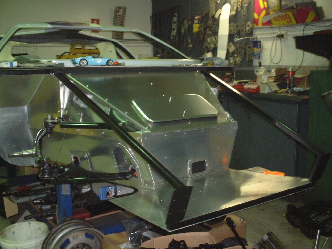

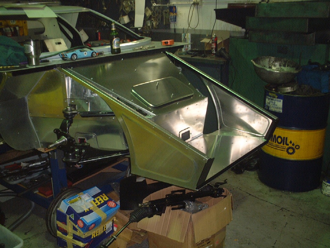

Jim great sheet metal work and some super inovation and vision ! You must have spent a bunch of time planning and figuring out how to do it differently and make it look more like a mono. Congrats /ubbthreads/images/graemlins/smile.gif

Your right it was a lot of work, The first side took about 2.5 to 3 days roughly.
I have to admit a lot of looking & beer drinking went on in that time.
The new handbrake panel wasnt in these pics.
You will be pleased to know ive called it the Dan Weilacher handbrake after you.
Lowering the handle was a good idea.

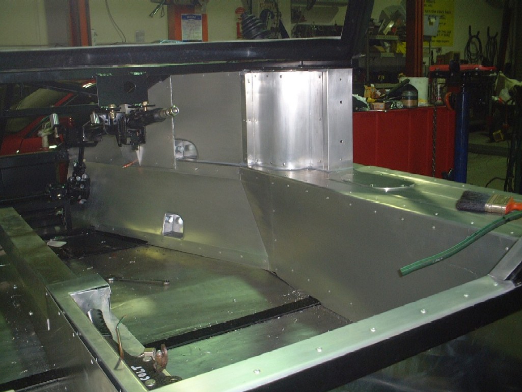

Nice work in covering the fuel tank down tubes. I saw similar panels on the 40inches.com car and thought it a good path to follow. Take care Jim and good luck.

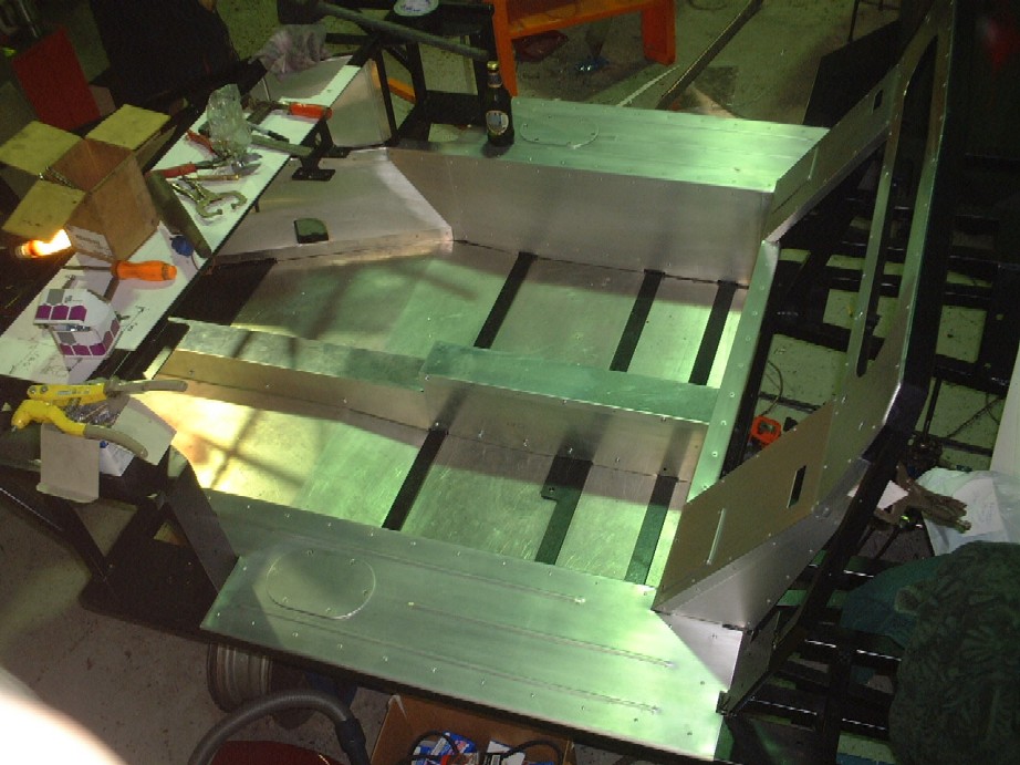

Again, that is some nice work there on your 40. The work is neat, very functional, and serves a good purpose in that the frame is not exposed to the elements and thus the seems betwen the frame and internal panels is not present. That eliminates possibility of corrosion. Plus, it down right looks neat!

One thing I did notice by accident I was blowing air inside the tube work to clear the swarf from drilling ect,And rust dust came out of the holes.
I am going to spray with fish oil or extrol through a hose & nozzle.
I cant see it being a problem now but maybe in 10 years or so it will.
Its obviously a natural occurance as the tubes are not painted on the inside.

Well the sheet work does seem to go on forever.
Im getting sick off looking at the guilo & the folder.
But I can see the light at the end of the tunnel.
A few more bits and peices , some detailing work on the finish I want then onto the suspension & fuel tanks I suppose.
