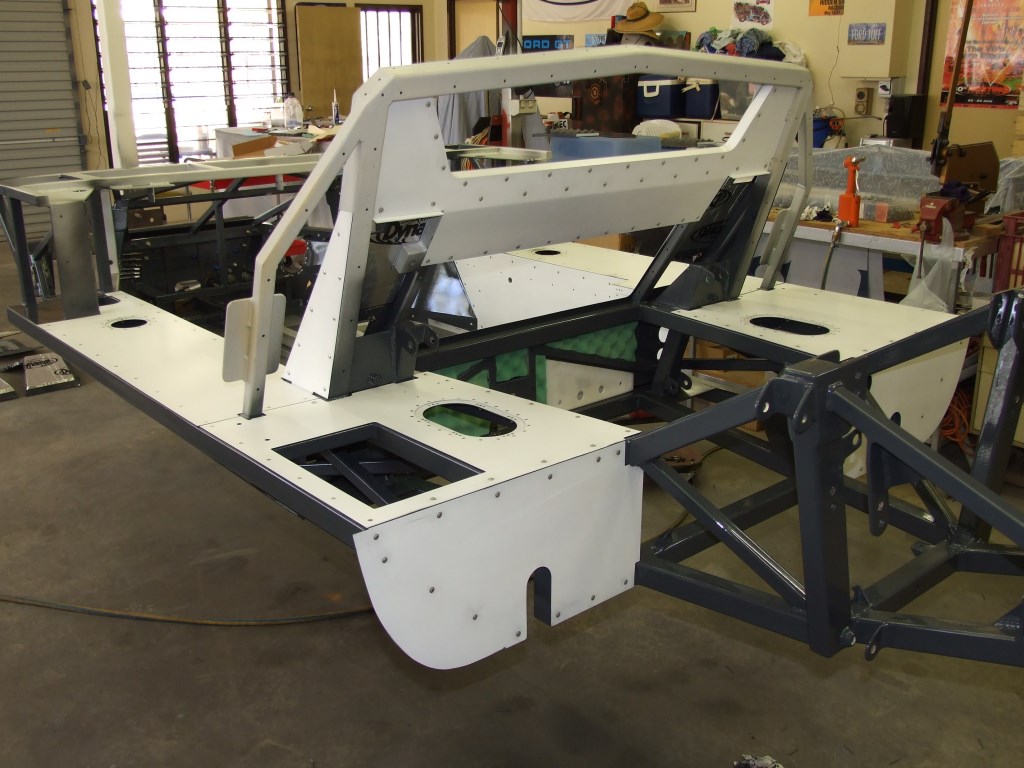

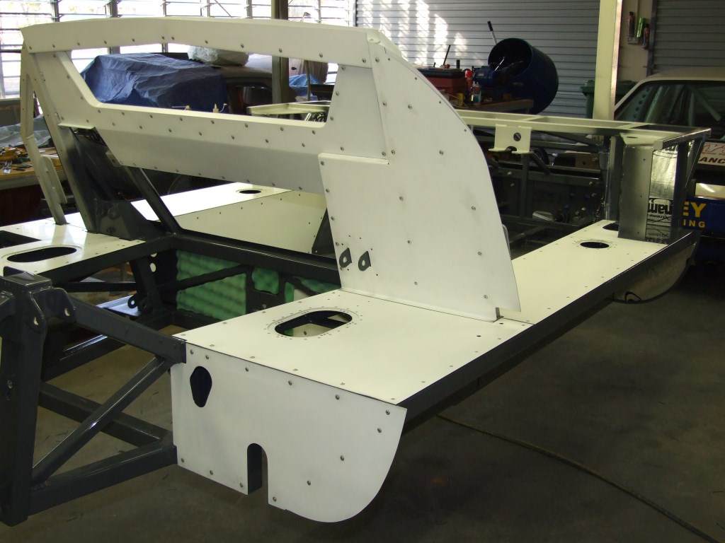

And the panelling continues.....
Clayton

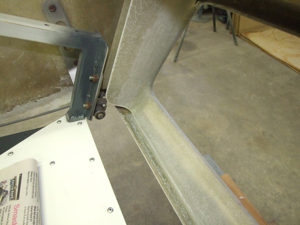

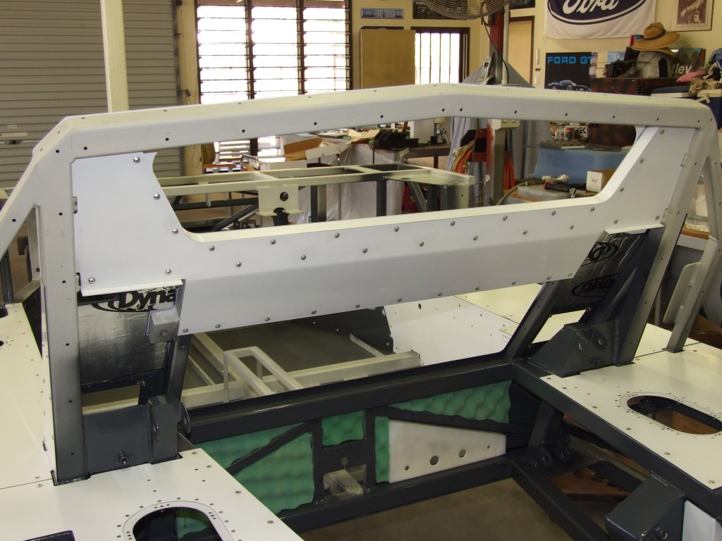

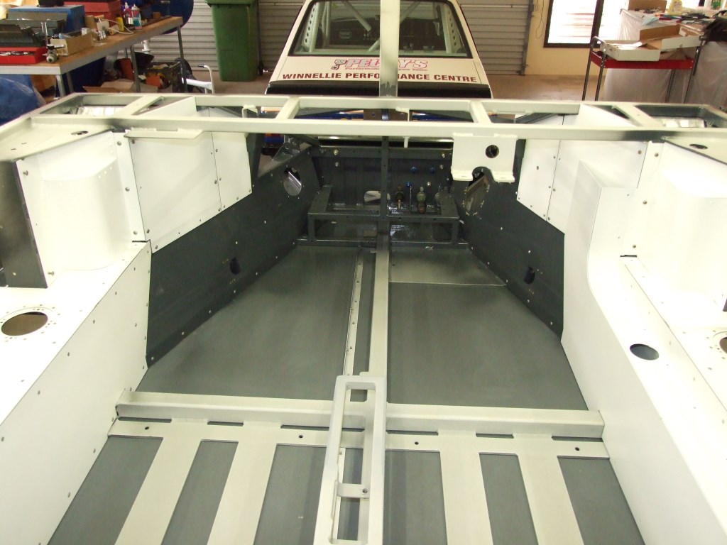

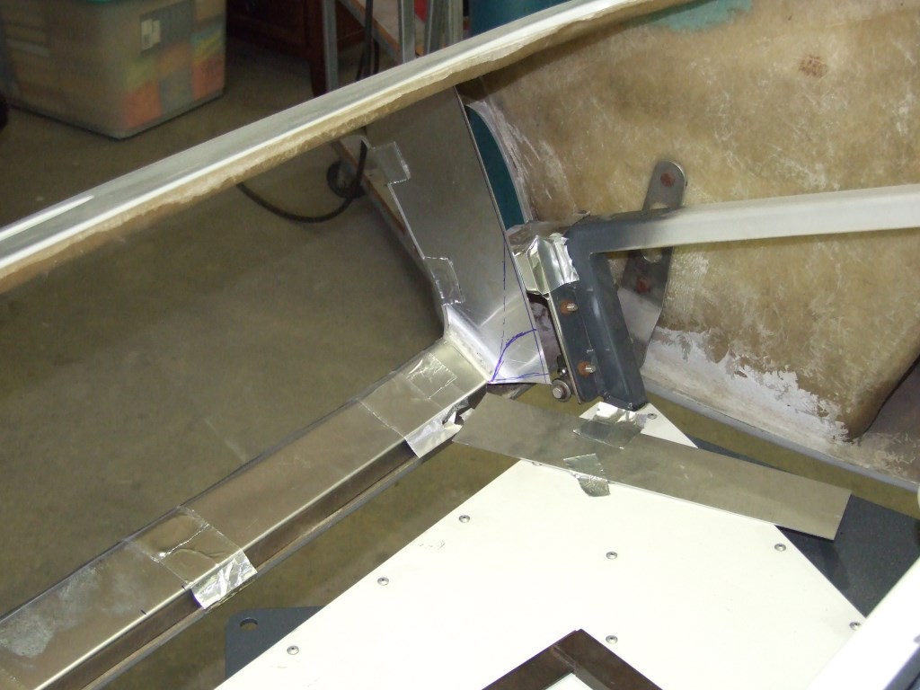

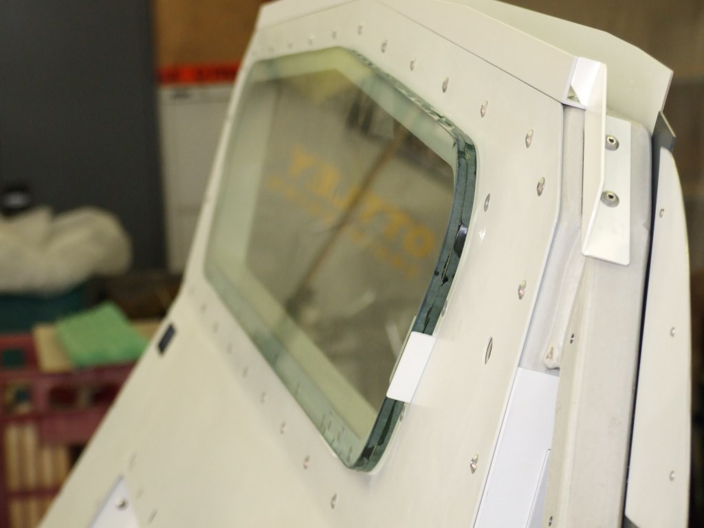

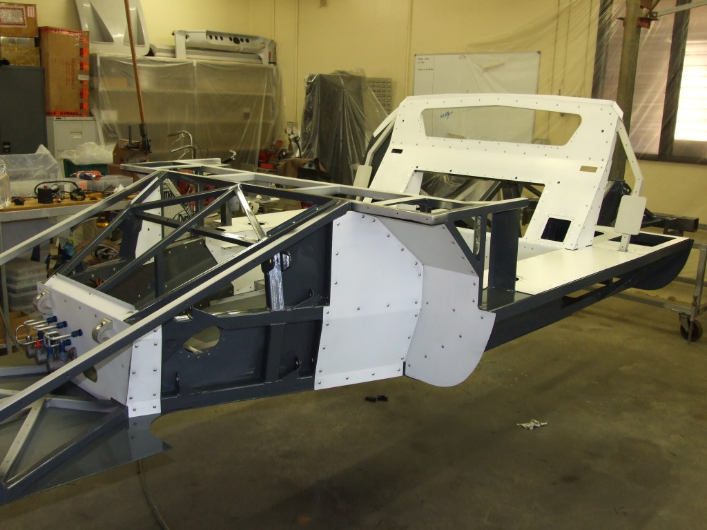

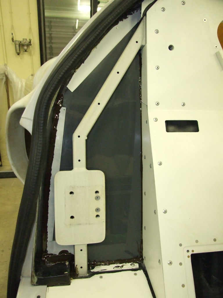

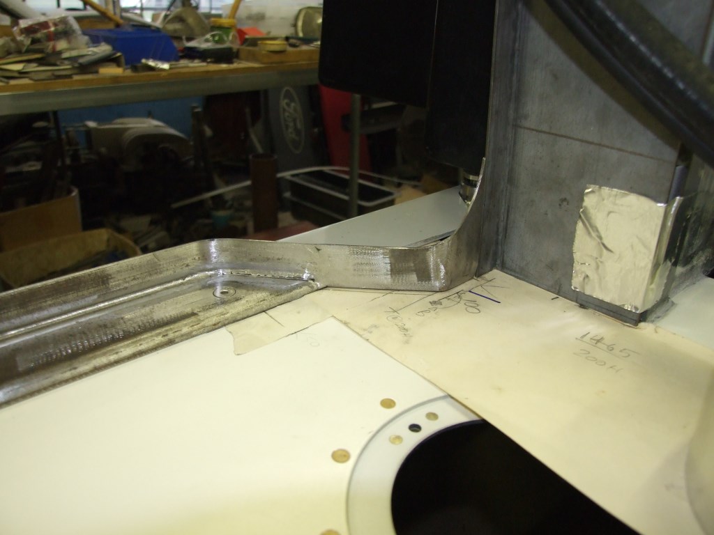

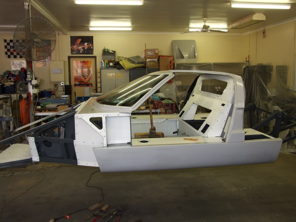

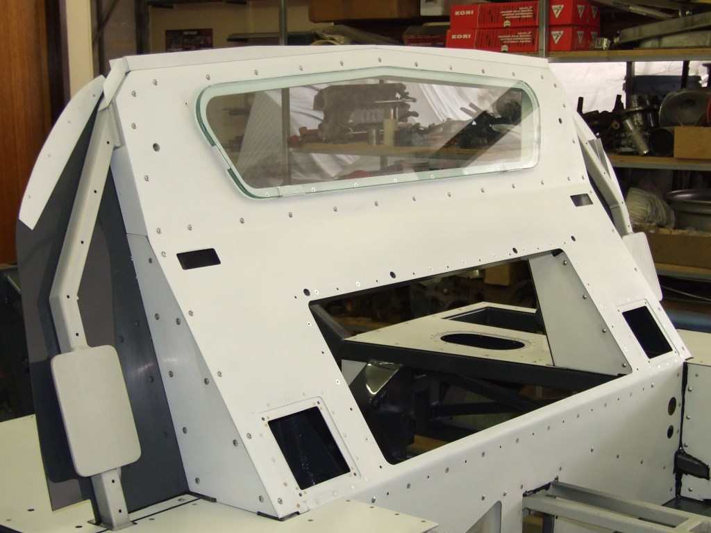

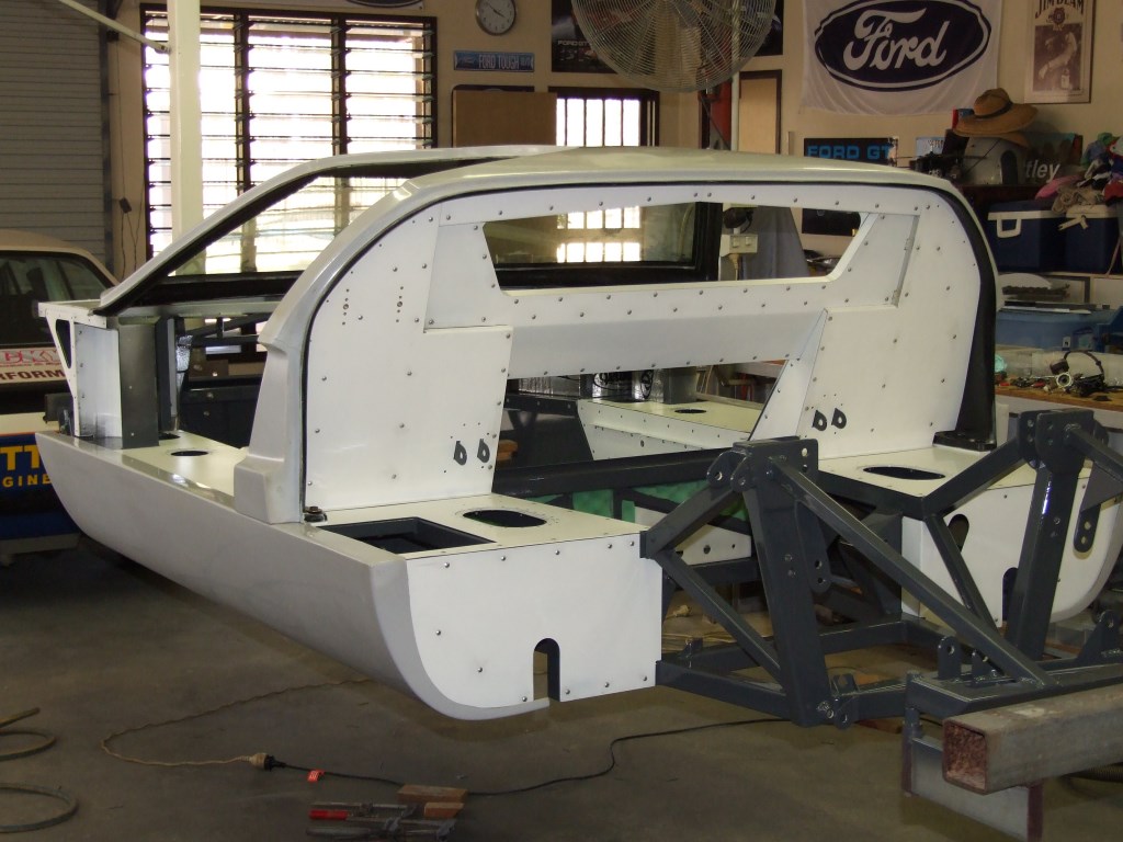

Clayton
Bulkhead window will be glued in and a trim to cover the edges.
Spider glued and riveted in place. Sat the windscreen in for a test fit.
Rear bulkhead panels edge sealed to the spider, then insulated.

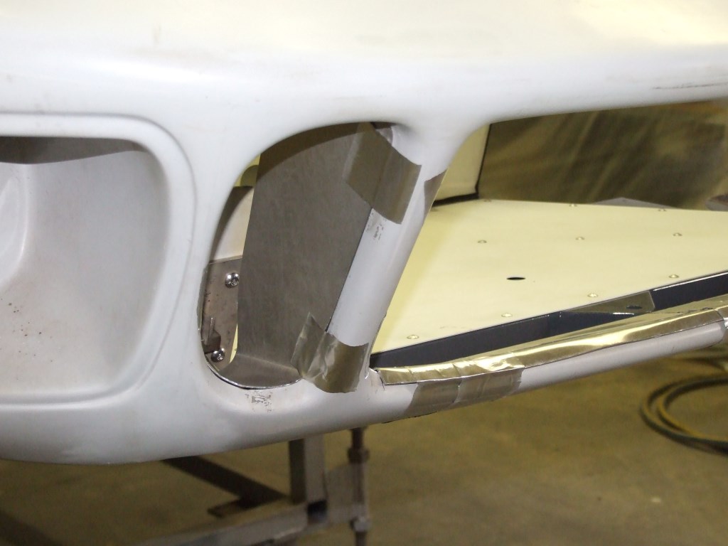

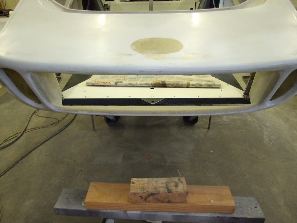

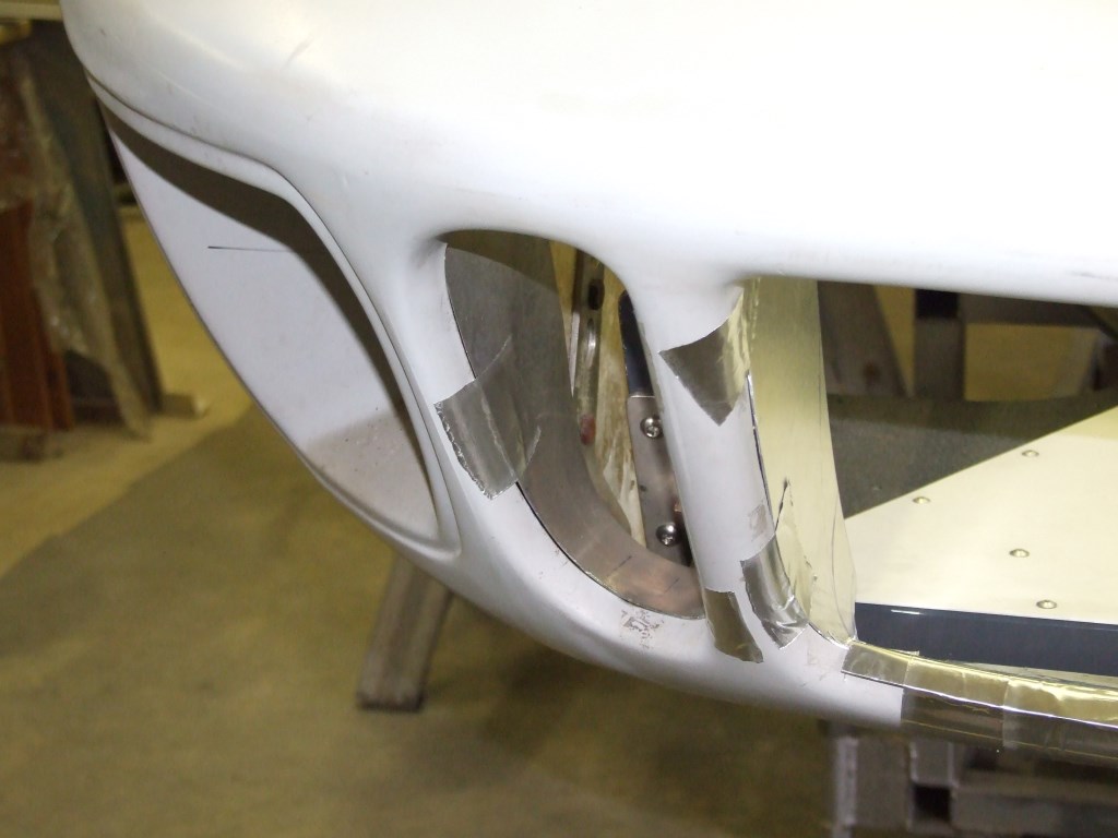

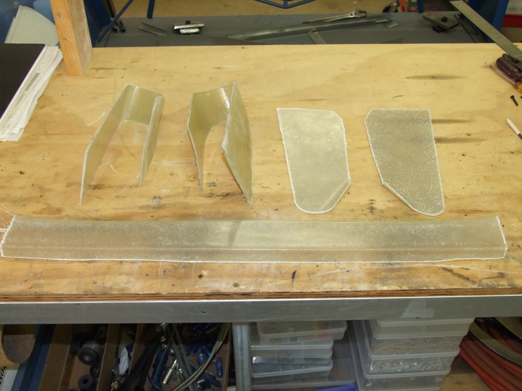

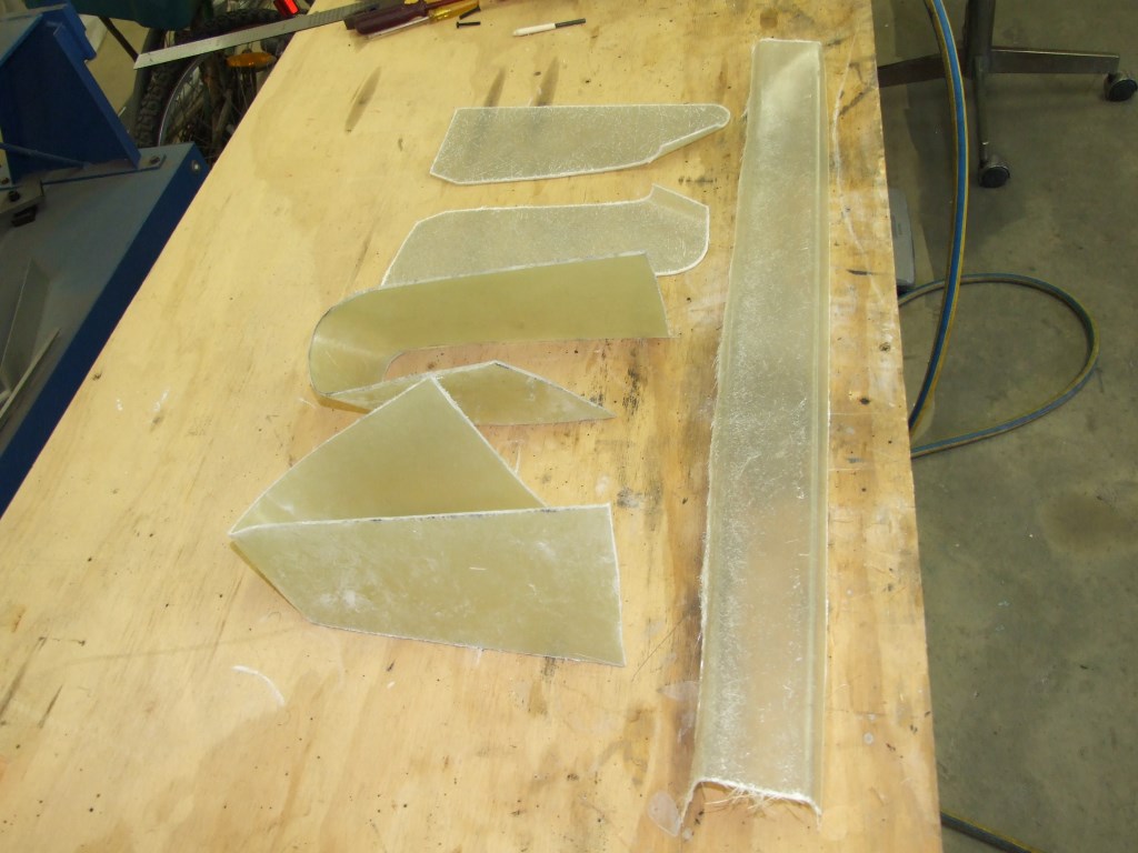

Time for the body
First place to start was the radiator / brake duct opening. I wanted to extend the walls of the ducts to give it some depth. Also double skin the lower opening to clean up that area.
Made the moulds from alloy, and then laid fibre glassed on them.
The lower edge has a dogleg in it so that a bolt-in panel (off the chassis ) will fill the area, stopping air from bypassing the radiator.
Clayton

Clayton
Starting to glass the additions in.

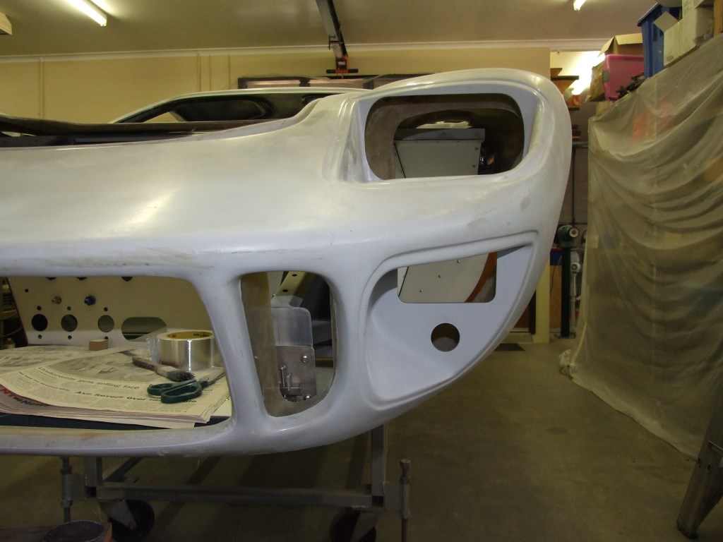

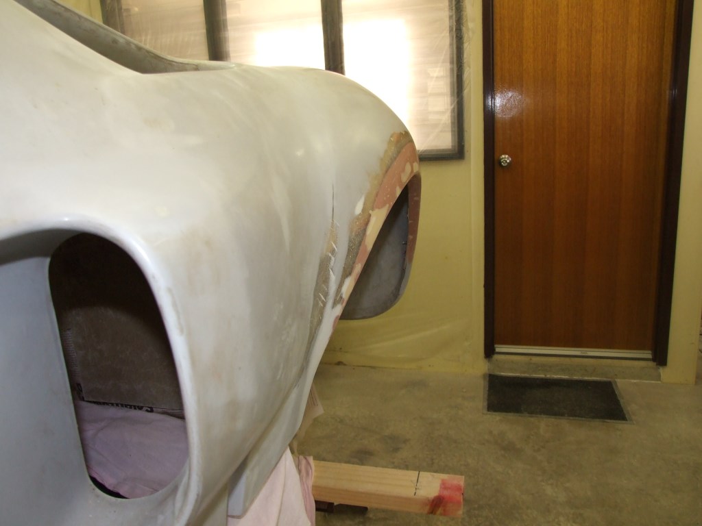

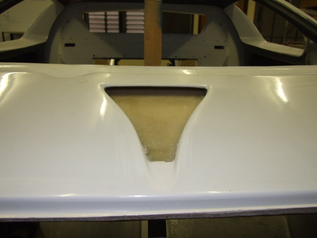

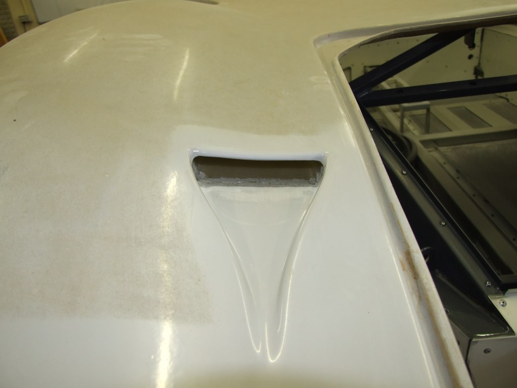

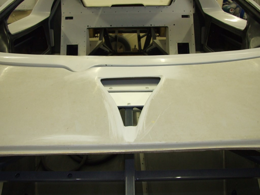

Clayton

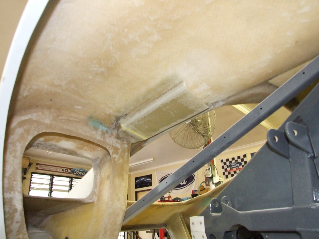

Opened up all three NACA ducts.
The centre one was hitting the chassis, so I had to cut it out and make a shallower floor. At the same time extended the duct rearward to make it look right.
For the outboard ones, I made an open ended duct to give them a purposeful look.
Clayton

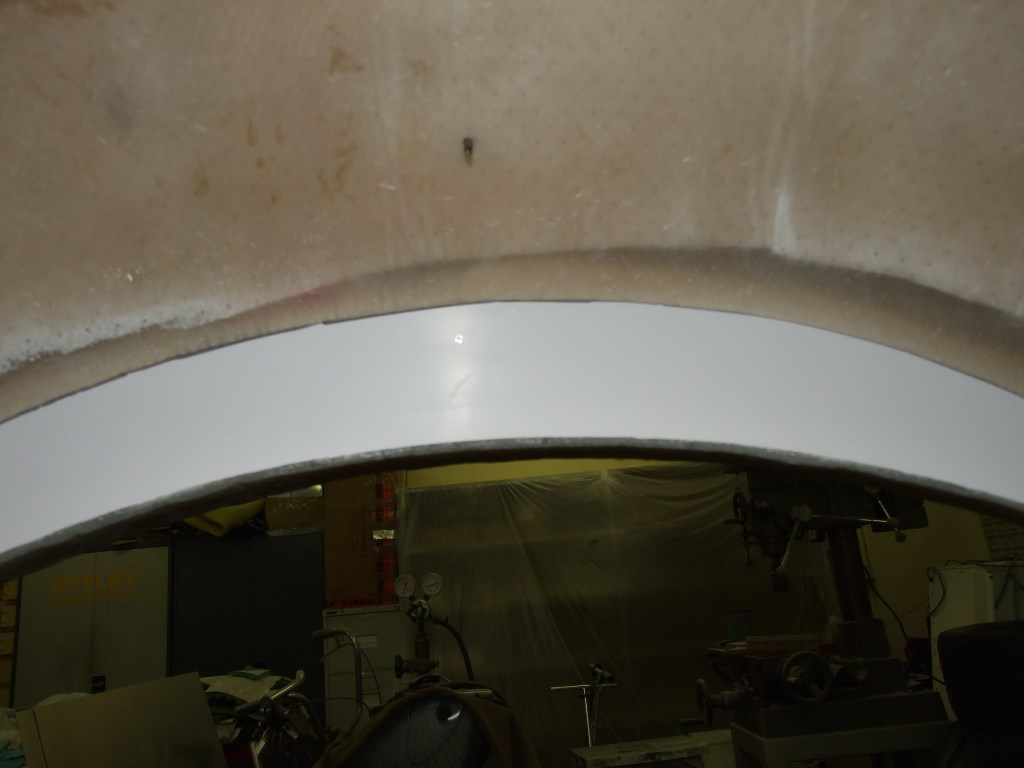

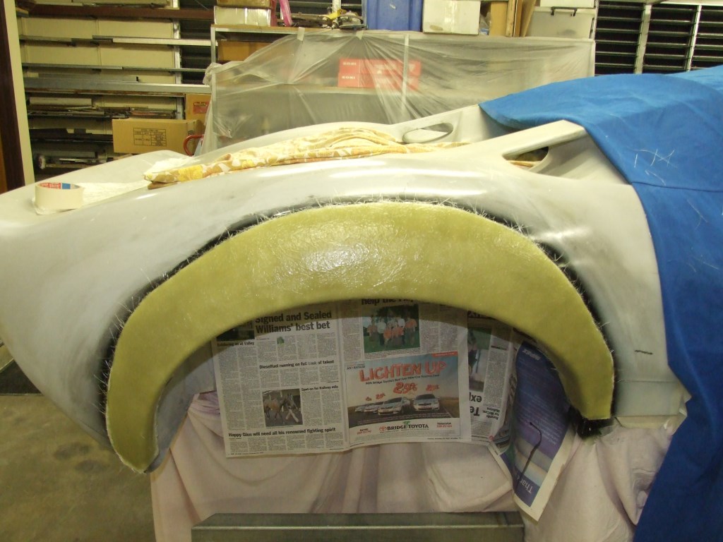

Clayton

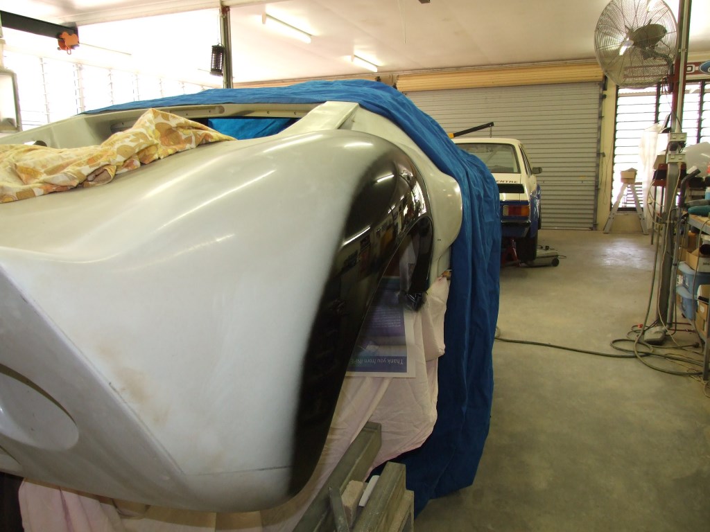

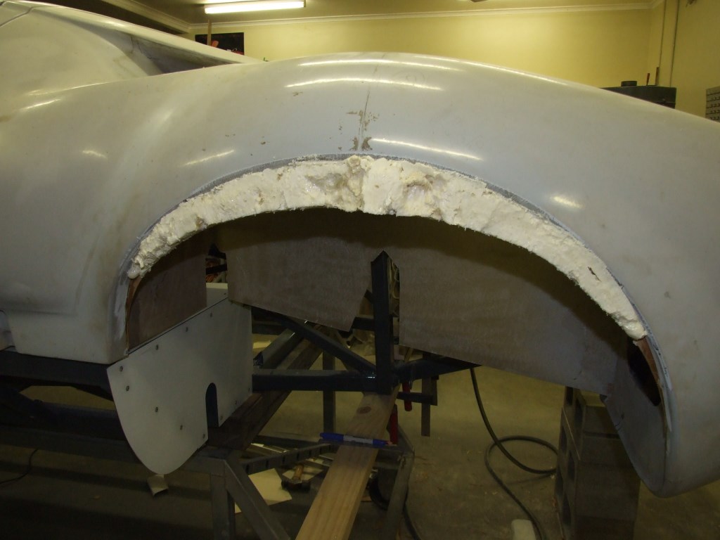

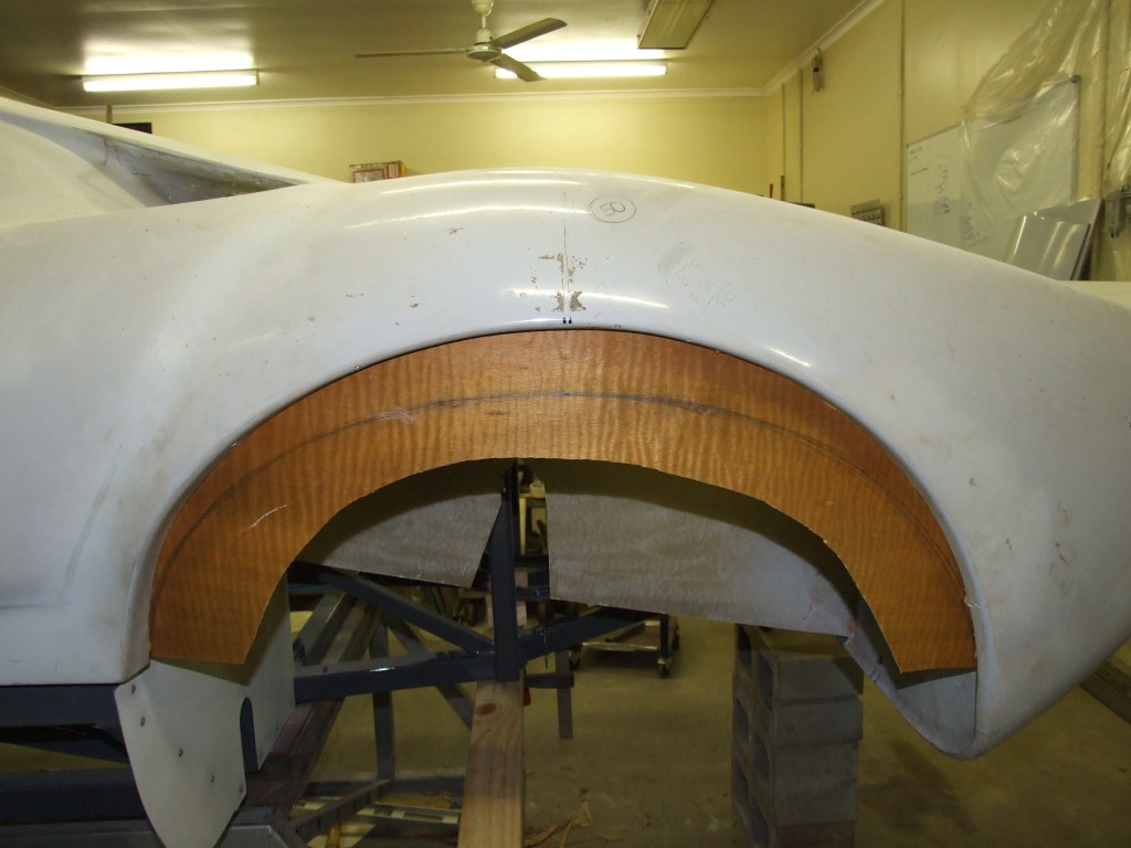

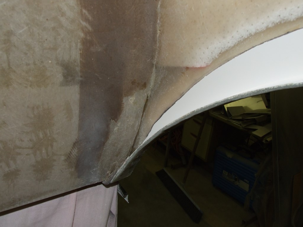

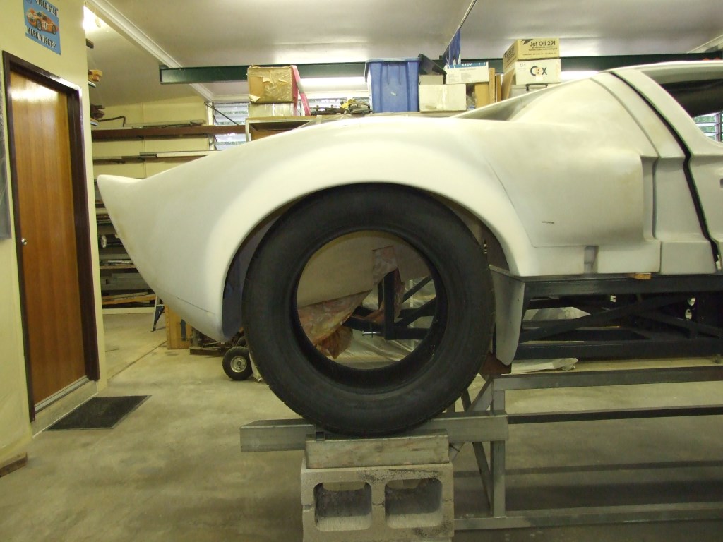

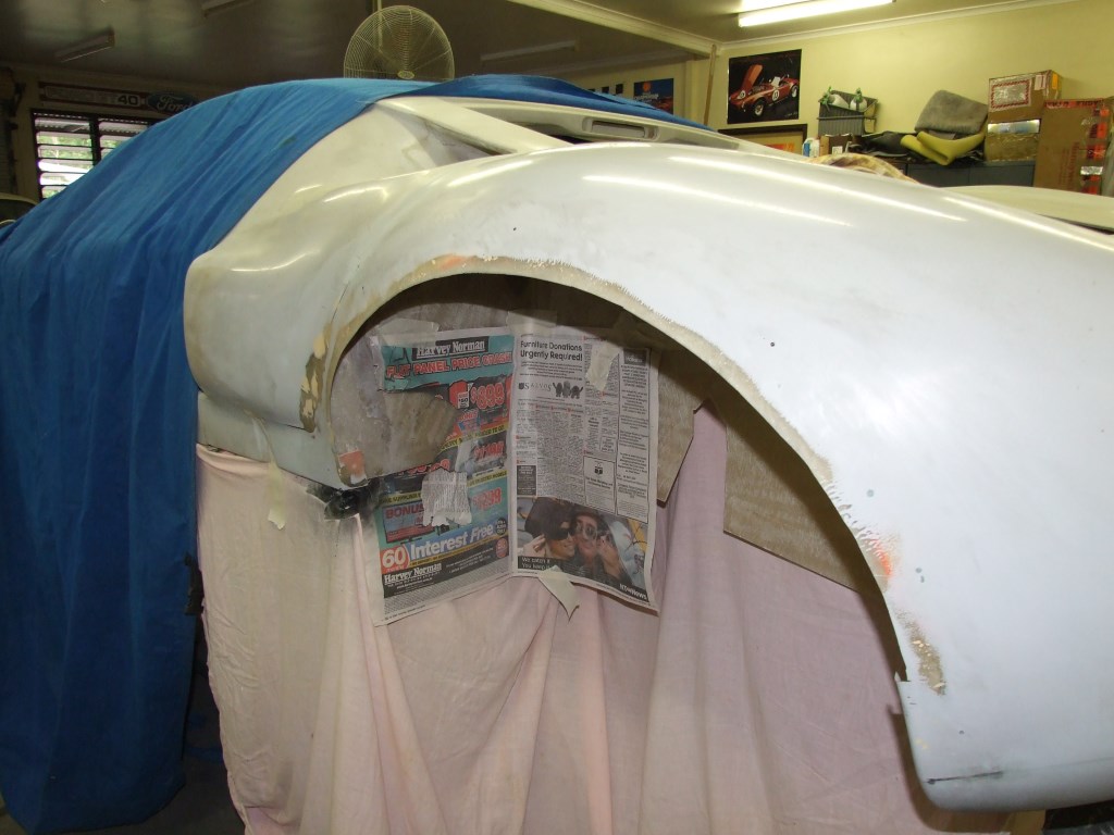

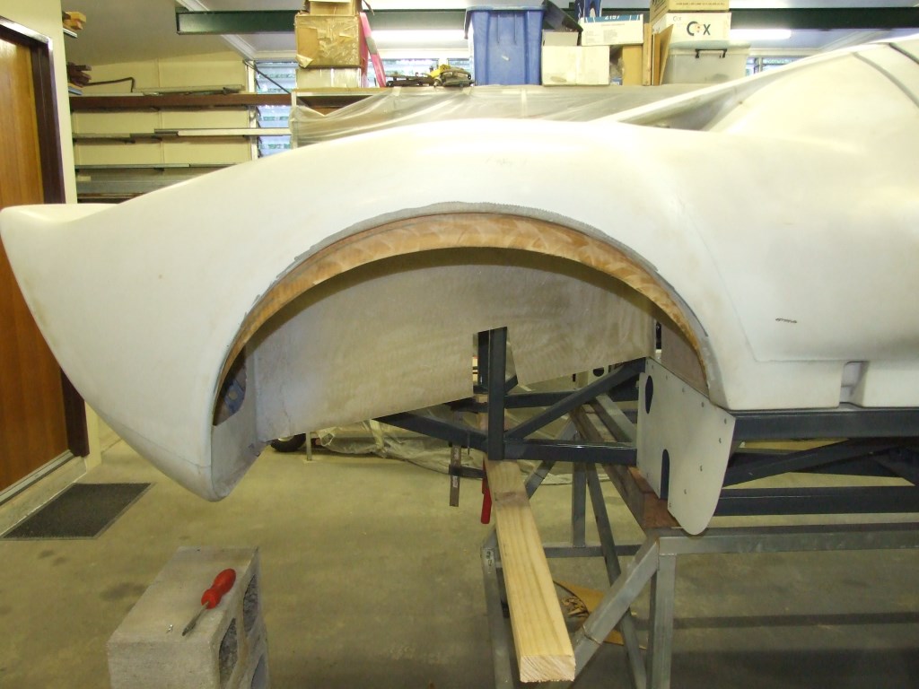

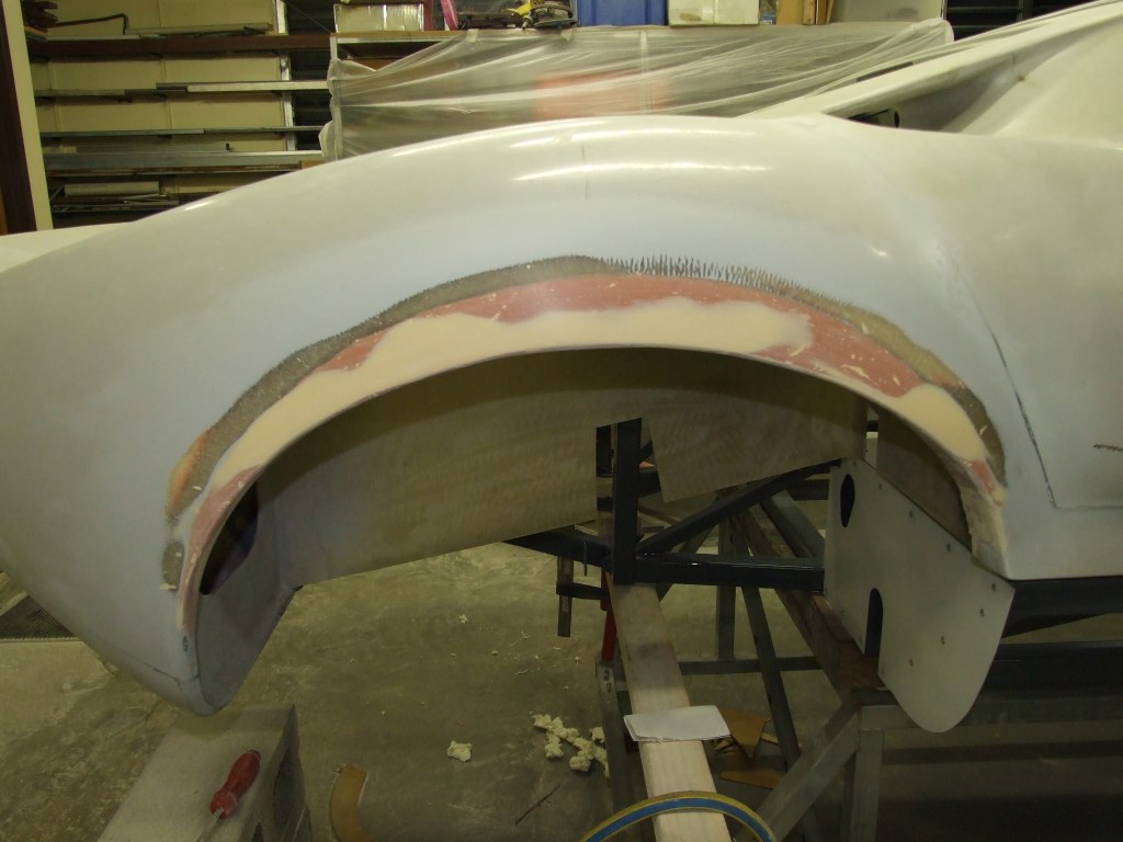

Next inline was the rear wheel arches.
I have never liked seeing daylight above a tyre, even though it may come from the factory like that.
Working with the loaded tyre radius and chassis ground clearance, I needed to lower the arch by 50mm on the left and 45mm on the right to have 15mm of tyre cover.
Used some ply as my template, added foam to build it up and then bogged to the final shape.
Clayton

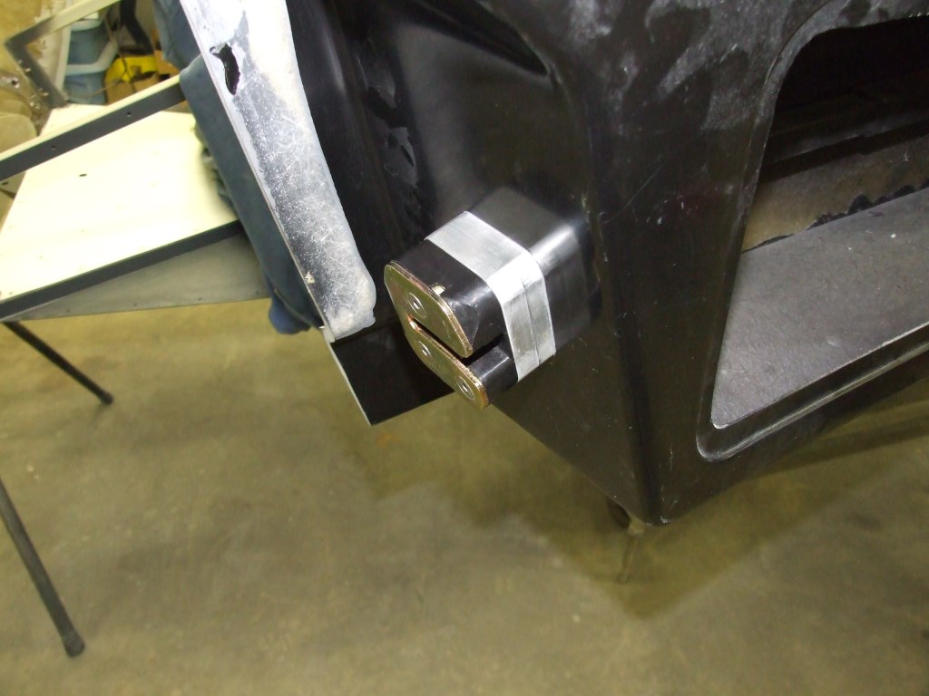

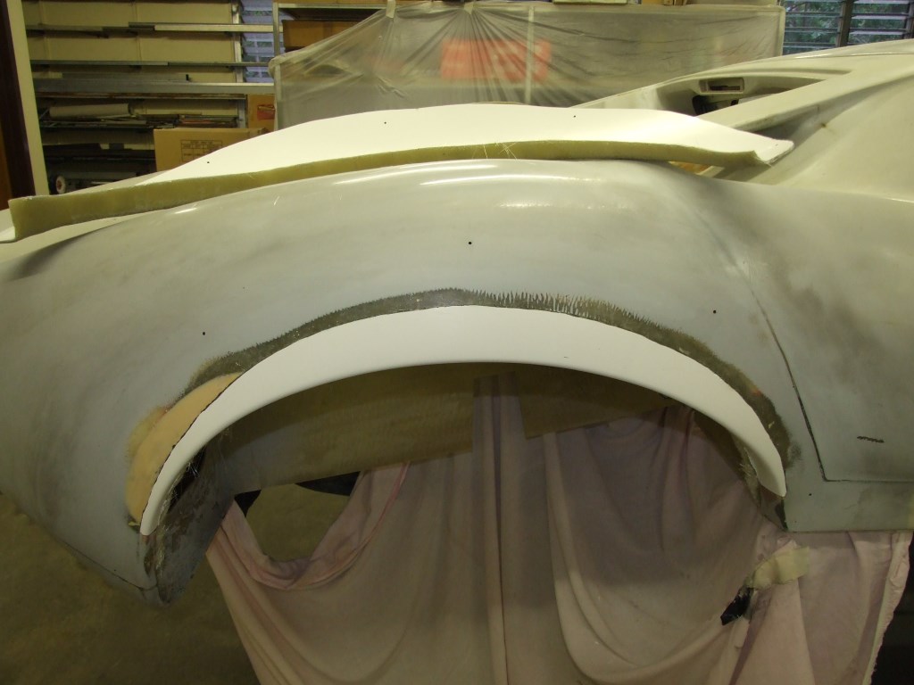

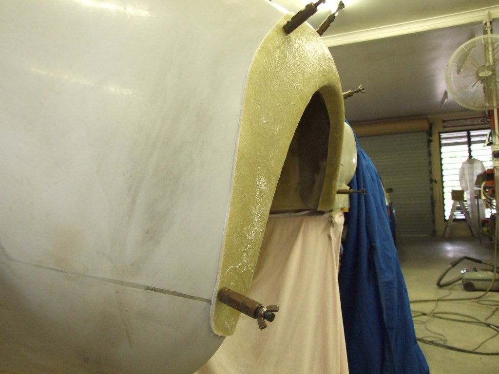

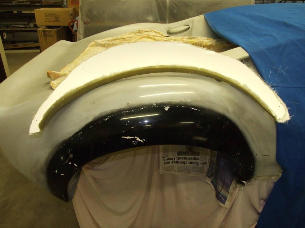

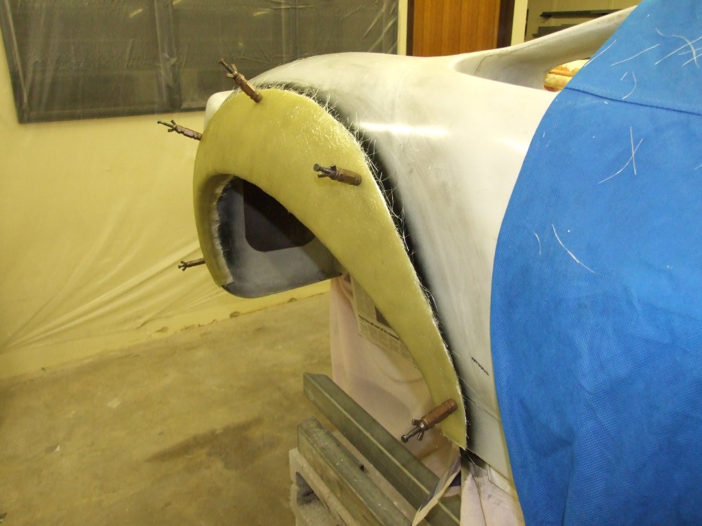

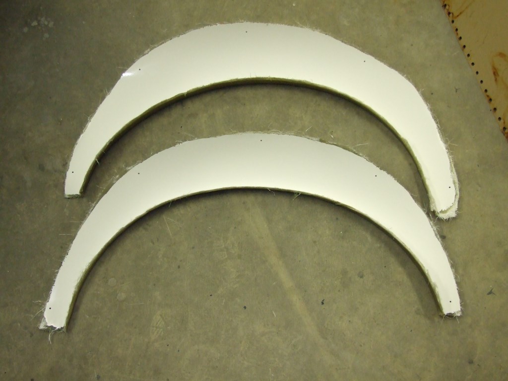

Clayton
Took a mould off the new guard extension and before I removed it, I drilled holes for skin pins.
Had some good advice from an old fibre glass man. He told me to make the buck / extension, lay up the mould then skin pin it. Remove the mould and cut away all of the added stuff (bog / foam etc) and taper out the glass to a feather edge.
Refit the mould with skin pins (perfectly located) add the gel coat and finish with several layers of glass. Great thing is, you made the part and fitted it in one go.

New arches in place.

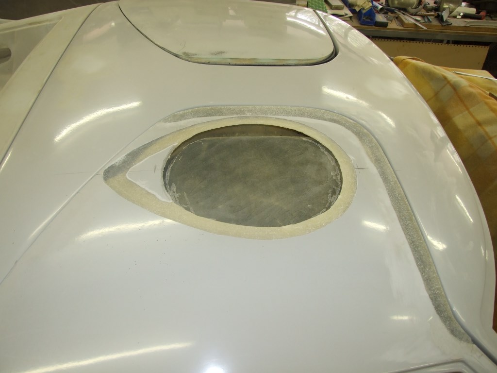

Clayton

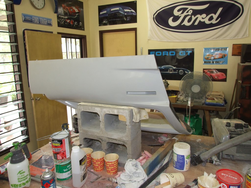

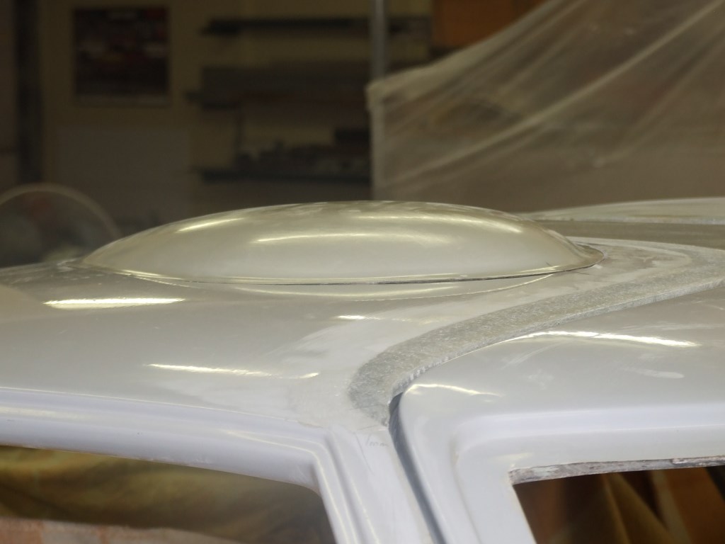

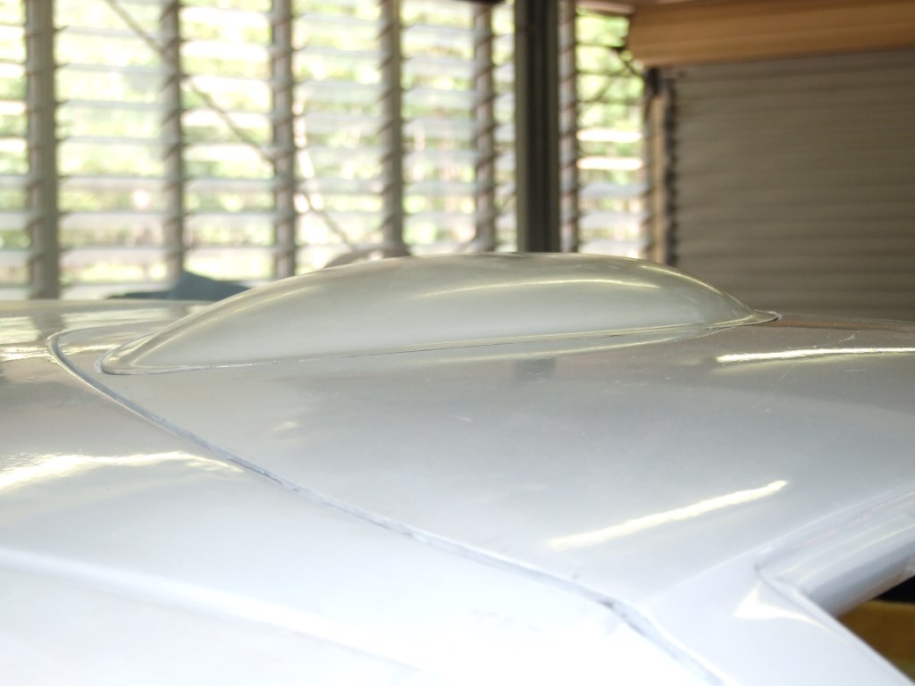

Onto the driver’s door and Gurney bubble install.
The gap lines were a bit big on the roof section. Feathered out the edge to a point and laid glass both sides.
Centred the bubble over the seat centre line and as far back as possible (could have gone back a bit further if the door allowed).
Recessed the bubble into the roof by the thickness of its flange, so the roof could remain flat up until the start of the bubble.
Clayton

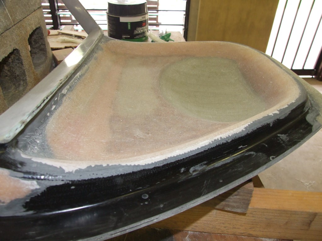

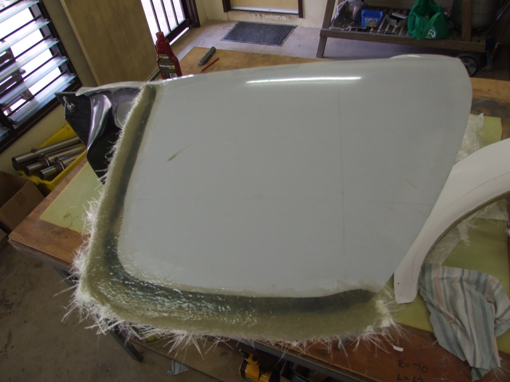

Clayton

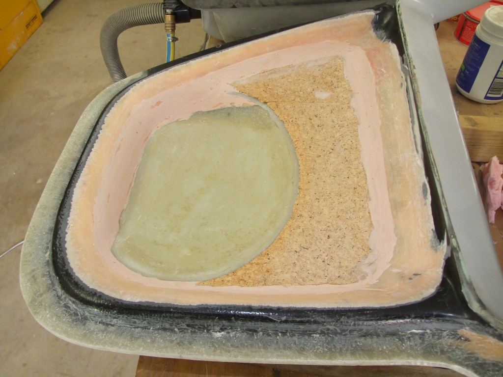

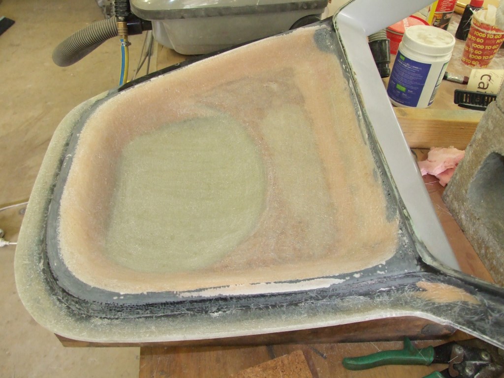

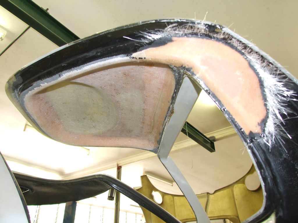

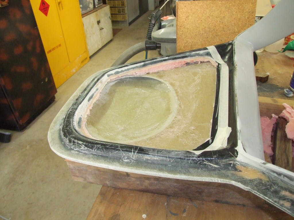

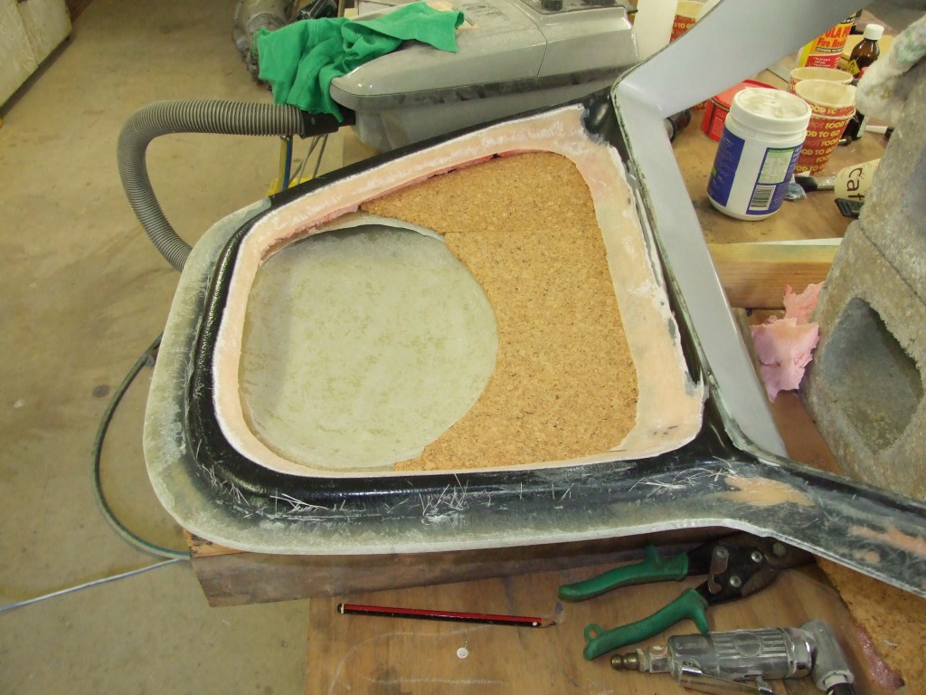

With the door off, I was going to keep the inner roof panel and flare it into the bubble, but the inner skin had a bulge and hung low (3/4” in the middle).
Cut the whole inner door roof skin out, filled the edges with expandable foam.
Added 6mm cork tiles to act as a core for the next layer of glass.
Bogged up all the gaps and smoothed it out.
Laid several layers of glass to finish off the inner skin.
Clayton

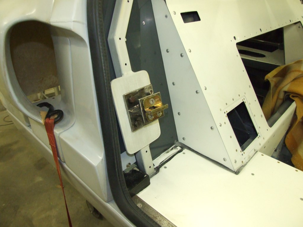

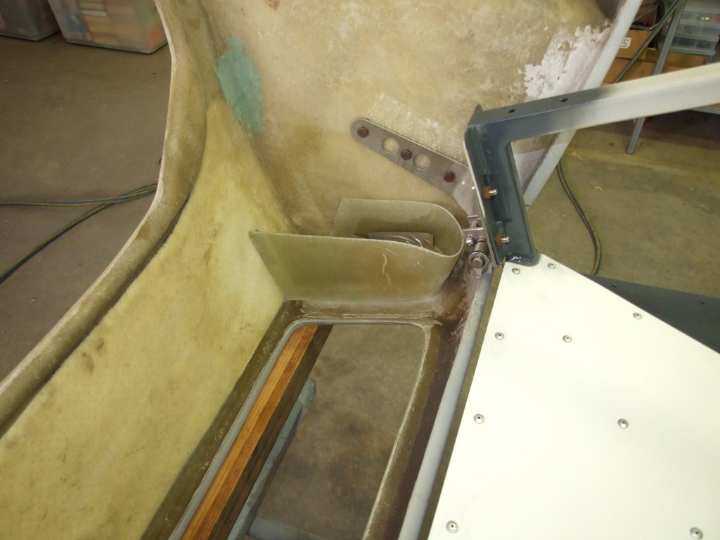

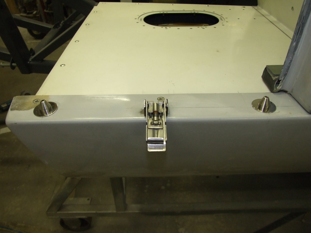

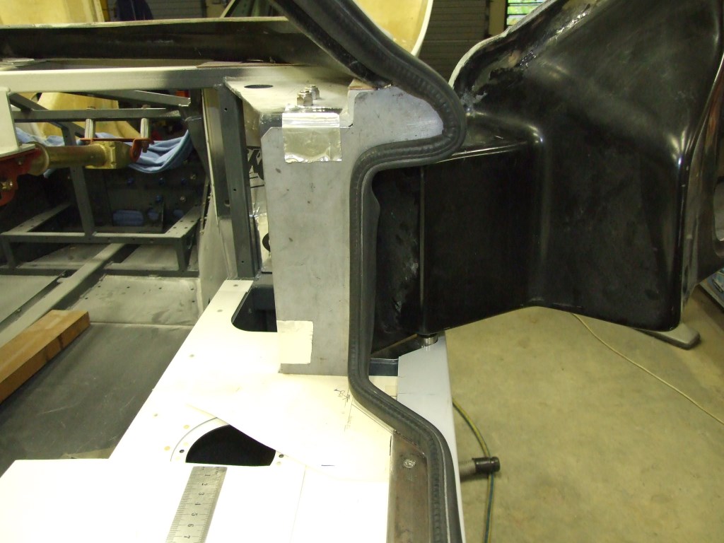

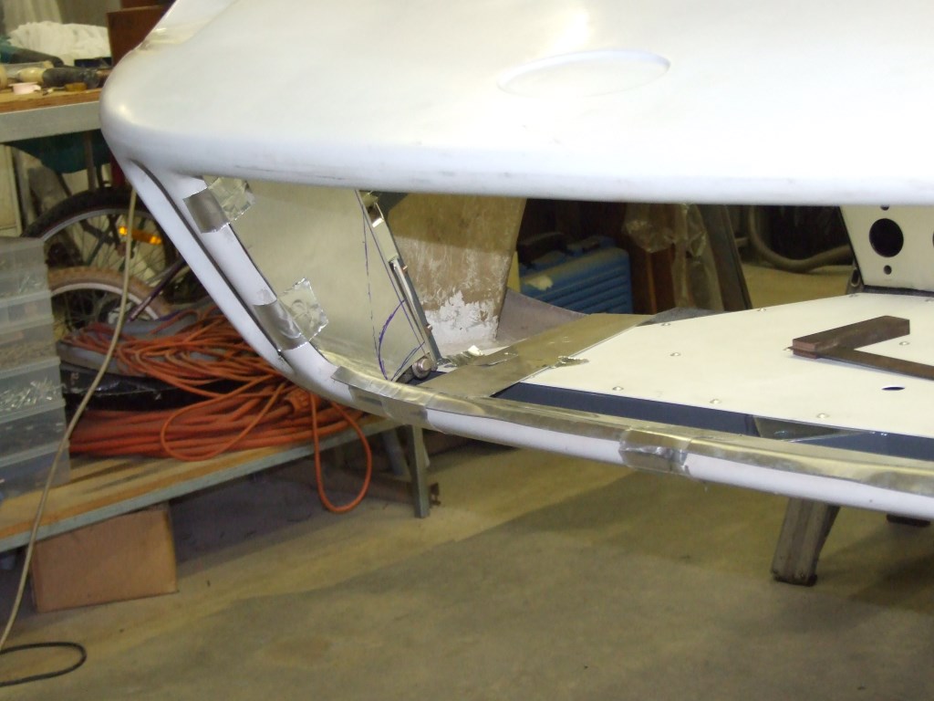

Clayton

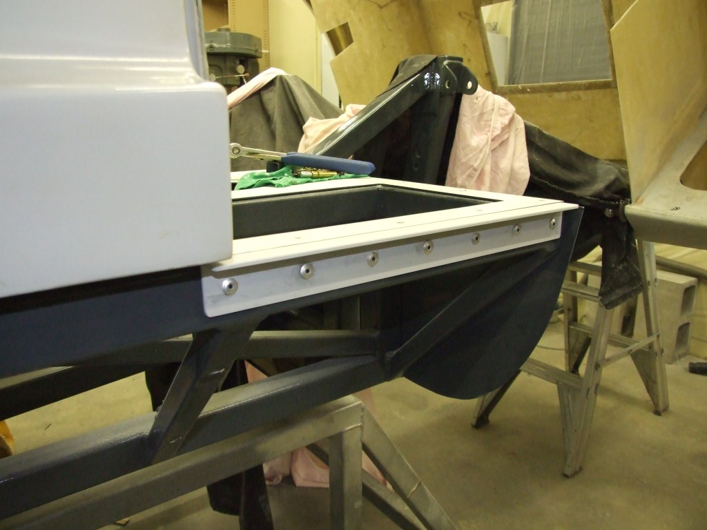

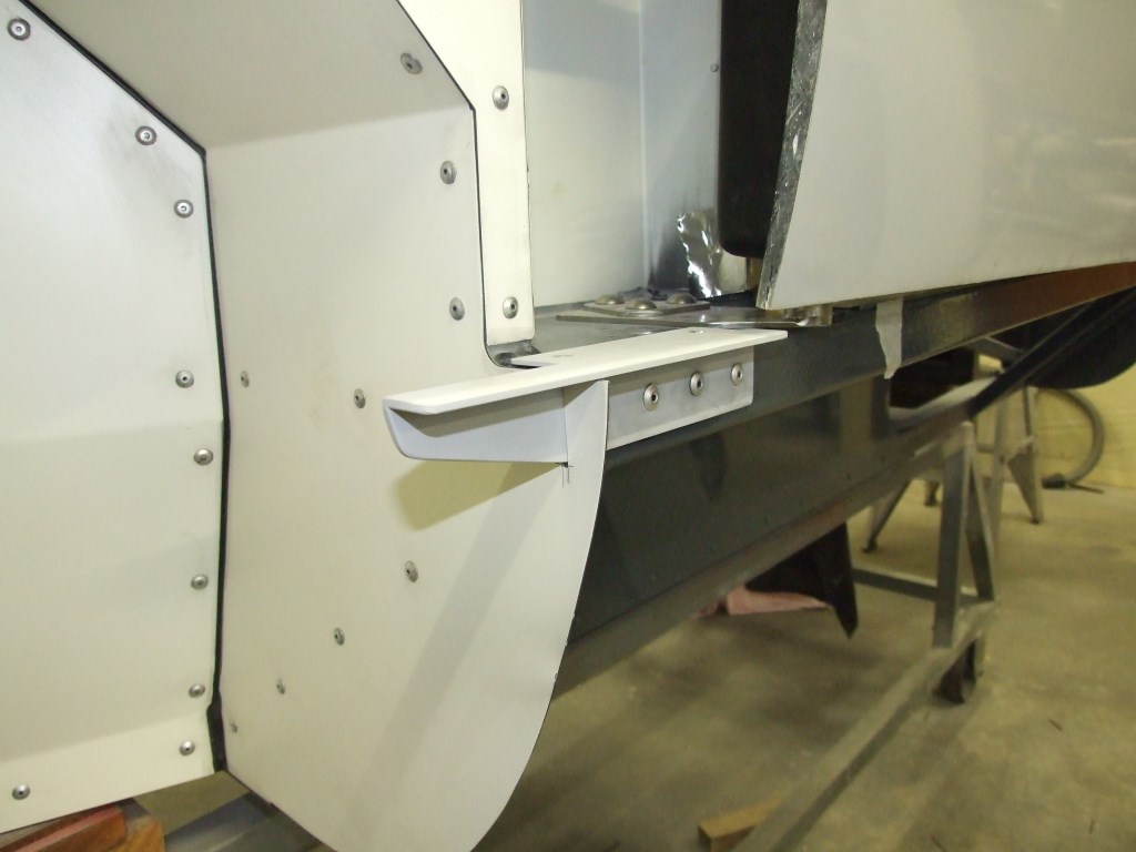

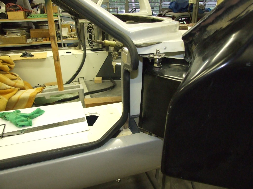

Had a small break from fibreglassing and the dreaded itching and started on the door seals, clips locks.
The over centre latches for the clips had nothing substantial to bolt to the chassis. Added angles to the chassis to support the sill panel at the latch mount.
The front door seal plates get sandwiched between the chassis and dash and follow the door inner skin. The sill seal holder completes the full door seal.
Clayton

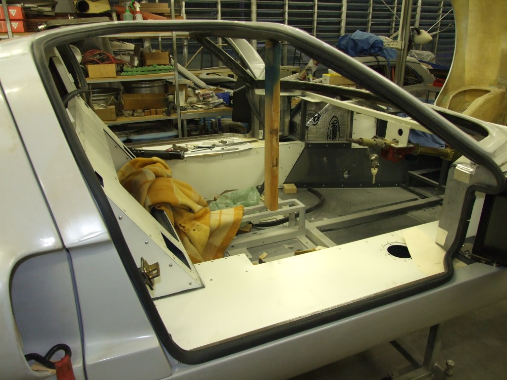

Clayton
In order to keep the door striker plates as short as possible (less chance of catching them while getting in and out. I added a 10mm spacer to the drivers catch and 20mm to the passengers catch so they just cleared the door seal.
Door rear edge rubbed on the door seal, cut it right back and re-glassed.

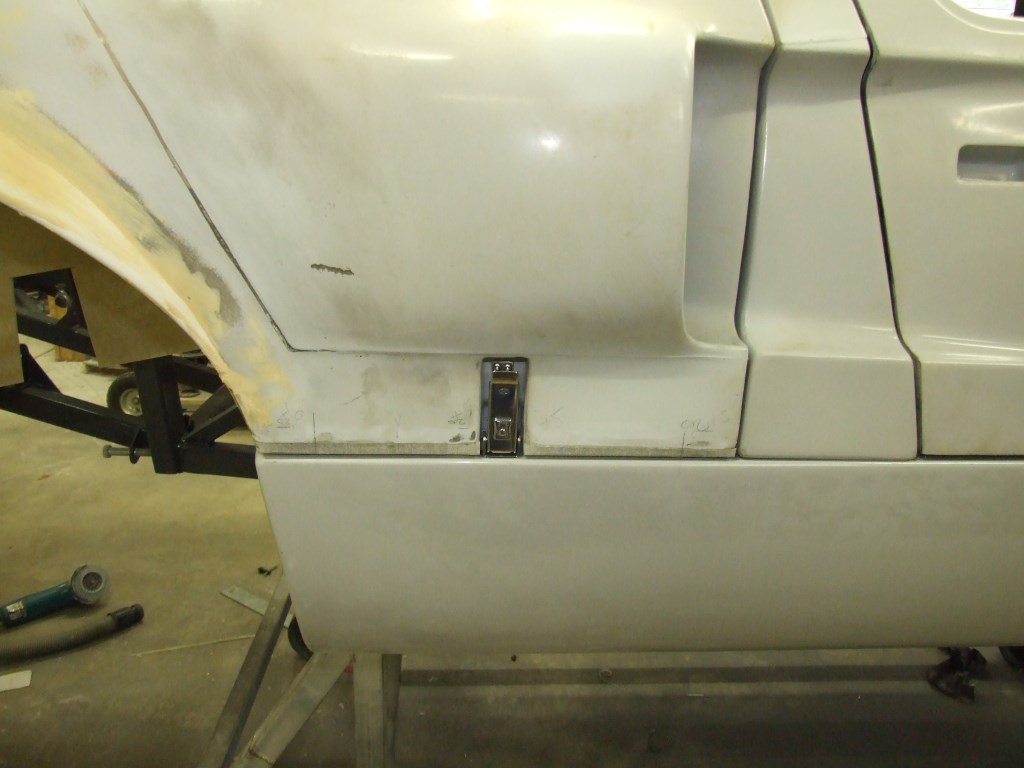

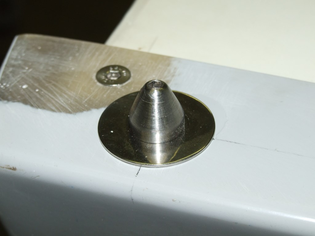

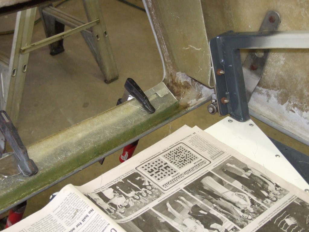

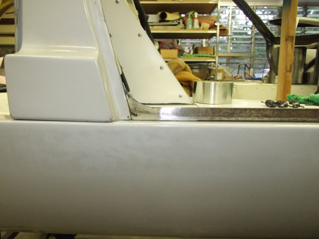

Clayton

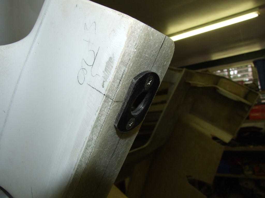

The rear clip needed quite a bit of extra glass added to the sill shut line area to bring it up in alignment with the spider.
Made some locating pins and receptacles that would hold the panel gap constant.
Pinched the idea from Chris (flatchat).
Clayton
