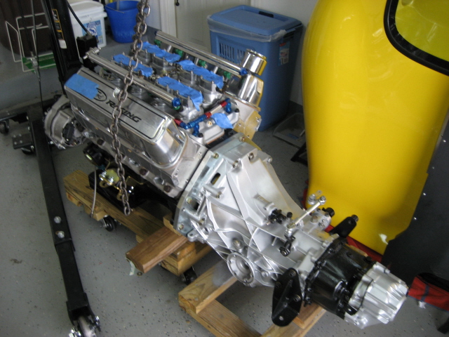

Spring is the time when mating begins, so I give you pictures of RF80's joining Ford SBF to Audi.
Peter

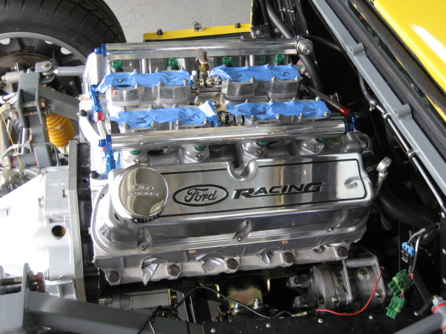

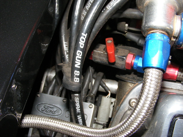

Just updating things. The engine is in and i am doing the hookups, target date for light off is end of April.
Peter

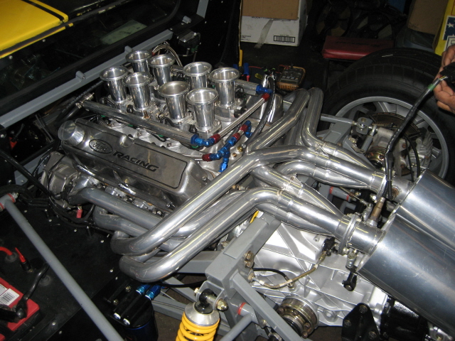

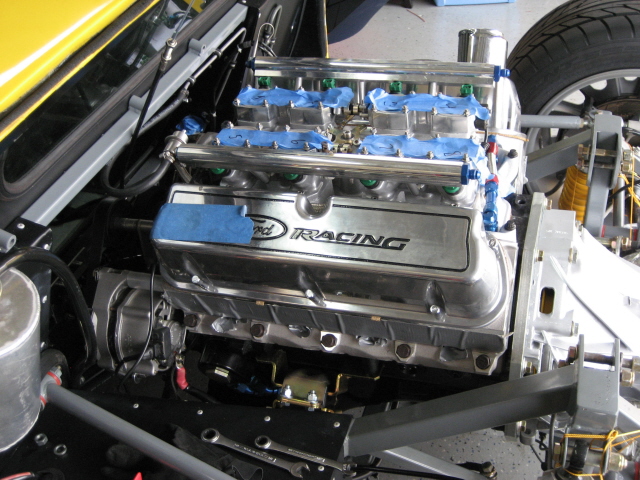

Well it's been a while since I have updated this thread, life, business demands and just plain sh*t happens have all conspired to get in the way of this project, but now I do have an update.
After weeks of trying to figure out how to get the motor running with the Motec system I had reached the point of thinking a gallon of gas and a match would solve my problems. In those three weeks I have heard more backfiring and popping, had more no starts and fouled more plugs than in all my 59 years of playing with cars.
Last Friday I went to SpeedSource Inc. If you don't know the name of the company, you might know the name of the owner who is Sylvan Tremblay. If not the name of the owner then you might know the number 69 and 70 Mazda RX8's that compete in the Grand American racing series, and until some bad luck were leading the GT championship. Im lucky because this professional racing shop is located 6 miles from my home.
When I explained my problem I was able to set up a meeting with David Haskell who does the tuning for the race cars all using Motec ECU's. Within one hour the motor went from a mess to purrrrring on all eight cylinders with unbelivable response, and this is on the first visit. After the first session he left me to correct the hookup of the Lambda sensors which were wired incorrectly in the cars other life. The second session is tonight were he will use the Lambda to dial the fuel maps in. The Motec system is wonderfull in its capablity but if you don't speak the language of the software it will never be right till you get someone that does.
With the motor running I will be able to complete the debugging of the car and then corerect the body fit issues and repaint the car.

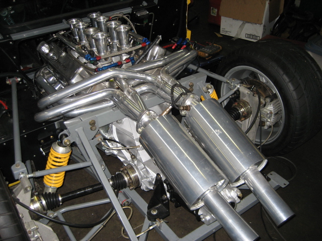

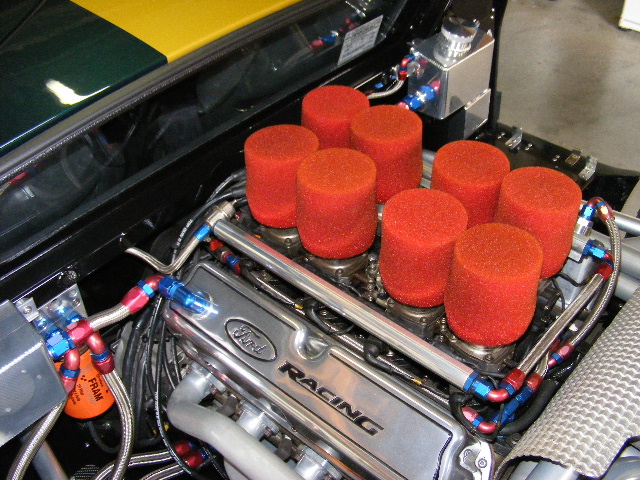

I have a DC&O inlet manifold the same as yours and experienced the same problem of not getting up to temperature. I tried blocking off the radiator but this did not work because as you stated the problem is caused by too much coolant by-passing the thermostat.
My solution was to fit an in line ball valve to the -6 hose from the rear of the manifold. This allows me to regulate the amount of coolant that flows to the front of the thermostat housing. eg about 3/4 closed in winter, 1/2 closed in summer and fully open if I run on the track.
Since doing this I have had no problems and the engine comes up to temp in about the same time as my other cars.
I have also had a problem with some plugs fouling and others not. The Motec guy up here has dynoed the car and told me it is very difficult to get the fuel map completely correct at road speeds and throttle percentages.
Because of a extremely slight difference in butterfly openings between cylinders at small throttle percentages this is what causes the uneven fouling in my case.
I have a M800 and to rectify this I have been adjusting individual cylinder percentages below 25%tpi and up to about 2250rpm. By perservering with this over time (I'm up to about version 50) I have improved the situation but it is still not yet perfect over all throttle percentages.
