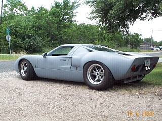

Your car looks fantastic. Could you elaborate on the emergency brake (I think that is what I saw). Is it wilwood? What is the part number? Thanks,

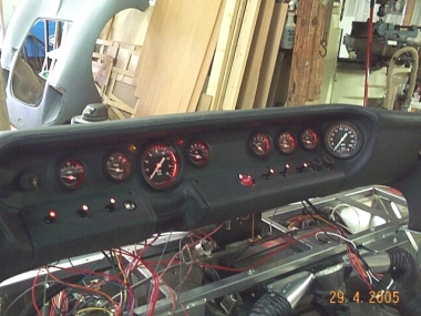

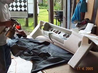

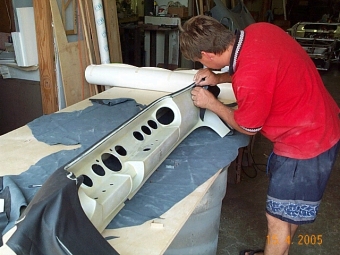

My brother who owns Vista Customizing in Corpus Christi Texas came up a few weeks ago and covered my dash with leather, he did a great job. Have most of the wiring & plumbing finished and the engine running.Hope to take a trip to the end of the driveway this weekend. /ubbthreads/images/graemlins/grin.gif/ubbthreads/images/graemlins/grin.gif/ubbthreads/images/graemlins/grin.gif

Faili, They are Wilwood Mechanical calipers. I will get the part # for you. I had to make the mounting brackets.

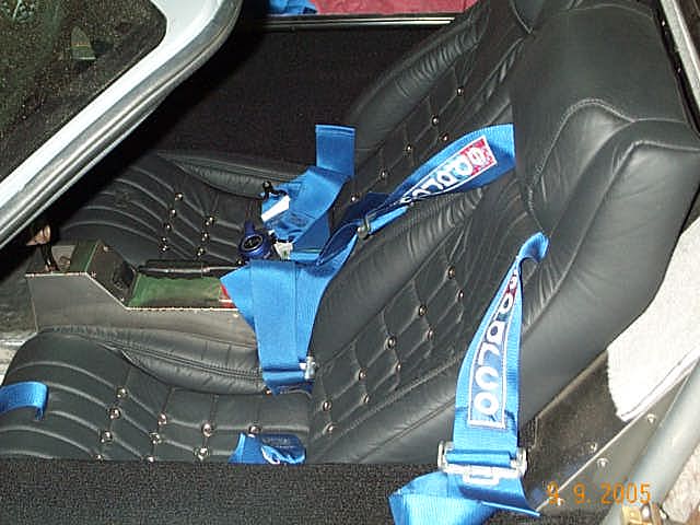

Trailered the car to my brothers shop in Corpus Christi to have him do the seats, not quite finished yet but they look real good and are really comfortable. He made the bottom and back a removable cushion so I'll have plenty of head room with a helmet.
He is planning on making a office chair in leather so if anyone is interested let me know.

I have put about 500 mi. on it and it has been a blast. /ubbthreads/images/graemlins/grin.gif/ubbthreads/images/graemlins/grin.gif/ubbthreads/images/graemlins/grin.gif

I very much like the stance as well. Pictures of Ross' car look very racy. Do you guys have problems bottoming out on on the street?
Ross Nicol
I think the stance of Simon's car looks good because he has used a wheel offset that fills the wide arches on the rear with 50 profile tyres.In my opinion there is nothing worse than wide arches that are not filled with fat rubber. As he says he could have fitted 12" wheels as there is a lot of room between the inner tyre sidewall and suspension.295 front tyres fill the wheel arches well at the front too.The motor / transaxle position doesn't affect the cars stance because ride height is set by the coilover/ shock adjustment unless I am confused as to the meaning of stance.Very neat job Simon.I have remotely mounted my Tilton resevoirs slightly higher than the wheel calipers as gravity plays a part with the fluid flow.May only affect blleeding though.Just thought I should mention it.Let me know if you want a pic of my setup.I don't have bottoming out problems John but then my spring/wheel rates are tailored for track use and are quite stiff.I think 15" wheels and tall rubber looks tough and my cars 17" wheels and low profile tyres not as tough or period but there is little race rubber available in 15" here in OZ.
