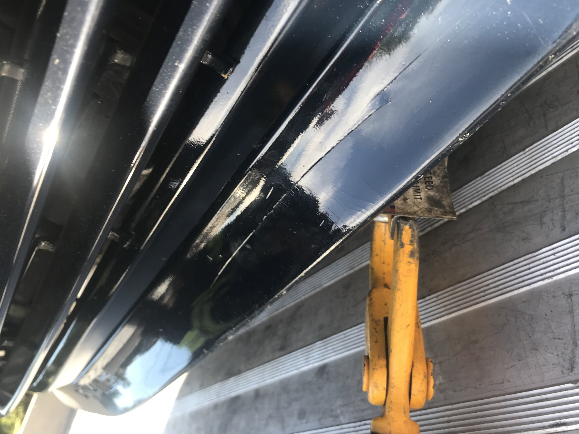

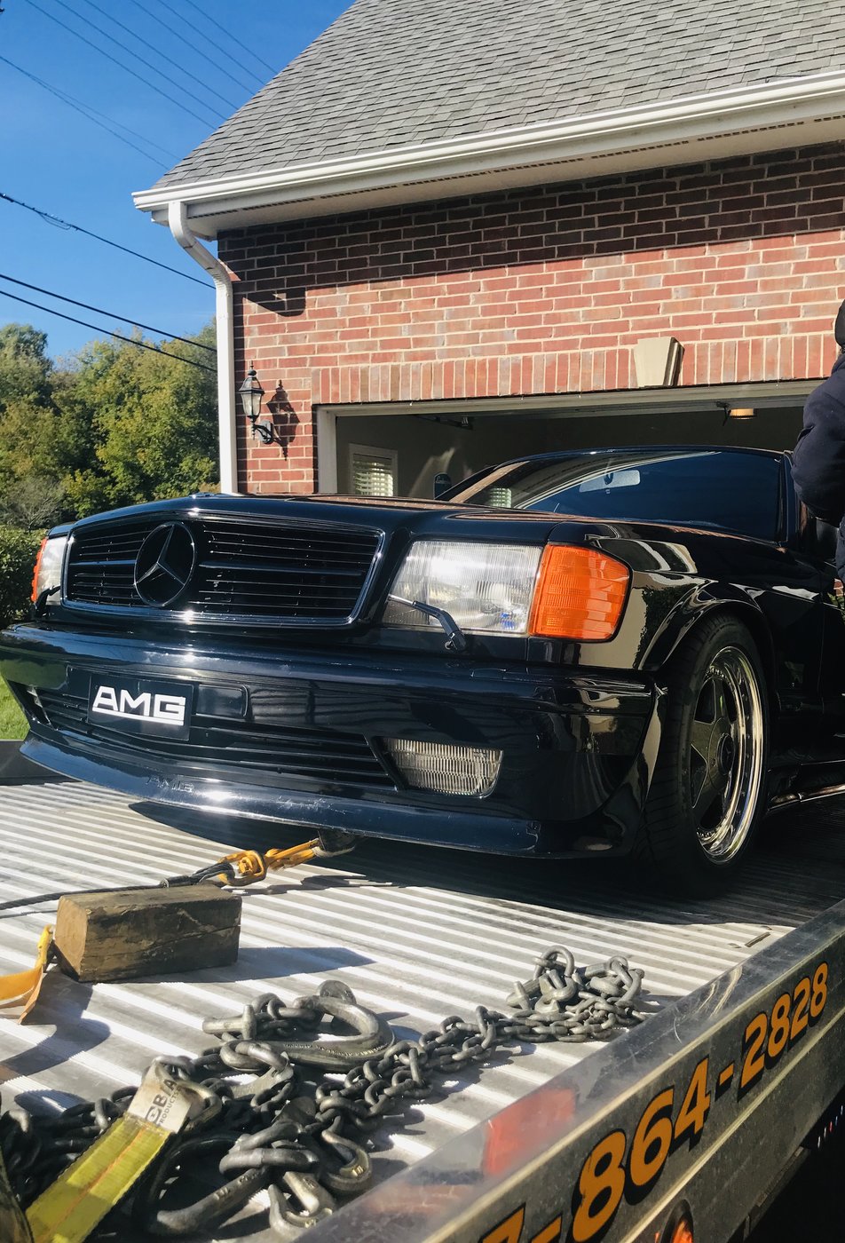

Also always take before picture just in case. I had towing companies on 2 occasions crack a front bumper on my cars. And I made sure I asked all the questions and asked to send a guy with proper equipment. Both times drivers denied they did the damage and claimed it was there before they touched the car. So frustrating.
