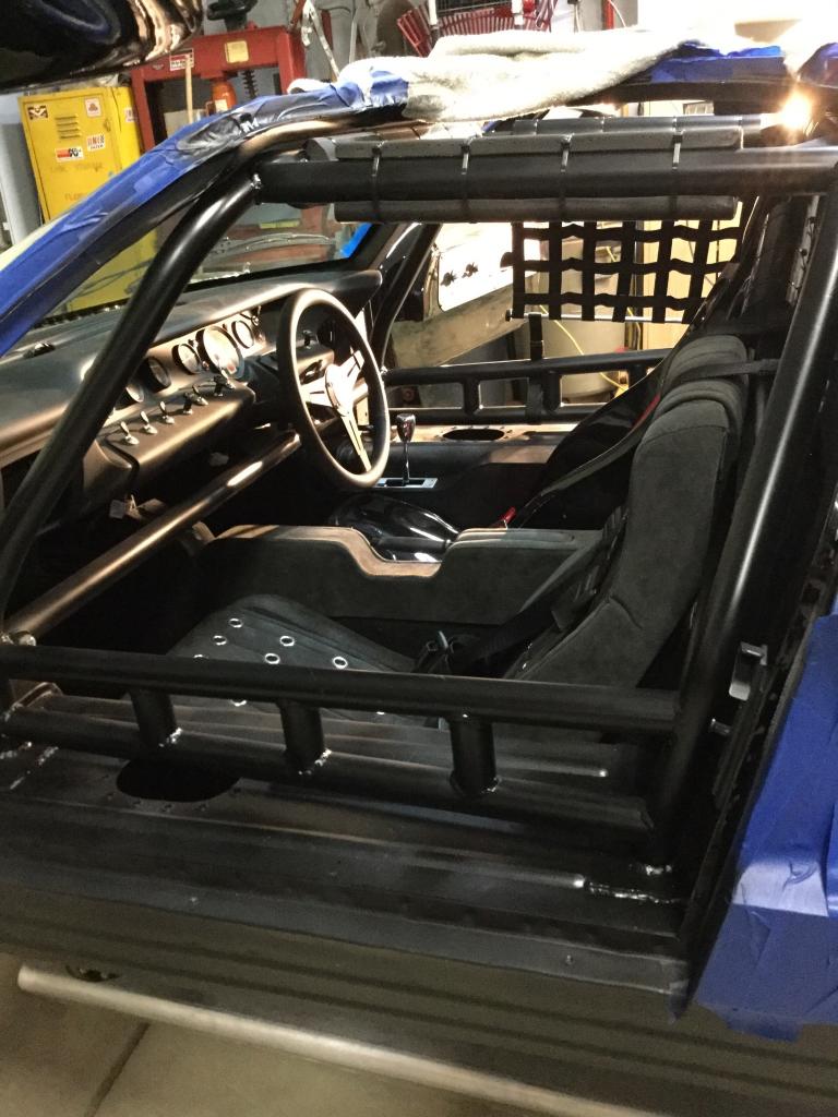

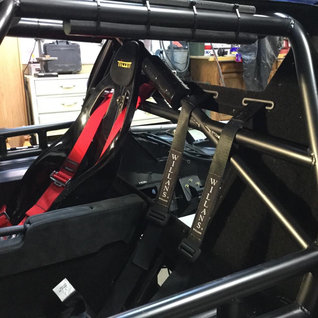

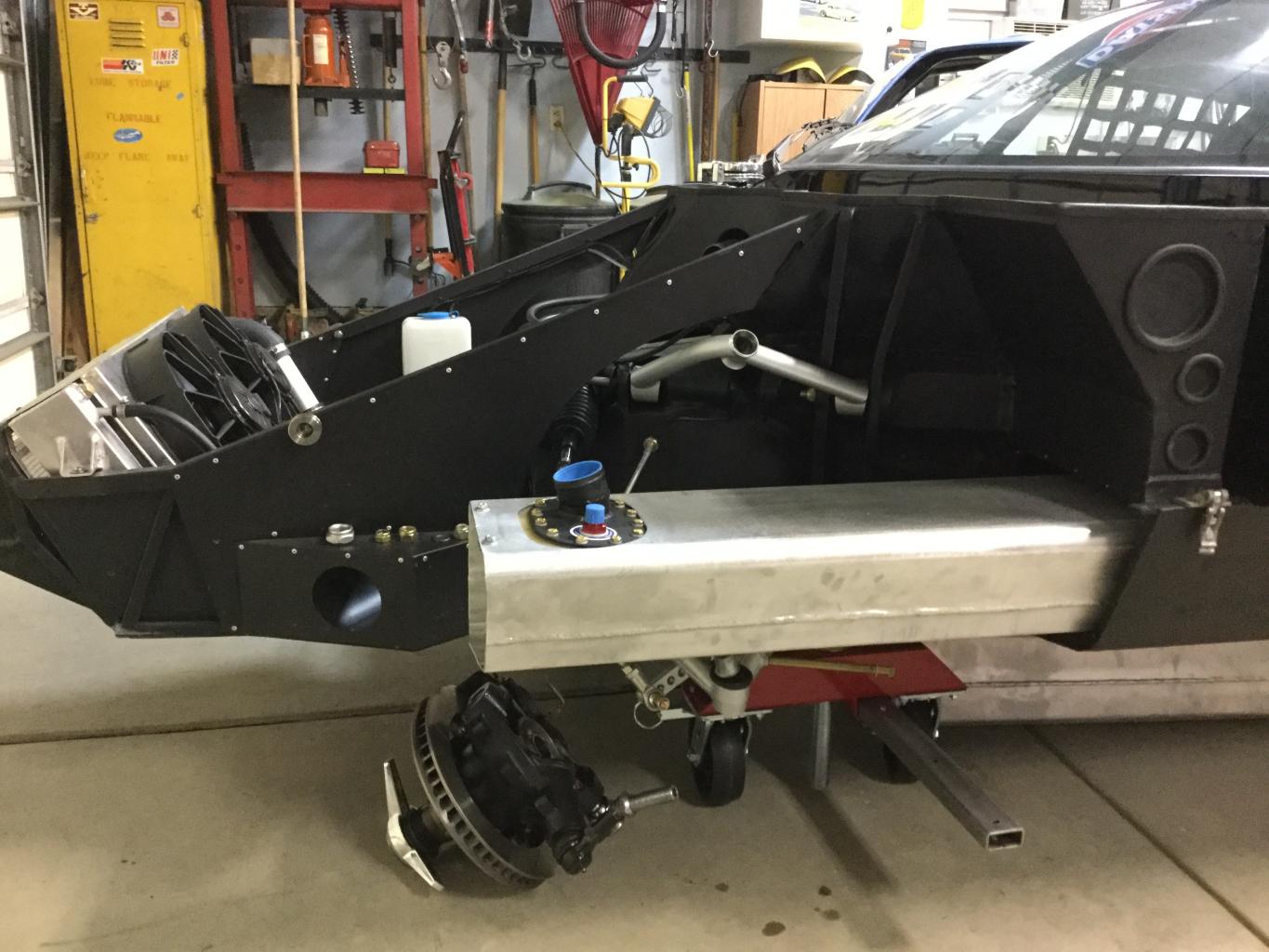

SCCA legal cage and fuel cells are installed and approved by tech inspector. I made some compromises here. Most notable is the position of the forward down tubes. I wanted a future owner to be able to cut the cage out and return the car to "stock" trim so I did not cut into the dash or doors in the hinge areas. I also wanted to have a lateral bar near the dash. Mine is removable. Also the door openings are traversed by forward connecting tubes as required by the rules. All lines of sight are unhindered but make no mistake, this car is for a small and wirery driver like me. This cage, too, is very strong. Now on to the kill switch and fire system. First, I must qualify my 240Z for the Runoffs at Indy. Decisions, decisions!

I'm curious, is it normal practice to place a bar across under the steering wheel and over the thighs? That seems like it has the potential to pin the driver if that bar was slightly crushed down to the belly pan?
attachment.php
It is absolutely required by the SCCA and I believe FIA. It keeps the cage in place should you be T-Boned,

Hello Larry Great Looking Build and strong Cage by the looks. Which Model Tillett Seat did you go with. I'm currently changing my seats and have some Tillett Seats Ordered .... Hoping I have chosen wisely??? I have gone with B6F
