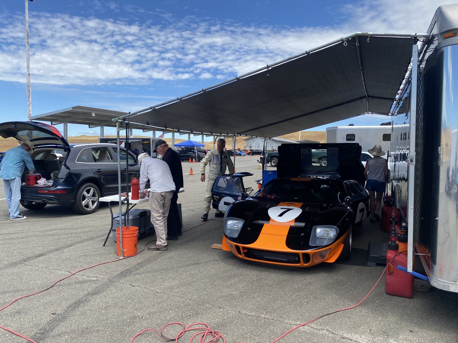

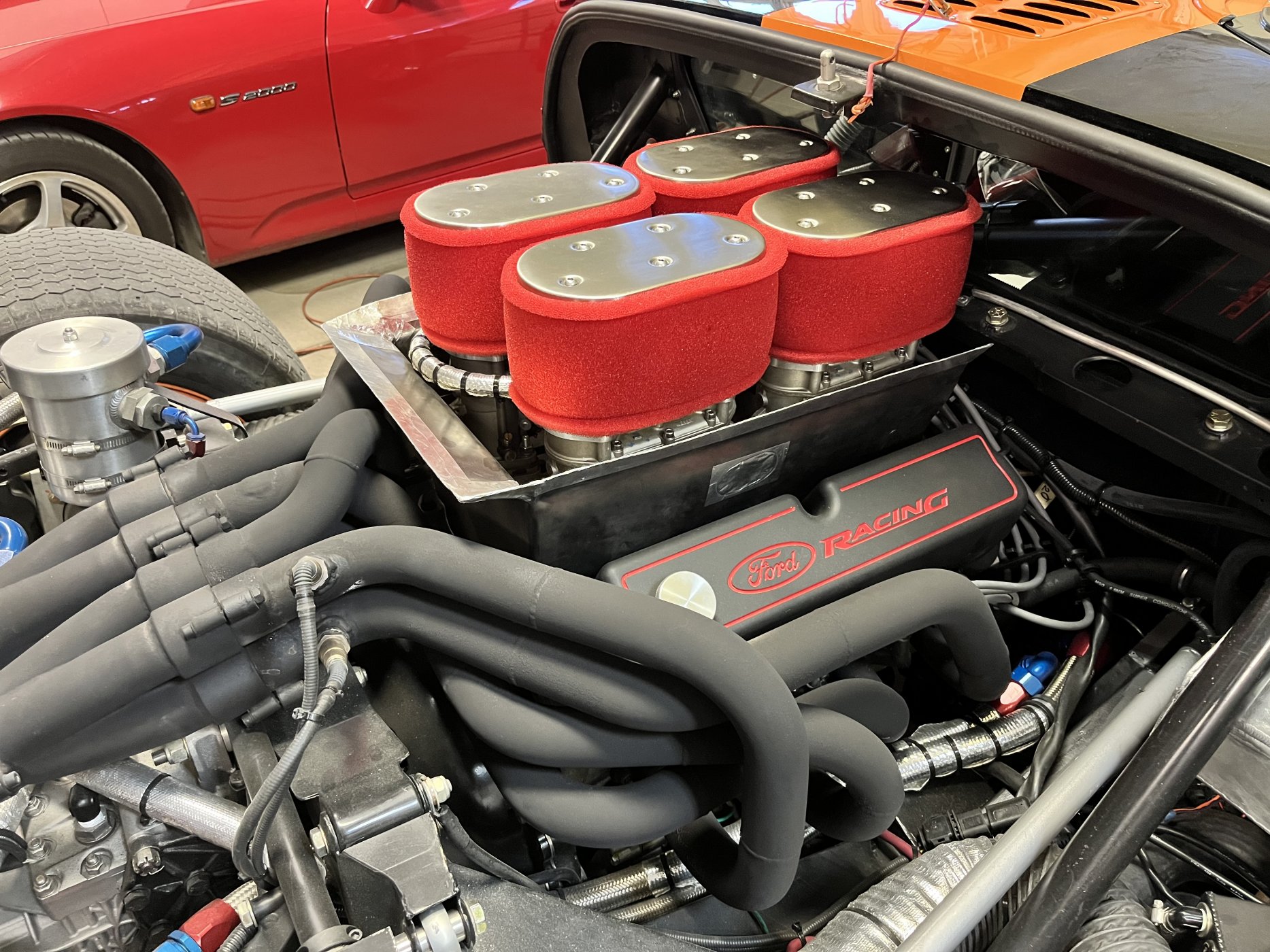

Just got my SCCA log book for class ITE last Friday. Unfortunately, on Saturday, I hit 104.8 db where 102.9 db is the max. So I had to park it. Anyone have any ideas what mufflers might do the trick as the Superformance ones just don’t cut it.

I think the most effective silencers are going to be the steel wool / fiberglass packed chambered mufflers - I have seen people also add the SuperTrapp disc mufflers to the tips of the tailpipes. Must use a shield, however, to keep the blast from being drawn up to the bodywork of the rear clip.

Great to see it finally finished and on track! On the Pantera I used inserts (spirals and vortex cones) with two angle tips pointed away from the sound meter to ensure I was below the 103dB at Thunderhill. It might have been overkill, but I never got pinged and I haven't been back (engine rebuild) to test further with removing one part at a time.
