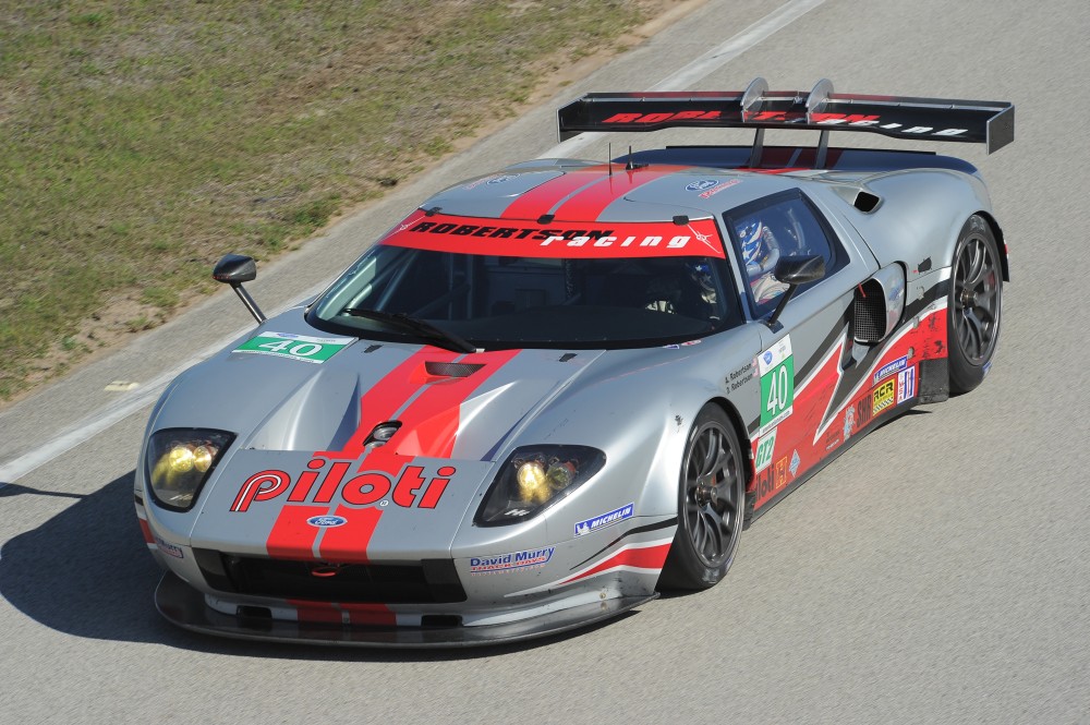

The Robertson Ford GTR ran two one inch tall by four inch wide slots to cool their much larger brakes for Le Mans. Picking a high pressure area is part of the key.
Remember you can over cool rotors , hence the mk2 gt40 pulling air from behind the radiator to prevent such dramatic thermal shock cracking brake rotors
I found a pic of it. I am guessing you are talking about the two slots right where it meets the splitter.

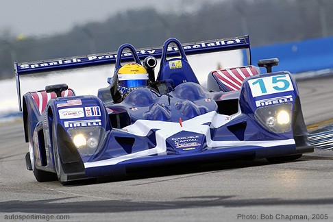

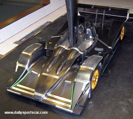

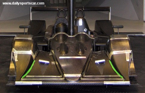

Here is pretty much what I was thinking. Either on the top of the ramp like these or in the vertical inboard side of the fender enclosure. From Mulsanne's corner website.

My 2 cents, which is actually worth less than half that, is that the various mock ups are kind of visually disruptive. I know aerodynamics causes some weird looking designs sometimes, but aside from these latest additions, what you have done has remained visually nice.
In that line of thinking, either the NACA ducts under the winglets or just routing from the inside of the radiator opening under the bodywork would look the nicest.
Maybe that thought would change once they are created and painted to match the body, but as they are now they look a bit odd.
EDIT: had another thought - what about just using the existing leading edge of the bodywork between the radiator opening and the pontoon fronts? Might have to increase the height of it a little bit, but the point being it'd still be flat on the top and the same all the way across. Possibly only a portion of it could be opened for the ducts and the rest left solid, kind of like the Robertson car.
