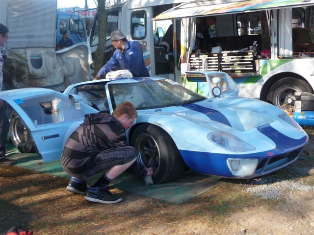

Pics.

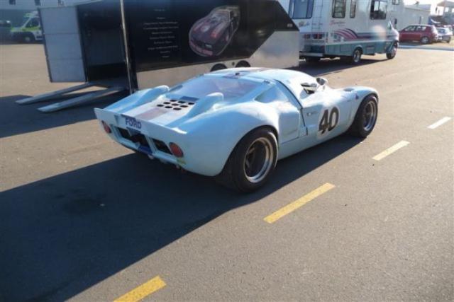

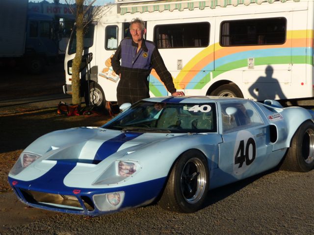

#1 The car almost ready to go again after the Race 1 off
#2 Someone has to be the supervisor.....
#3 Long shadows on the dummy grid before the last race
#4 Happy driver, intact car, after the last race.
#5 "The A Team"

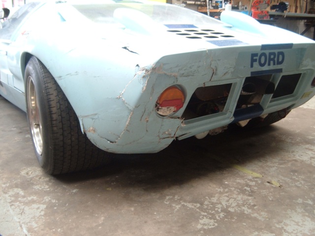

On the second to last lap coming out of the hairpin I saw the race leader about to lap me and between the esses I moved off the dry line (well not really dry, just not as wet as the rest!) so he could go through easily.
Ok, so now you have learned the same lesson as I did, i.e politeness can be detrimental to your cars health. In my case it wasn't my car, but it was detrimental to my pocket.:sad:
Formula Ford, Ingliston, my best mates Crossle, warming up in practice, I kept out of the way of a fast lapper, unfortunately I went on the large collection of marbles at that corner and understeered into the barriers, taking a corner off in the process.:embarassed:
Keep up the good work, but don't be so polite that you throw yourself off the track:thumbsup:
Dave
Dave

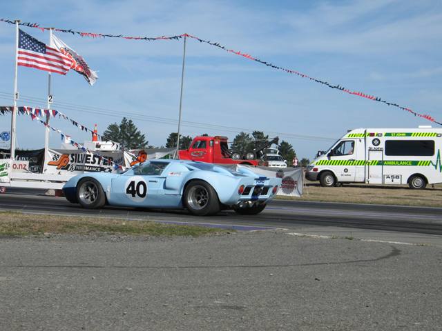

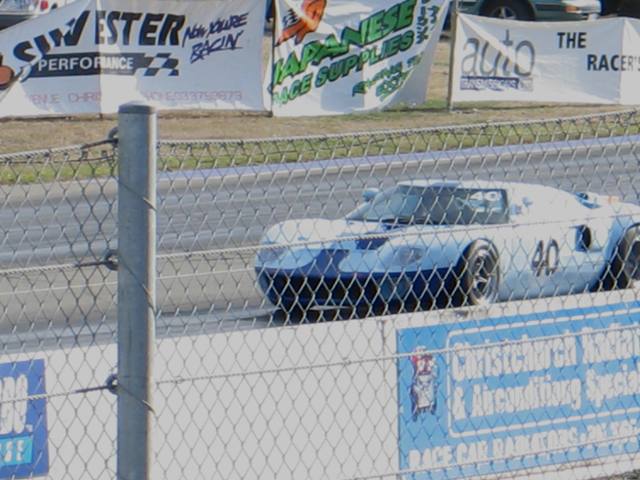

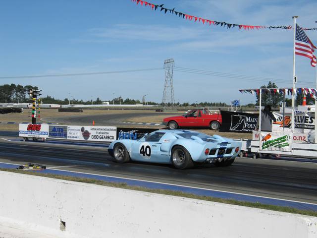

Lim's just sent me some photos from the drags
#1 Waiting in the pits. The pits were a bit more primitive than I had expected..
#2 Waiting, about to stage
#3 Waiting, staged
#4 Action
#5 Waiting, for the next run
#6 Next run, inching up to the line
That pretty much sums it up, lot's of waiting all day for about 48 seconds of action

Good pics...
Amazing to see the GT40 being totally dwarfed by a Capri... :)
Or was it the camera angle... :D
