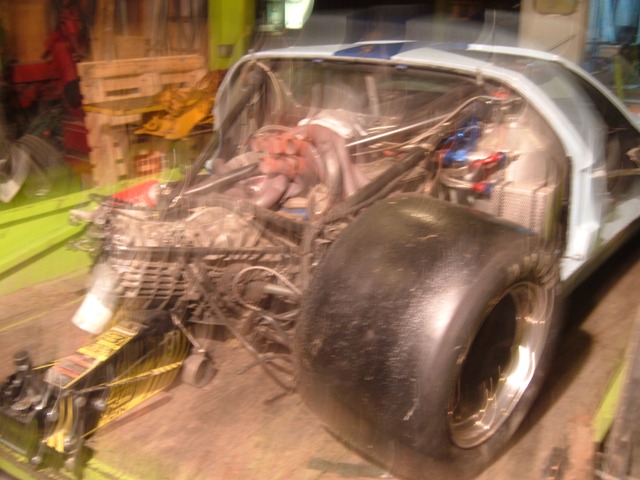

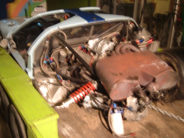

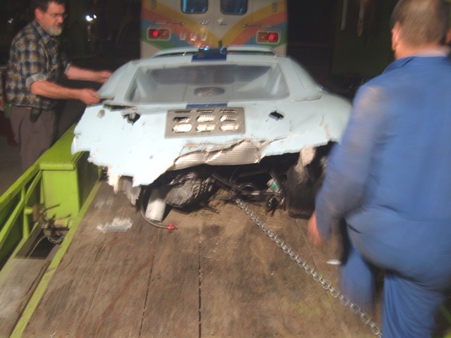

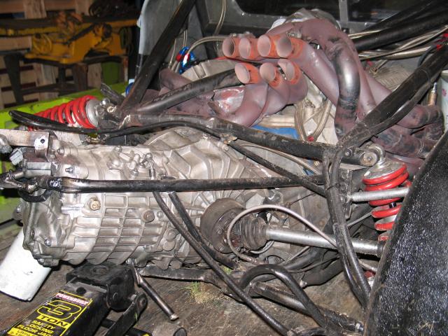

Car is a total rebuild from the firewall back. Plus both doors torn off and minor front damage. Preliminary inspection reveals transaxle housings are buggered as is one wheel, one shock, upright, exhaust pipes, muffler and most of the rear fabrication. Probably clutch and maybe flywheel too.
At this point the wheel is the major problem as Phil Smit said at one stage he was not producing any more 14s. I will fax him tomorrow.
We will start work on the car tomorrow night. Strip out the back and fully assess things. Aim is still SFOS. Whether I can get a medical clearance to race by then is another factor though.
Batteries in camera have gone flat but will post more pics shortly

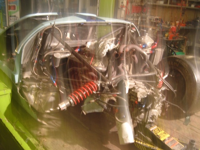

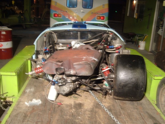

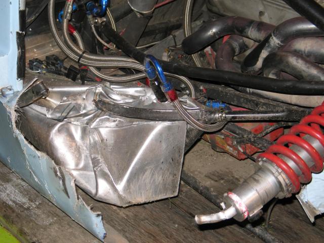

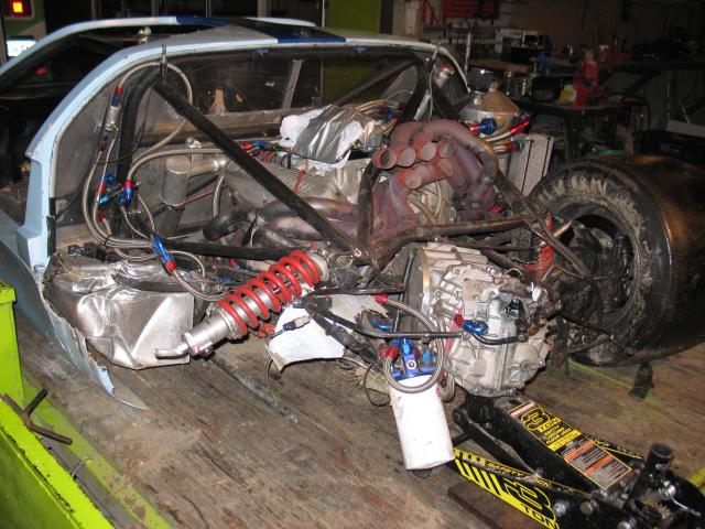

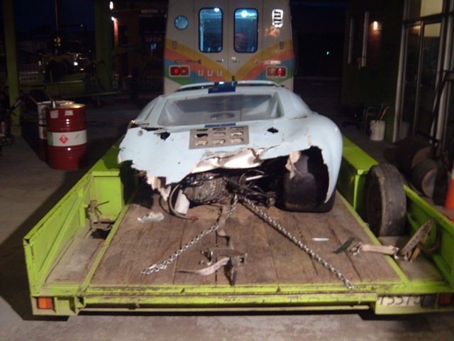

Russ Noble

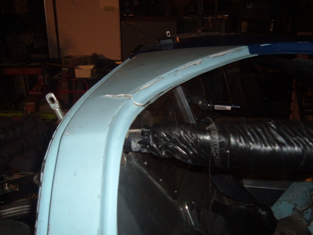

As promised some pics the car. 2nd to last pic is damage to the roof spider caused by my helmet (and neck). Thank goodness I was obsessed with lightness as thicker fibreglass may well have not broken and caused more serious injuries. As it was, helmet was split.

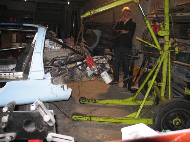

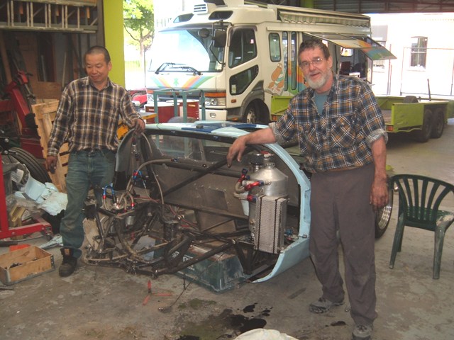

Well, the A Team of Lim and John couldn't wait to get on with the job tonight. Got it stripped out pretty quickly. Just as well they had me to supervise ;) Last pic is the completed strip out. It appears the front and rear engine plates have held everything in perfect alignment. Only the chassis behind the rear engine plate is deformed also the LH side pod and fuel tank. Will rebuild with some minor improvements for accessability and removal.

Interestingly, I noticed the rear trailing arm was bent up pretty well. Can you provide some data on those arms. It is nice to see that piece fold up rather than break the mount and spear anybody sitting in the seat. I'm currently using 1 1/4" diameter .125" wall tubing, but considering 1" diameter .095" tubing instead. Would you care to opine on this (aside from the obvious weight reduction)?
