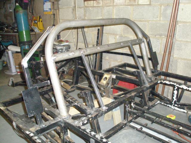

Hi Roger
If you're going for a full roll cage, why not get a horizontal bar added to the main rear hoop to take the fixingss. The attached is what I've done on my Tornado chassis
Regards
Andy

Andy, great job on the roll hoop, inspires confidence.. What struck me about Rogers post was the shoulder strap angle which seems to makes sense as under extreme situations, you want the straps to keep you down on the seat. I was thinking of reinforcing or replacing my existing horizontal bar which is not man enough, so this has raised another point for me to check later today. What angle will your arrangement give?
Roger, when I sit in my seat, my shoulders are slightly higher than the back, just enough not to need cutouts, but I may need to rethink if there is any substantial upward angle..
regards
Dave
Hi,
Many thanks for those thoughts
I too have a horizontal bar in the RCR roll cage but a trial fit left the shoulder strap mount too high - I'm 5'10" and my wife is 5' 2" - the mount needs to be around 2" lower. Putting in another lower horizontal bar would push the seat back forward by around 2", not good. The current bar is positioned just above the seat back which slots in neatly below it. So I'm thinking of putting a strengthening horizontal channel section bar behind the bulkhead and screwing snap hook eyes into it using supplied anchor plates. There's just enough depth in the seat and padding to accommodate the hook and eye on the inside.
regards
Roger
