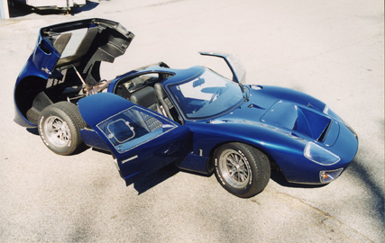

PS: Here I'll post some pictures I took near my home. This is why I called her "BLUE BEAUTY".
