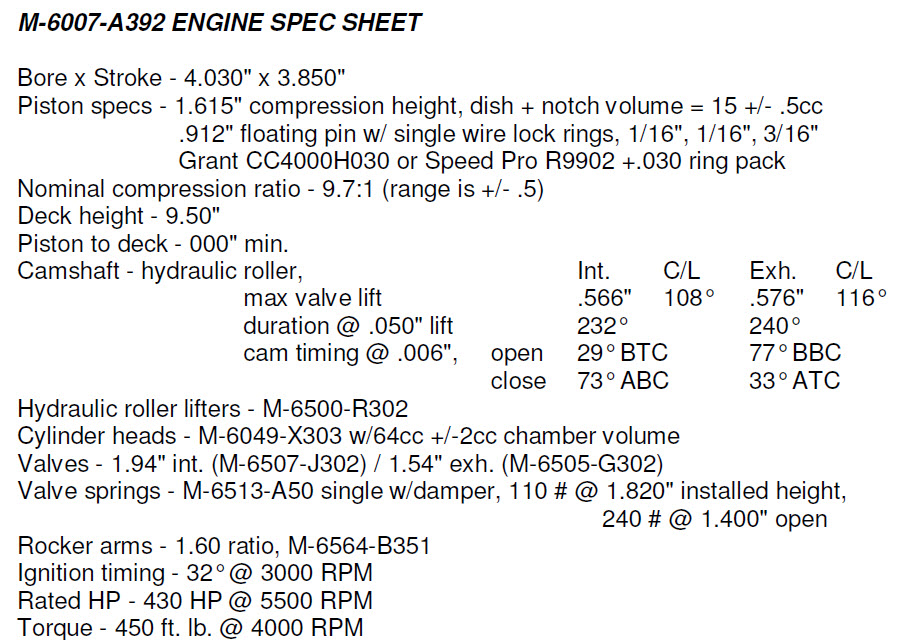

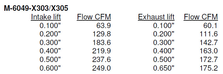

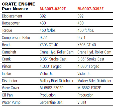

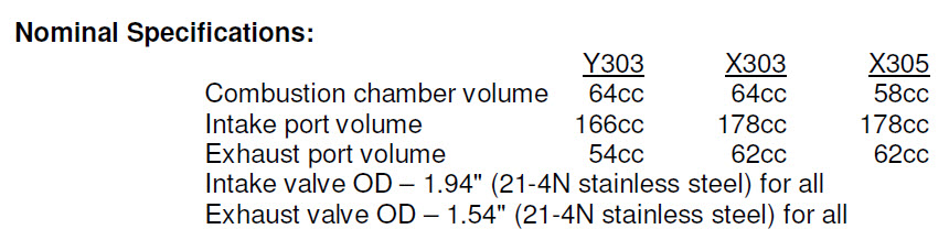

Mine is a Ford Racing M-6007-D392E crate motor circa 2006, with Weber 48IDA induction and MSD 6A ignition. Specs are shown below. Not too dissimilar to your target specs, but nowhere near your target HP/TQ numbers. Should be helpful to you as a basis for comparison.

Phil,
Cam I'm looking at is a bit more aggressive and heads I'm looking at flow about 18% more. That may be what pushes mine higher. But sounds like a solid engine. I'm hoping that what I build will last a long time. I don't relish the though of having to pull it out every year or two to be freshened up.
