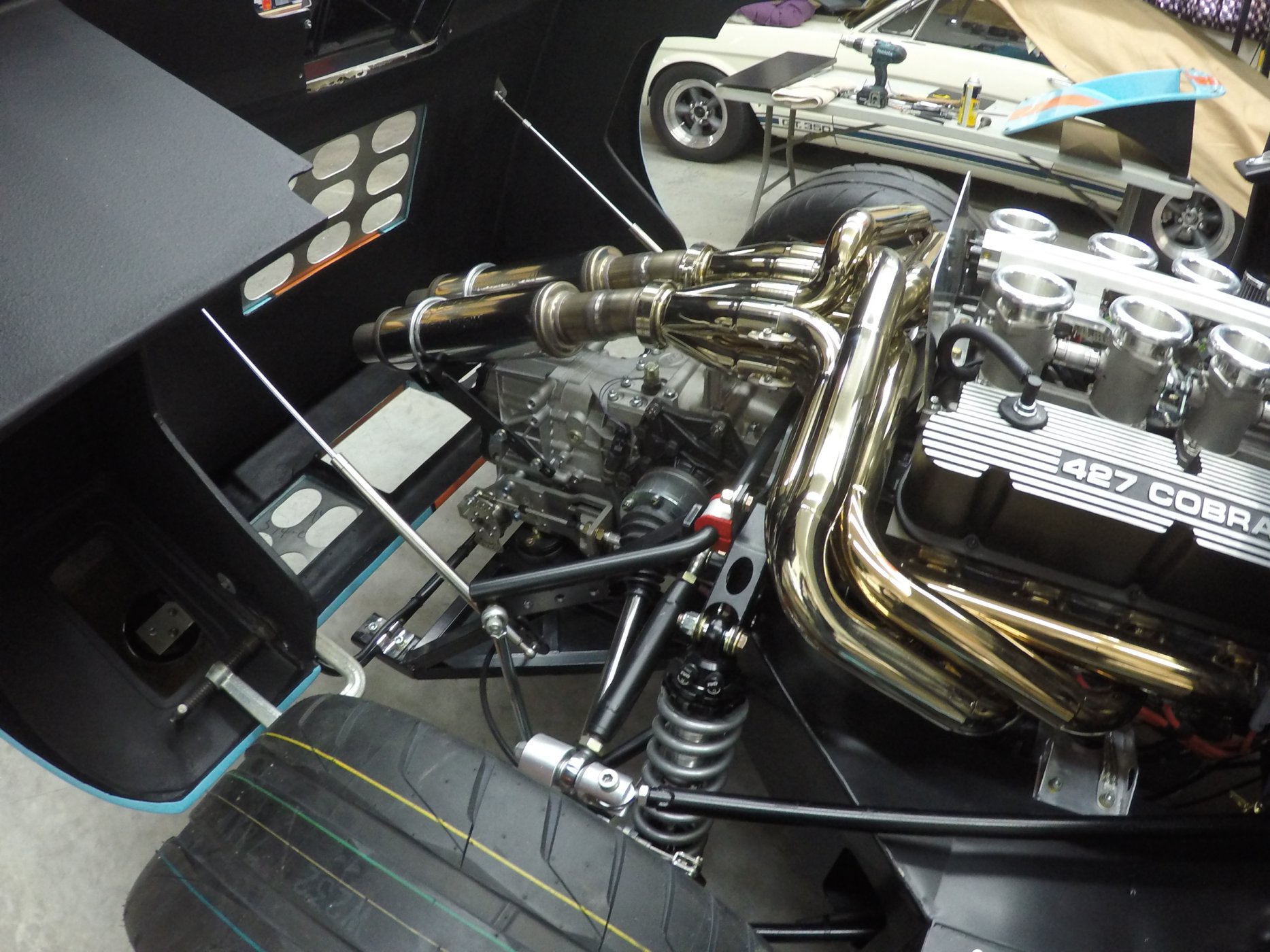

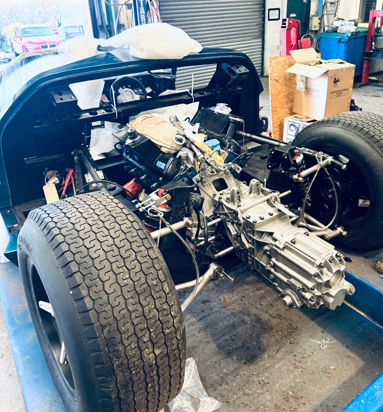

427/ 482 cid stroker FE shelby aluminum block

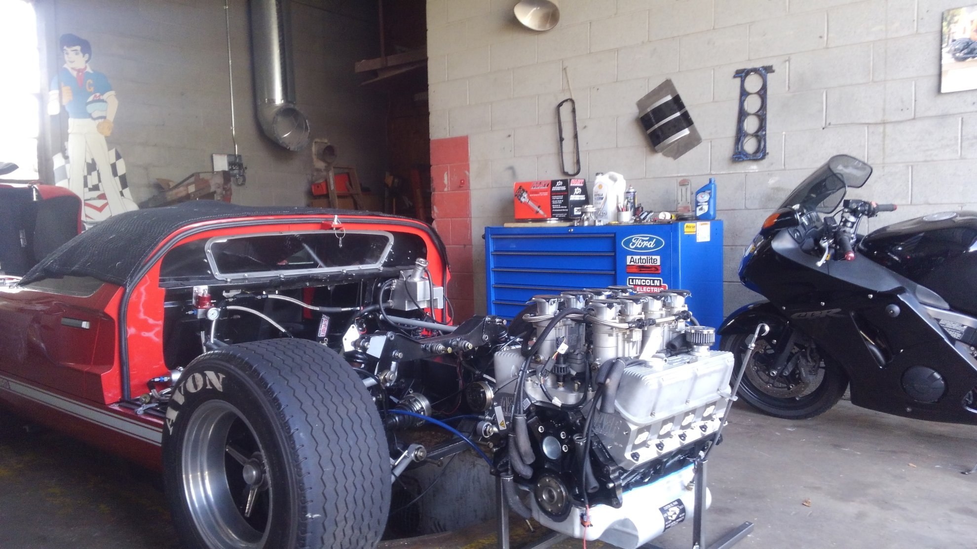

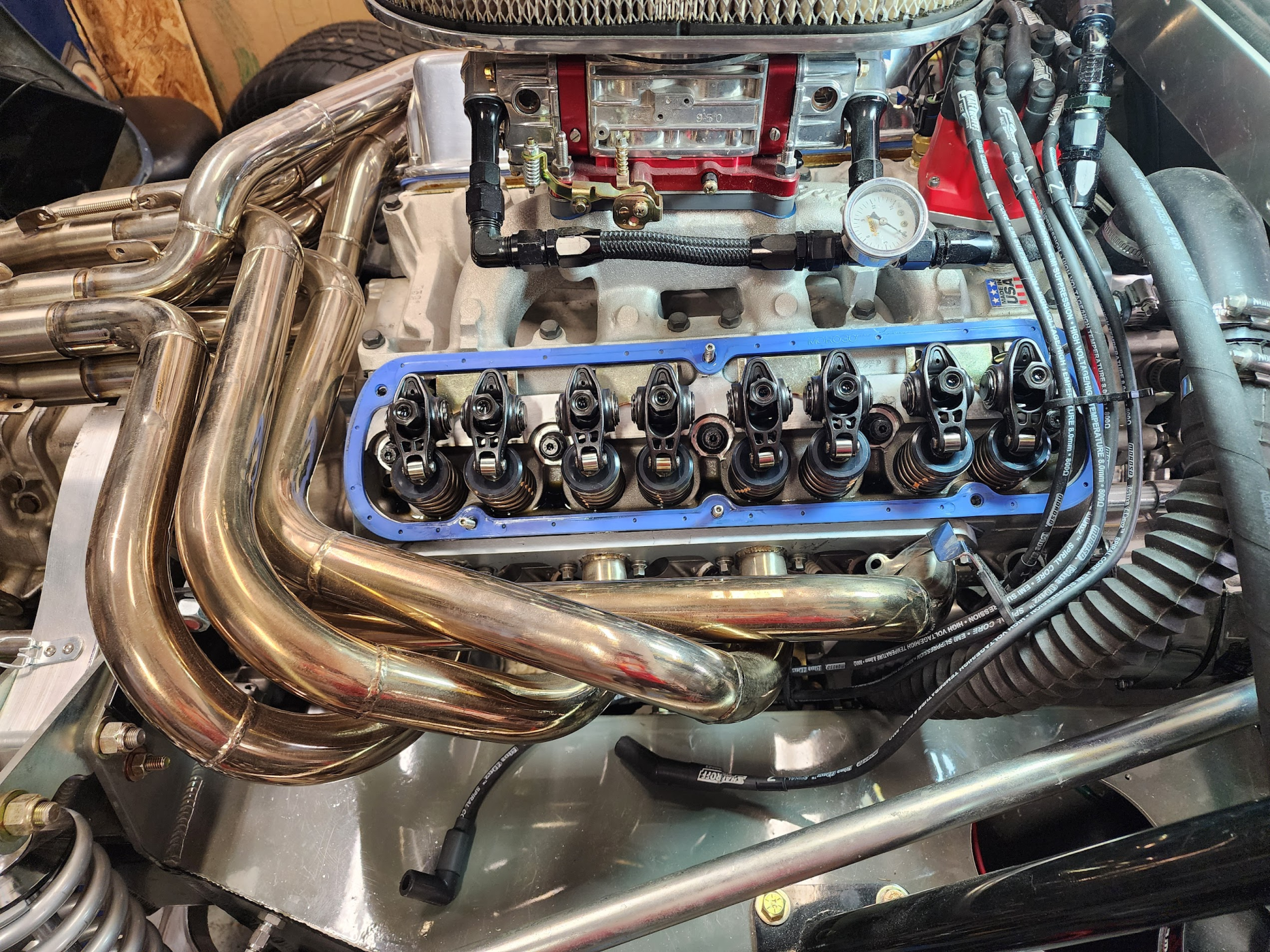

383 CID Donovan aluminum block, Dart Pro-1 heads, Edelbrock 4+4 intake manifold, Proform 850 cfm racing carburetor, Crane HI-6 ignition. This is not a GT-40, of course.

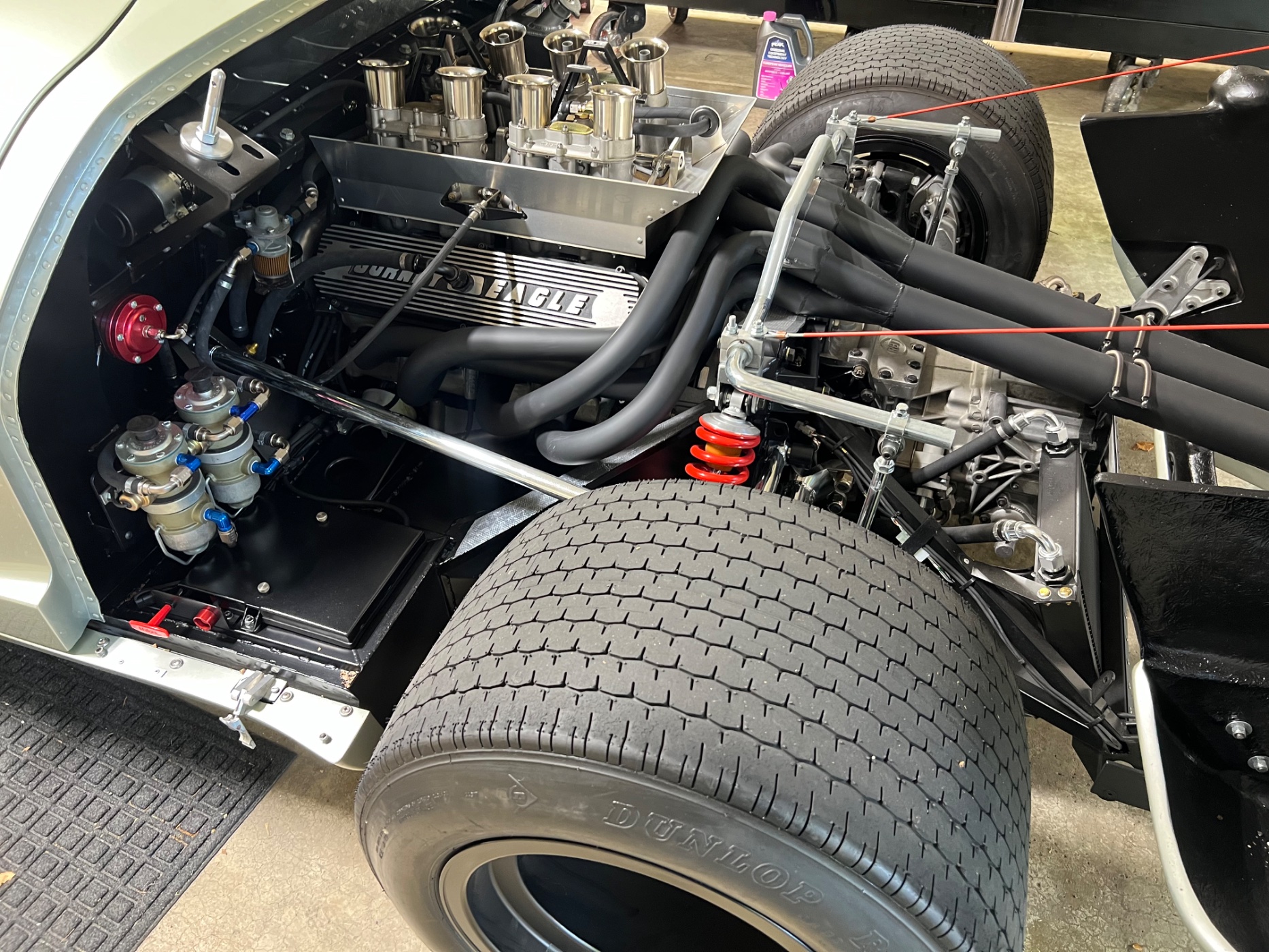

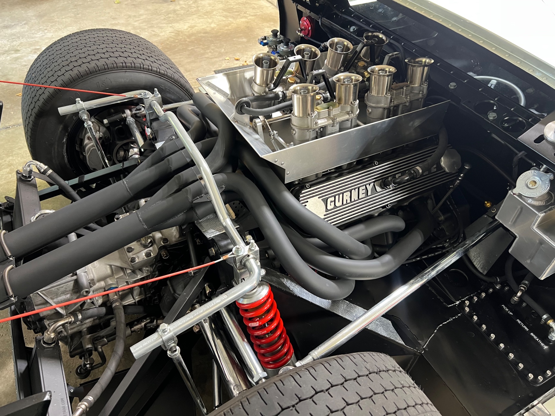

My engine was built by Prestige Motorsports in Concord, NC. 363 Ford Super Street Series Engine, 515HP Dart block, hydraulic cam and lifters, AFR ported aluminum heads, Borla Eight Stack injection and Holley Terminator X EFI.

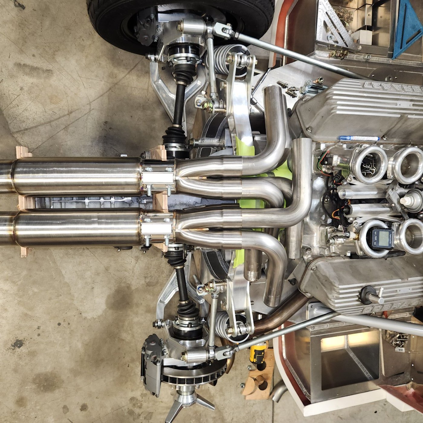

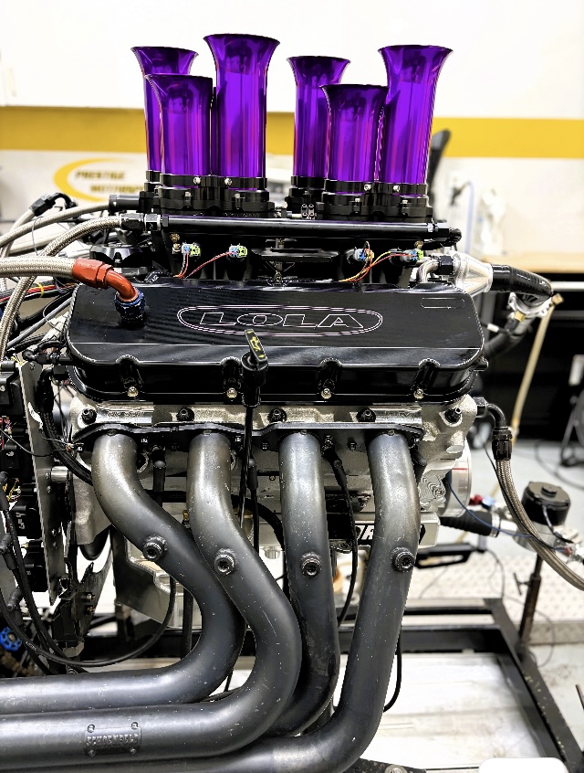

Some quick specs on it are as follows.
Brodix Hipped .400 tall block
4.600 bore
.400 raised cam
60MM roller cam
.937 Bam coated roller lifters
Callies 4.375 Magnum crank
Callies Ultra I beam connecting rods 6.700 long
JE custom pistons with coated skirts and lateral gas ported.
DLC coated wrist pins.
Manton 1/2" taper pushrods.
Brodix 24 degree SS 360cc heads CNC ported by Prestige,
Crower shaft rocker arms.
Custom fabricated road race oil pan by Moroso equipped with a 450 watt pan heater
Innovators West 7" internal balance harmonic balancer
Jesel belt drive
Moroso billet valve covers CNC'd with a LOLA logo, and machined for valve spring oilers. You can see the pressure lines on the back of the block. Valve cover oil returns both side back to the oil pan.
Custom built Kinsler EFI. Big shout out to Brad Cauzillo at Kinslers. He ran several engine simulations and the ones I chose were spot on. I will post them up later in this thread along with the dyno sheets
Holley Dominator ignition and Holley Big Wire CNP setup.

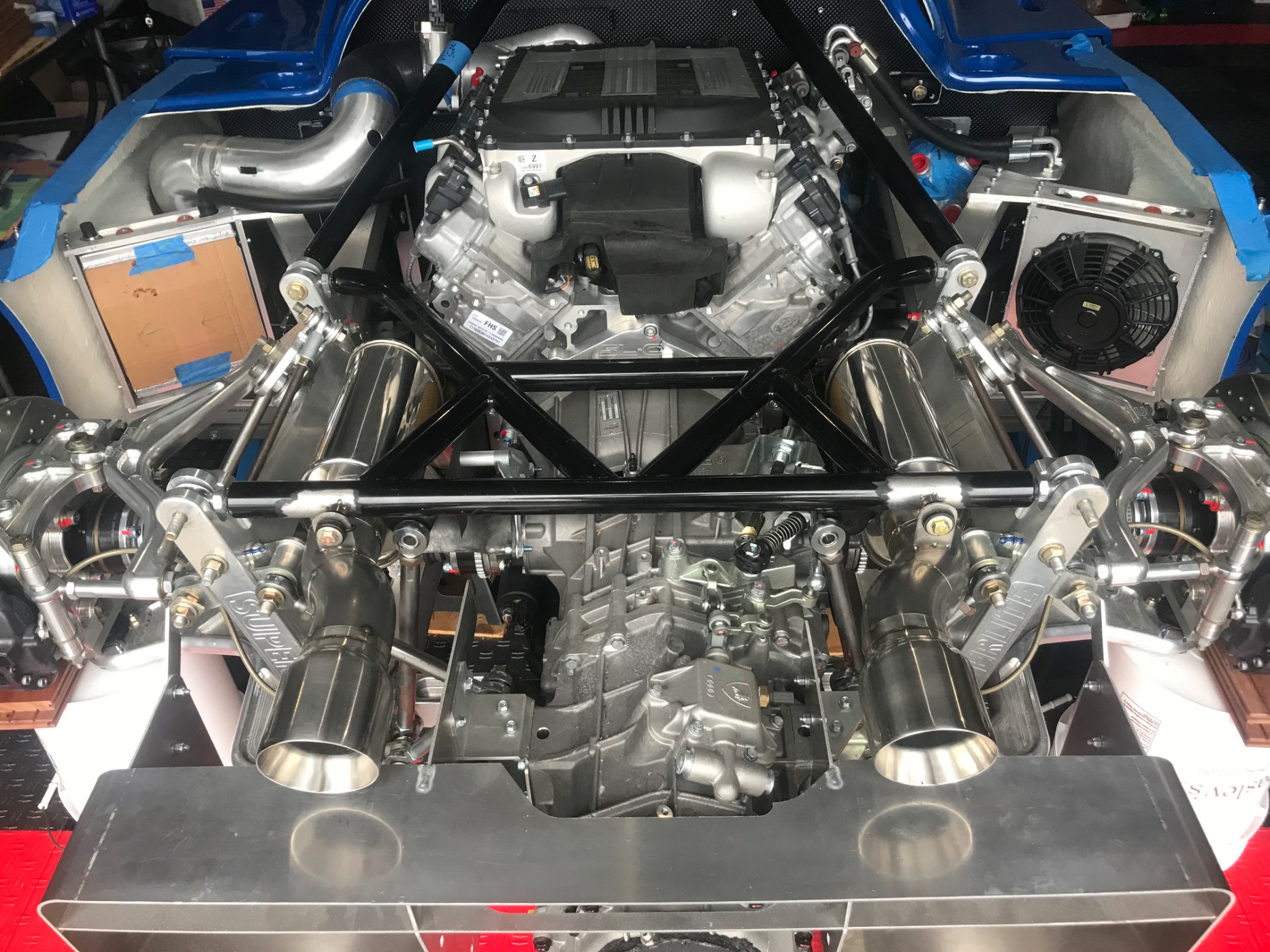

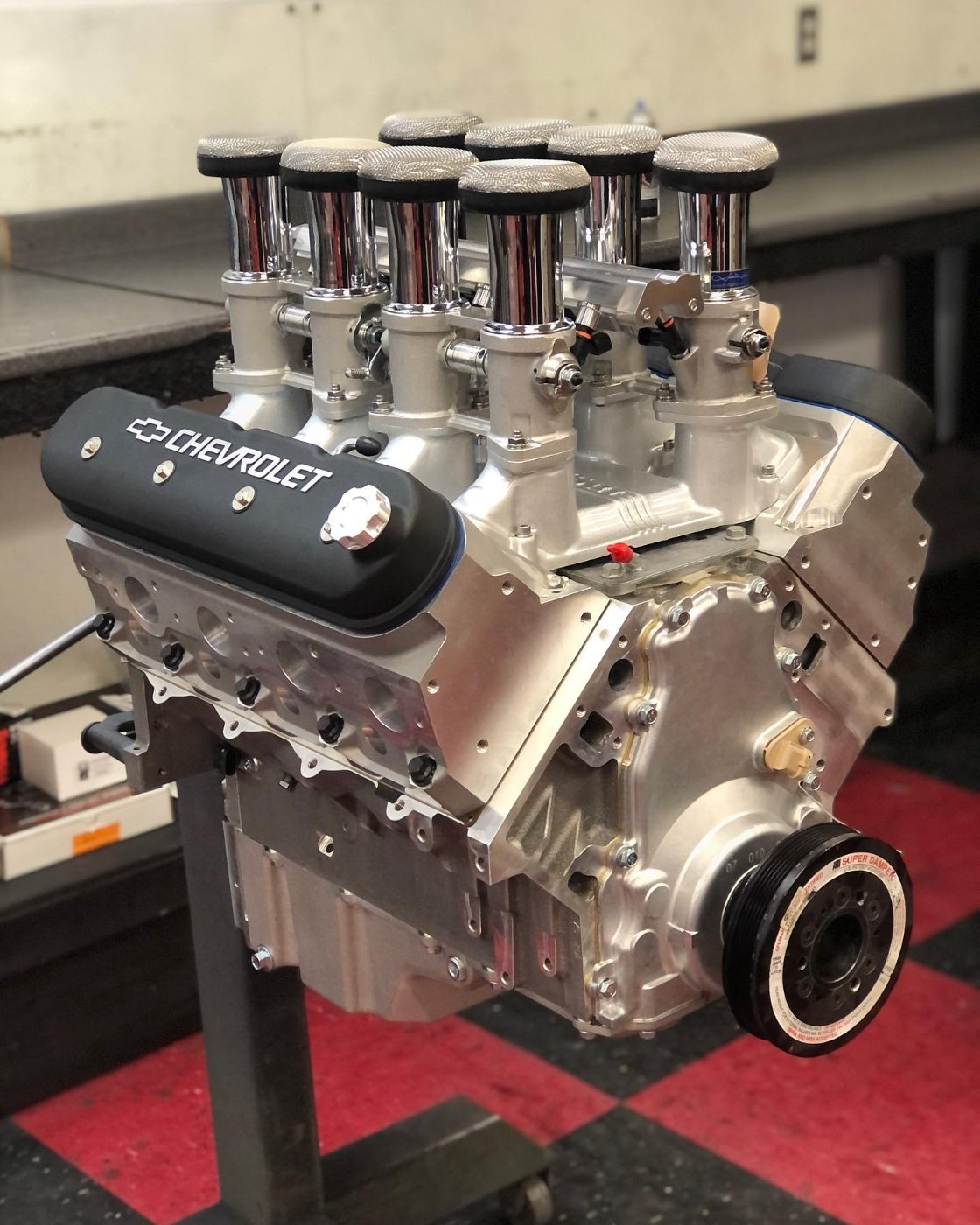

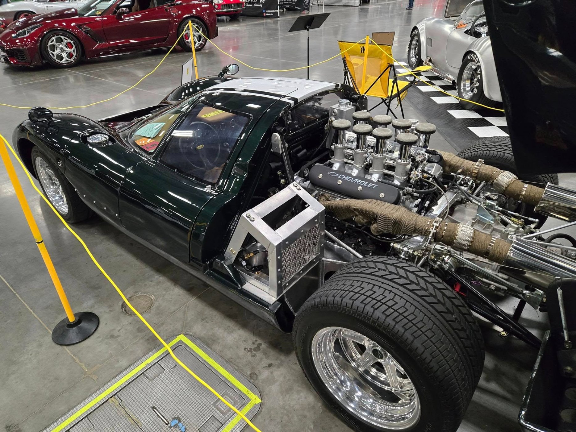

427 LS7 by Golen Racing Engines with Jim Englese 8 Stack Fuel Injection. 698 HP on the dyno.
