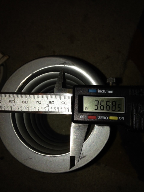

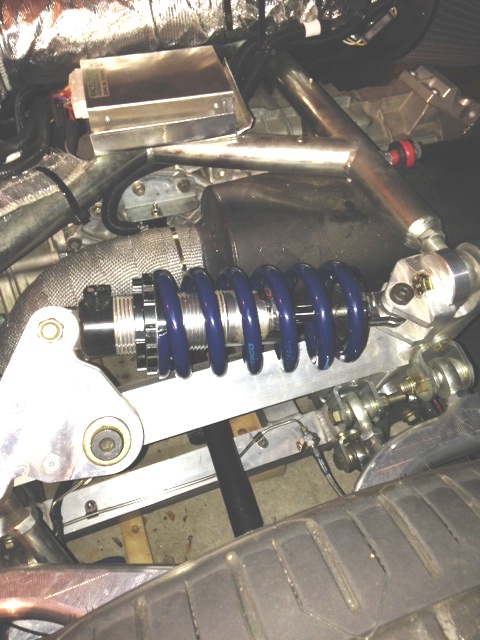

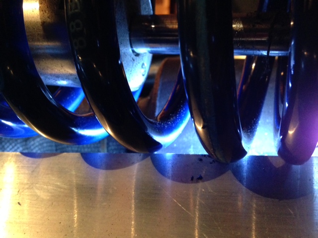

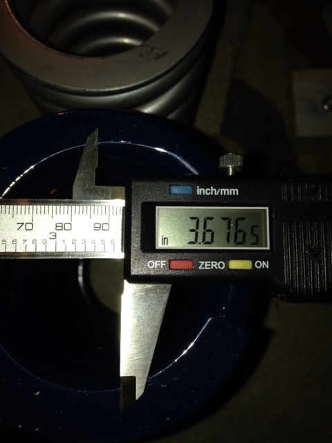

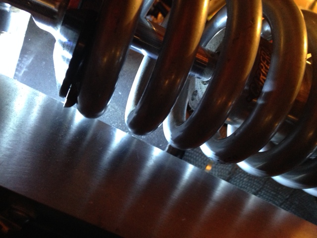

I installed one new spring last night and found that when the rear of the car is jacked up and the susp. is in full droop the new spring makes slight contact with the upper frame rail. Has anybody noted the same - even the stock spring is millimeters away from that rail. I stared at it for a moment and called it a night - it was late. Any impressions-suggestions.
Pictures noted below: spring comparison, spring external diameter dimension, spring clearances, stock and with new spring (blue). The stock springs are silver.

I installed the other spring and found that if one spins the spring say 90* the gap opens up at that frame rail spring rub location. So, the spring diameter doesn't/shouldn't change much, but the location of the springs widest diameter (re: rub location at rail) shifts to an area of more clearance. In a perfect world you should be able to spin the spring 360* and not get any rubbing. I have marked the high/low spot on the spring itself and need to keep the spring orientation static while turning and adjusting the turnbuckles. I figured a posting of my "Duh" moment may assist others. Maybe the Swift Springs are slightly smaller in OD and will freely spin 360* without any rub in full droop, they do cost approx. $100.00 more.

It only happens when the car is jacked up and suspension in full droop - when the car is dropped no issues. The picture above (blue spring) ain't lying and the spring(s) comparison measurements are negligible - color me baffled.
