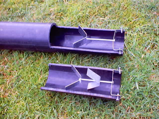

Here's a photo of the Patriot insert with a 3" outside diameter, 11 inches long.
Available from Jegs for $14.99. Such a deal!
Patriot Exhaust H3844 Patriot Exhaust Muffler Inserts
If the inside diameter of your pipe is less than 3 inches, you can probably trim this one to fit. Alternately, you could copy this design and fabricate one yourself.
My 427 Cobra had standard Cobra side pipes, which were made with a simple glasspack muffler. The exhaust system consisted of headers with 2-inch primary pipes, going into a 3.5 inch collector, but then the ID of the glasspack muffler was only 2 inches!!! It was loud but cost over 100 horsepower on an engine dyno!!! I had the mufflers replaced with Lobak mufflers, which use a similar spiral core. They are just about as loud (which is to say, VERY loud) but flow substantially better.
I would guess that using these Patriot spiral cores (or something similar) in your tailpipe downstream of your existing mufflers would do the job for you.

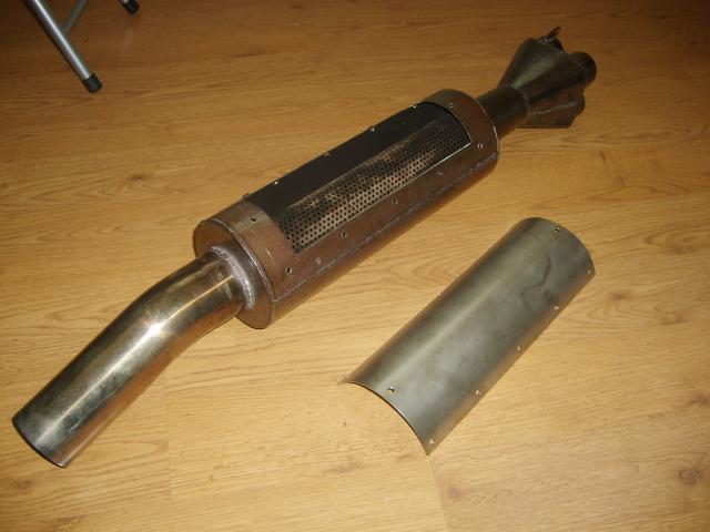

Think twice about using pop rivets for the fixing of your repacking plates. I tried that and after a short period they failed due to the high heat cycles. I also tried self tapping screws and they also failed, I can only guess they vibrated out. I ended up using rivnuts and brass bolts (M6) with spring washers. No problems since I used this method although I tend to carry spares for track days.
Malcom
Thanks for your advice. Unfortunately I read it after I have repacked the silencers and used pop rivets ! I will keep an eye on things, and at the first sign of any problem, will go doen the rivnut route. The good news is that with the silencers now repacked, on tick over we are reading 82 dB. Cadwell here I come :heart:
I do realise this is not permanent, as the packing material will gradually come out of the exhaust. I will test at a greater rpm shortly, but hopefully we will be all right for the track.

If your exhaust is repackable, then consider exhaust wadding a consumable! If you use higher RPM then you will need to repack more often than if you don't. Again I normally carry a sq metre or two of wadding as a spare on track days in case I fail testing so can add more as needed. Have fun at Cadwell.
