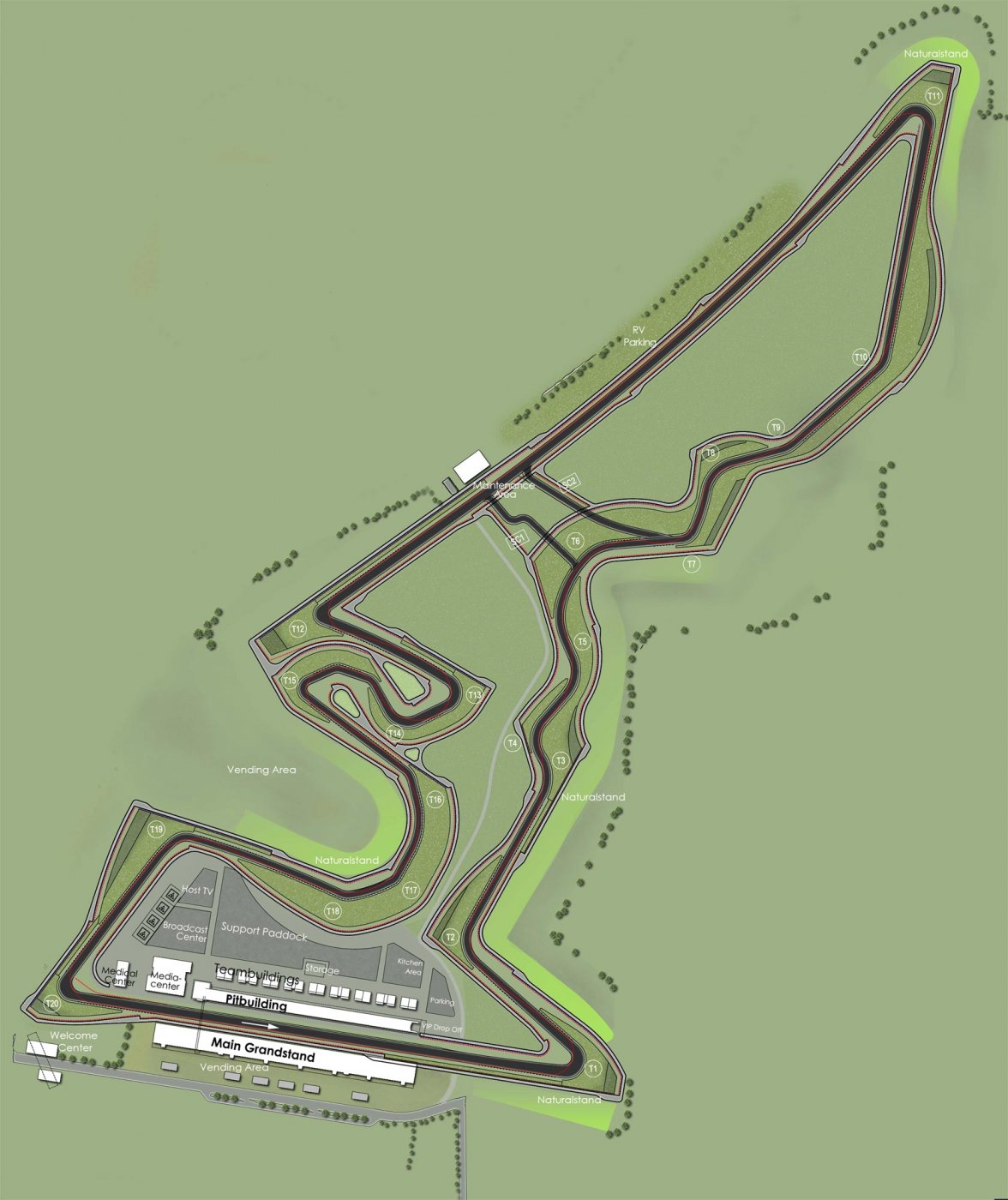

Ya I'm not sure exactly what happened. I went off at the end of the brake zone Turn 19. This is not a place that lends itself to hit anything. I hit the outside fence, drivers right, at about 5-10 MPH. Just enough that you think sliding up to it that I might make it. NAAA. Shit!

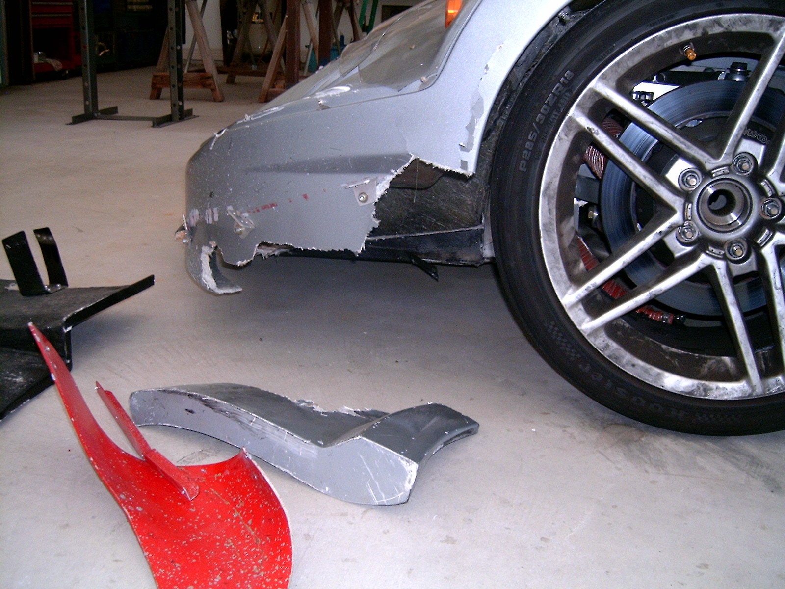

Fortunately you have retrieved the big pieces of fiberglass so it can be fitted back together. A steel or aluminum body would be bent up beyond repair. Glad you are OK, Howard.
Howard Jones
Ya the on track crew was really helpful. They took their time and didn't damage anything else. I asked for the pieces and the crew boss said they didn't usually do that but everything was right there in one spot so he gathered things up quickly and put them in the car.

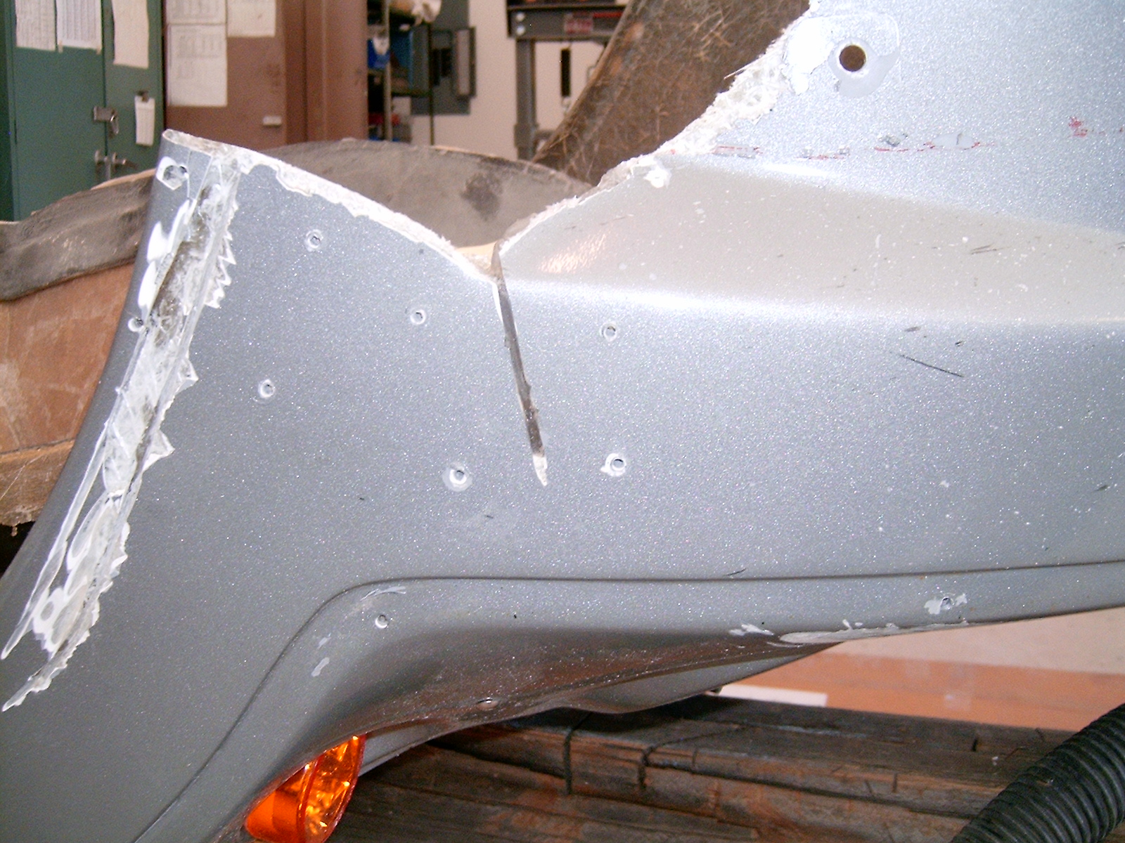

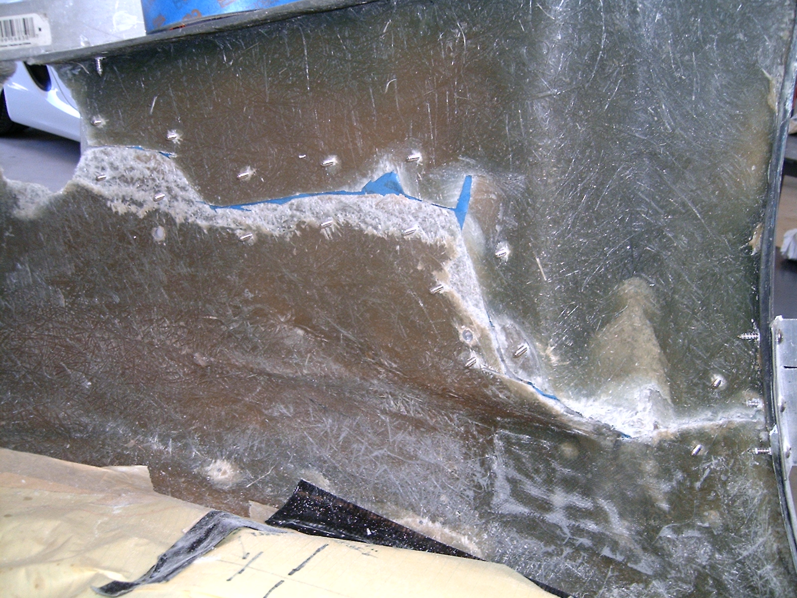

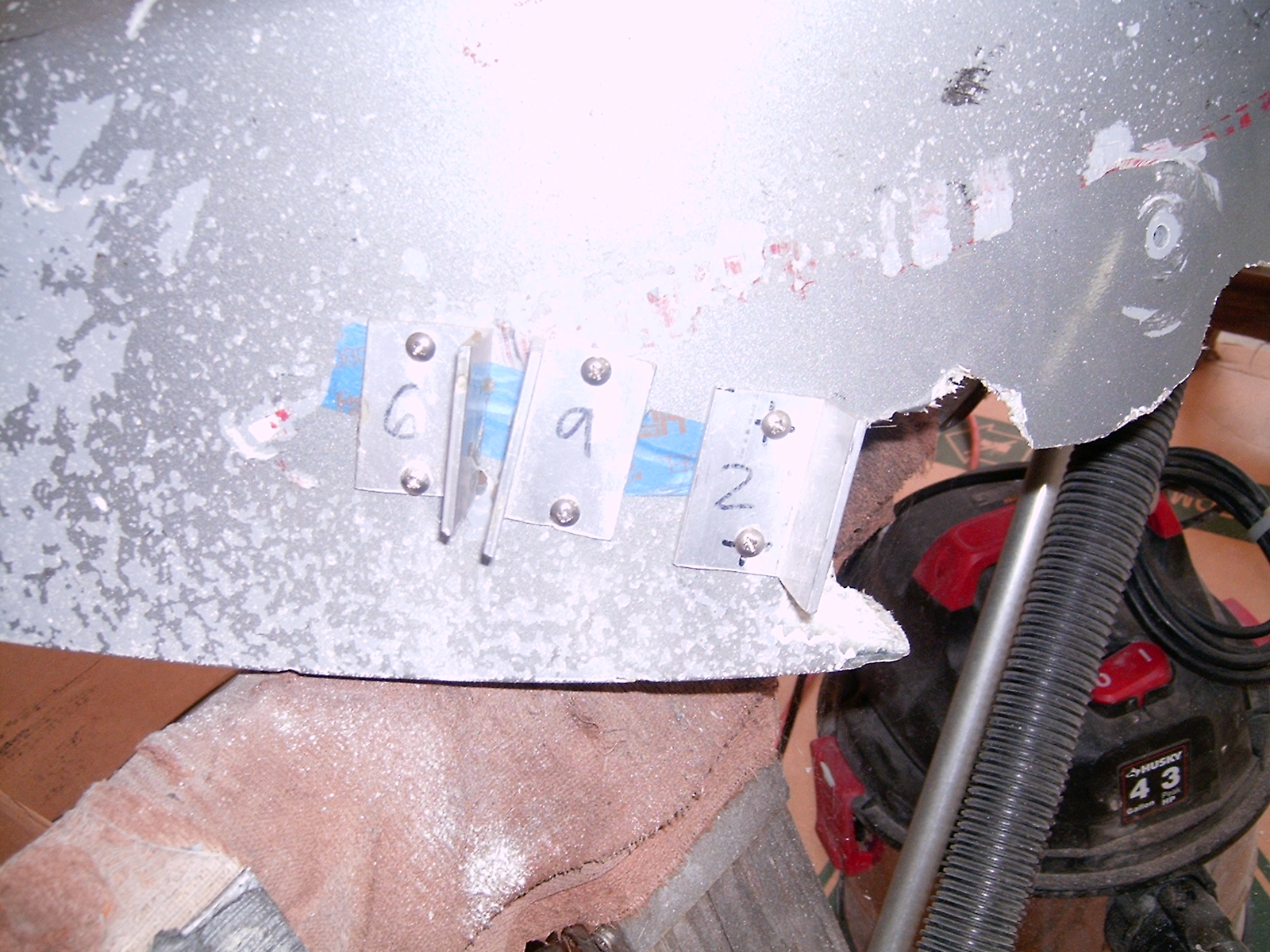

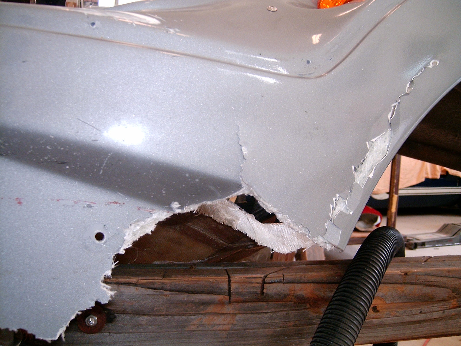

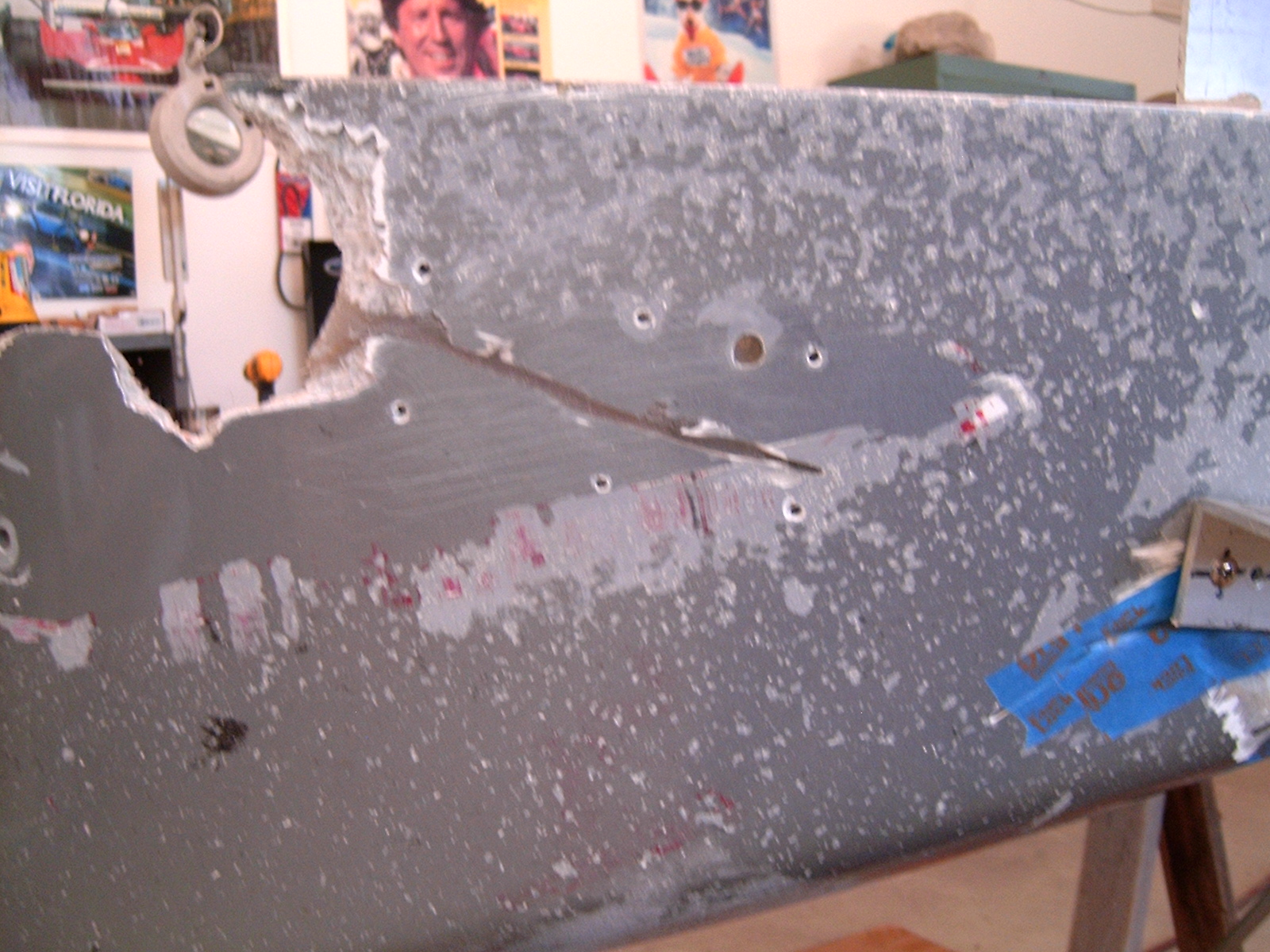

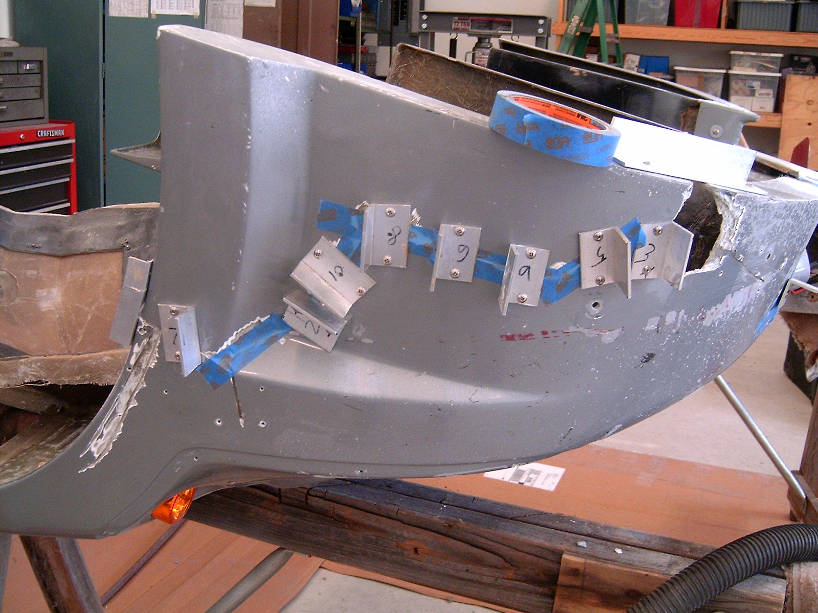

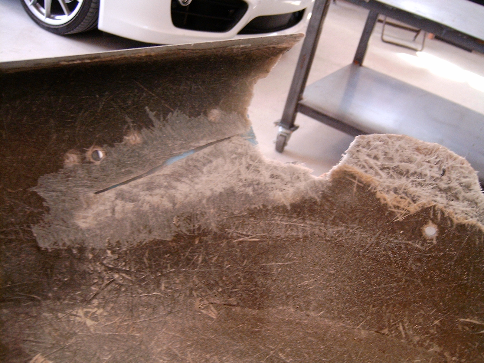

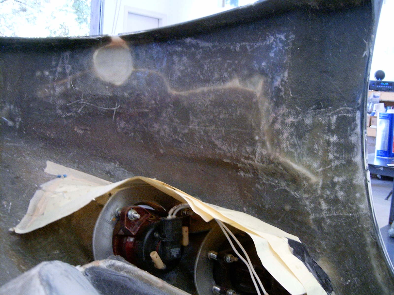

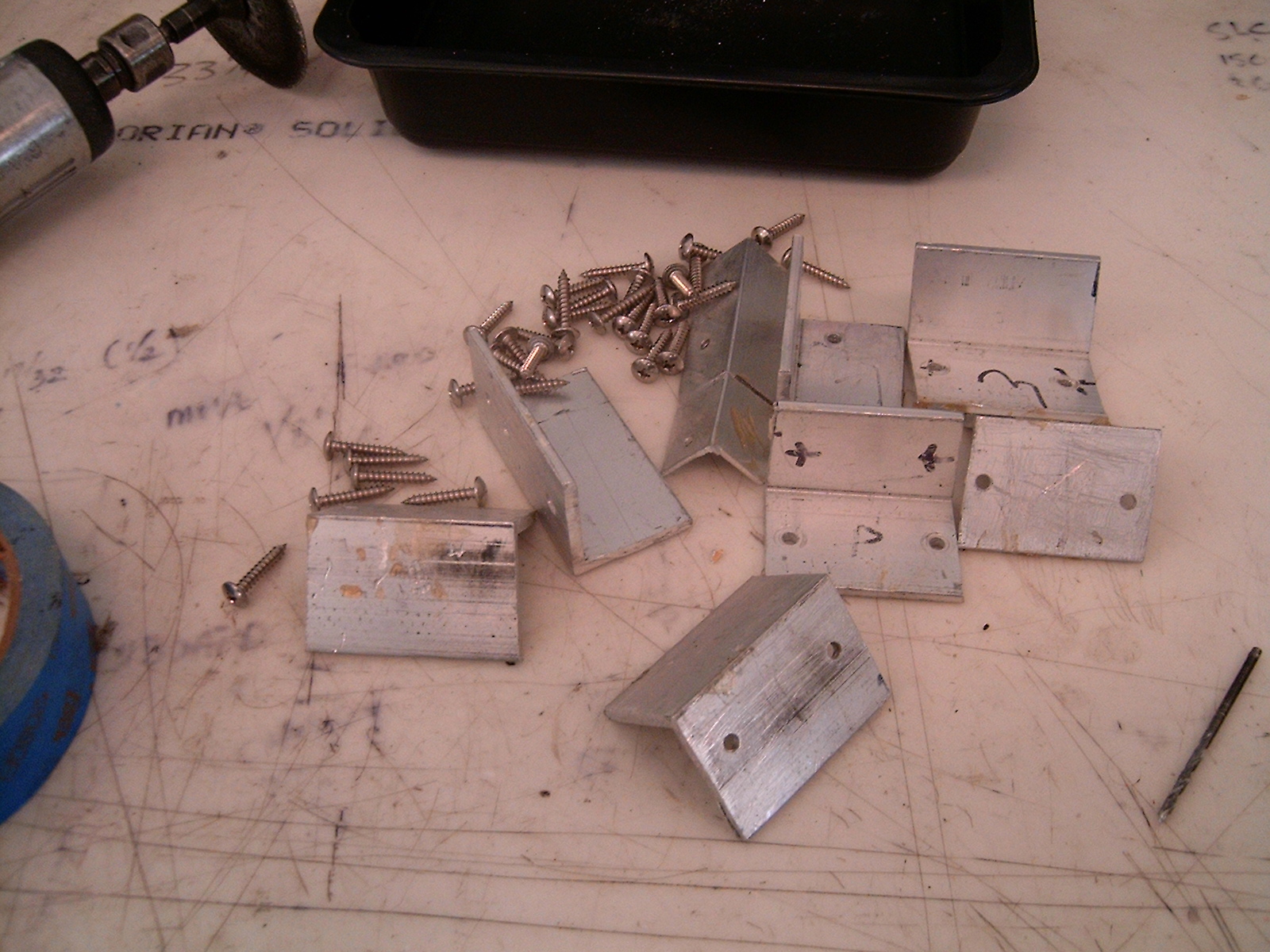

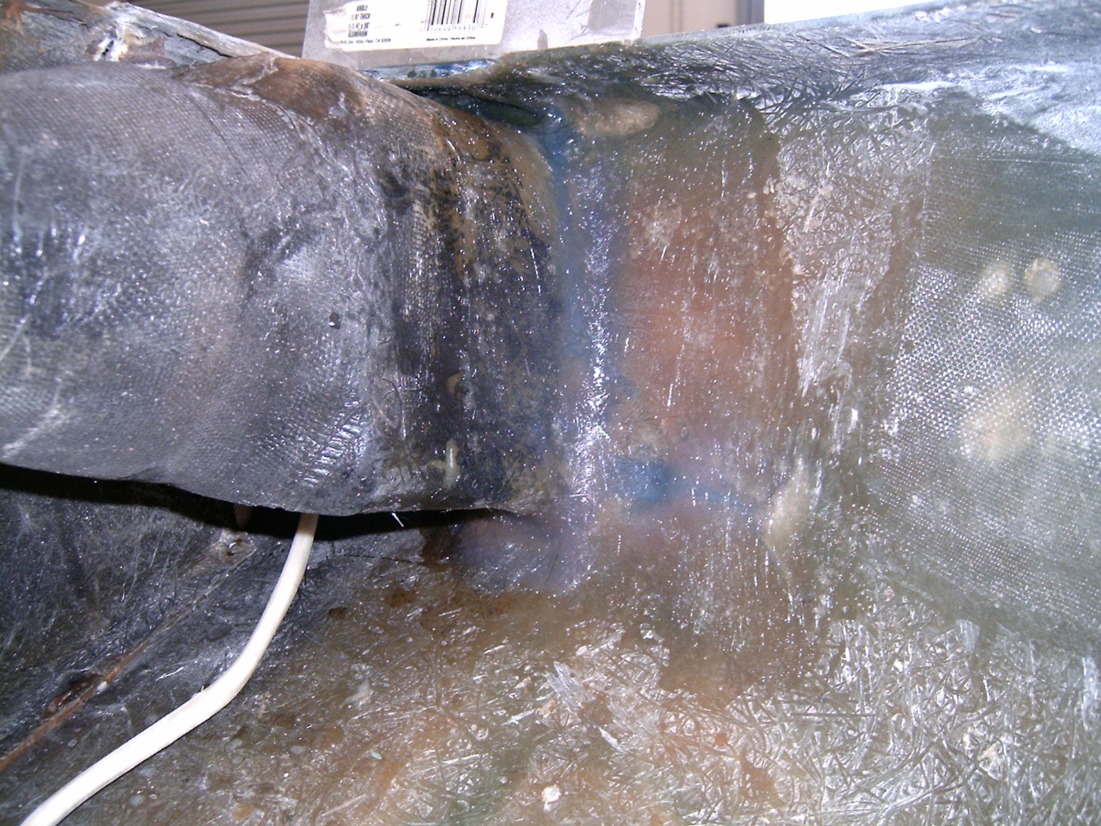

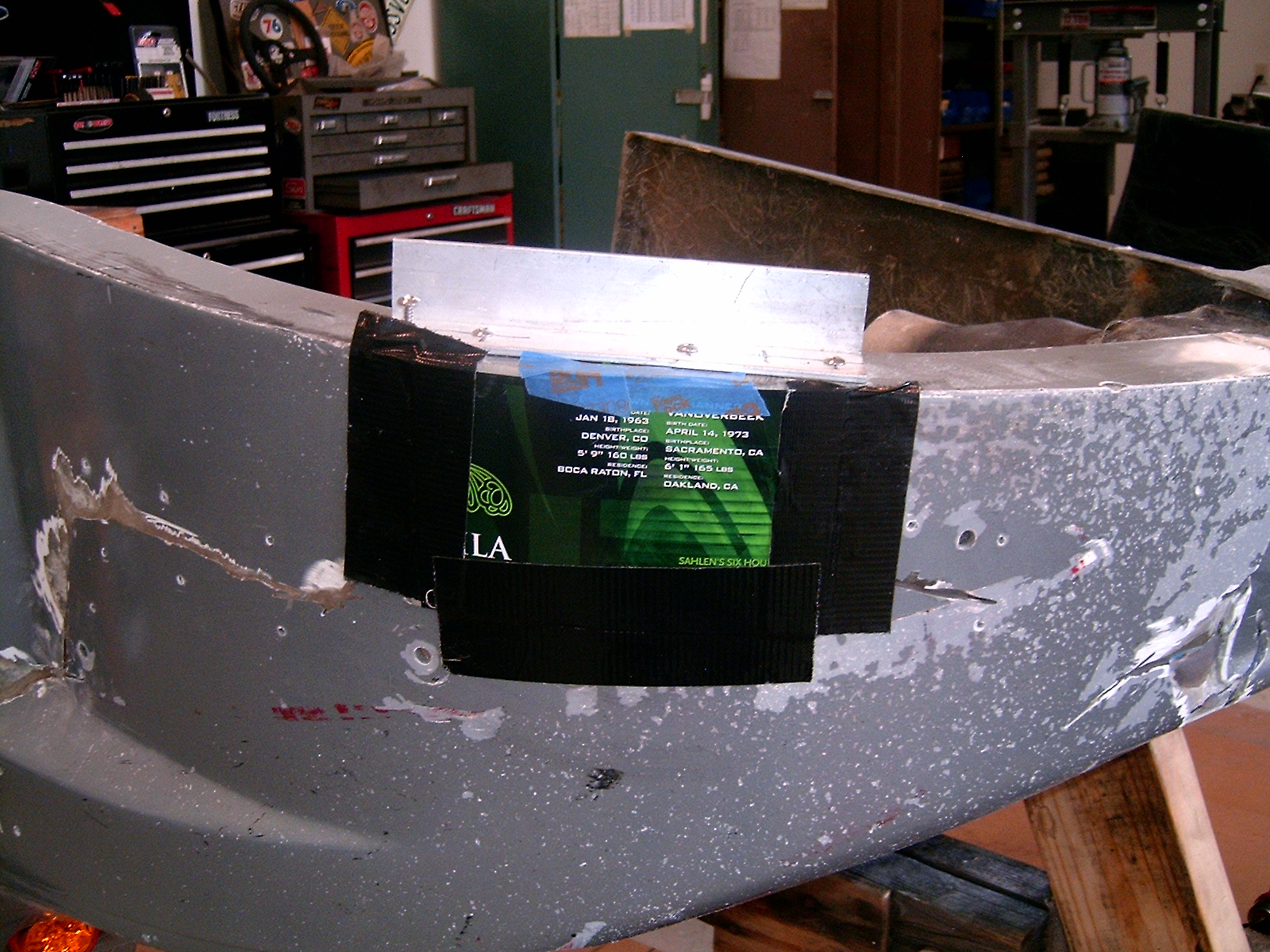

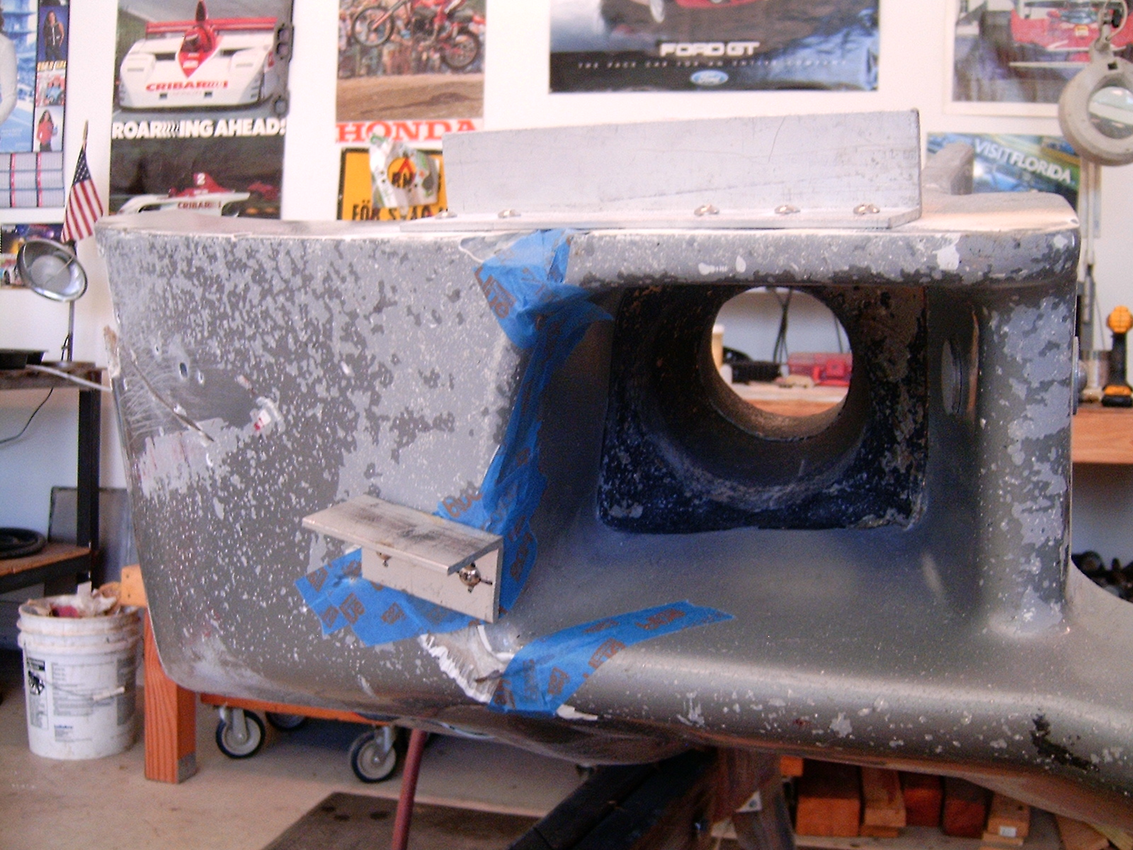

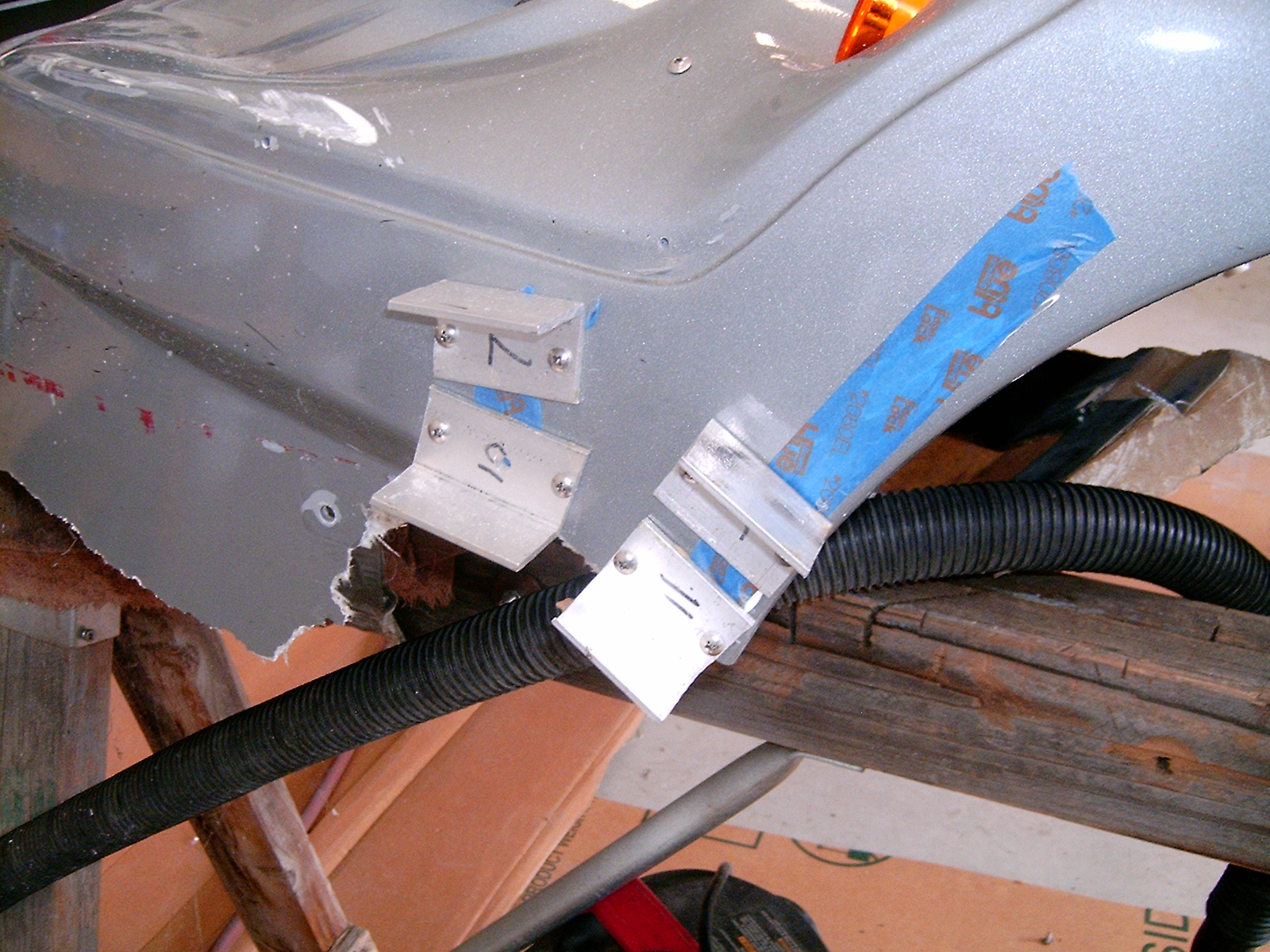

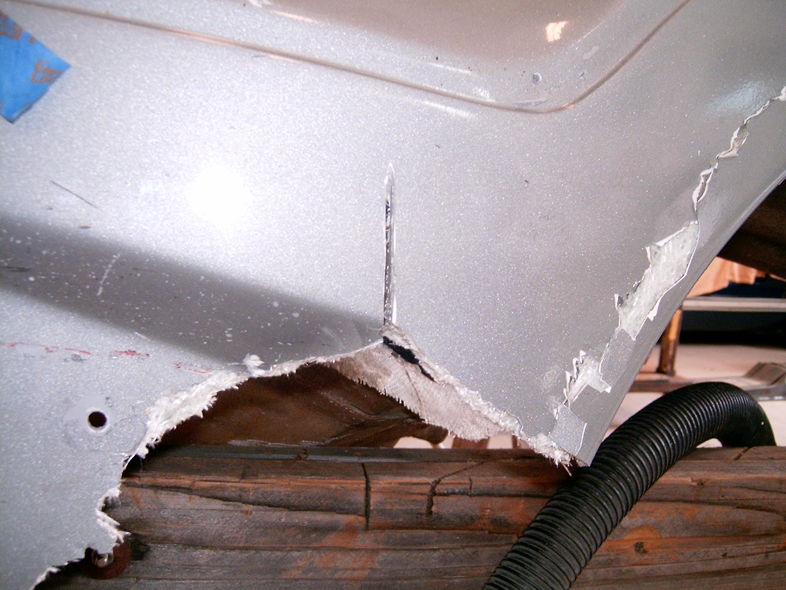

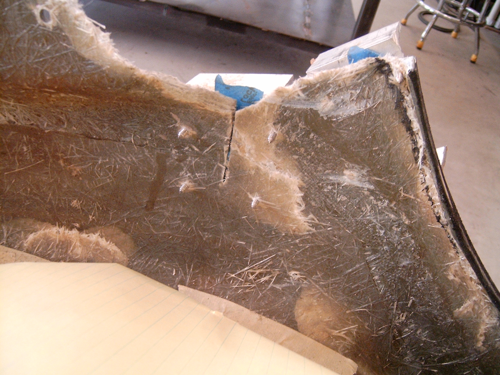

I started to fix it. First thing to do is repair some of the cracks in the larger nose piece so that it is all in the correct place/plane to graft the big broken part back on later. As you can see in the pictures the cracks are ground out so that only intact parent material is left. This is important. Get rid of all the frayed and broken material so that the new fiberglass patch has solid fiberglass to bond to.
I use a slurry of resin, chopped fiber, and micro balloons, the consistence of peanut butter to fill the crack and low spots, and then fiberglass matt to cover the slurry three or four courses thick on the back side.
The crack is positioned with a few angles across the crack. They are screwed onto the piece with sheet metal screws and then the points are ground off the back side to make it smooth with a cutoff wheel. I cover the crack first with a piece of painter tape to keep the slurry in the crack.
More pics as this progresses.

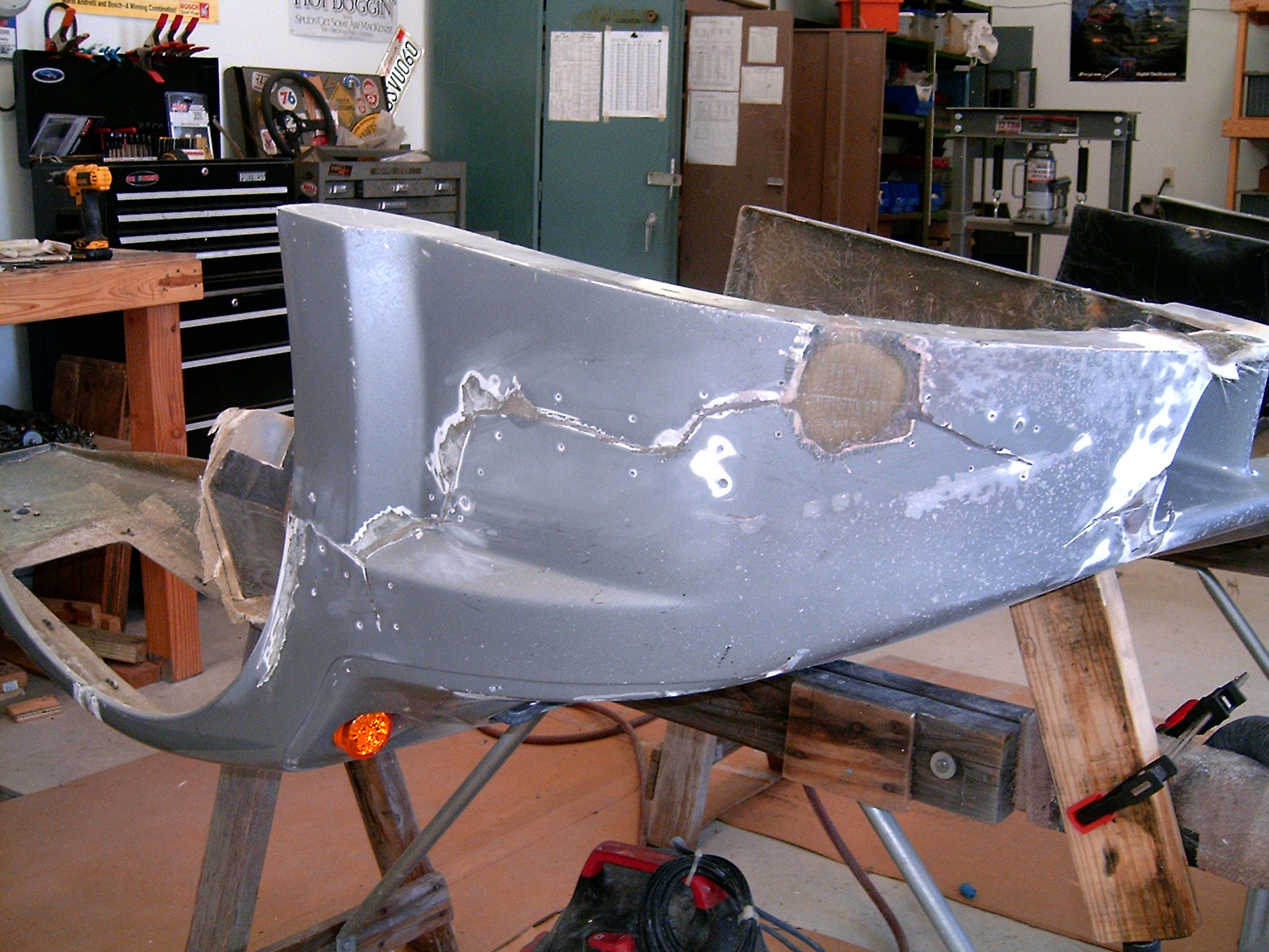

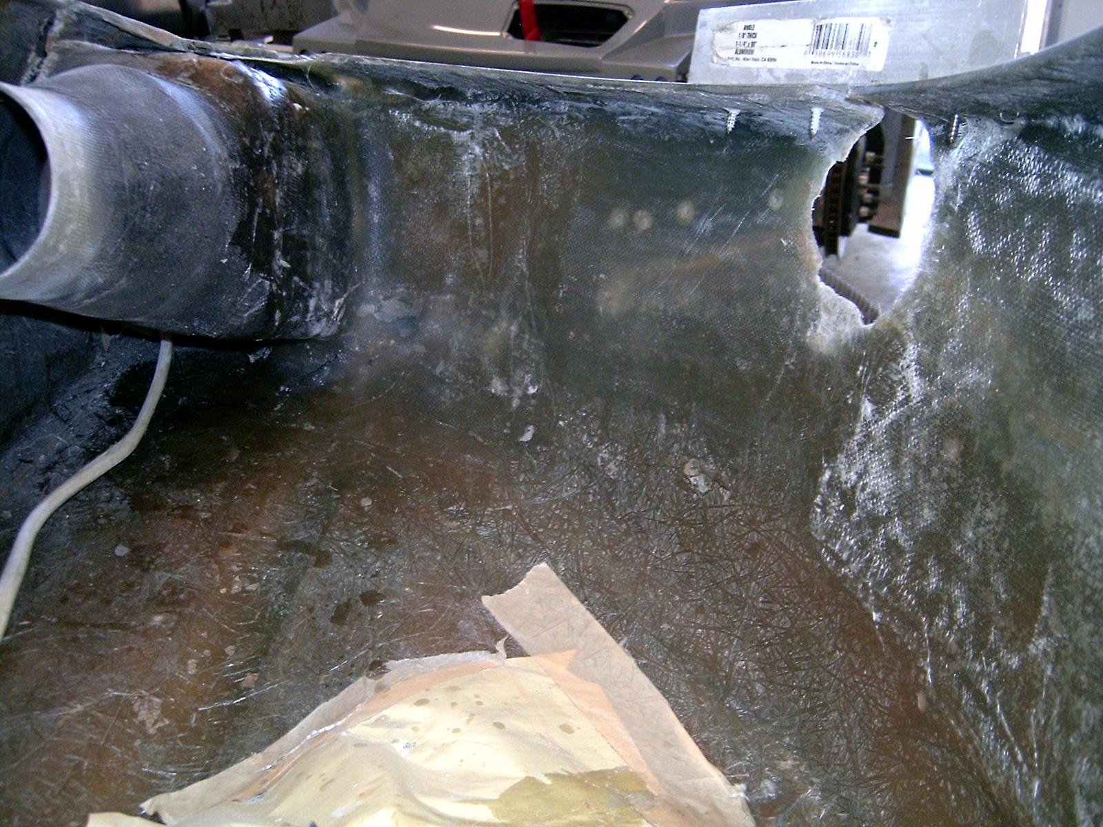

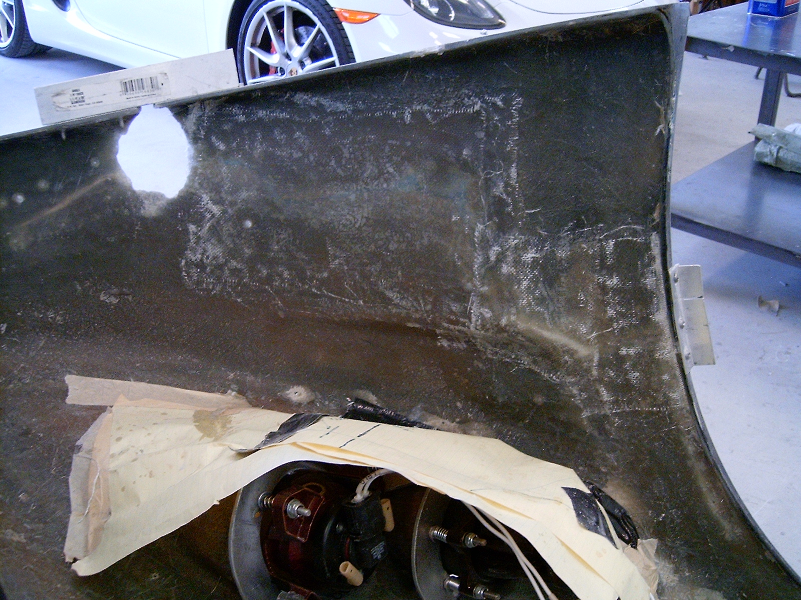

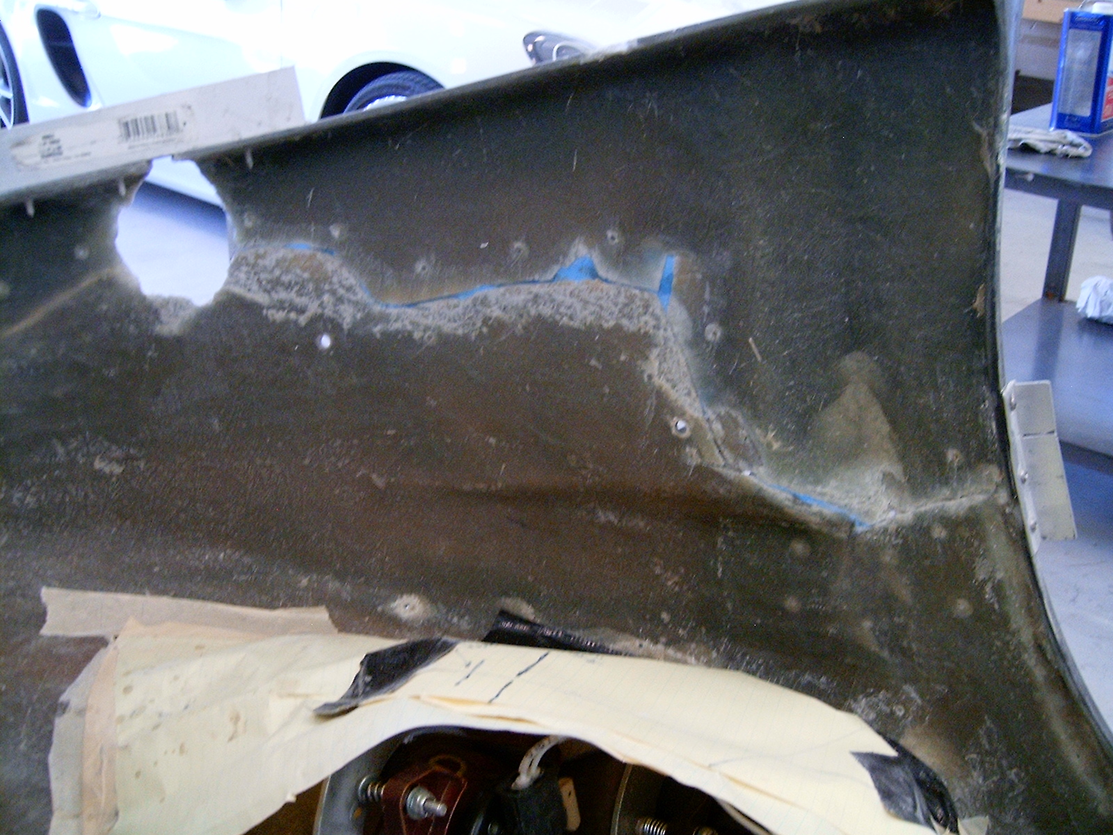

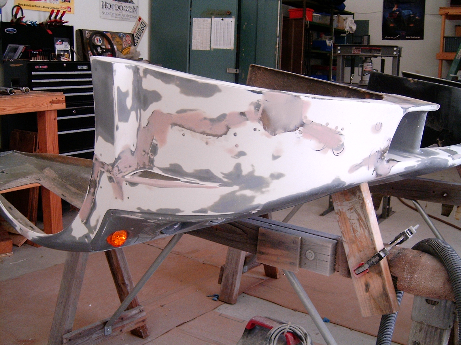

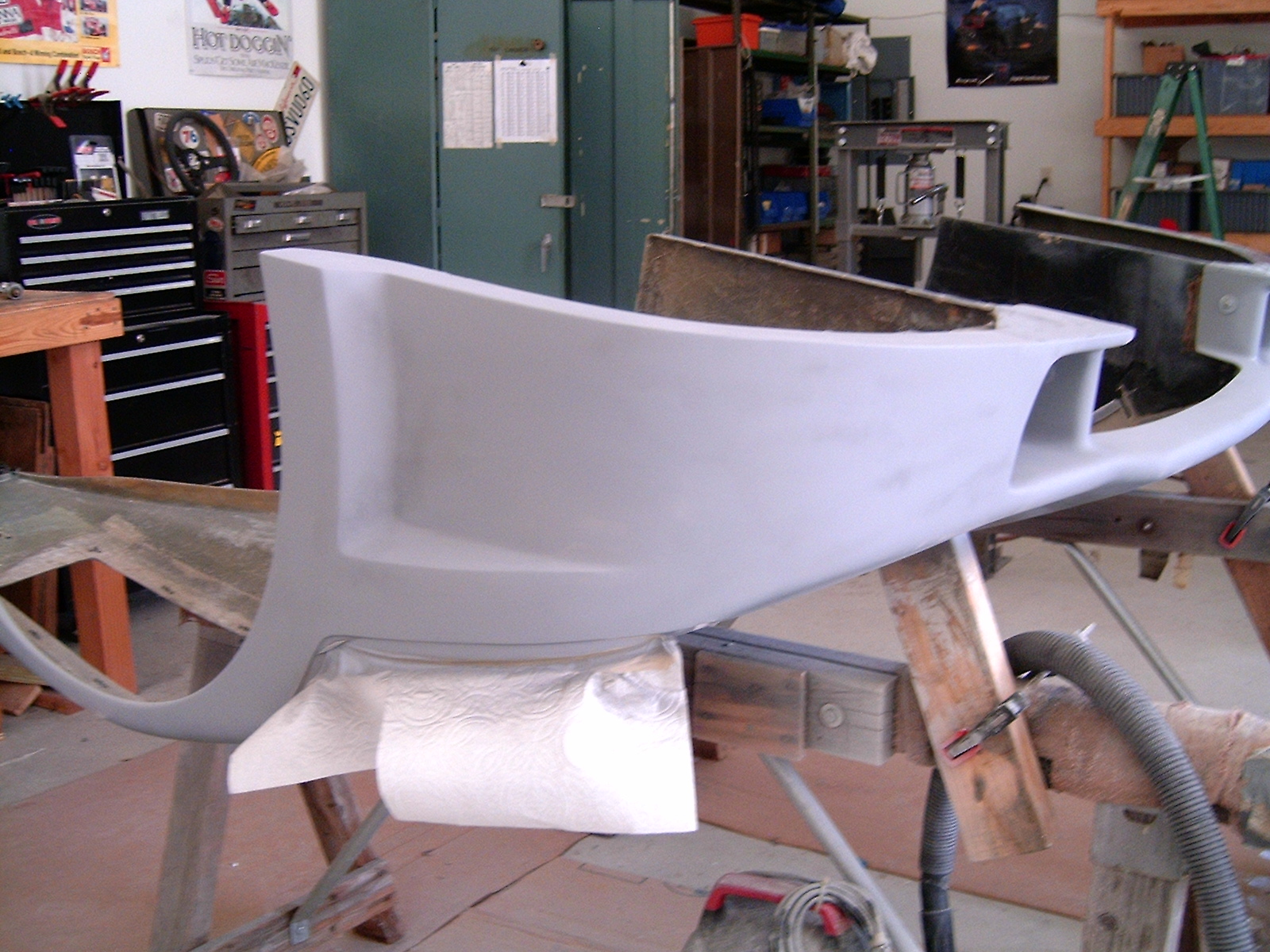

Ya, this is pretty easy really. Not difficult just a bit time consuming. Here's yesterdays progress. I decided that I'll name it the "humpty dumpty process"

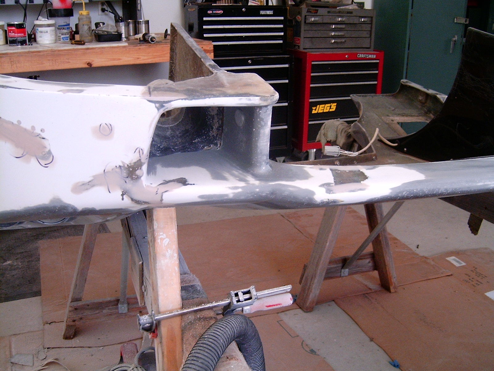

Howard Jones

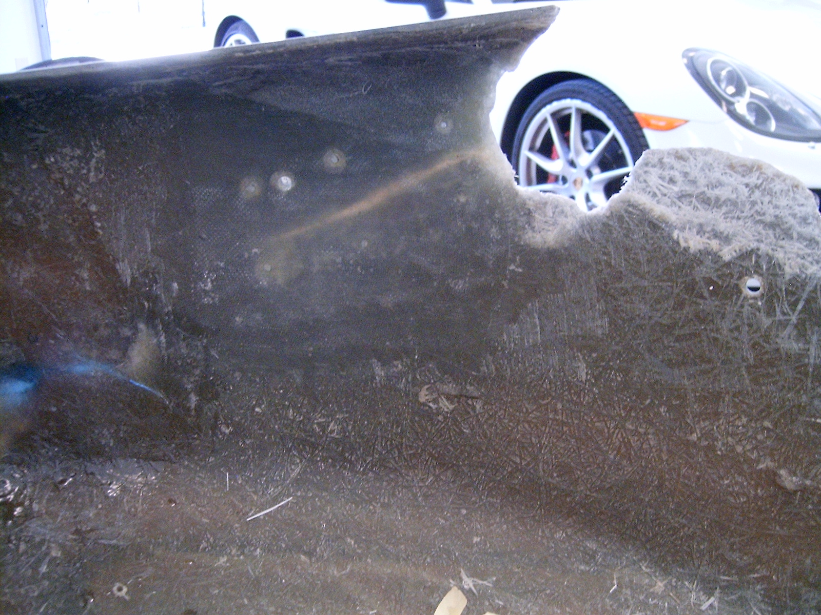

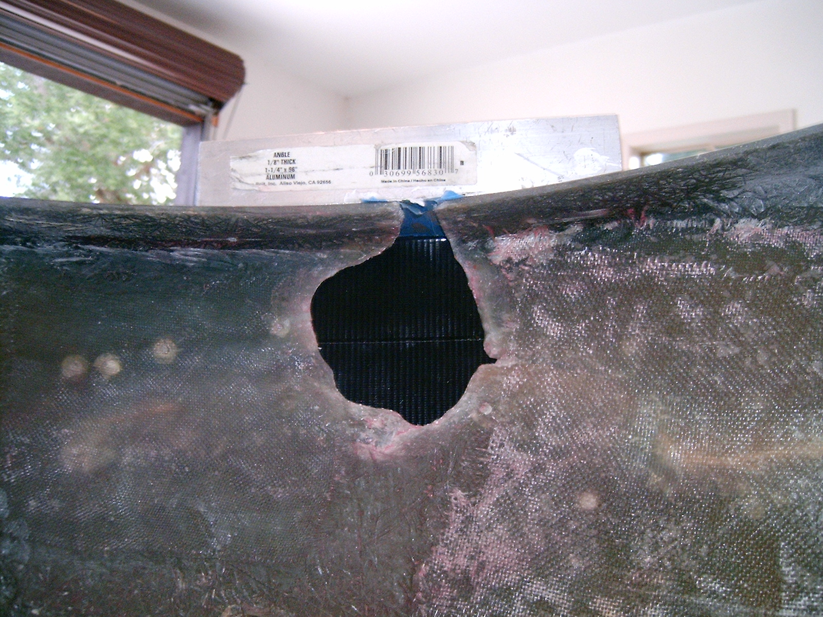

Saturdays progress. Filled big hole created by canard mount bolt being pulled though body. I decided to not replace original piece and instead just glassed it over from the inside. First I covered hole with a piece of hard carboard covered with duct tape on the inside. Resin does not stick to duct tape.
All the pieces now back in place and inside work done. Now I will need to bevel outside damage and smooth edges. Then I can add matt and grind down to smooth for bondo.

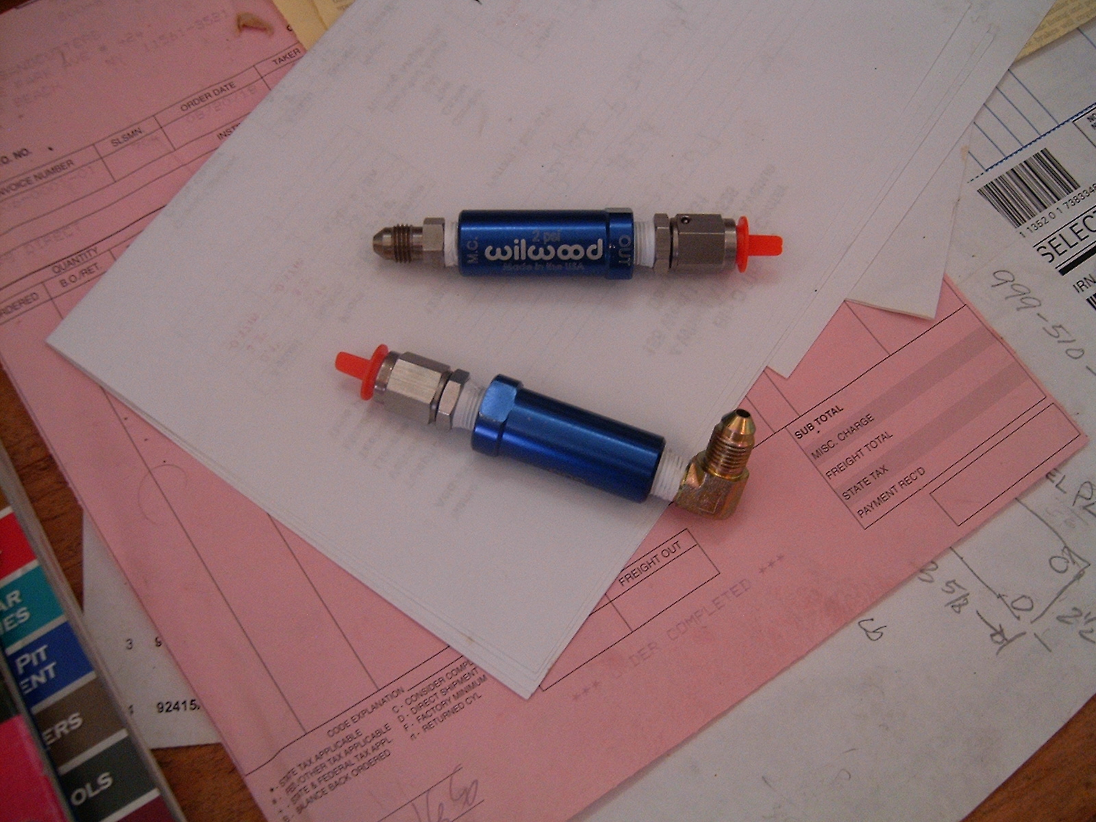

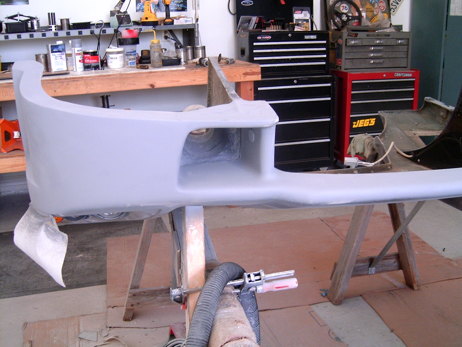

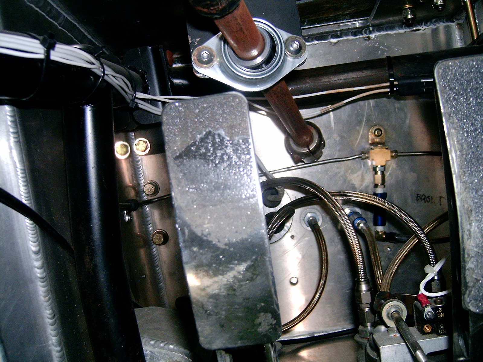

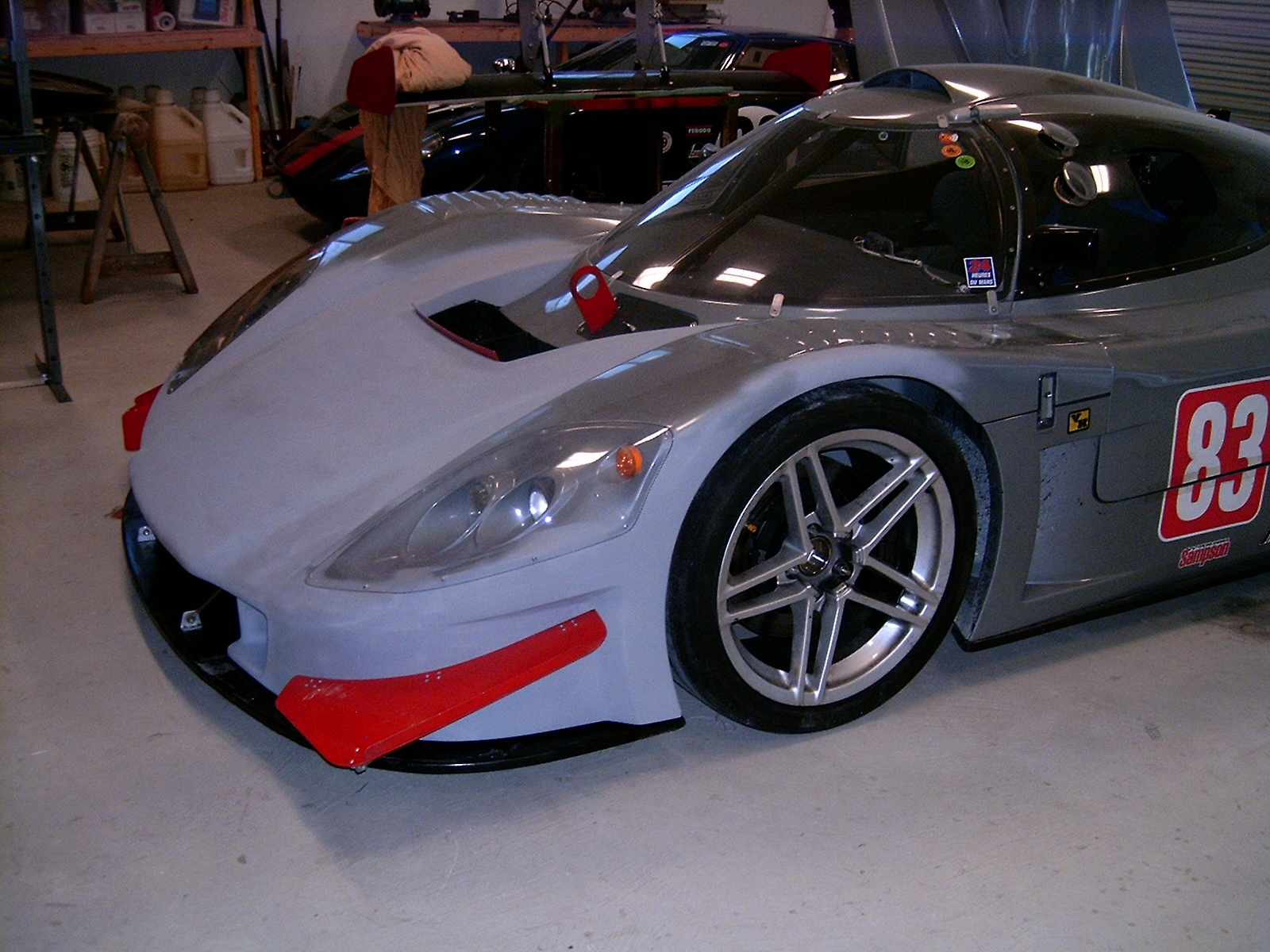

So all better now. The first picture is of the new Wilwood residual valves. I have installed an fittings on the ends so I can directly attach to system without the little pieces of brake line tubing. This makes it much easier to remove them and is virtually impossible to leak at the connections.

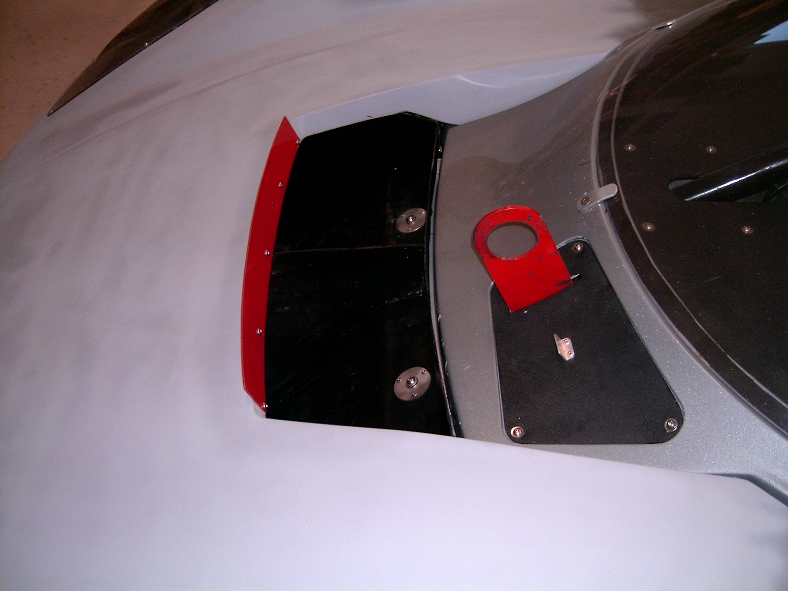

The last is the redone radiator exhaust opening.

Howard Jones

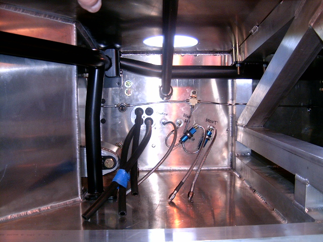

Here's where the new Wilwood residual valves ended up. The first pic is the original valves with the pieces of tubing needed to hook it all up. I never liked that anyway so I got rid of the tubing and used AN fittings on the Wilwood valves. Second picture. Better.
Those are some darned tight working quarters down there. You must be far more limber than I am to get down in there and live to tell the tale.

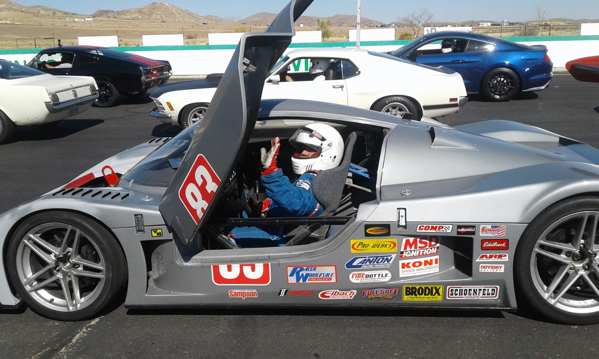

Here's sort of a update. I towed out to Willow Springs in California to run the car for two days with The Cobra owners Club of Orange County. They do a track weekend there twice a Year and I ran the GT40 with them a number of times when I lived in California. I really like that track but more so I really like that group of guys.
In any case the cleaning of the rotors seamed to work and the new residual valves were much better, It appears that the original ones were in fact causing a constant drag from the pads. I think the effect was that this prevented a good bedding process that really became more apparent as I changed to a higher friction pad material. I have more to learn on pad materials, but my advice is to remove them if you have them and install Wilwood valves. The for mentioned vibration has gone away by about 90% but I think a recleaning of the rotors will not be necessary, just more laps and see If they continue to get better as the rotors are worn in with the pads on the car now.
About that (more laps). This time it was the throttle cable that failed. It was to close to the engine block in one spot an although it was shielded it still melted and froze. No drama, as I found the problem as I was starting the car for the forth session on Saturday. Nothing to do at that point but pack up and leave Sunday morning.
This was too bad really as I was just about to change up to a faster run group and push a bit harder.
I really hope that all you guys that are thinking about track cars for the first time are reading this thread. This is the kind of stuff that happens with new race cars. It will one thing after the other until you begin to achieve reliability and things do not fail or you gain the desired performance. I had hoped that I was there or at least close enough to run the whole weekend but then the unexpected happened. That's just the way it is I guess. That's why they are called prototypes...
Howard headed out at Willow Springs on a mission to make all those Mustang drivers question their manliness. :p
While I was left behind to answer all those "what is that?" questions......
