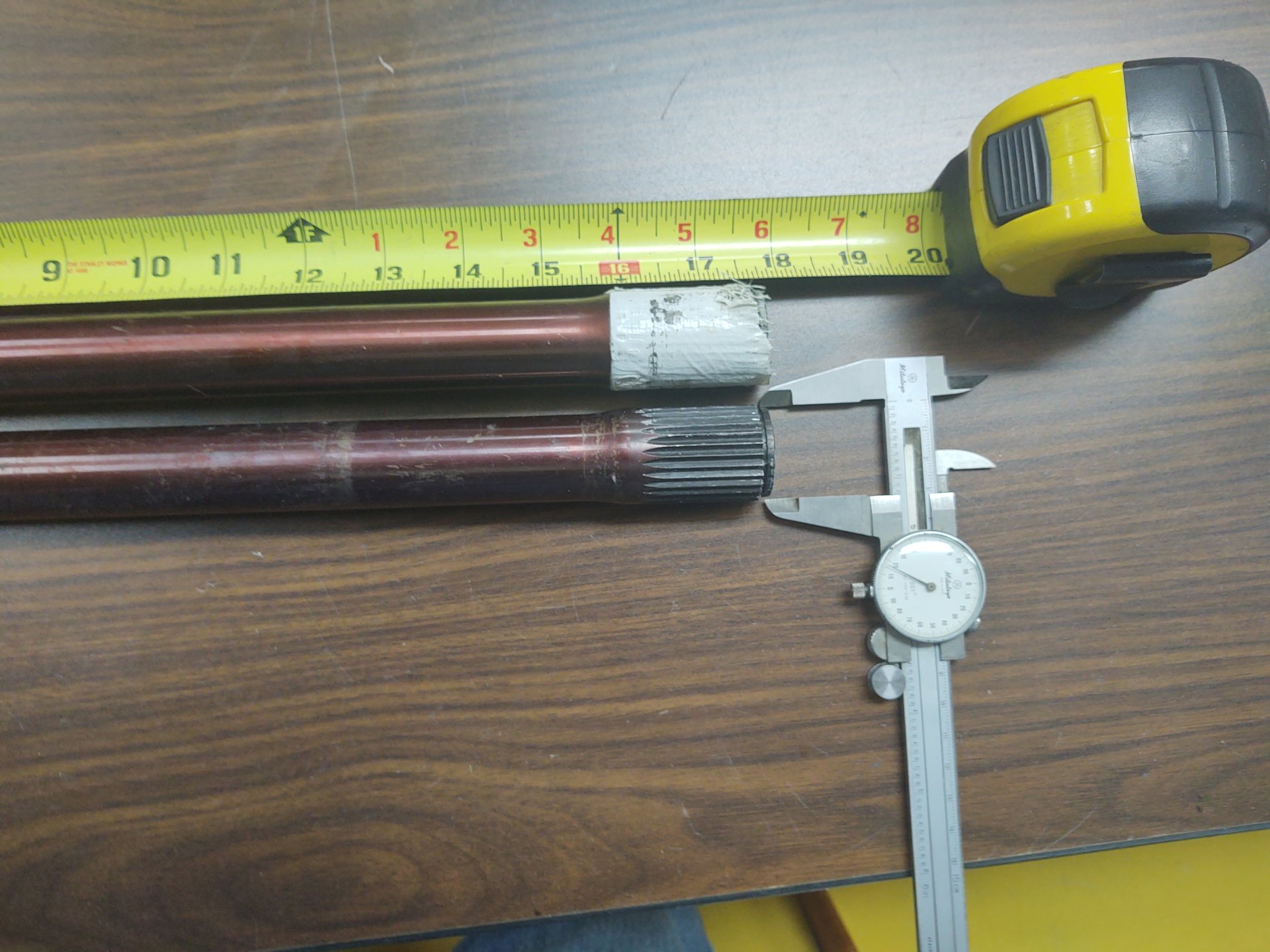

I went to COTA yesterday with the new setup and the upper A-Arms I made. Set camber to F-2.5 and R-2.5. This is the most negative camber I have run to date. Unfortunately, I broke a driveshaft on the third lap of the first session. So what did it feel like at 50-60% pace? Really hard to tell but if anything more on the nose than before. Really I didn't get a chance to even get to full power so who knows?
The driveshafts in my car are the original ones that came with the car. I have a GPS speedometer so I have 2303 total miles on the clock. My guess would be all but maybe a 100 miles driving around the block checkout miles is on track with something like 2/3s full pace. A lot of the early days were at an easy pace so let's call it 1500 miles total full-pace track miles with the rest more or less tuning and check-out laps at less than full power or quick gear changes and downshifts.
A normal track day is about 6 sessions with 8-9 laps per session @ 3,5 miles per lap or 20-25 miles at full pace per session or more or less 150 miles per day at near or full pace adding on maybe 30 miles of warm up and cool down laps per day. 150 miles per day @ 8-10 days per year is about 1200-1500 miles per year. So if I don't change the type of axles I am looking at new ones once a year.
All in all, I think that's not bad for the standard material half shafts that came with the car. So next is to call Fran and find out what part he gave me back then and then call the Drive Shaft Shop and ask them for advice. I'll let you know what I do when I know.
Pictures when I get it apart but I'm pretty sure it failed at the outboard end spline root shearing it in two. The shaft stayed in the boot so there was no other damage. That was good because it was the end of the back straight, 70% power, and about 110MPH when it went to no drive. That's what happens to a Quaife TBD when one side loses any resistance to torque. It goes to no drive on either side.
So there ya go.
The axles being shipped now (and for some time) are made of 300M, which is what DSS will tell you to use, in case others are wondering about their cars.

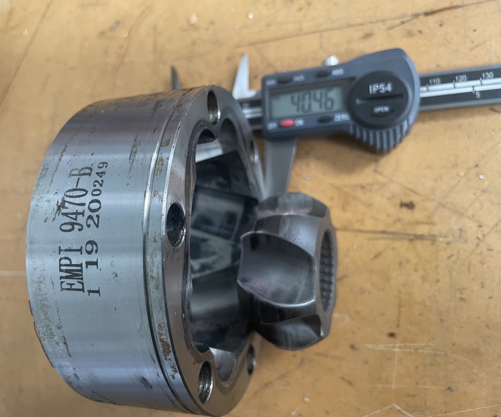

Thanks for posting that video- good information. One wonders why the factory doesn't ship their CV joints already polished? Surely they could use automatic tooling to do it.
Ken Roberts
I discovered that my original RCR SL-C cv joints from DSS were polished like shown in the video. I disassembled them to install longer axle shafts after converting to SKF X Tracker rear bearings. Last year I bought a couple of #600 grit felt head diamond bobs to go over them before reassembly.
