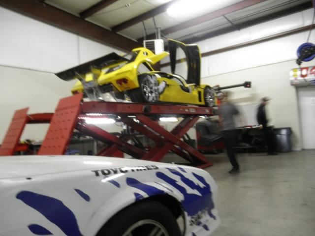

They specialize in tuning for the track. I wasn't too far off considering i took off all control arms. I had a little positive camber in the back, not bad +.06 to .03. and a littel toe in in the front but that's now tuned out. Here is a pic on the $75,000 Hunter rack, brand new, amazing. Supposedly the best in town, they ordered more options than the Ferrari rack.

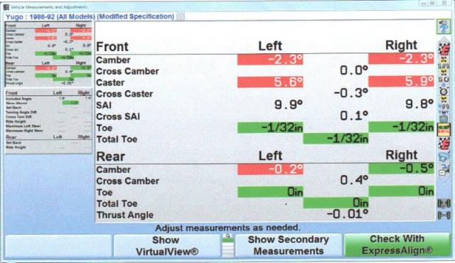

Hrete is where the alignemnet was left. We ran out of time on the front camber. i was shooting for -1 but left it at -2.5. Also i need ot crank the left rear camber out. otherwise pretty happy. Any one see any concerns?

That seams alike a lot of neg camber in the fronts for a street car. What does Fran recomend for a starting point setup? I would have guessed about -1 degree on the fronts and about a -.5 on the rears as a first setup.
The rest looks OK to me.

Howard, it is a littel more -camber than we wanted but it got too late to finish. I'm trying to bring the car out to Texas motorsport ranch to track in 3 weeks. I'll take the 1st run like it is and pull it more positive.
Thats a good way to ruin a set of tyres and not have the grip and feel the car should have...
-1 would be much better in front and -0.75 in rear to start...

What do you recommend as starting alignment settings for the wide Michelin meats? Front toe/rear toe? Caster?
Too much rear toe destroys tires for sure ... the stock NSX settings were murder on tires for instance... but then it didn't have any trailing 'porsche' throttle oversteer either.
