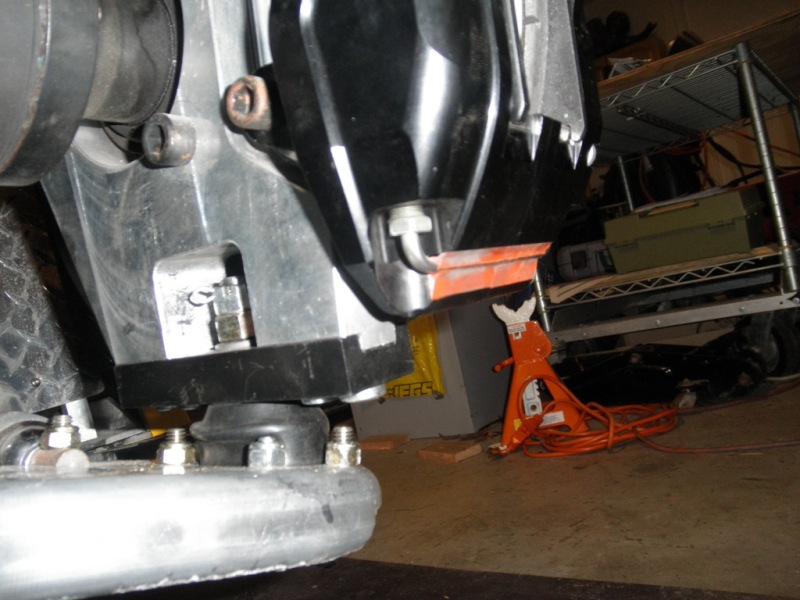

I was getting some creaking out of my balljoints. i took out the stacked washers and added an SAE grade 8, 1/2-20 nuts below the castle nut. this tightened it up and also means 9 threads are re-inforcing the balljoint now.
