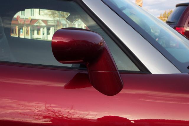

Hello Cam

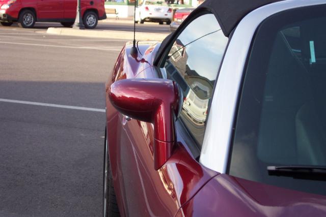

I like your rework of the mirrors. I have been looking around for straight stalks similar to yours. These are the closest I've found. These are electric. I seen them on Monday when I went to Makinaw City.
Regards Brian
Nice, is that on a Eclipse or a solstice? The Eclipse looked like they worked but the fiberglass mirrors came with the kit so figured i'd use them.
Brian Kissel
It's a Saturn Sky. I think they are the same for the Solstice also. I found them on Ebay for $150.00 a pair " newGM ". I think they are like $400.00 at the dealer.
Regards Brian

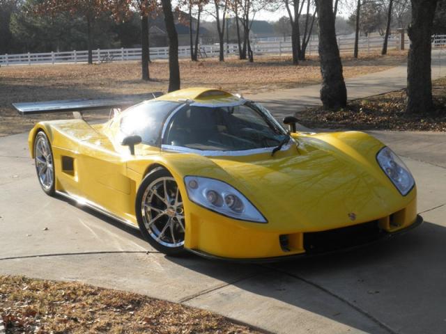

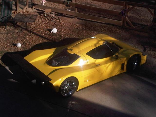

Hadn't posted in a while but been busy. Here is another shot of the tail light in using the new F/g mount. I'd recommenda strip of glass over the top of the assembly. Initially i epoxied it in and it was jolted out. I took out the stock dodge mounts, too short, and tapped uneven all thread into the holes left behind. changed ou thte bulbs for LED cluster. I nuked every bulb in this car and went with LED's, except the headlights.

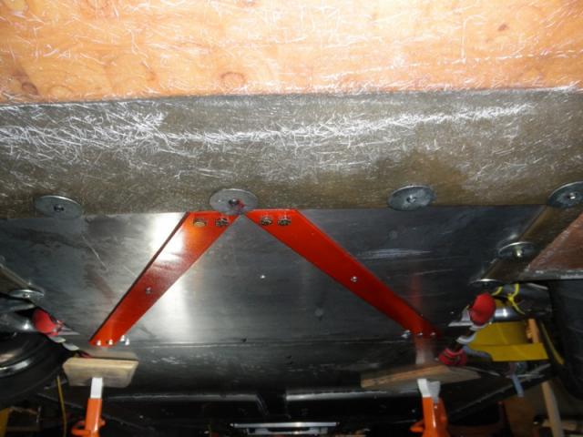

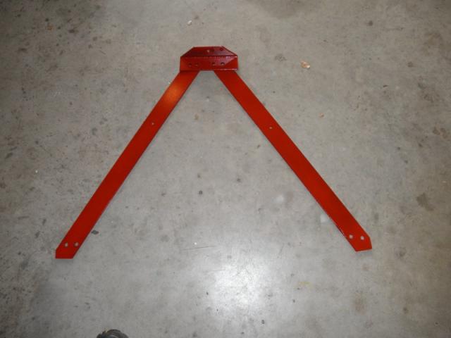

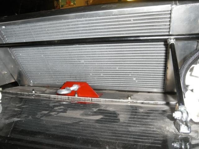

The front end really has nothing structral to tow from. Not that my build will break down but i might get a bad load of gas:drunk:. I reached back to the footbox and braced the front of the trinagle with some beefy 1/4" steel angle. Yup, i said steel. i added around 12lbs to the car. but my New Years resolution is to lose that 12lbs!
I wanted to add some rigidity to the front clip and floow the lines. it just happened to end up looking like steel spears! Eventually i'll tie these into the lower Tow bar. this hopefully will add additional force to keep the tow bar from trying to bend upward if towed.

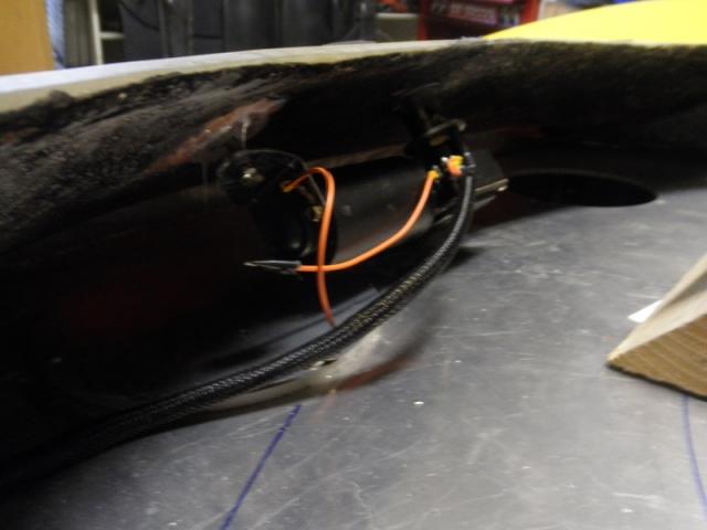

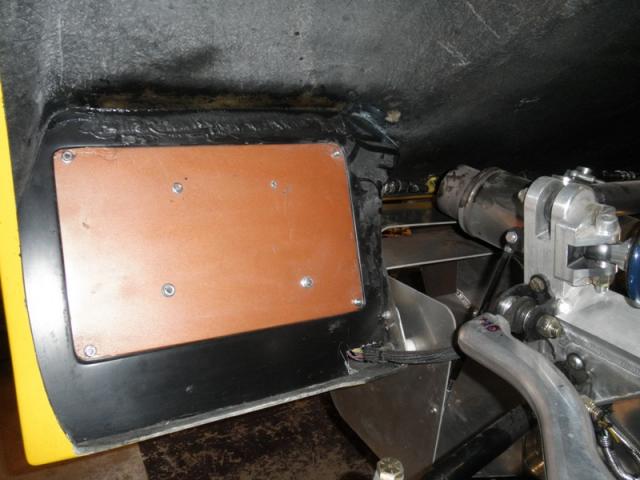

Here are a few shots of the wiper. I needed to chop into the top of the footbax to get the wiper down far enough. If not the wiper blade will overshoot the top of the windshield. It works amazingly well although i don't have the self park wiring. i assume it comes off the 40 way pigtail but don't have time to mess with it. i just need it for inspection as i won't be driving it in the rain. I'll just self park.

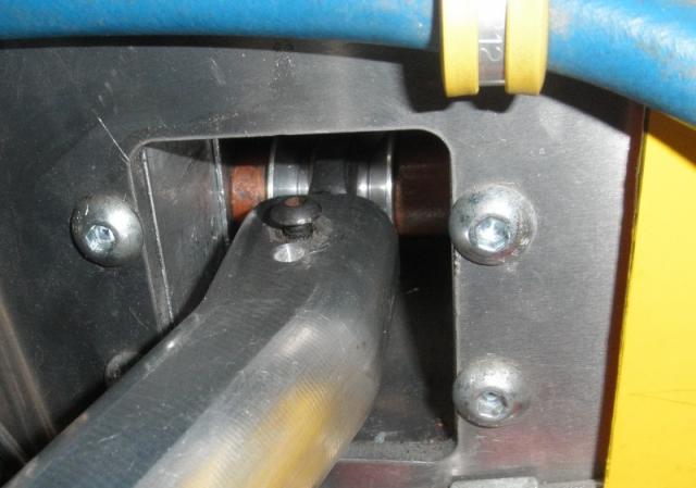

I had zero washers on my Lower control arm mount. i cut 4 steel spacers and left a little daylight, around 1/32". then i pounded a 1/16" front end shim into the gap. I think it's important to give this heim no chance of moving. Otherwise the heim will prefer to move on the 5/8" bolt.

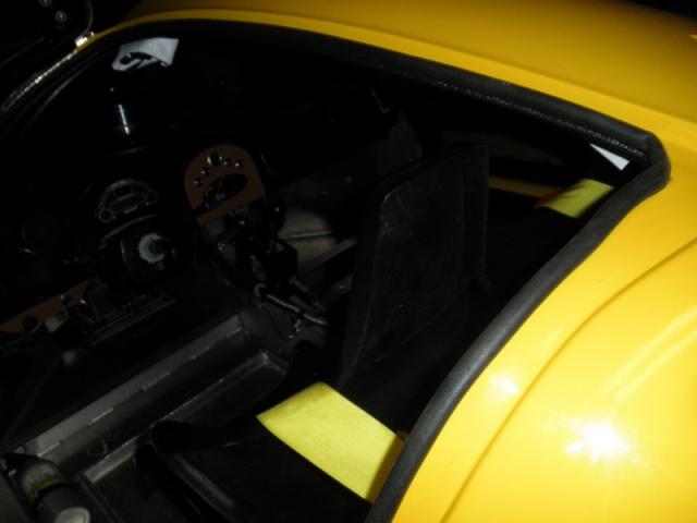

Shoot, bought 1" bulb seal. i think the 3/4" would work best. here is a pic of the one i shouda bought.
