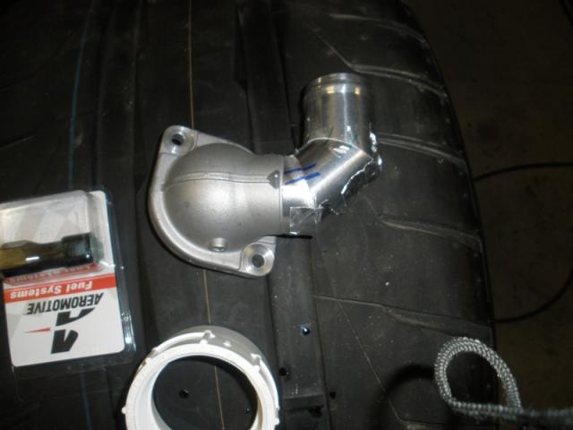

I gave up. i coulndt find a thermosatat housing for a modern LS that rotated 360, so i made one pointing down. I saw a plate on ebat that adapted LS to old school snmall blocj tstat housing but added 3/8" clearance. Had to clear the firewall and the fuel filler so this is about the only orinetation i saw working. Short of spinning it 180 deg and threading it through the belts! Hadn't used 22.5 deg angles since trimming my crown mould...

Good job Cam,
Also cut & rewelded mine to point straight down. Same interference found with the adapter plate for old school SBC housing..
Yours is "prettier" than mine too..

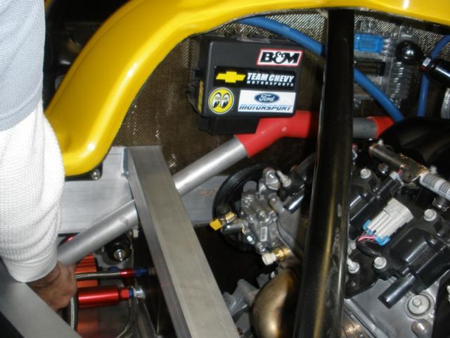

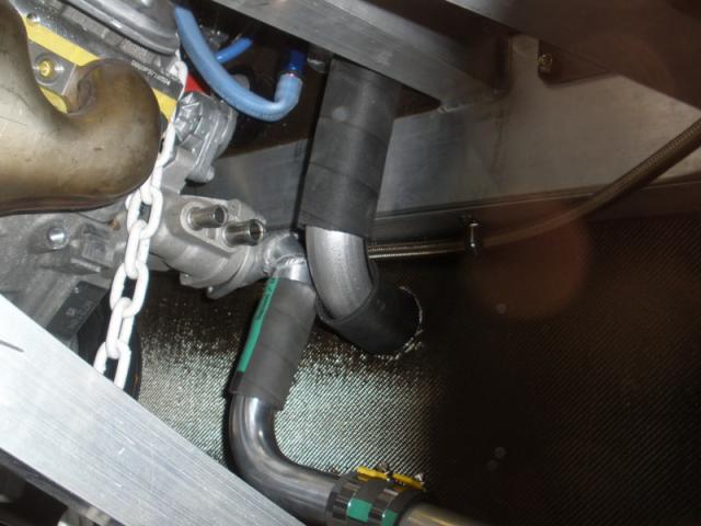

TRying to finish up the coolant system. I have to snake the radiartor return line in between the Fuel system, fuse box, serp belt pully as well as the SLC frame. its gettting crwoded back there.
I'm about 1/2" away from the serp belt pulley. with solid motor mounts will that pully be torquing more than 1/2"?

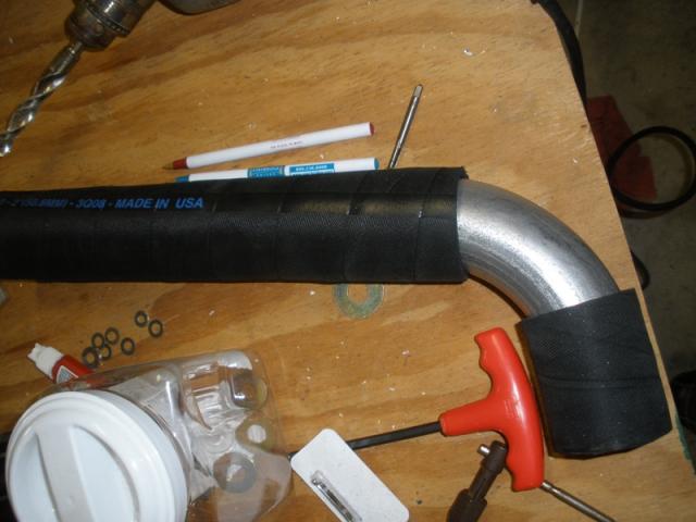

Fuel filler: Not my favorite idea but i broke down and got a 2" galv muffler j bend. Cut the 90 out of it and joined it with fuel safe 2" hose. i think the sparco filler necks are 2.25" So i got the 2x2.25" adapter too. Wish i had one !

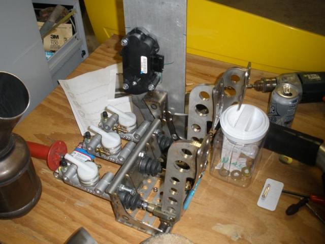

Huh, guess i have been busy , just haven't offloaded the pics. OK, it's ugly but i wanted to stay with the LS drive by wire. Waiting on some 1/4" cleavis joints. These are hard little gems to find, so McMaster carr!
I'll clean it up, thanks Tim for the idea!
