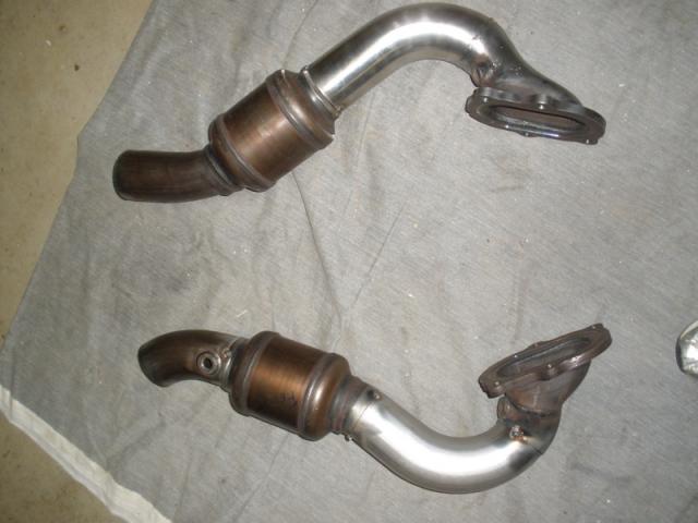

My sons favorite part of the build so far, 3" SS J bends. I better cut these up soon or they'll disappear. I picked up a z-06 Vette exhaust, cheap on ebay right now. These cata are huge. I think i fit it but worried about weld shrinkage on 304 ss to 409 ss. So i'm making one weld, carting it back to the SLc and tacking up the 2nd one.
Does anyone see a problem with this cat getting anything too hot. Anyone? anyone? Bueller?

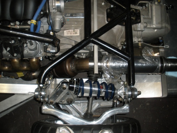

I'm planning to build heat shields around the cats and some of the exhaust to protect the transmission, the shifter cables, and the clutch hydraulics. I see you still have the original FGT foil insulation around the clutch flex line, which is a start. I will cover mine with one of the Aeroquip or similar hose covers.
I expect to run a trans cooler, and use minimal shielding for the exhaust, which I hope will be adequate to keep the transaxle cool. We don't get as hot, or as hot for as long, as you do in Texas, but I think a cooler for these transaxles is a good idea.

I hadn't though about sheilding the cats. I was most concerned with melting the Rubber CV boots. Good idea. what do you guys think about header wrap for insulating the exhaust ?
HSP301050 - Exhaust Heat Wrap - 1" Wide X 1/16" Thick X 50' Long - Premium Grade - HSP301050
Heatshield products claimed it will increase horsepower, blah blah blah. Might look a little nast as i start to melt tire/road debris on it, but oh well. I'd love ceramic lined headers but it's not in the cards for this build.

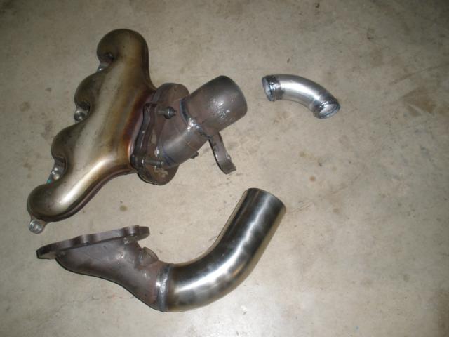

Worked til 2am on the drivers side exhaust. The other side went deceivingly well. Mhis Z06 down tube smacks firmly into the frame. Booo! Probably my biggest setback so far. I've gotta do major welding sugury or go back to LS3 2.5" exhaust.

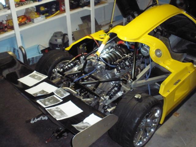

Huh, now that the tail is back, i find out it makes a great workspace/table. It doubles as a dinette some nites...

I think they weree right on the type of stainless. The LS7 exhaust seemed to be 309 hydroformed SS and welded up nicely to the 304 mandrel bends. I'll start from the front and piece by piece, weld them to the mufflers...

Thanks. Chopping that Stainless downtube and reconnecting was some work. The cut left behind 3/8" gaps that were tricky to weld/hammer closed. I drove the piece 2.5 hour east to a guy who used to weld on nuclear power plants, I trust his welding.
I realize i've been working past midnight the last 7 days in a row, the wife is real happy!
Got the final welds finished on the LS7 exhaust and they fit up perfect to the LS376. If anyone in Tx needs some tricky Tig SS or Al welds, i'd highly recommend Meeks Custom Welding, LLC
I have a dislike for cats now. They don't just get hot, they get really hot. Personally, I would not want that thing near those CV boots which will crack from the heat, and I would not be thrilled with it so near the damper either, but I have no experience there. I might try to gut it if you can. And I would make heat shields if you cannot.
