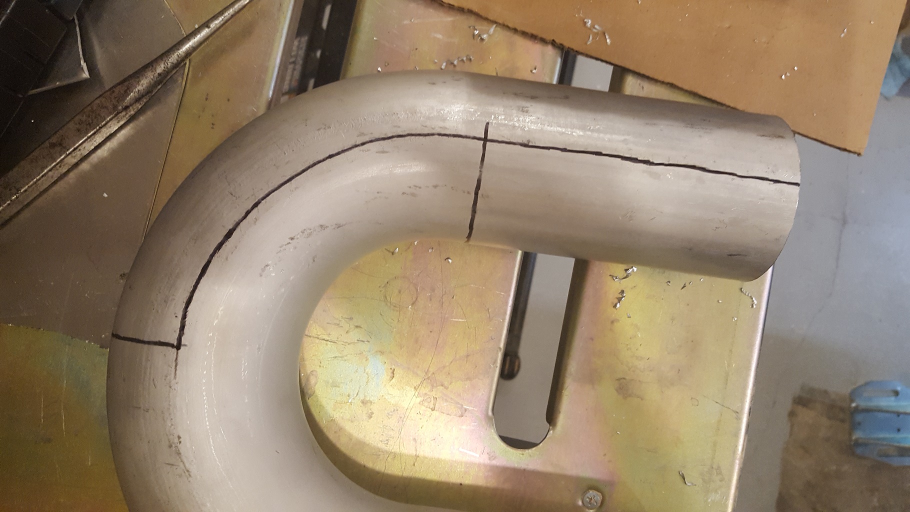

When I used the LS7 manifolds, I got two cast SS elbows, split them in half to make the outside of the oval, filled the middle with triangle shaped flats so coming out the side it was round. Took a bit of cutting/grinding/filler, but the transition to round was reasonable. That was for side exhaust. Many ways to skin that cat.

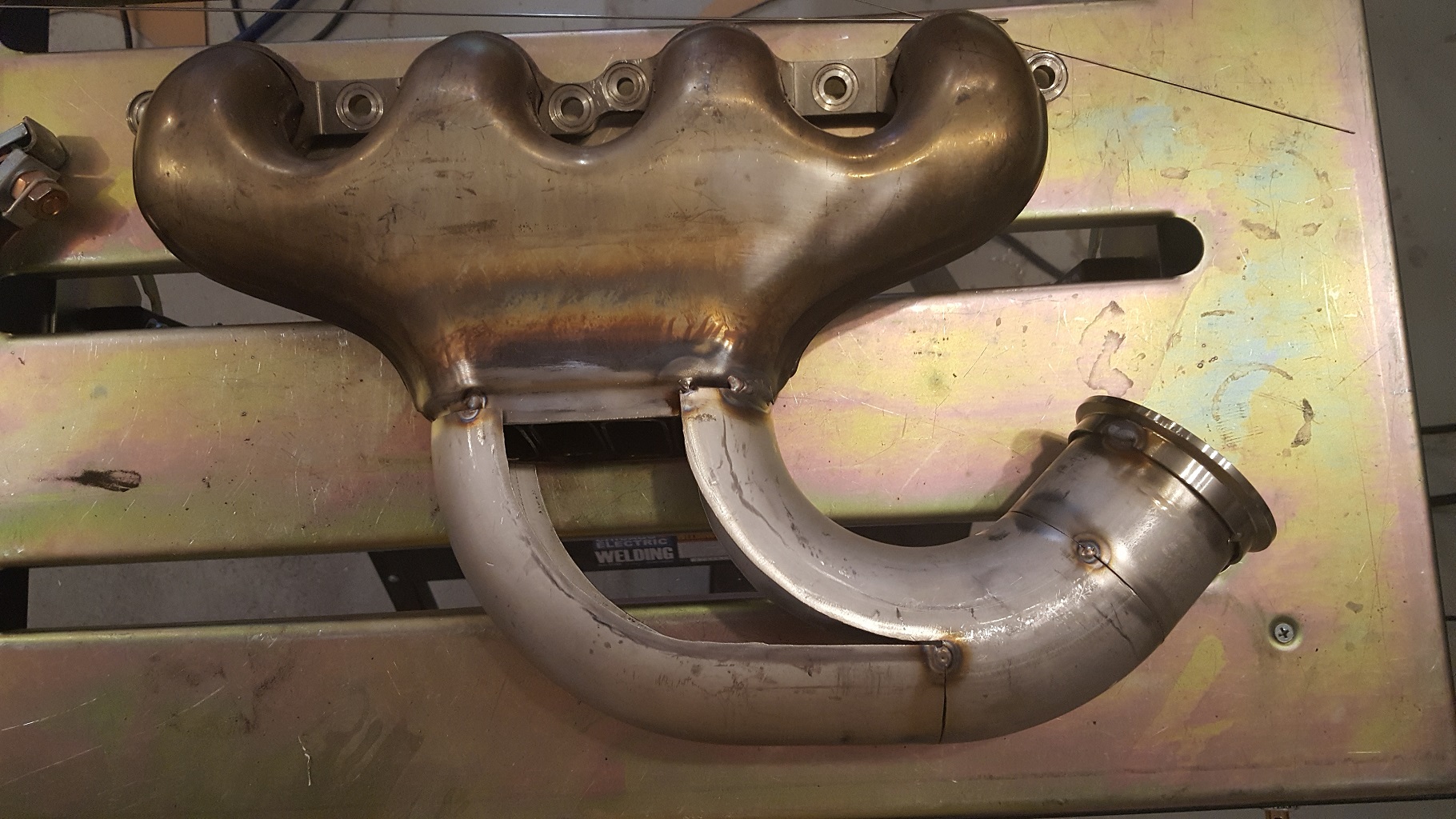

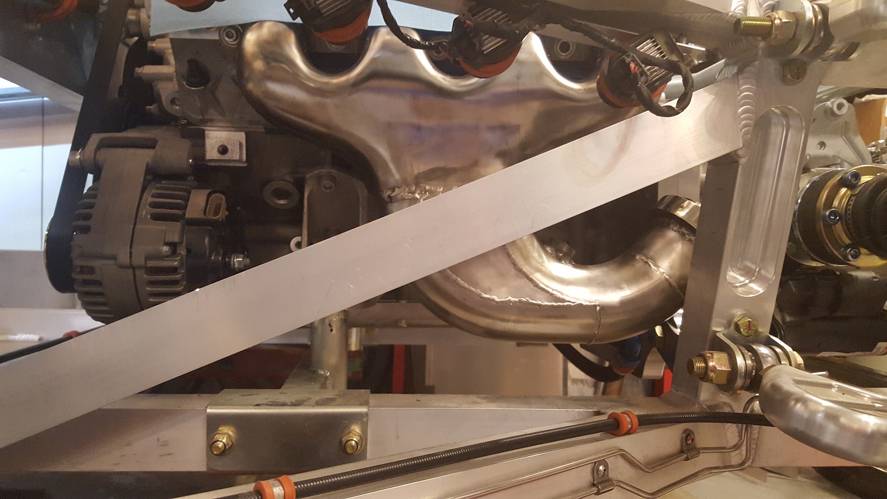

Frank, one of your previous posts inspired me to do something very similar, but to the rear instead of side. I picked up a 3" 304 SS U-bend off ebay, sectioned it, and filled in the triangle sections with 304ss sheet. I was able to integrate the 45-degree bend up to go over the axles and added v-band clamps. They have much more clearance below the header than if I had used the stock flange and bolted up a bend to it. My TIG skills aren't pretty, but they're back-purged and strong :)
Thanks for the inspiration!
I haven't finished the rest of the pipes yet, but here are pics of the headers.

Mark and Frank. I like what you have done. What is the best way to remove the flange from the header?
Mark B.
I just used a 12" cutoff wheel on my miter saw. Lot of sparks, but zipped through it pretty easily. Then cleaned the flash up with a die grinder.
