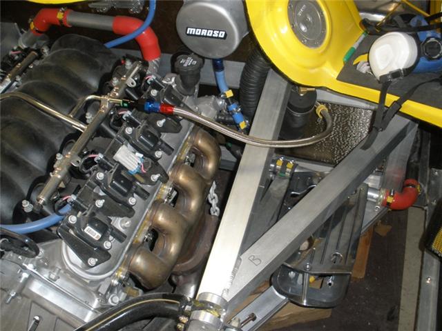

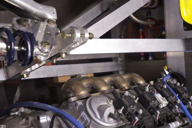

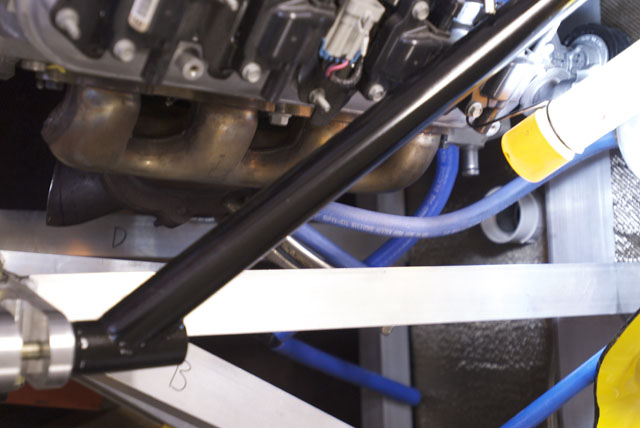

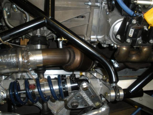

Shane,
Here are a few photos that I took of Cam's SL-C with LS/Ricardo. Not quite the perspectives that you might be needing, but best I can do from Lone Oak laptop for now:
Doc Kaler,
That last pic is the best I've seen so far of that area. Looks like as long as the collector clears that mount that runs from the chassis to the adapter plate, we should be GTG. Hopefully Fran will have time to check that out this week so we can be sure. Thanks for the help! If anyone else has some pics of this area from different angles, feel free to post.
Shane
