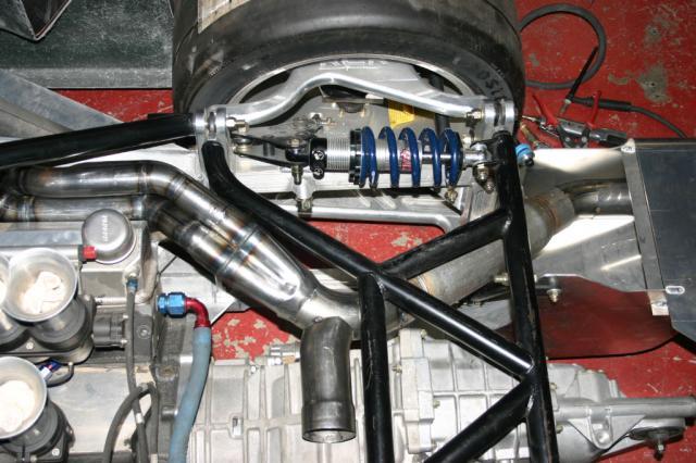

The request is for a 180 deg. bundle of snakes style exhaust system....not just a crossover....we use Sebring mufflers on some of our SL-C's so that is not a problem.

Sebring offers a nice polished stainless internal X pipe design like the one Crash posted a picture of. I spied it at SEMA two years ago but as noted without room above the rear subframe there would be no place to put it.
Ketel: It may be a while before I can spell your name correctly :) There is no room to mount a muffler cross ways behind the grearboix as you posted pictures of. I don't remember if the 25 hour car had a cross mounted system, but if it did it was probably because the very small racing gearbox allowed for the room to do it.

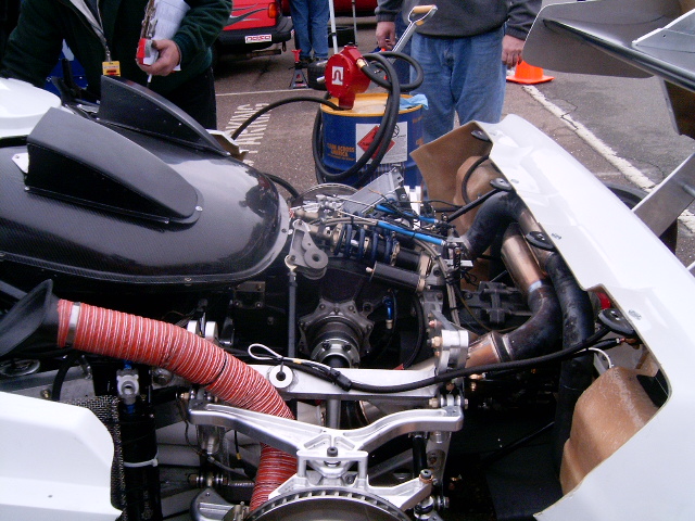

the #18 car actually has four mufflers...two are Burns race mufflers, mounted low and very close to the collectors .
The other two are Sebring units that are mounted above the rear of the transaxle and the pipes cross ending in tpips that exit the rear diffuser...
The engine being high. comp. was still pretty crisp if you recall and we really needed to dull it down a little more...thats for 2011.

Fran, are you running mufflers and cats on the exhaust that you made turn out before the rear tires?
Rob,
"Crisp" now there is an understatement LOL .....actually I liked the sound especially on the downshift/over-run. But then the sound police didn't like it so much did they?

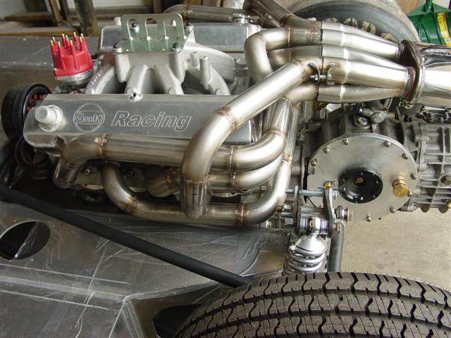

When I get my headers from Fran, I'll post some pictures how I am going to do mine. The basic plan is to run equal length 4 into 1's. Kinda of a downward and froward swept with the end of the collector at the rear of the heads. Then run a crossover "H" above my Porsche and then out through the diffuser after passing through two round mufflers one on each side of the gearbox. It all fits nicely in mock up. I will be loud but good enough for all the tracks around here except Laguna Seca and OK for a streetcar should I ever convert it to one.
Heres a pic of a SLC with a H type crossover above a Porsche.
