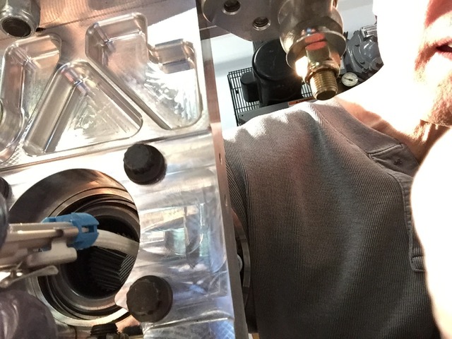

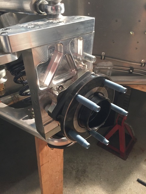

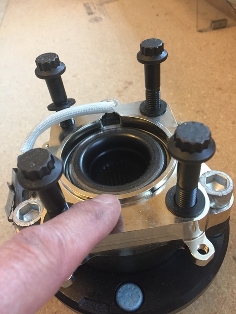

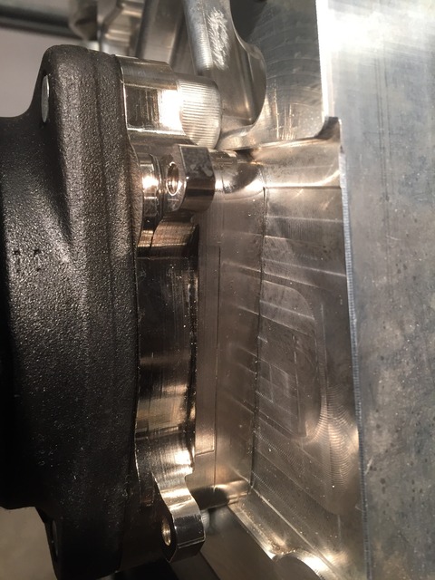

I finally got around to installing the ZR1 Corvette SKF X Tracker front wheel hubs. The adapters to convert them for use on C4 Corvette and 1998-2002 Camaro are made from Chromoly steel. They fit up snugly just as the hubs supplied with our SLCs do.
The C4 Corvette owners and Camaro owners that track their cars regularly claim that the front hubs must be changed out twice per year. When they switched over to SKF X Tracker hubs they were able to go two years without changing them out. There was far less pad knock back as well when cornering.
Mounted in place (left picture)
What the adapter looks like.
Pointing to the lip
A back side look at the lip once installed in the upright
The snug fit in the upright (right picture)

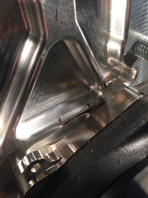

The only bit of modification that needed to be done was at the top center of the pocket in the upright. A very light touch with a die grinder and aluminum bit easily took care of it as shown in this picture (between the 2 black marks).

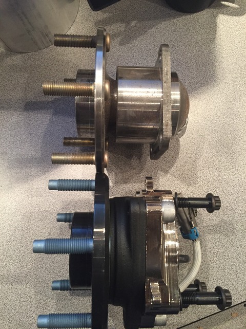

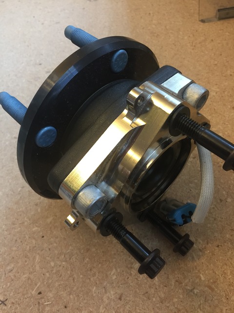

Here are a couple of pictures showing the differences between the stock C4 hub that is used on the SLC and the SKF X Tracker hub used on the ZR1 corvette. The SKF hubs shaft is hollow where as the C4 hub is solid. The SKF hub and adapter was slightly less than a pound heavier. You can see the difference in thickness of the flanges when side by side.

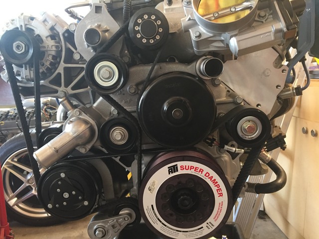

I finished the custom LS9 build for the next project car and developed a belt wrap that eliminates the large and heavy power steering pump. There is very little in the way of 11 groove belts. It's an odd size. Quick work with a utility knife and a 14 groove belt in the desired length and it's now narrowed to a 11 groove belt. The drivers side idler pulley was removed and a 12 groove pulley from a Caterpillar with a machined spacer (for alignment) was installed. The belt runs on the 11 inner grooves.
Now the water pump coolant outlet piping will be easier to route as well as the large air intake piping that must be curved around to face backwards.
