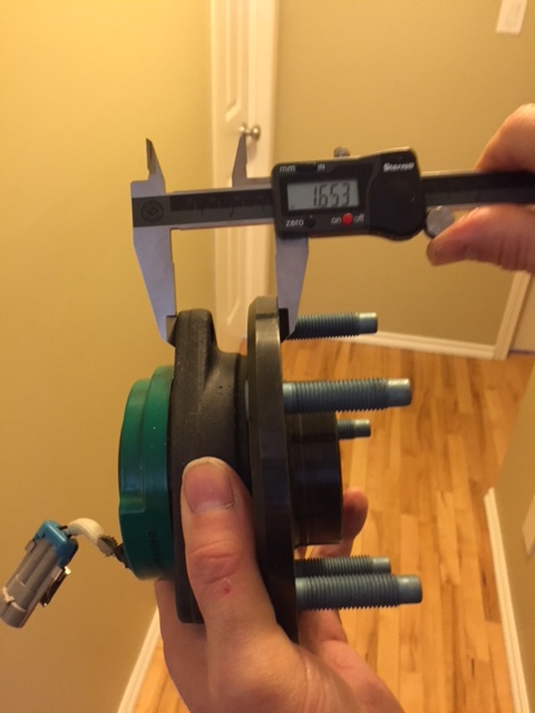

Does anybody have a C5-C6 hub in hand that they can take a measurement from? NOT C4.
I need mating face of upright to mating face of rotor. See picture

Do I remember correctly that there were different hubs provided by Fran in the earlier and later kits? It's so, will that affect the need for upgraded hubs?
