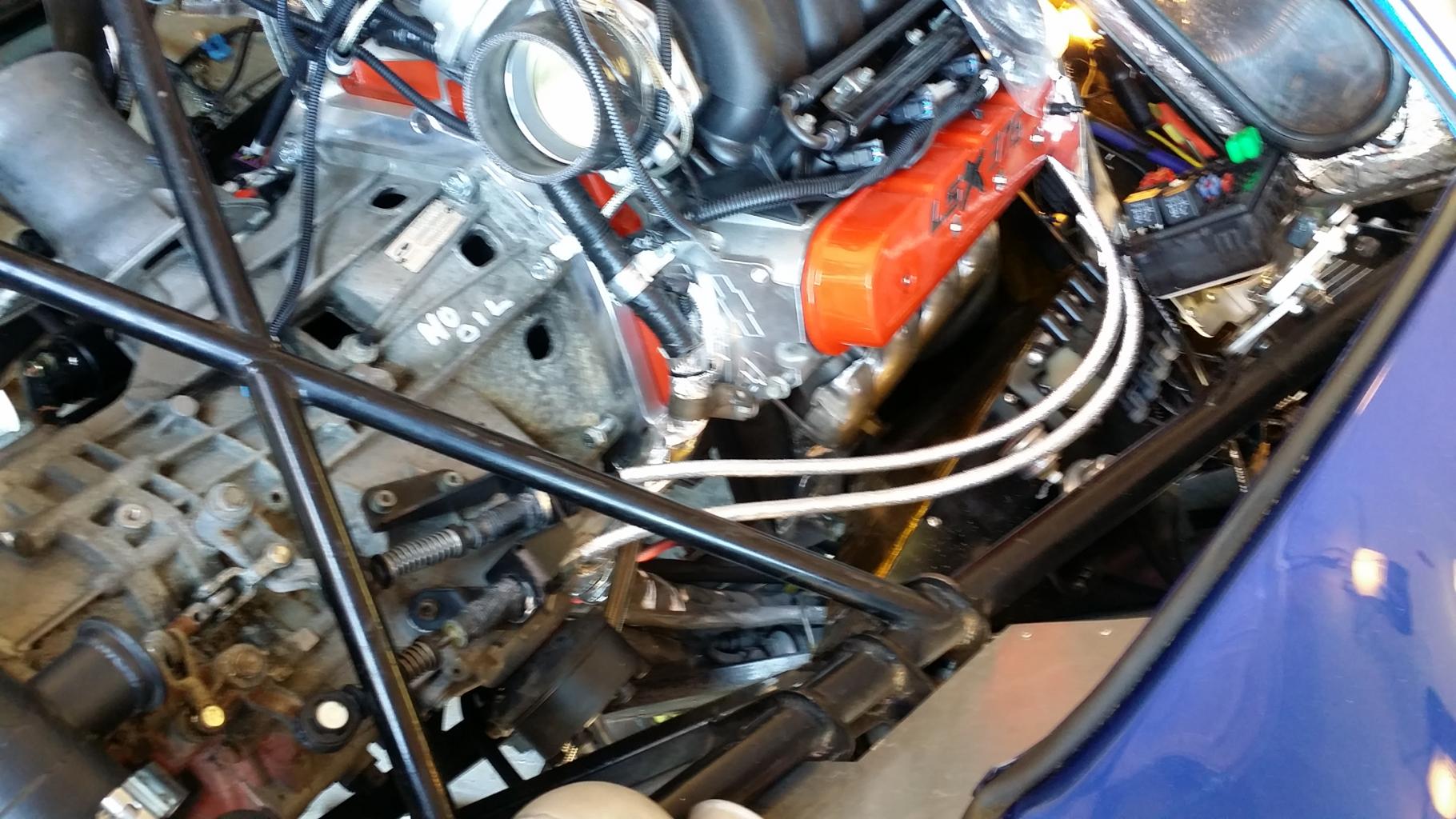

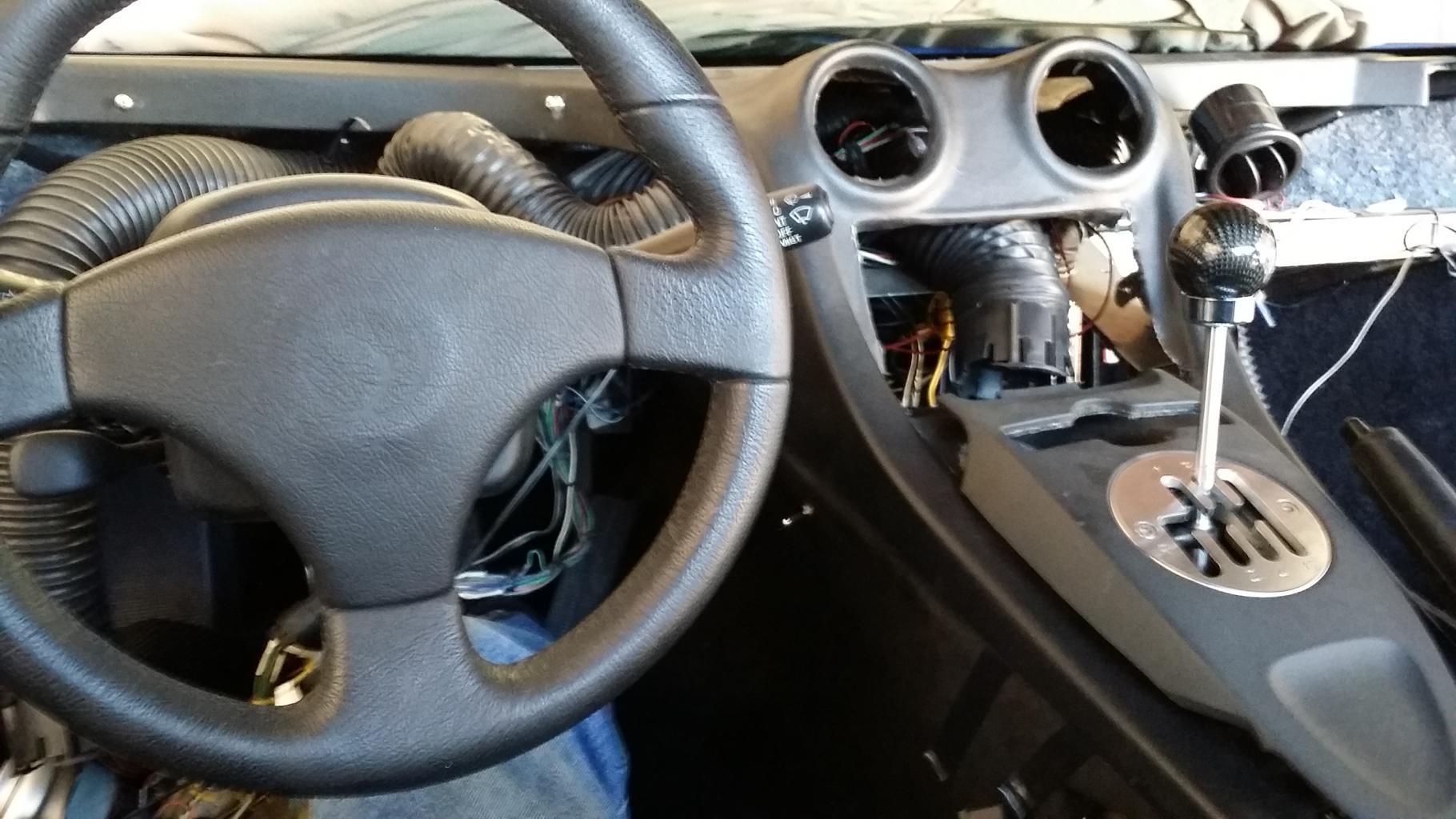

The centering and whatnot is why I went with the actual gated shifter from the Gallardo. It's ridiculous price wise compared to the Brandwood units, but I wanted to try something different. That also permits the use of stock Lamborghini cables and the gate/throw is perfect. It also requires you to push down on the shifter to go into reverse, which is a nice feature.
I have to glass in the shifter and finish all the brackets, but initial tests were flawless.

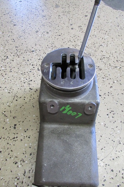

Dave,
I believe "Bodhii" addressed this earlier and indicated that the R8 also is gated at the shifter. If I remember correctly, he did not like it.
Although not an SLC, I thought about just the gated shifter in mine. I was afraid though that the gating would not match up to the Brandwood shifter (thats a really good price for those, you should look up the price of the Lamborghini plate!)
I also bought the outside case for an R8 shifter box as they are different slightly in size, but same internally. I've actually thought about getting the Lamborghini shifter box to Jim Brandwood since he is local so he can use it for dimensions, which then you could use it with just the gated cover plate. That would be a much better deal considering I have $2500 just in the shifter and cables alone.:thumbsdown:
