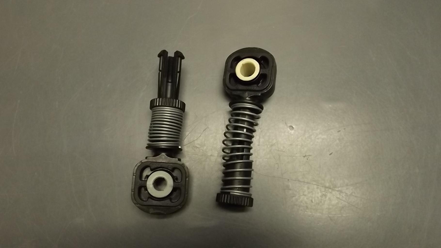

OK finally these little beasts arrived this lunchtime. (weeks late but beyond my control..:veryangry:)..they will be shipping out to all in need within the next 24hrs.

Has anyone tried the cable ends? They are plastic seem pretty light they have some rubber in them and I am sure are made for softer feeling while shifting, I think they will work ok in a street car but I am not sure on a track or combo. I have adjusted my cables as best I can with the bracket supplied the cables are two long, I will have to change the bracket to get enough room if I am going to use the plastic hiems[stock ones].
The one cable/hiem will hit the trailing/adjusting arm that goes from the chassis x-member above the engine down to the frame upright, it looks like I may have to move those brackets, I figured this was going to be a problem even if I ended up using a smaller steal hiem joint for connection of the cable to the grazziano.

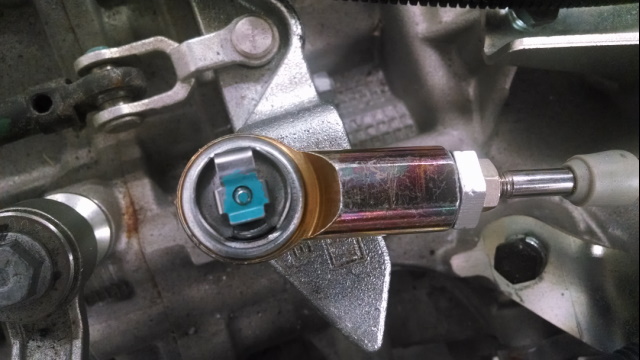

I received the cable ends from RCR a couple of weeks ago. One of the ends fit fine (the one that snaps over the ball joint), but the other was a rod end that fit fine over the post, but was designed for a 10mm pushrod end.
As the pushrods are 1/4-28, the 10mm size was way too large to fit.
I emailed RCR to ask if this is the correct end, or if some kind of adapter was recommended. A week later, they replied with the contact number of their supplier and suggested I contact him directly to resolve the problem.
I was concerned that this would result in further delays. Fortunately, a friend came to the rescue with the suggestion to drill the center of a 10mm bolt and tap it for 1/4-28, thereby making an adapter. This worked great and the cables are now connected.
