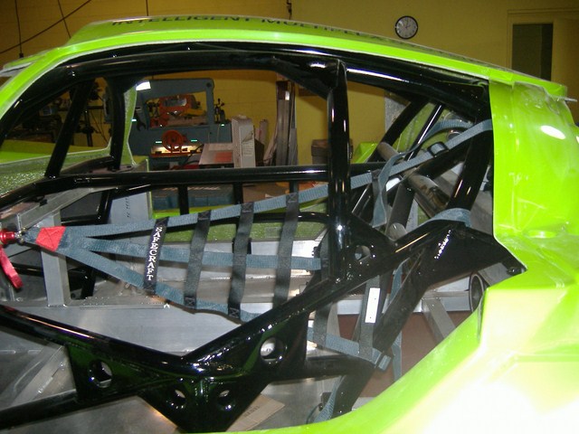

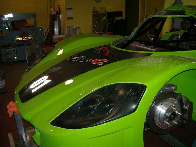

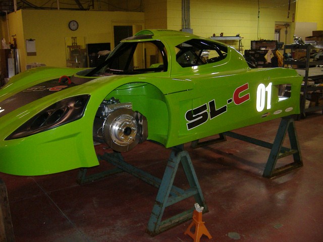

Some quick snaps of the factory racer in gelcoat...we are testing in a couple of weeks....
The engine is a pump gas LS3 based engine...ARE dry sump system but very mild build and should go a full season or more without major work..

Is that a new Gel Coat color for an RCR?
Sharp looking car... I like the gussets on the cage - would like to see more..
That LS3 engine is a bloody marvel of engineering...
Just about any colour is available ....just need to ask...
Cage is built to FIA/SCCA/NASA specs...this is a spec build and repeatable for open track or as a specific race class package.
Stock chassis with all stock suspension pick up points but race specific arms/uprights/brakes etc etc .....so anyone with an SLC that has decided they want to go racing can make the conversion...
The parts are not for the street though as there are no balljoints...only race spec spherical bearings...and I will not sell them to anyone for street use..
Much more to come ....stay tuned.

They are attached to the car....buy an SL-C racer and you can look at them to your hearts content...:thumbsup:...they have some very neat features that I have not seen on any other.
