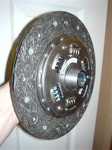

I would have thought it unlikely to be gearbox related. If the slave is moving OK then it seems that something is preventing the slave cylinder from pushing the release bearing in to actuate the clutch. The clutch fork may be stuck or jamming against something. Or the clutch assembly may be stuck together preventing the plates from separating. The plates may be stuck by rust. If there is a slight springiness when you press on the clutch I would suspect the stuck by rust as the spring fingers on the clutch cover are slightly bendy. If it is rock solid I would suspect something jamming the clutch fork or release bearing carrier. If the plates are so stuck by rust corrosion and it is so bad as to prevent movement then the usual trick of rocking the car in a high gear with the clutch pressed is not going to work. You can check the gearbox is OK by lifting the rear wheels off the ground and spinning the engine over on the starter in all the gears.mtake the plugs out to give the starter an easier time. If you engine will run the use that to check that the wheels spin OK in each gear. Make sure the car is securely held on axle stands if you do this check. If the box is OK then a strip down separating the engine and box to check what is going on with the clutch.
Mike Pass

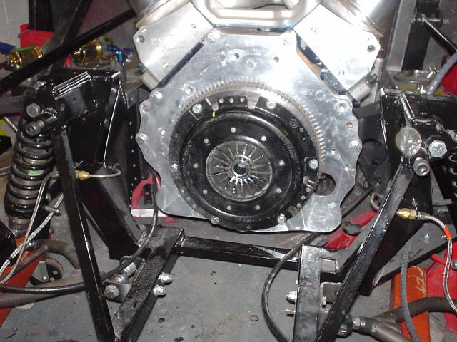

I have just had a quick look at your build log at the part where you have your new driven plate and the assembly of the gearbox to the engine. On the pic of the clutch cover installed on the flywheel it looks to me that the metal boss at the centre of the driven plate is too big and you can see this just below the clutch fingers. If the clutch fingers are prevented from being pushed in by the driven plate boss then the clutch will not open and you will have a solid pedal as you are trying to compress the metal boss of the driven plate. I guess you are going to have to remove the box and strip the clutch and modify the driven plate boss to allow the clutch fingers to move and the clutch to operate normally. I am not sure which clutch bits you have whether Renault, Audi or a mixture. When I spoke to Helix about the Renault clutch I had on my car initially. They told me that the max torque the Renault clutch would take even with their upgraded parts was 280ft.lbs. which was why my clutch was always slipping once it was even slightly worn. I replaced it with one on Mick Sollis's AP Racing ones which are rated at 340 ft.lbs. and it has never slipped since even with regular abuse.

It is hard to tell from the pic of the assembled clutch (re-attached) as it is quite low resolution so even when I zoom in there is not enough detail to see clearly. From what I can see it looks like there is not enough clearance for the fingers on the clutch cover around the boss of the driven plate. If you have a better resolution pic you may be able to see it better than I can. If these clutch fingers can not move past the driven plate boss they will lockup solid when you try to operate the clutch and give the symptoms you describe. If this is the case then you will have to remove the box and turn down the driven plate boss in a lathe to get the clearance needed. Maybe the supplier of the clutch bits can shed some light on how it is all supposed to work together. Do you have pics of the inside of the bellhousing and clutch release mechanism?

Are there any openings large enough to get a small TV camera probe/flexi into the area for a look see [ only needs a 20mm hole], I had a quick look at your clutch plates and the pic mike has posted last night and there is a possibility the situation he describes exists.
Sadly the photos were taken with an older camera that was low res, so below is the best I can do. Regarding the whole setup, it was mismash of bits together in the days before suppliers started offering 01e/01x adaptor plates and setups. It is a Kennedy adaptor for a 016 and then a Helix plate made afterwards based on the larger input shaft and relation of the splines. KNowing me I've probably done something wrong :huh:

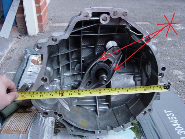

and a picture of the inside with the fork and original release bearing
DSC01516 by Brett-GT40, on Flickr
If your still using that release brg & fork there is a possibility that the fork hits the clutch cover before the bearing gets a chance to release the clutch, still a possibility of the clutch fingers hitting the plate hub before release also.

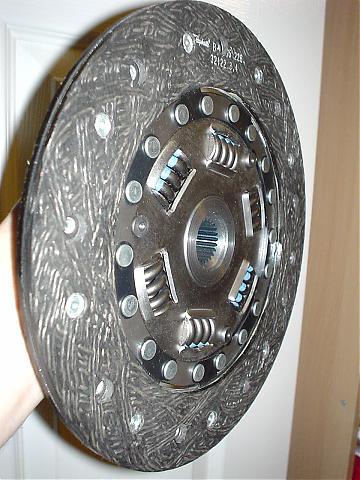

It may be significant when you say that Helix made up the driven plate for the larger input shaft. If the shaft and hence the boss are larger then the hole at the centre of the clutch cover fingers may be too small for the new larger boss. As you have a reasonable thickness of metal on the driven plate boss the maybe a better course of action may be to trim the length of the fingers rather than turning down the boss. This would need to be done accurately to ensure that the new lengths are equal on all fingers.

I'm thinking Jac is right, the clutch fork looks like it would hit the pressure plate and stop. Maybe you need a new carrier for the thrust bearing so it can reach deeper into the pressure plate, Didnt Jim C glue a spacer or similar onto his 01E set up to get reach?.

Hi Brett, check the length of the splined section in the disc, I got bit big time on a stage 4 pressure plate and disc from Kennedy eng, I ended up removing almost 1/4 inch off the length of the back side of the splined section on the clutch disc . Turns out the trans [016 Audi] was trying to push the disc thru the flywheel! trans in and out 7 times!!!!1 and I am a mechanic by trade!! Check also that the audi slave hasn't bottomed on the circlip at the end of the slave at the beginning of the stroke, let me know if this helps.

Putting a longer push rod is not the best option, I used the spacer because it puts the fork back in the correct position as well as the correct shape for the pressure plate used, also the fork needs travel through the correct ark.

The measurement from the bell bolt up face (of the gearbox) to the thro out bearing when fully home is ~90 mm
The measurement from the clutch(assembled) fingers to the engine block (or where the g'box bolts up to) should be ~85 mm
A 5mm gap is good
If the gap is more than 10mm --a spacer for the TOB is needed or you may try a spacer under the fixed pivot point (where it pivots off the G'box) of the fork.
