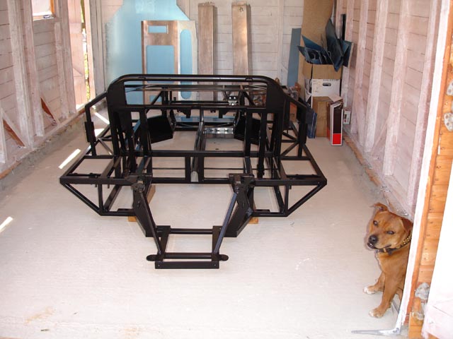

OK, we're off! Something like six weeks from first seeing the Southern GT I've got chassis 006 in the garage! The word "committed" springs to mind. I must admit to being a little stuck for words, it's been a long term ambition to get this far, I don't think it will really sink in till tomorrow when I get up and open the garage door.
Garage is not the biggest in the world and will be cramped at times. That's my mate "Ted", one of us is a big softy?

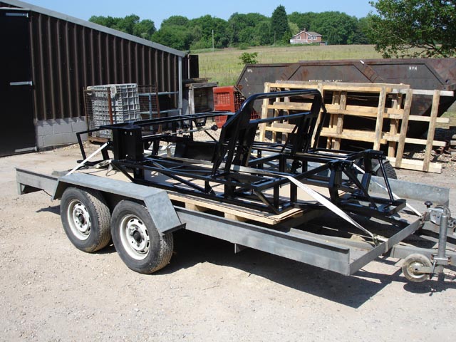

Outside Micks Workshop collecting chassis this morning. I was surprised at how light it was at the other end putting it in the garage.

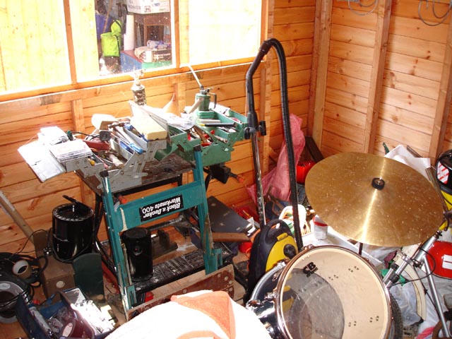

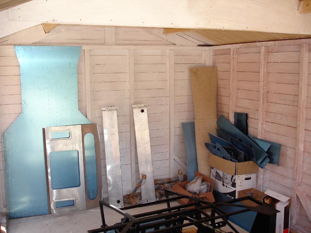

Don't expect the car to be ready this time next year (how did you do that Jerry?), I reckon on at least 2 1/2 years but hopefully less. As you can see the Workshop shed is awaiting attention post house move.
