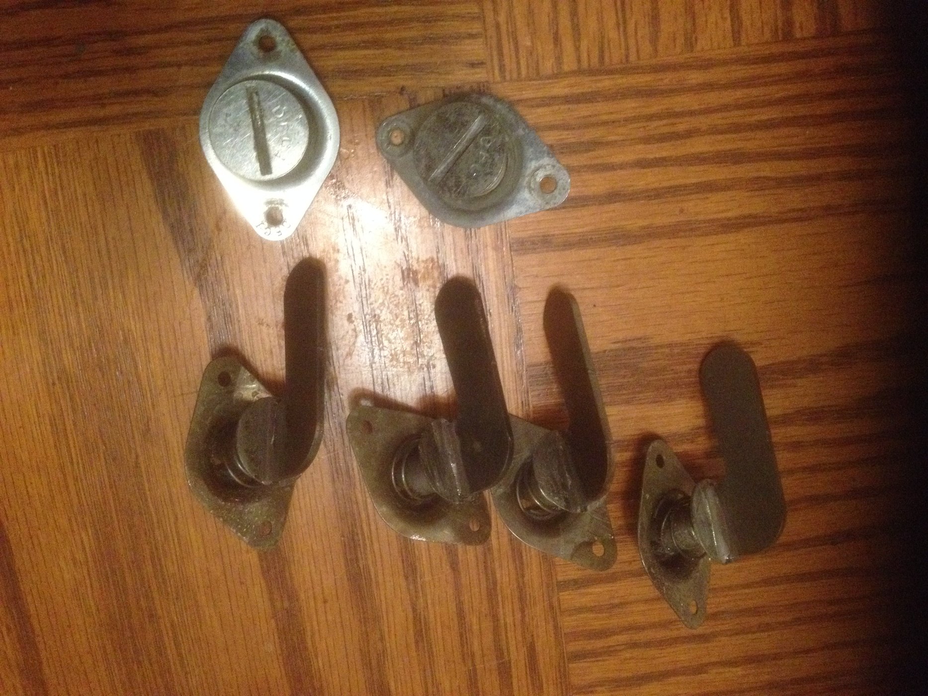

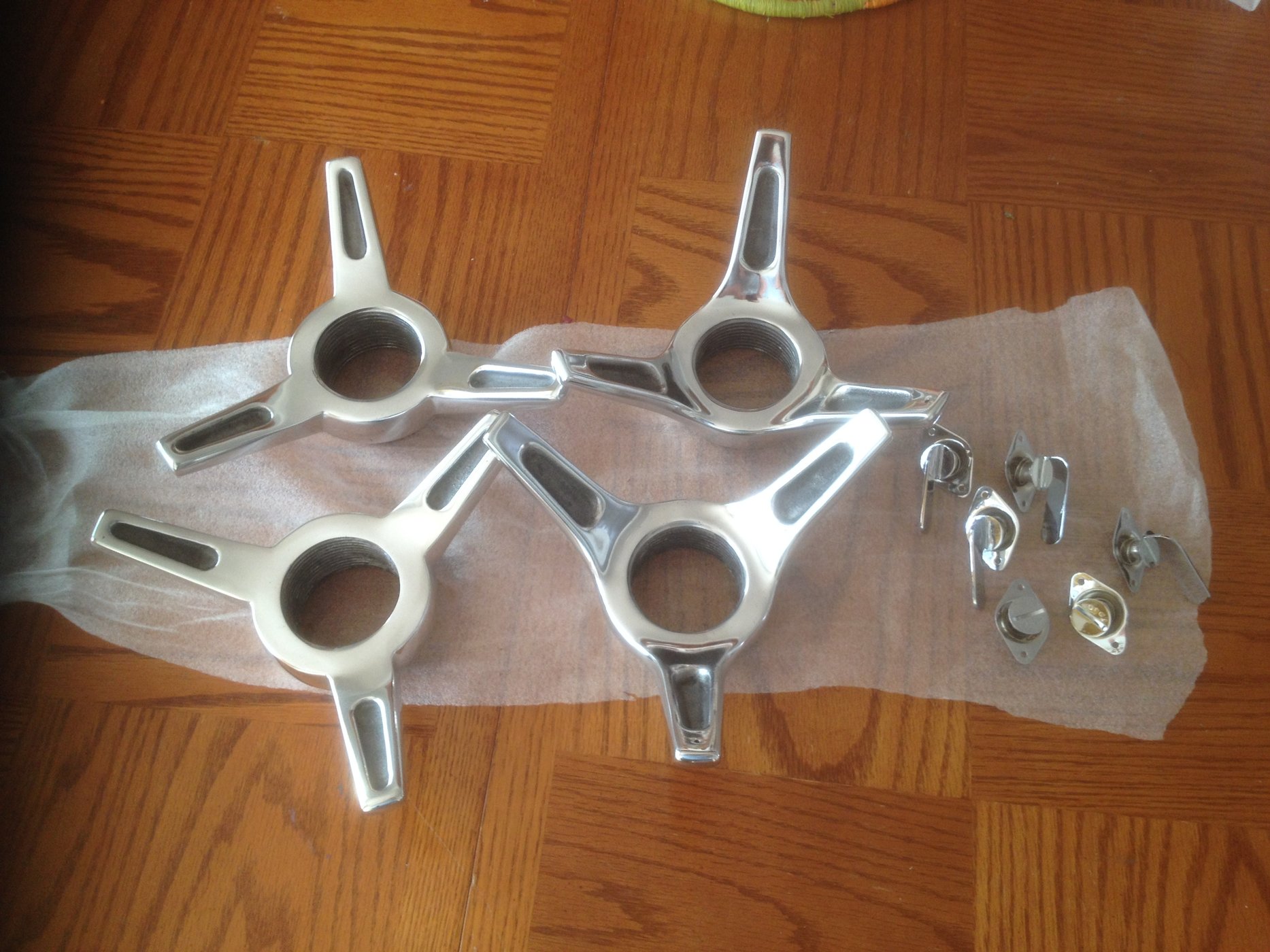

I managed to get some new old stock DZUS fasteners and some “wings” from James ( Jimmymac ). Soft soldered the wings onto the fasteners and got them chromed and the spinners metal polished.
The company who did the work said it would be 6-8 weeks, I managed to get them down to a half promise of a possible 2 weeks if everything went well, as I explained the car obviously can’t be moved in and out of the garage to work on without them. Took them in on Monday, they rang 2 days later Wednesday to say they were ready, well chuffed.

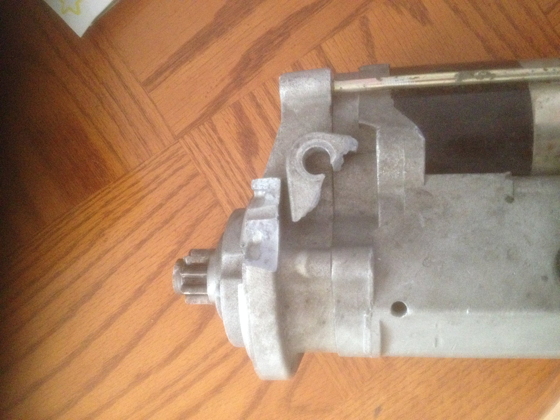

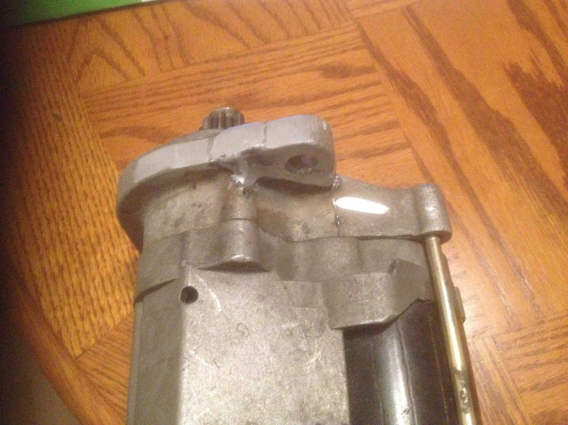

Well I have had better days !!! should have followed my wise old dad's advice " more haste less speed". Having got the car back after almost a year, thought I had better get it started. Turning ignition on click then nothing. 2 trips to the auto electrician and he was adamant the starter motor was good. Still click then nothing about to give up and tried a direct battery 12v to the solenoid and the engine turned over, then a bang :( ln my haste I had forgotten I had not put the second nut on the starter motor retaining bolt. Turned out to be more expensive to get the lug welded back on than I was expecting, possibly the extra was a fine for cruelty to GT40 replica starter motors.

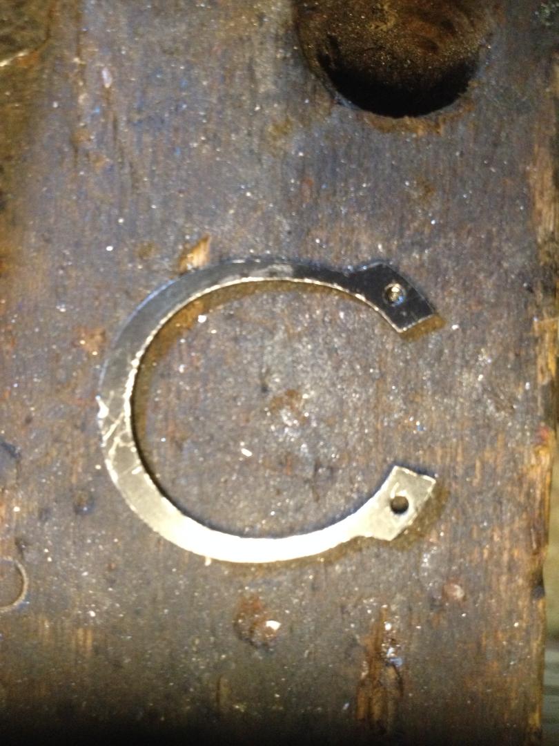

Today was supposed to be the day I took my car for it;s first outing to see my friends at the North West GT40 Enthusiasts Club meeting. As the saying goes "The best-laid plans of mice and men often go awry", and they did in the form of a floppy half shaft, caused by a truculent circlip,and detected by luck. The circlip has been replaced by a similar one from my friendly local garage's stock but I am not confident it won't do the same again, sadly the meeting was missed.

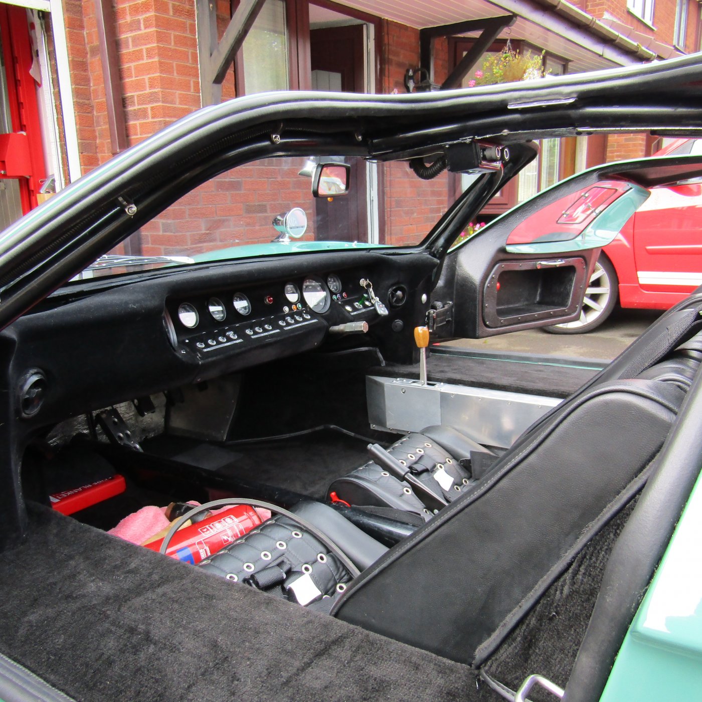

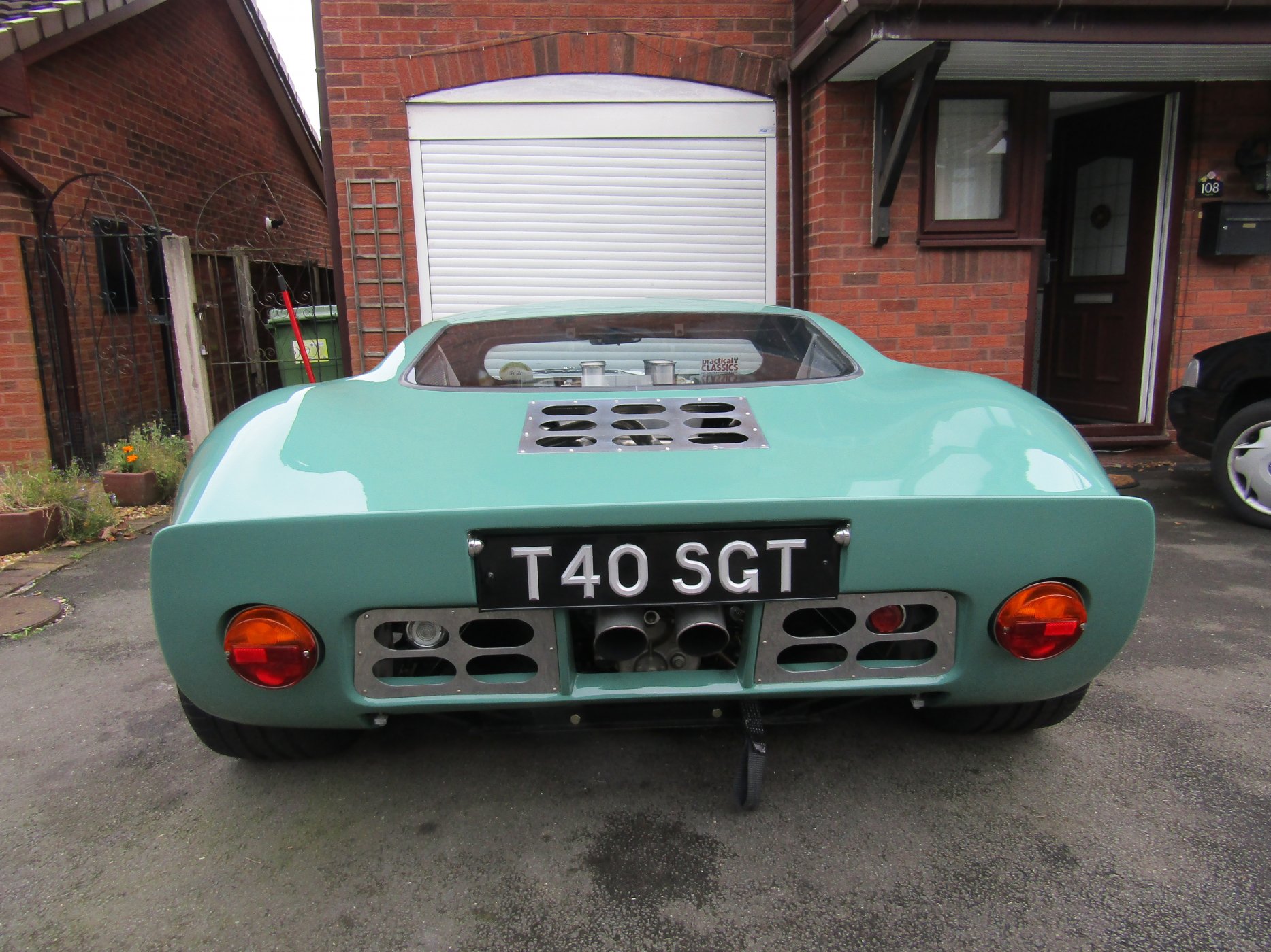

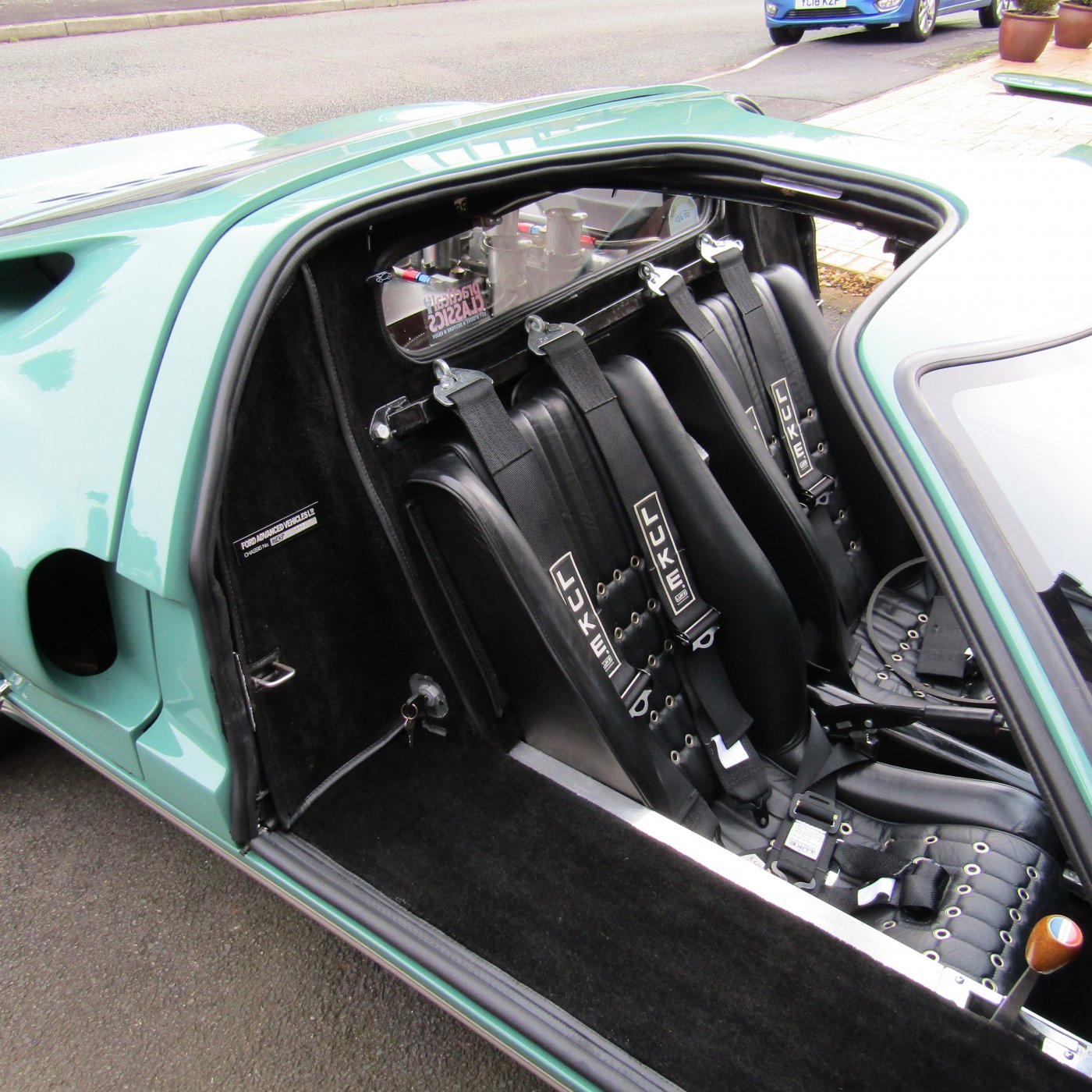

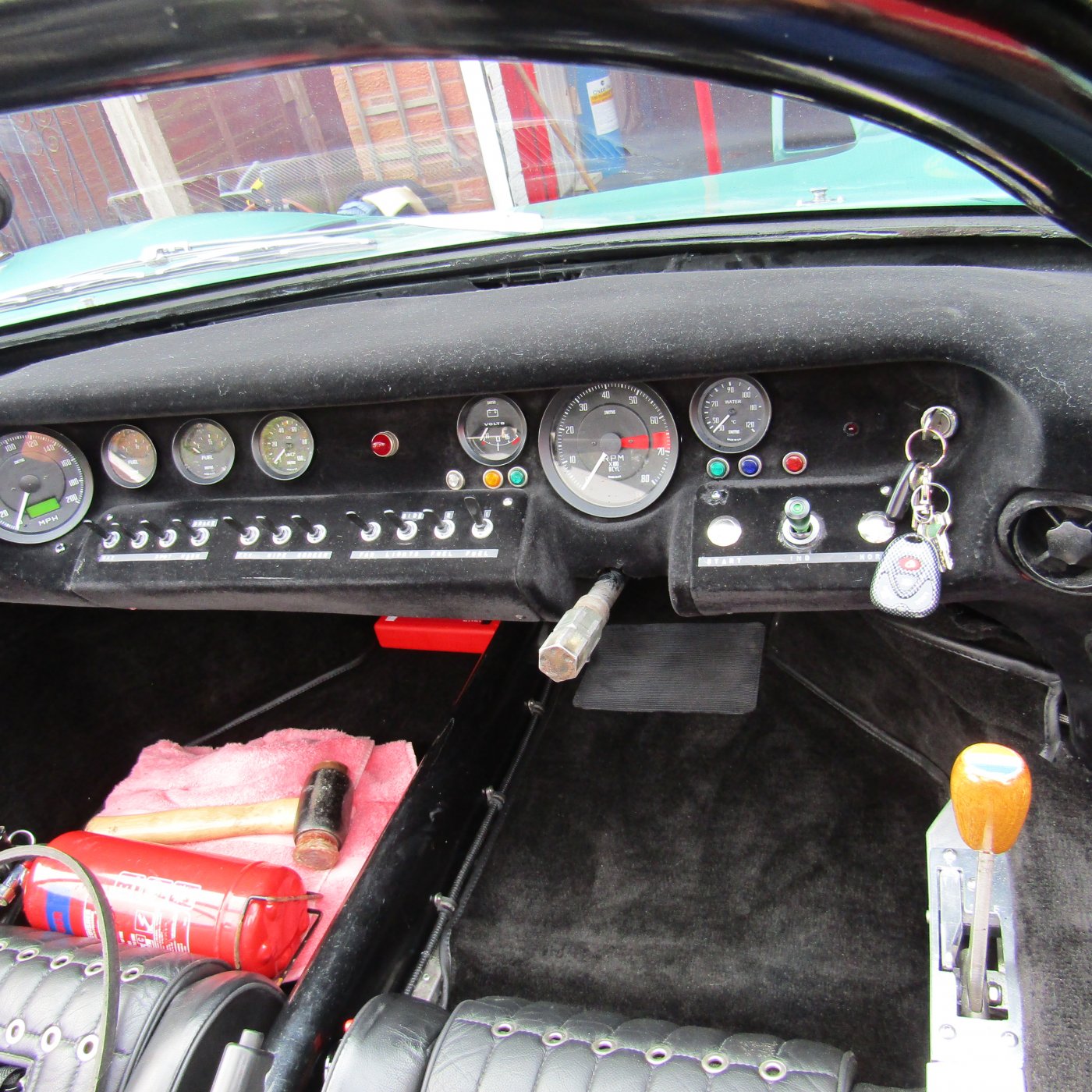

Pictures
