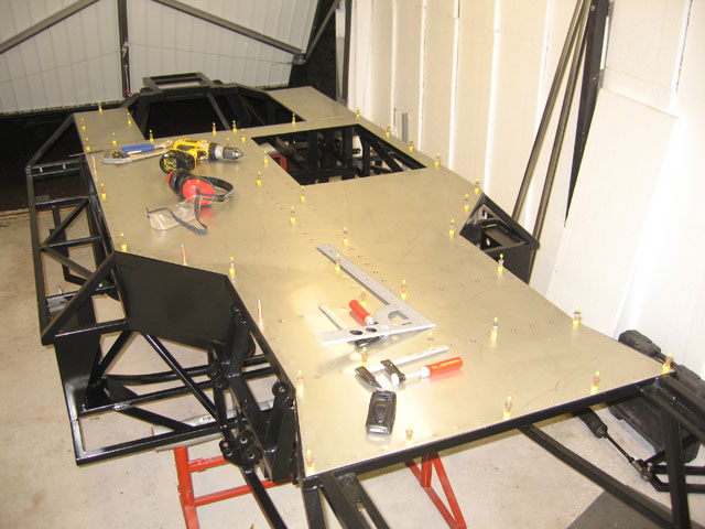

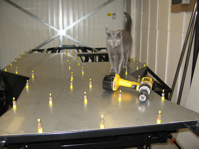

Made a start today by trial fiiting the bottom panels and drilling all the holes ready for rivetting. Holley the cat turned up after all the work had been done(typical woman) to cast a critical eye.

Can't quite see everything properly in those photos Martin but that's the best looking GT40 spaceframe I've yet seen....
PS the cat is well cool as well.......:coolgleam:
