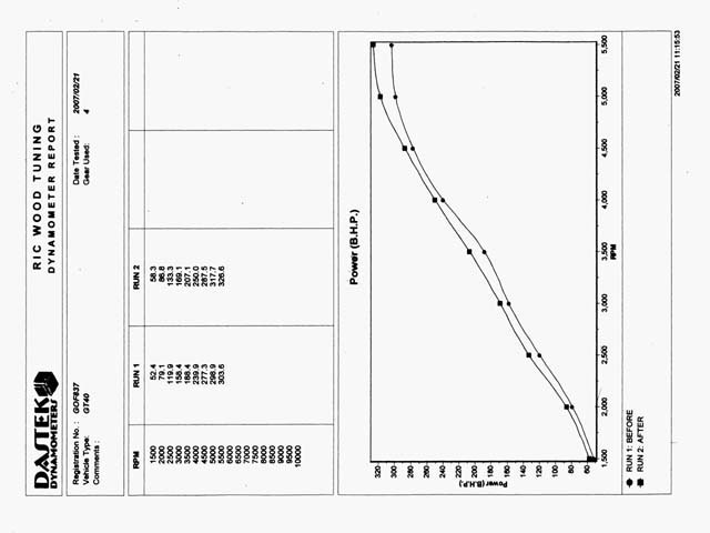

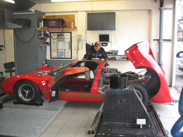

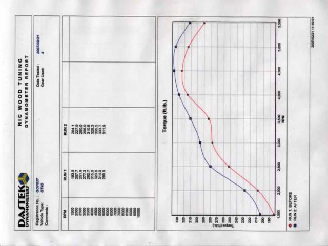

Yesterday I took my current car to Ric Wood`s in Stockport near Manchester. As I had changed the carb some time ago and knew things could be improved it was time for a rolling road session. Cheap power it has been said to me. Well what a difference it has made to the car. Drive`s much better in traffic with no spluttering or hessitation and the difference in torque and power was definately noticable. Here are the before and after tables. The engine is stock apart from Edelbrock heads and inlet manifold.

I can confirm that it was LOUD at full chat on the rollers with the door closed. My ears are still ringing! It also now spits little flames out of the exhausts on the overrun which I noticed as it flew past me on the motorway (at exactly the legal limit!). You can also learn a lot from chatting to people like Ric Wood who has campaigned a lot of different race cars over the years and has a business doing his own CNC heads and car prep and tuning.

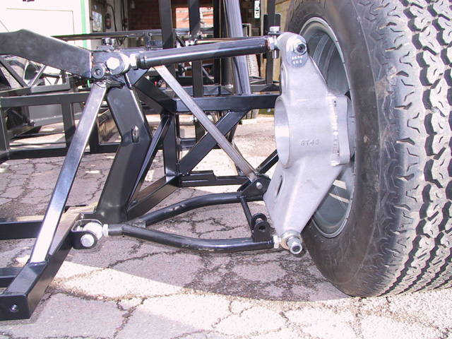

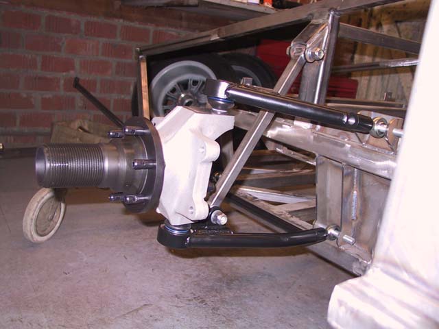

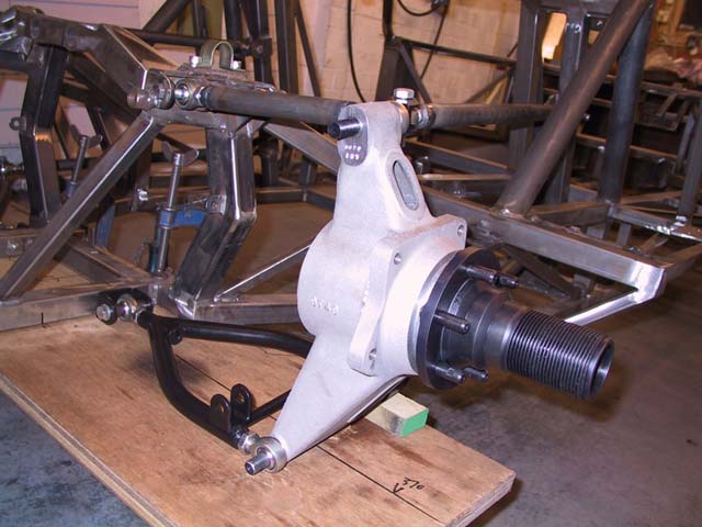

I recieved some pictures last night from Frank of the progress he has made with the suspension. Just mocked up at the moment. The chassis should be going for flame spraying and coating next week. Once thats done I hope to be getting my hands on it.

Wow, those shocks are going to be hard!
Seriously, nice looking build, bet you can't wait to get your hands on it.

Did some go karting years ago so I find it hard to cope with suspension hence the radical setup! The retractable second wheel set should make the tesco car park a breeze.

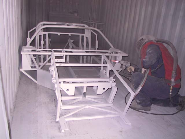

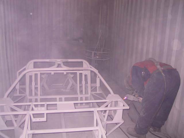

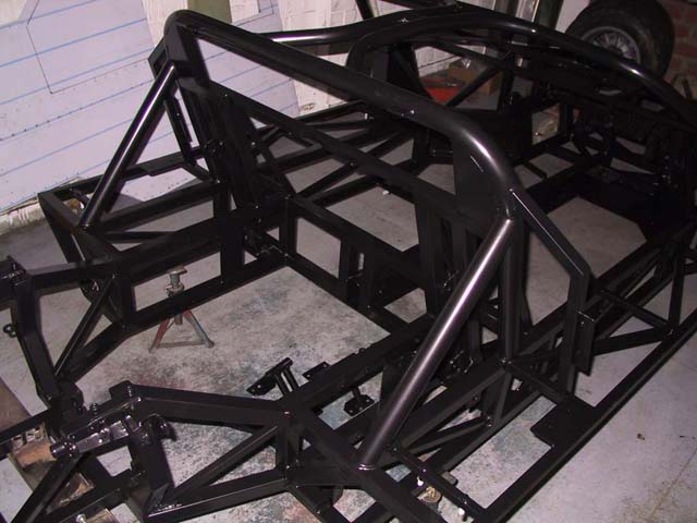

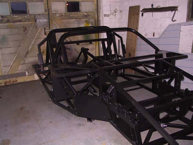

Now things are really starting to move. Today Frank delivered the chassis for coating and the job was done in one day. Now how`s that for service? The chassis was blasted, flame sprayed twice and powder coated three times.
Now I find it increasingly difficult to get anyone too do anything these days, as probably many other forum members do, but I have to say up to now the level of service and professionalism shown by all involved has been second to non. Mick and his team in supplying the chassis, Frank and Geoff in the fitting of the suspension etc and the guys who have done the coating, oh and me of course for paying the bill!!!
My only hope is that I can do the rest of the build justice. Here are some pictures taken today.

Chassis looks superb. Like the roll cage. Should add some serious stffness to the chassis. Echo your sentiments re: the quality of work done by Mick Sollis and Frank. That metal spraying looks pretty toxic though! Looking forward to seeing in the flesh or should that be FLASH.
Martin,
Thanks for taking the time to post great shots of the progress. Those photos of the flame spraying really captured the atmosphere; almost had me coughing in the fumes.
Keep up the building to this standard, and you'll have a quality car that will last forever.
Dalton
Not a stupid question as I didn`t know about this a month ago. Its for corrosion protection. Basically zinc rods are fed through a gun with a flame which melts the zinc which then gets sprayed onto the metal surface. GTD chassis were done origionally and all I can say is that my 1990 chassis is corrosion free.
Martin
Flame spraying is a method of coating ferrous and cast iron metals in an inert non ferrous coat of pure metal, not paint, usually either Zinc or Aluminium.
If you look carefully in the rear of the booth you will see a open reel carrying the zinc wire, which is fed into the spray gun, melted by the propane flame, and blasted onto the surface by compressed air. This means that the spray gun has connections for compressed air, electrical feed to the wire feed motor, propane gas for the heat, and of course the wire feed itself. This is quite a handfull for the poor guy in full protective gear, and very heavy, and when I took these photographs he was on his second coating after 2 hours and was just about exhausted. All of the early GTDs were coated in this method, and all have withstood years of use with little or no coating loss or corrosion, its a very effective solution, but not many shops carry this type of operation out, and I am lucky to have one within walking distance. Powder coating or paint can then be applied for finish. Frank

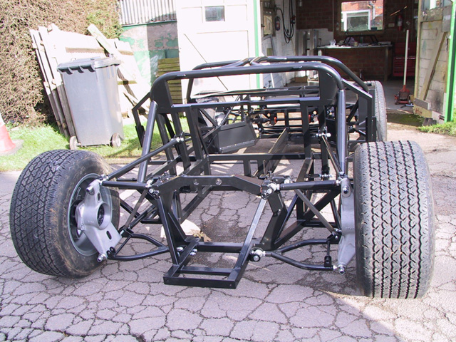

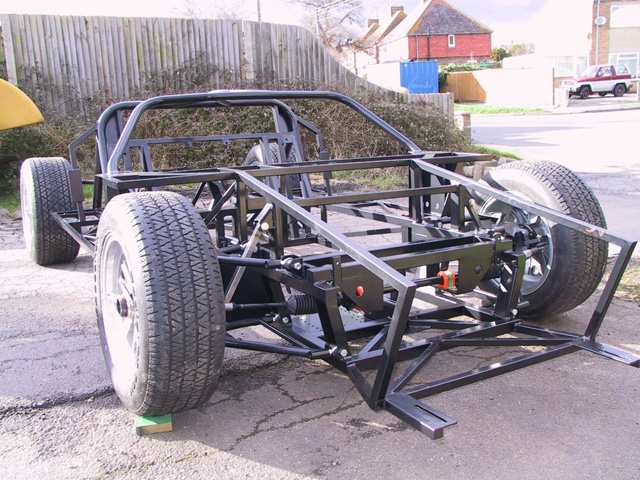

Latest news is that I am off to pick up the chassis from Frank this week wednesday or thursday all being well. Here are some pictures now its a rolling chassis.
